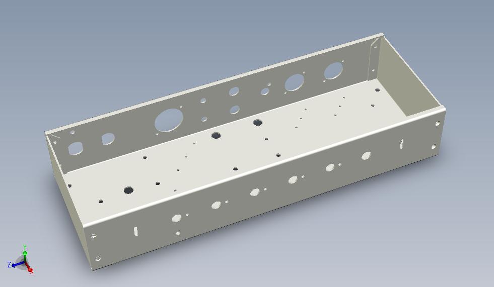

Here's a view of the final revision of the Tramp Chassis (by Peerless Design).

specs and chassis rendering updated
