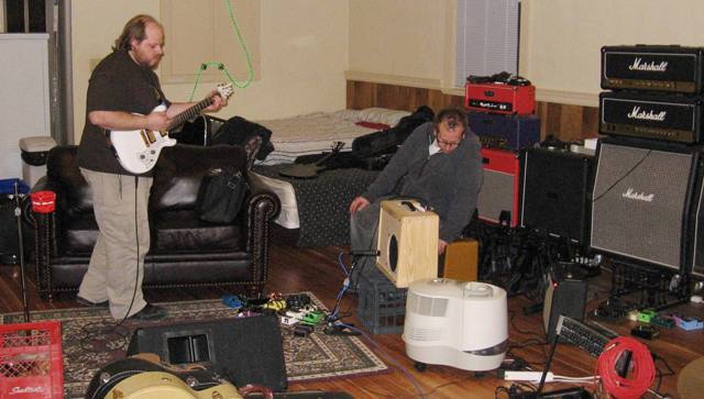

I took the Tramp to the Chapel last night. The chapel is brent's studio built in an old church. You've never seen so much gear in one place.
Sly-Fi Chapel
The objective was to get a few hours of playing time in and get Brent's golden ears and magic hands on it. He can do things to amps you dont want to know about!
Brent
We had two players this time, Rob Waite once again and Mark DaSilva who owns Strumm Music http://www.strummusic.ca in Picton, Ontario.
Mark
I learned a lot more about the tramp in this session. For example, you can get all the sounds you want (Clean pickin' to nicely OD) (Strat, Tele, PRS, Les Paul) in just the Tweed mode [design midrange settings] if you use all the controls, VRM and the Fat / Thin switch, together. If you need over the top OD, a pedal is the big ticket here. And we tried them all!
I'm not going to say a lot more until Brent has had time to post his thoughts but he did record clips.
