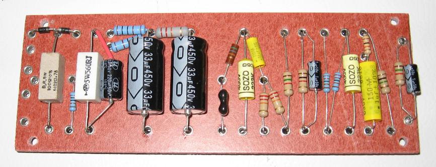

Tramp Eyelet Board
The first version of the board was too cramped, so I redesigned it after we decided to go with a 50/50 can cap. The empty eyelets on the left are for the VRM components that are part of the design.

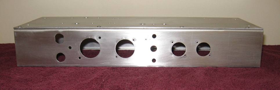

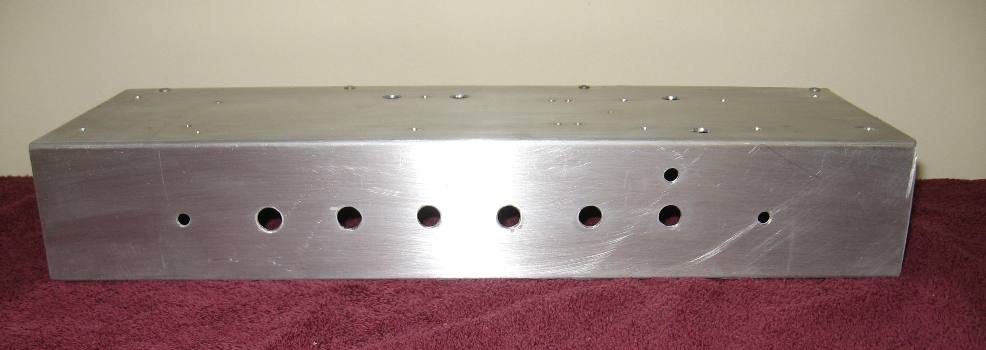

Naked Tramp Chassis Front
The final chassis is going to be 11" wide. It will end just past where the last two holes are. The prototype has to fit into a larger cutout so it's wider.
Tramp Chassis Top

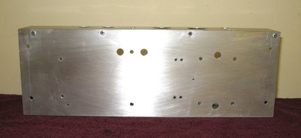

Tramp Chassis Rear
The Tramp only needs two tubes. 6V6 (Octal) and 12AX7. Anyone notice the extra 9 pin hole? [they say two holes are better than one!!]. the other large hole is for the 50/50 can cap. There is provision for a Tweed/'tude switch and headphone jack top and bottom of the output jack .

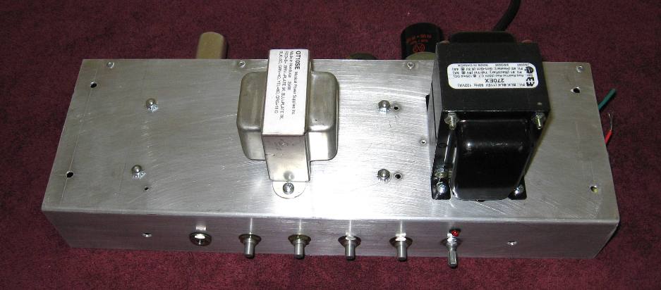

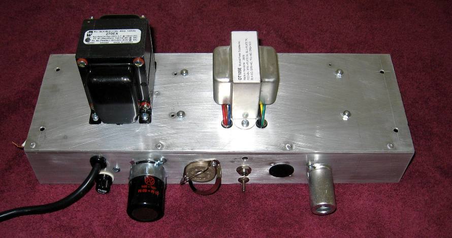

Tramp Chassis Stuffed
The first version of the chassis went together really well. No hard to get at places. Went together quickly.
________________________________Input ------ Gain ------ Bass ------ Treble ---- Master Volume ----- Power/Level
Yes, for the prototype, that's a Hammond PT & a nice-fat M.P.S. OT.

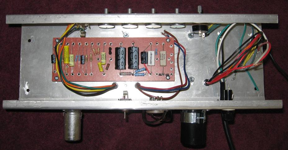

... and finally, the Guts

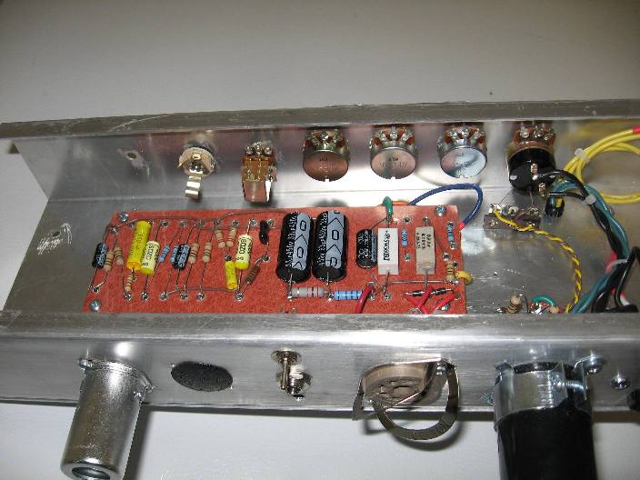

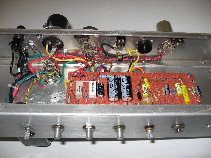

Yes, an LED indicator and MOSFET VRM. You could almost call is Solid State! BTW, the LED is driven by the 6.3V heater line with only a 220R dropping resistor. Works fine. Doesn't need DC. [But you knew that anyway! :wink: ]
Tramp Inside Front. PSU Wired - No VRM installed.
Tramp Inside Rear. PSU Wired - No VRM installed.
