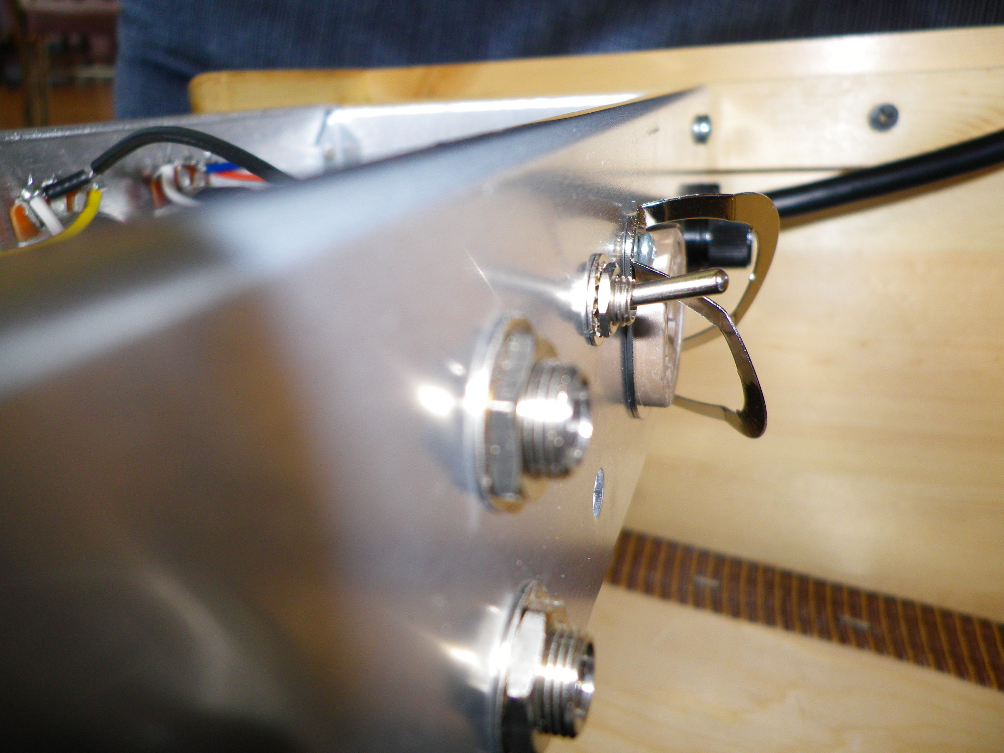

I have another guestion, getting close to firing the amp up. Not sure about the setting for the bias switch for the 6V6 tube. I have posted 2 pics showing were I believe the switch position should be for the 6V6 tube. That is away from the cabinet, with the cabinet standing up or the switch is up with the cabinet laying down as in the attached pics. Can anyone please confirm this for me?

Correct.
Make sure your switches lugs are jumpered horizontally.
Hi Dave.
Great to hear from you again.
FWIW, I think you got it right.
Here is what I found out with my Tramp:
6V6 use: the amp has been used with the same setting that you indicate for the bias switch for the 6V6. Just to confirm: with the cabinet standing up, that switch is away from the cabinet.
Then I decided to try using a 6L6. So I used the 6L6 setting (bias switch towards the cabinet) and the 6L6 tube (RCA and Sylvania, I have two) works fine in that setting.
I used a multimeter to guide me when deciding what switch position did what.
I plan to use a black marker to indicate what the settings are. It could be written on the chassis, near the switch. It would normally be hidden from view but could be seen, if necessary as a reminder, by looking under the amp.
Hope this helps.
