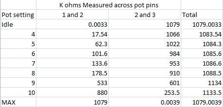

I de-soldered two of the leads from the pot so that I could measure the resistance out of circuit (just to be 100% certain). There's definitely a problem there. Big jump when we get to the 9 setting and there it looks more like something you'd expect from a 5 to 5.5 setting - close to half and half.
So, where can I pick up another? I see a1 has one listed on their site, but I'm not sure if it's the same in terms of physical size...
PostPosted: Tue Mar 22, 2011 6:53 pm
Is it a linear pot or an "audio" one? I forget exactly what kind we specified. If it's an audio pot, then the change in resistance won't be linear. You can compare with the gain and volume pots which are also "audio" (ie logarithmic). However, the jump you described seemed a little too abrupt to me. It would have also been useful, if before you had removed the pot yo could have checked the whole VRM's output voltage as you moved the pot. It should track the voltage on the pot's wiper to within a few volts.
PostPosted: Tue Mar 22, 2011 11:27 pm
Posts: 67
I'm pretty sure it's an audio pot.
But yeah it's still not looking right. Right?
I can put the pot back in circuit tomorrow and check the voltages
You're talking about the variance of B+ right?
