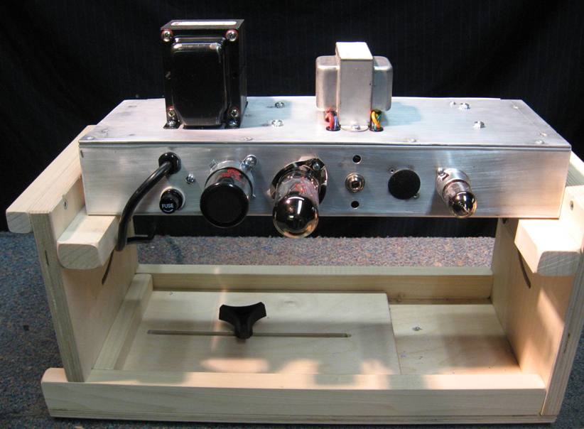

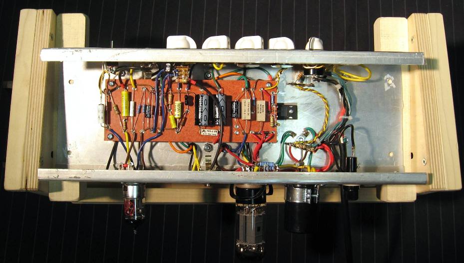

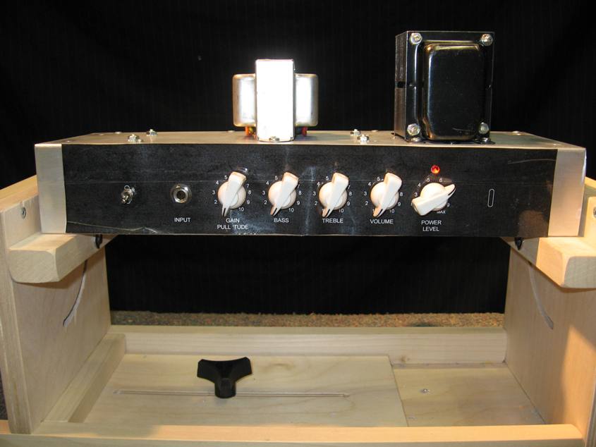

Prototype Pics. Front panel is 'faux panel' 8)
Inside - Note VRM, and 6.3 VCT derived ground with two 100 ohm resistors. Even that didnt add any noise. Wont be in the final design, just worked with what was available.
Front - Note Power - Level Control. Incorporates a Power, Standby (Idle) and VRM control. Prototype Panel is made from paper & tape!!
Temp toggle switch for 1uf & 0.68 uf V1A cathode cap comparison.
Rear - For those who like 'back ends'. .
