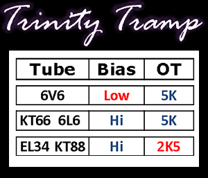

Dan, Check page2 of Tramp forum, read the fourth post from bottom ("OT Impedance Switch Arcing"). Arcing usually appears on the lugs of the switch, also the impedance switch on the OSD, too. I used the bigger switch in the spare hole on rear panel, but the liquid insulation seems to work also. Edit: There are other threads about the same issue in Tramp forum. I'm attaching a pic of how I did it. It's the big switch between output impedance switch and preamp socket. I see you got the head chassis, my builds were w/ combo chassis. ** My bad, bias switch NOT the problem, it's the output Xfmr impedance (load) switch that's the problem, put that in to run all 5 tubes and changed the 560 ohm cement resistor to a 1K per Coco's info on running EL34 and KT88's :bugeye: If you didn't put in the "load" switch, ignore my :chatter: ramblings!
