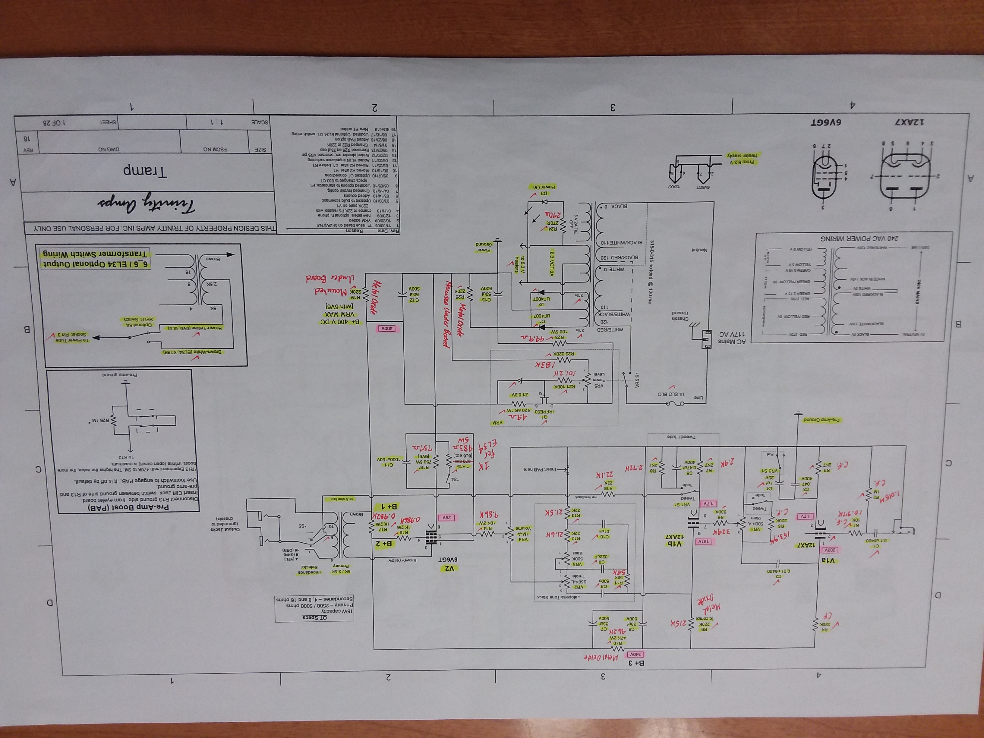

Here's some additional information for my build. I've attached an image of the layout where I coloured all of the wired connections the same colour as the wire I used in my chassis. I've also labelled each of the components to match the schematic. As well, the speaker connection jacks that I used are not the same as those on the original layout. I used 12a shorting jacks for the internal and external speaker connections which is why I have an external ground for them. These jacks use an insulating washer so they are not grounded through the chassis. The red check marks at all of the wire connections indicate that I've measured the resistance between the two points the wire is connected through to ensure there isn't an open circuit. I've also attached an image of the layout for the dual OT mod which I did. Hopefully it will be of some help for those of you that are planning to include this mod in your build.

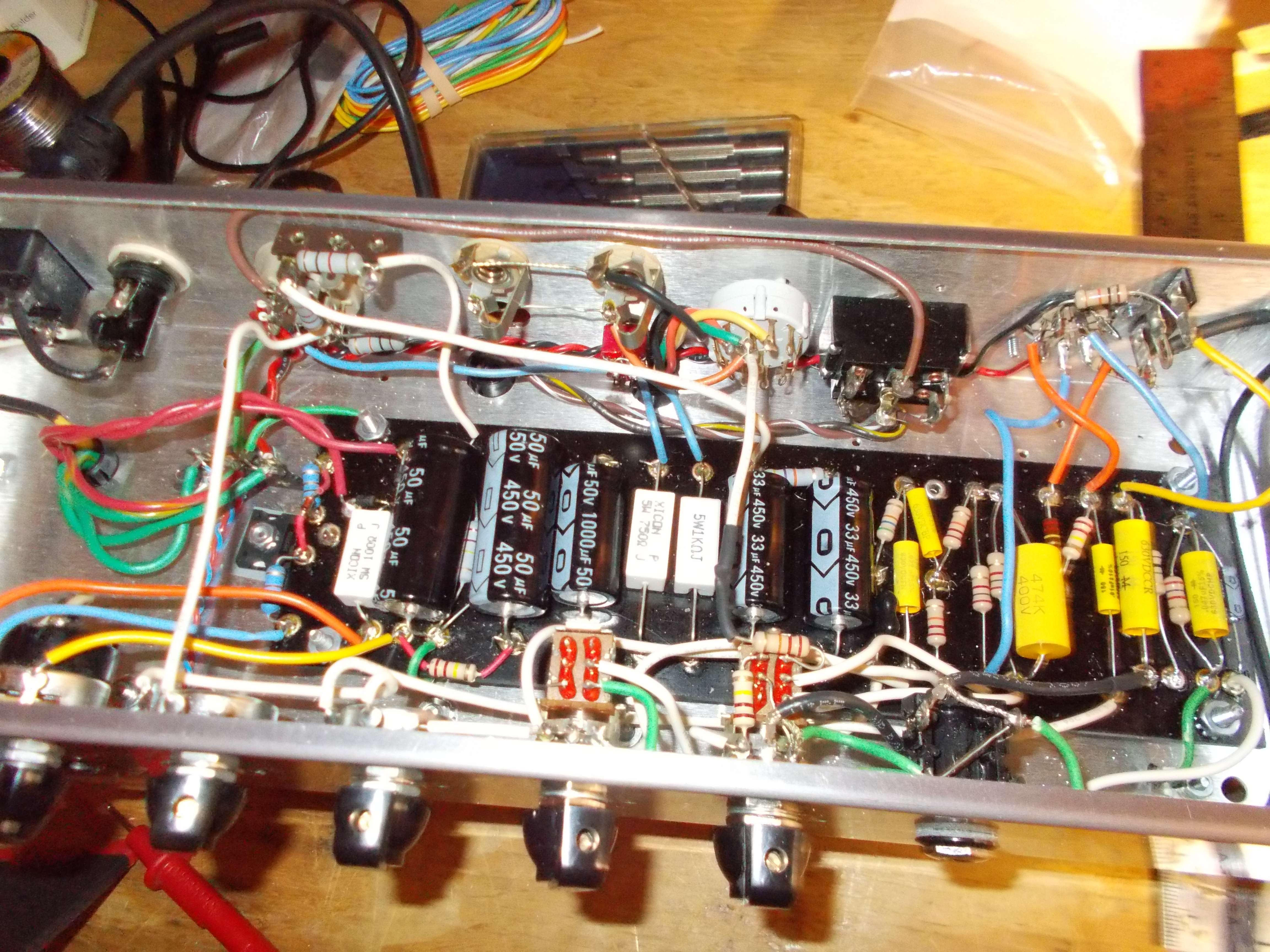

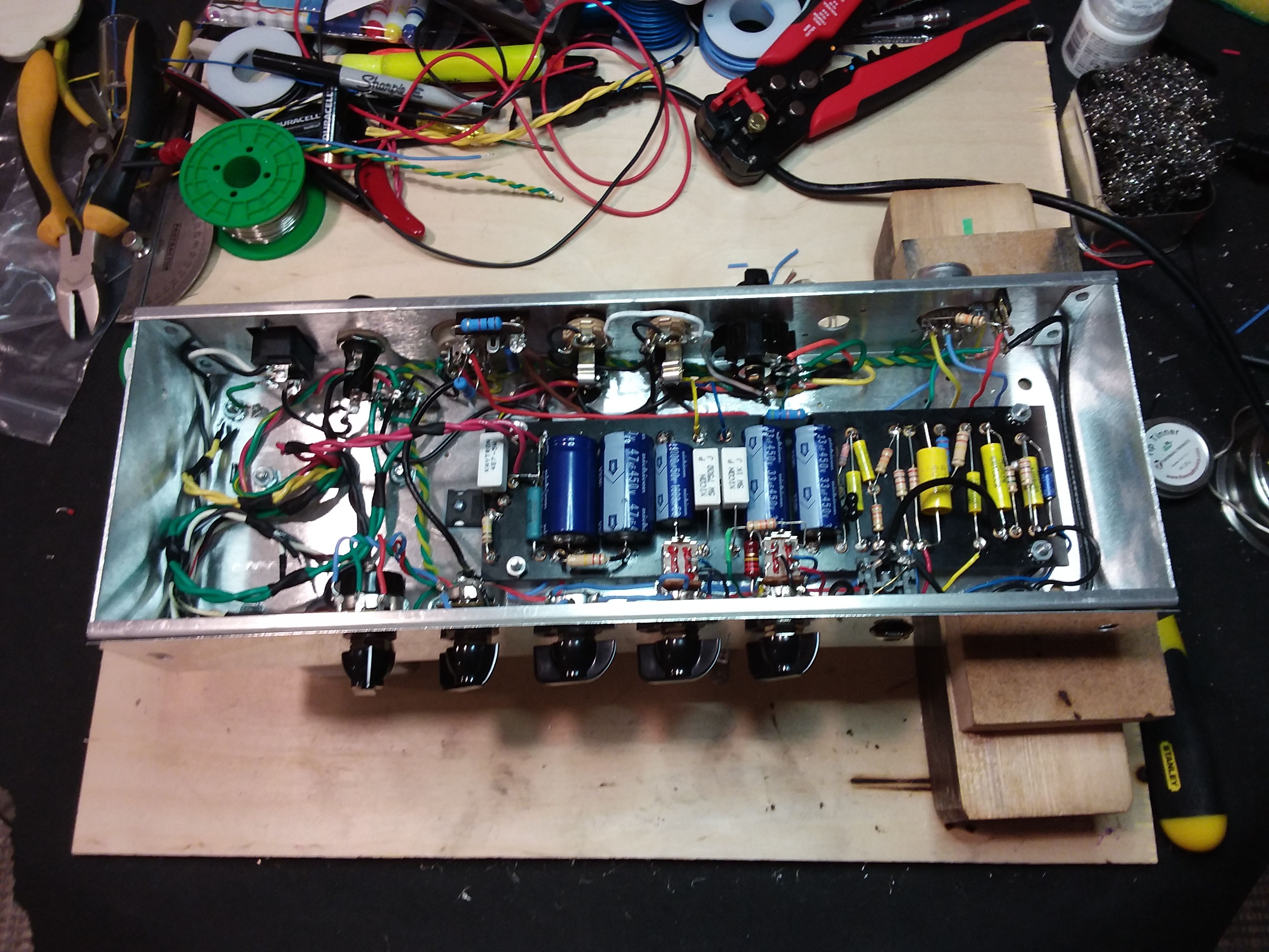

Here are pics of my board. Can't see the two 220k blue power resistors under first two 50uF caps.
