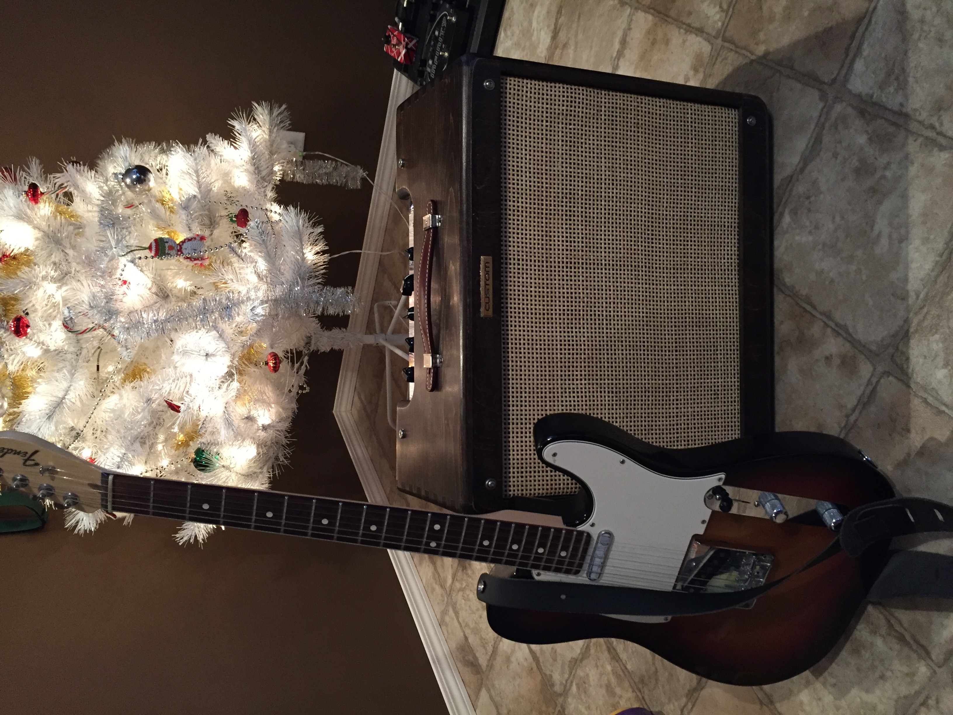

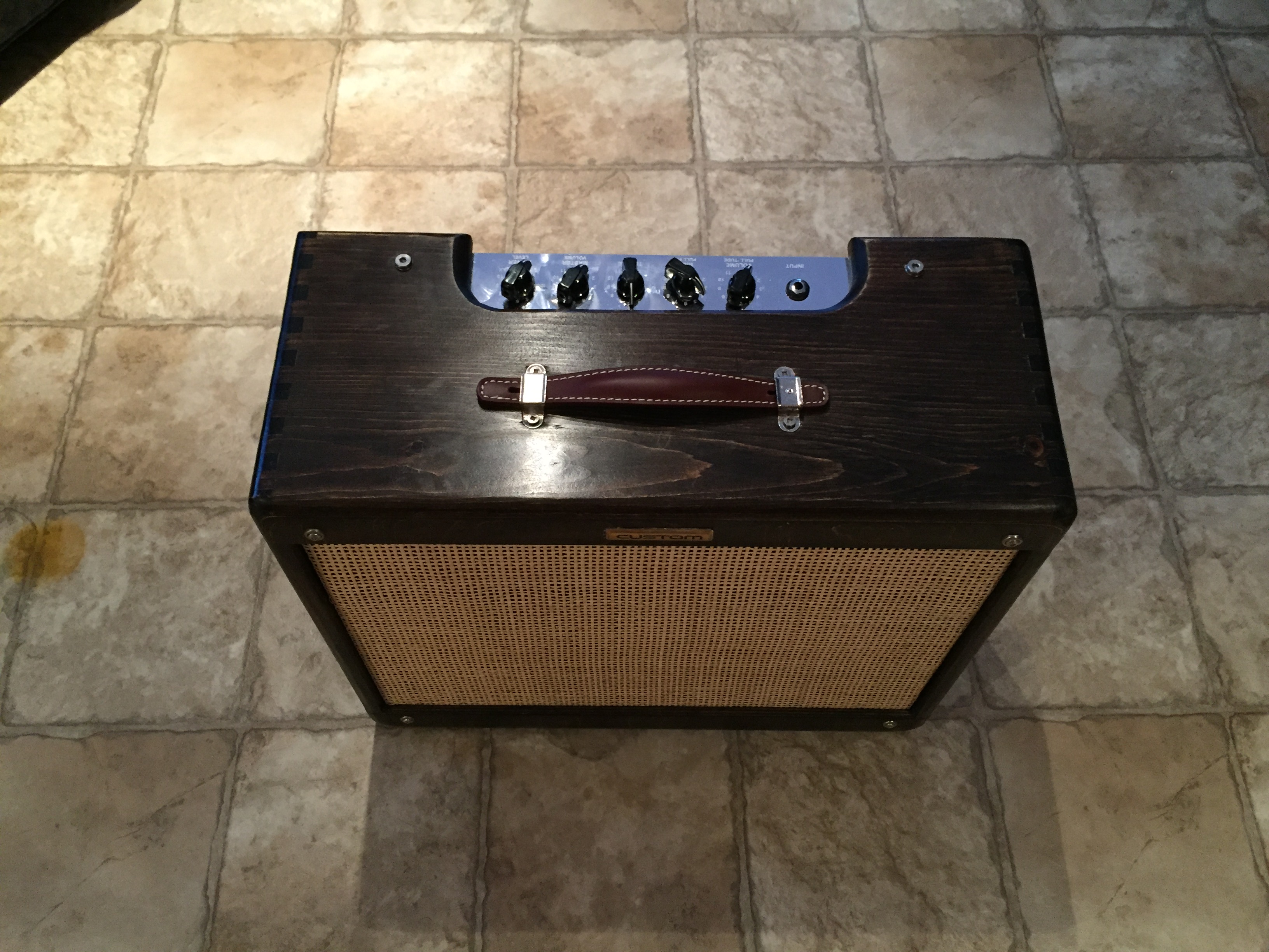

Xmas came a bit early for this guy! Turned out a lot better than I thought it would. Sounds awesome. Thanks everyone for helping me out. Thanks Stephen for a great kit! I thoroughly enjoyed the whole process of building both the amp and cabinet. Can't wait to start another one!
Happy holidays everyone.
Barry
