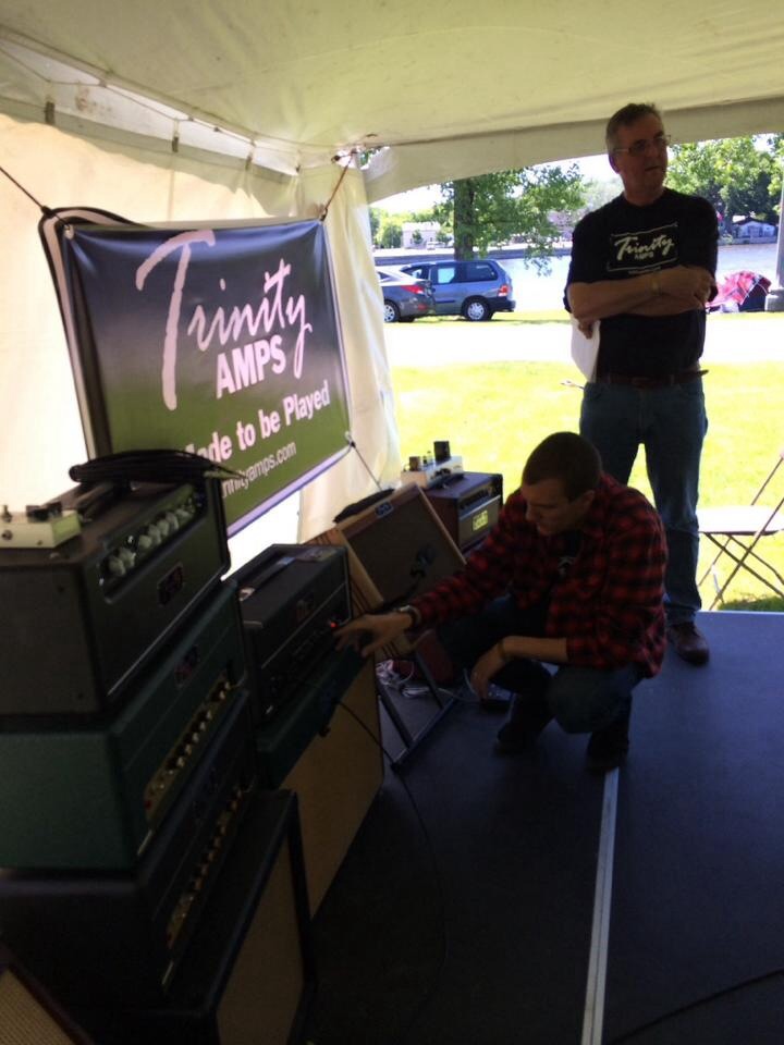

Yes, we posted on Facebook (trinityamps) but not here. Chris and I presented to about 13 people while Shawn Dore demonstrated the effects of changes with respect to modding amps to get a different tone.
Feedback on the workshop was positive and we met some more cool people.
