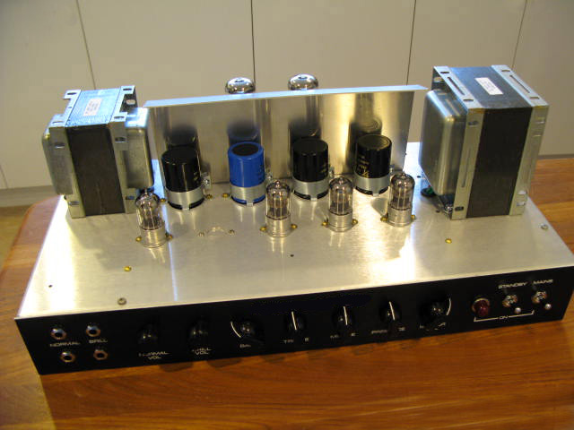

PostPosted: Tue Nov 30, 2021 6:57 pm
Sounds like heat isn't an issue, but adding reflective tape, as Stephen said, wouldn't hurt.
Hiwatts had an aluminum heatshield between the output tubes and the filter capacitors. Like on this DR504 clone with EL34s that I built several years ago.
