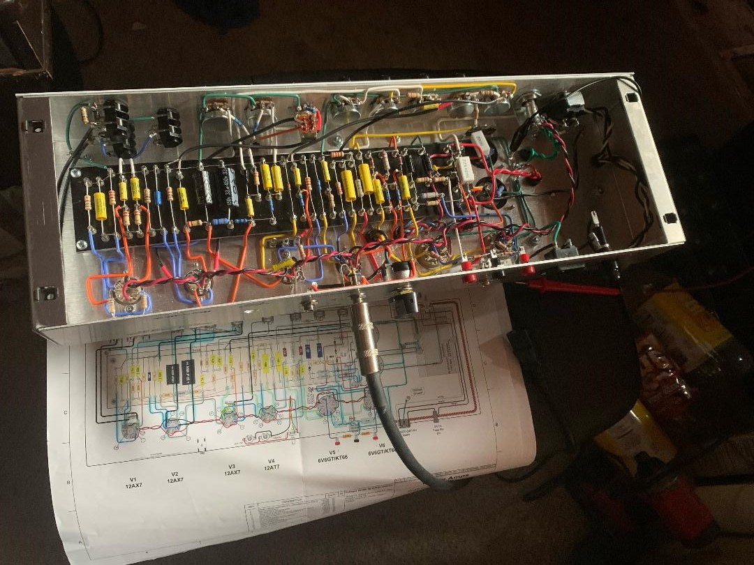

Note: I attached some pictures, because I just can't help it!

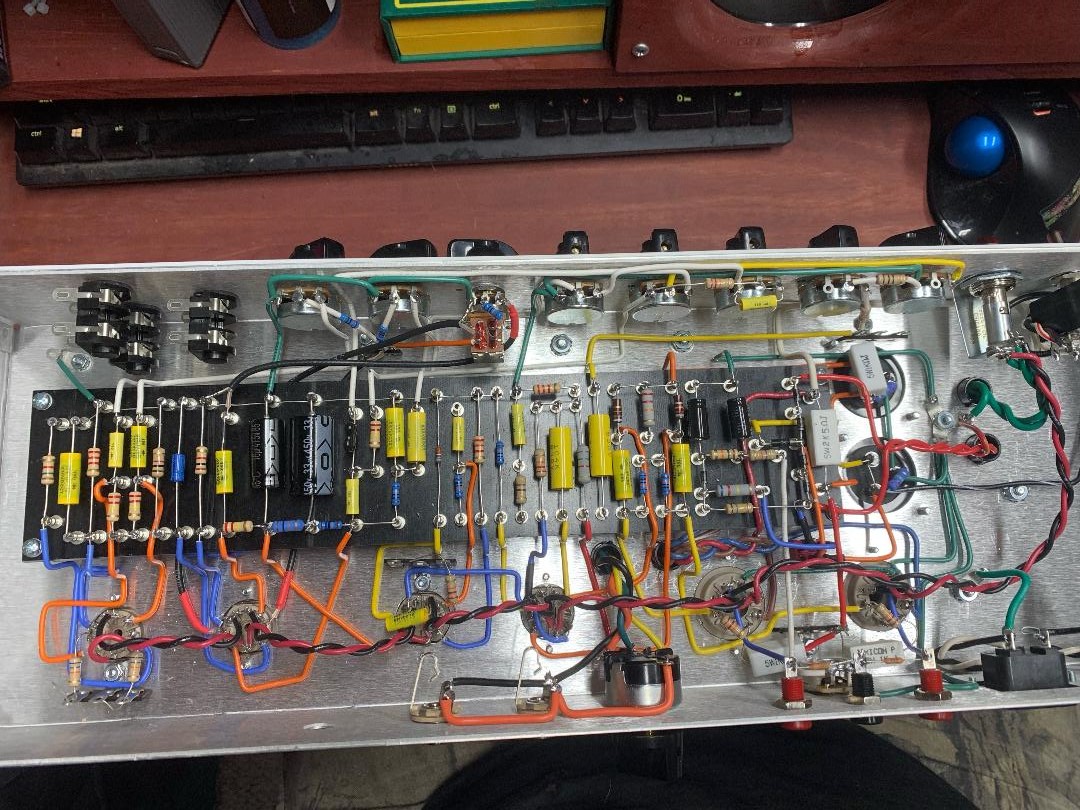

File comment: Wiring
File comment: Almost done...
File comment: Complete with cab!

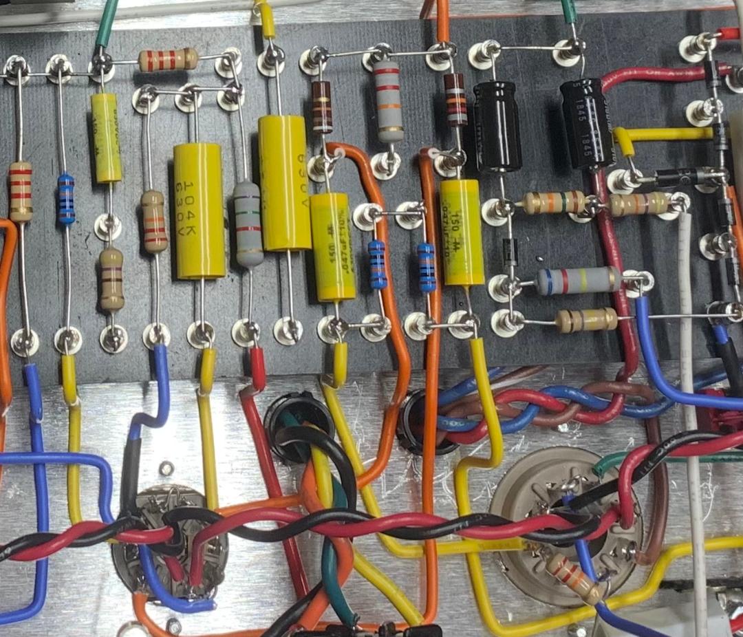

Can you provide a close up of V4? Did you double-check the resistor value mounted on the socket between pin 2 and 7?
Also a close-up of the PI section of the board...where you have the 91k and 82K resistors. Are they swapped?

Attached is a cropped picture I had from a little earlier in the build state, without all of the shielded coax installed. I definitely have the 82K and 91K resistors in the right spots, but it jumps out at me now that the tolerance bands are not the same, with the 82K having a silver band designating a 10% tolerance instead of the 5% noted in the parts list. I hadn't taken note of that detail when I was testing components, and now that 89K reading makes more sense.

Thanks for the extra pic...everything looks right based on the layout/schematic.
