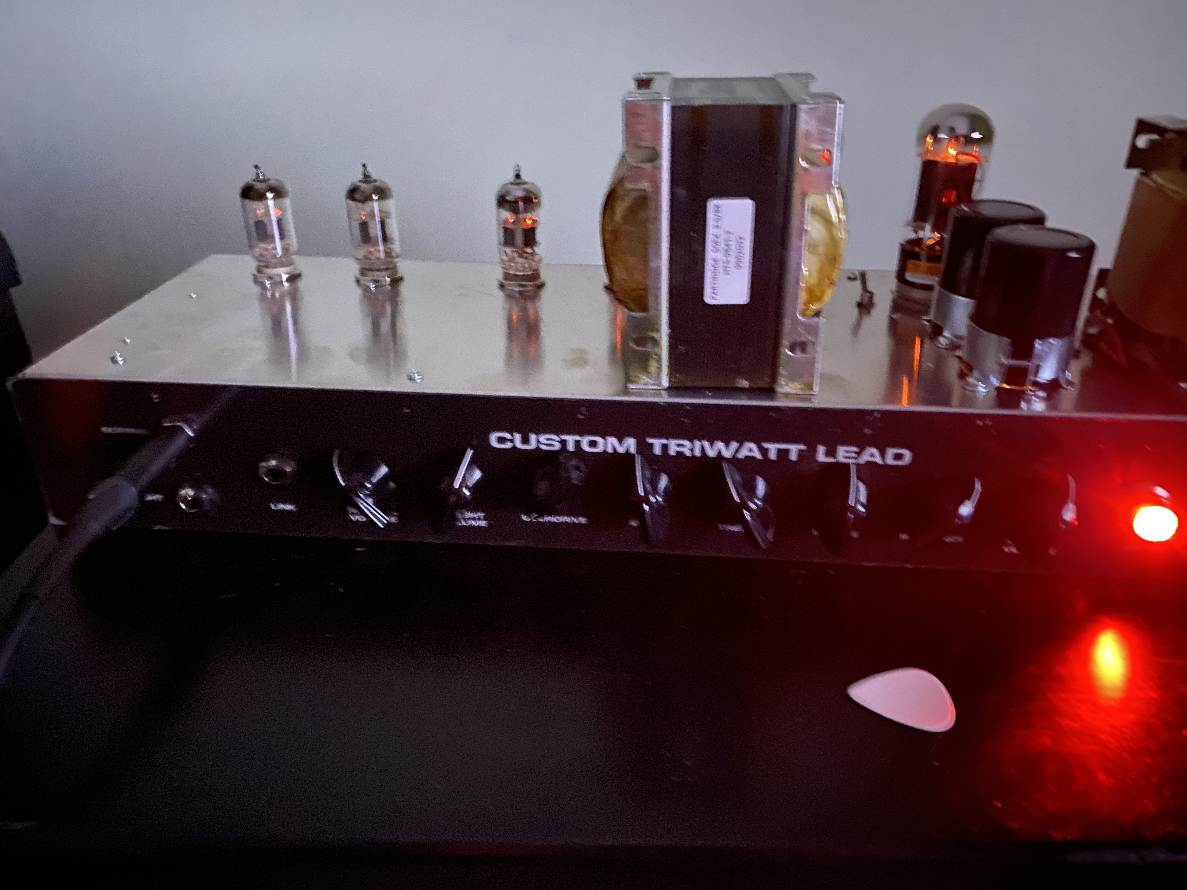

I finished up the wiring and adjusted the bias, but I am now not getting any sound coming from the amp when plugged in. The pilot light is on, the tubes are glowing, but no noise from the jack. Any thoughts on how to track down the issue?

Just to make sure, it's V5 now that isn't giving you a bias reading, right?
Because that is also the tube that has gotten the incorrect voltages because of the missing jumper.
Have you got some spare tubes to try? You might want to check that first.
Secondly, check all wires on the two power tube sockets, the blue wires going from those sockets to the bias circuit and the connections on the bias circuit itself.
It is very hard to see on the pictures but some connections seem to lack solder, but I could be mistaken.
First try out a new tube. Might solve the issue already.
By the way, out of curiosity are you using the 6V6 tubes?
So I swapped out the tubes and now I am not getting bias reading on the V6. So I will order a new tube and hopefully that fixes it.

Okay, great. That should be the final issue then.
Please let me know if those new tubes solved the issue.
I am very happy having been able to help you out.
The guys on the forum helped me out a bunch too.
BTW, I am using JJ 6v6s too. Great tubes that fit the amp well. Those are very sturdy tubes that can withstand quite some voltage. Significantly more than some other current production 6v6s. Unfortunately, the voltage you gave that V5 must have been too much to handle, even for the JJs. But hey, that is part of the process! ;-)
 Post subject: Re: Help with build
PostPosted: Fri Jan 29, 2021 6:41 pm
Joined: Thu Jan 14, 2021 11:42 pm
Posts: 10
Got my new tube in and swapped out some caps for Sozos and it’s working perfectly. Getting approximate voltage readings as well as bias on both power tubes. Thanks again for your help! I certainly learned a lot on this build and look forward to doing another sometime soon.
