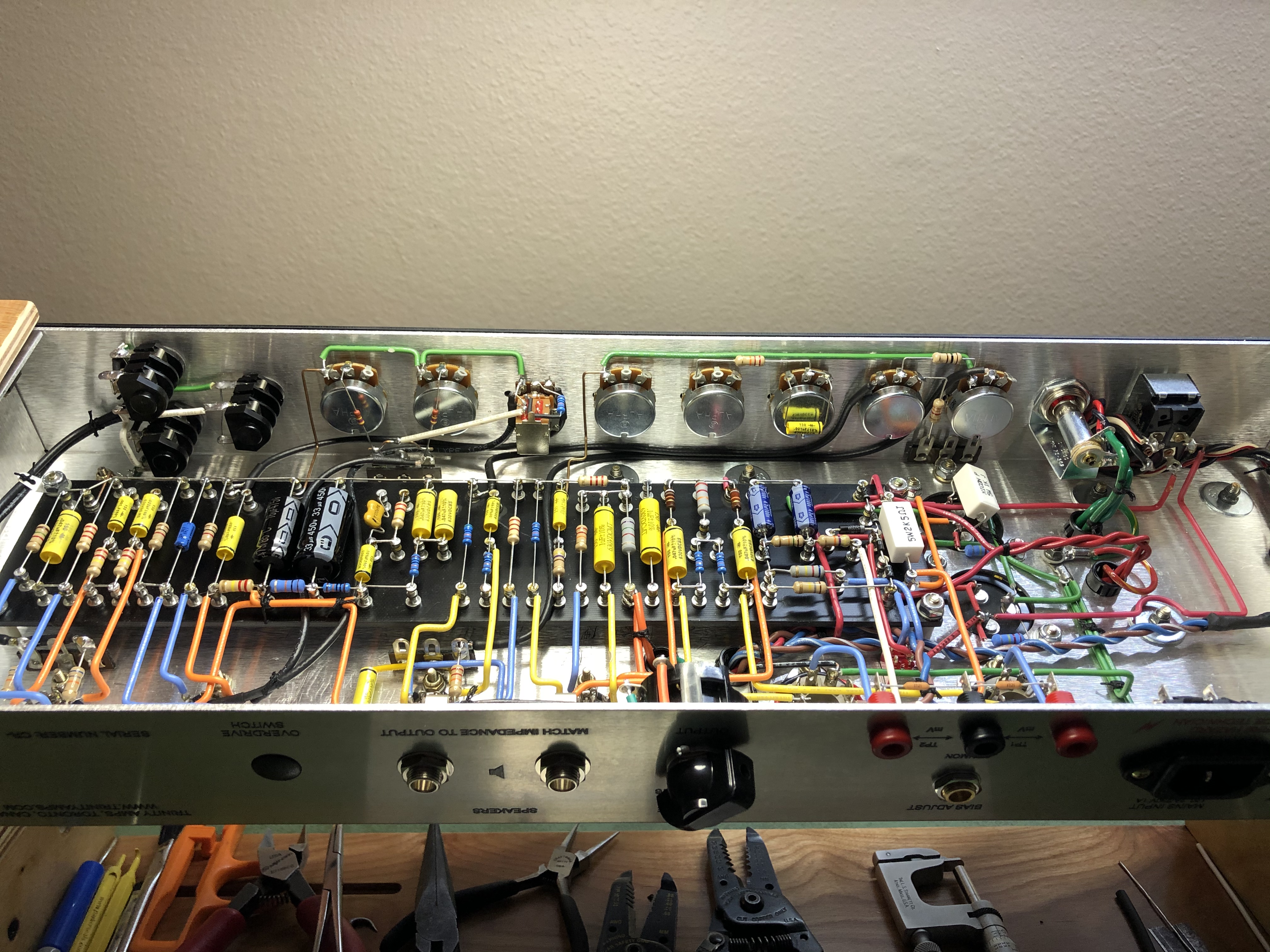

Here is my build so far
PostPosted: Wed Jan 08, 2020 3:34 pm
Looks very nice.

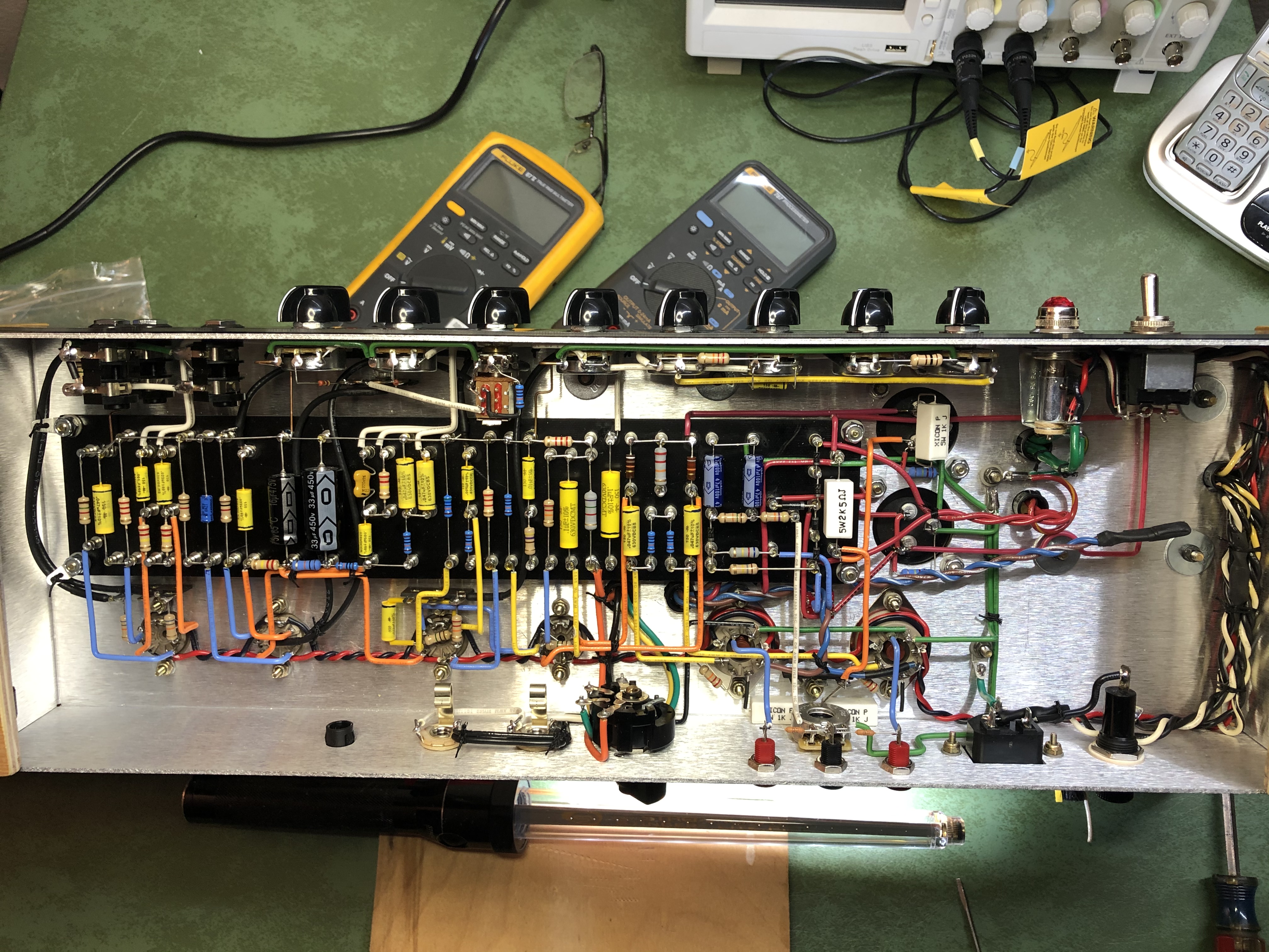

Thanks guys, here is a pic of the of V1 and the other nputs

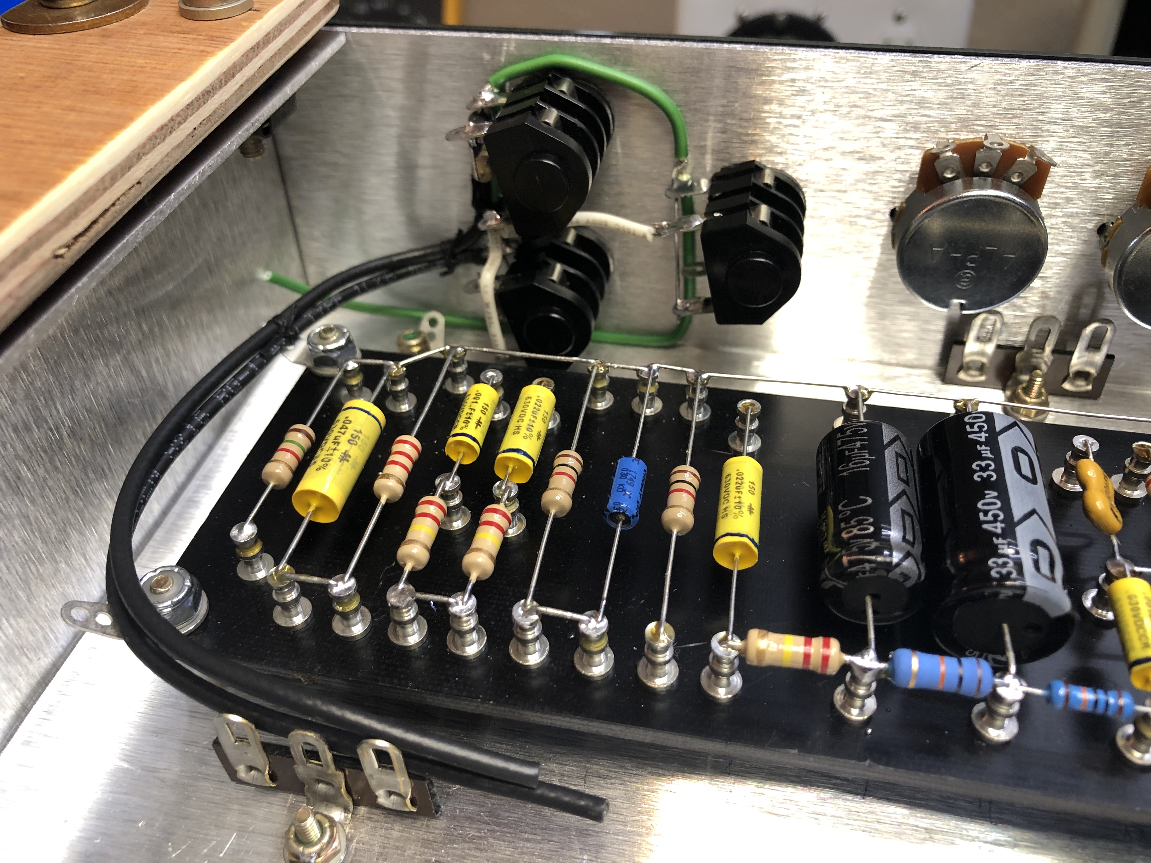

Here is another shot

PostPosted: Sun Jan 12, 2020 5:36 pm
Agree with Gertjan, that is really clean looking build :!: I do have a question, though, how do you get the wires so straight? I saw where someone drilled a hole through a board just slightly over the wire(with insulation) diameter and pulled it through the hole while spinning it w/ a drill to straighten the wire, but haven't tried it yet.

It takes patience. I am a perfectionist hence the straight wiring.
I used a pair of pliers to bend the wires and checked their fit before I soldered them. Takes some time but it makes for a neat build.

Hello Hankules, I rolled the wire between two pieces of wood, back and forth like rubbing your hands together trying to get them warm, except using wood. Works great with the cap leads also just have to do each side separately.

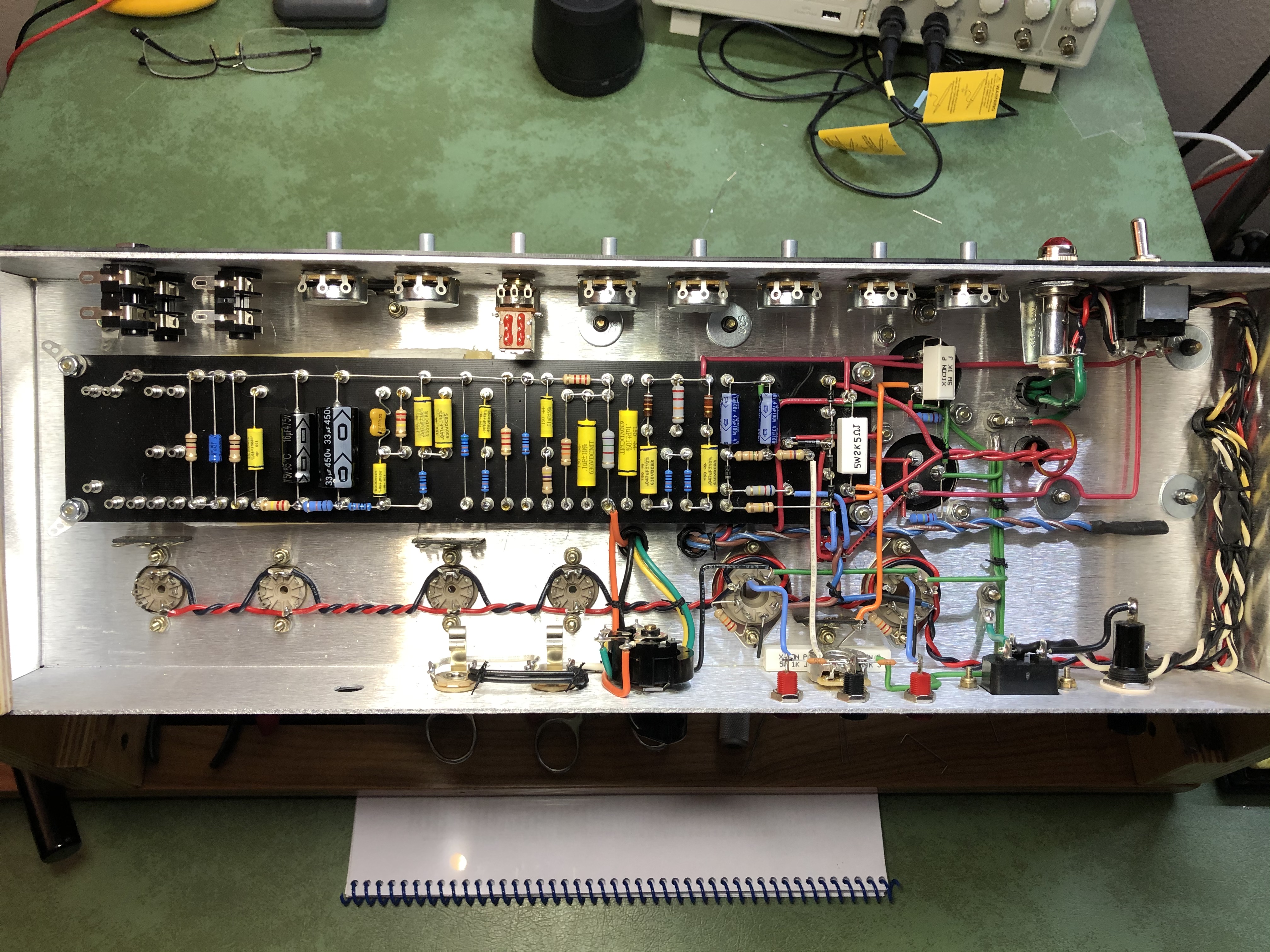

PostPosted: Mon Jan 13, 2020 1:46 pm
Posts: 40
Here it is almost done
PostPosted: Tue Jan 14, 2020 1:47 am
Posts: 40

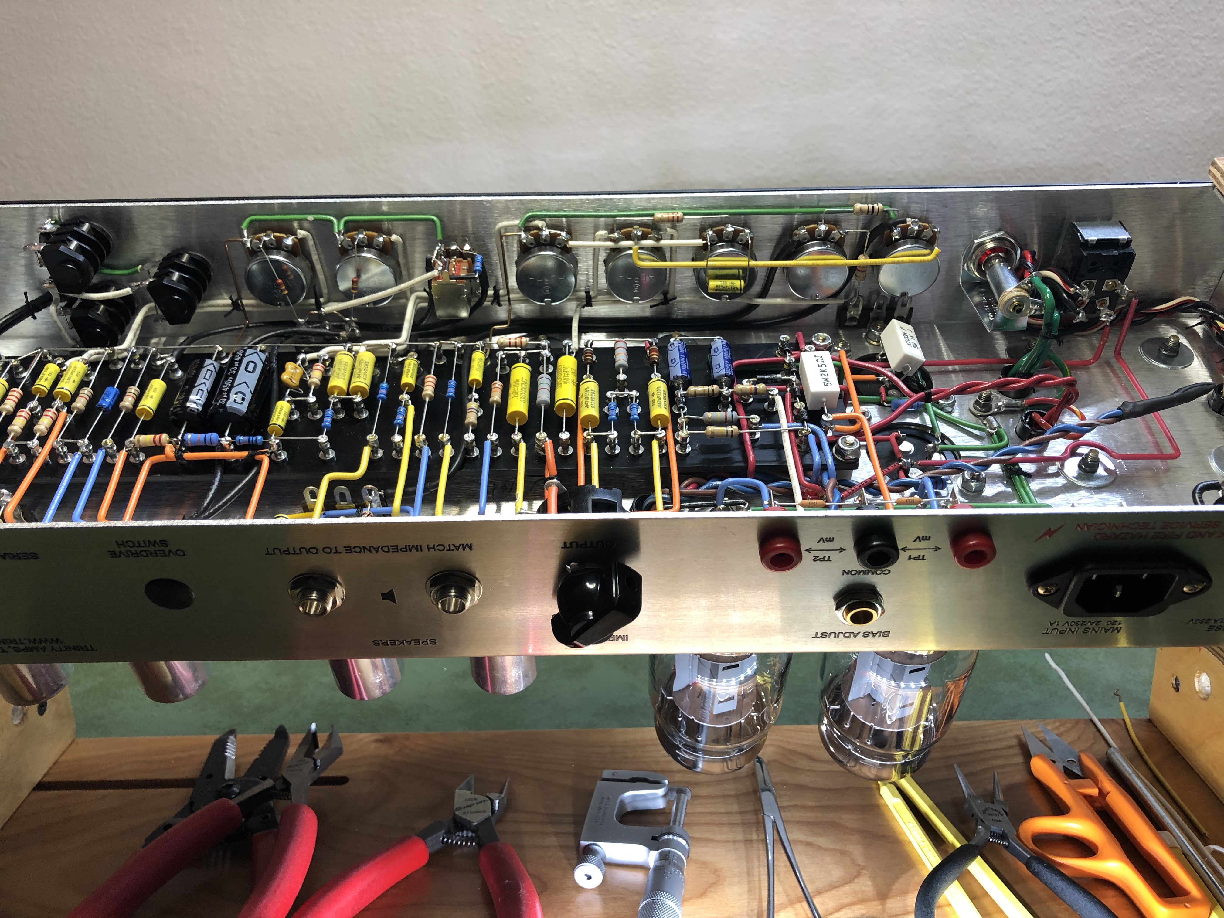

Well I fired it up, no smoke no burned fuses all voltages within specs. Plugged in the Les Paul and she sounds amazing It’s almost midnight so I really can’t put her to the high volume test I’ll report back. Here are a few pics. Thanks for the help.
