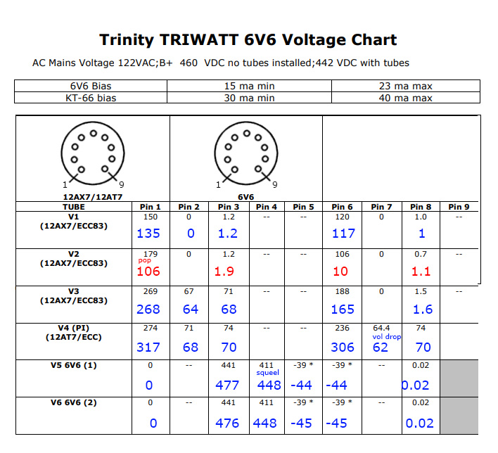

TRIWATT's been running great for a year or two, the other day I turned it on the the volume is <10% of what it should be. Took a look at the tubes and V4, one of the 12AX7, was glowing like the sun, compared to V1, V2 and V3 at least.
I swapped out V4, now the tube glow is inline, but it hasn't sorted the volume issue. Thoughts?

First measure all he voltages and compare to before. There may be a clue in that. that's the starting pont.

Finally got around to pulling this amp and checking voltages, something definitely up with V2.

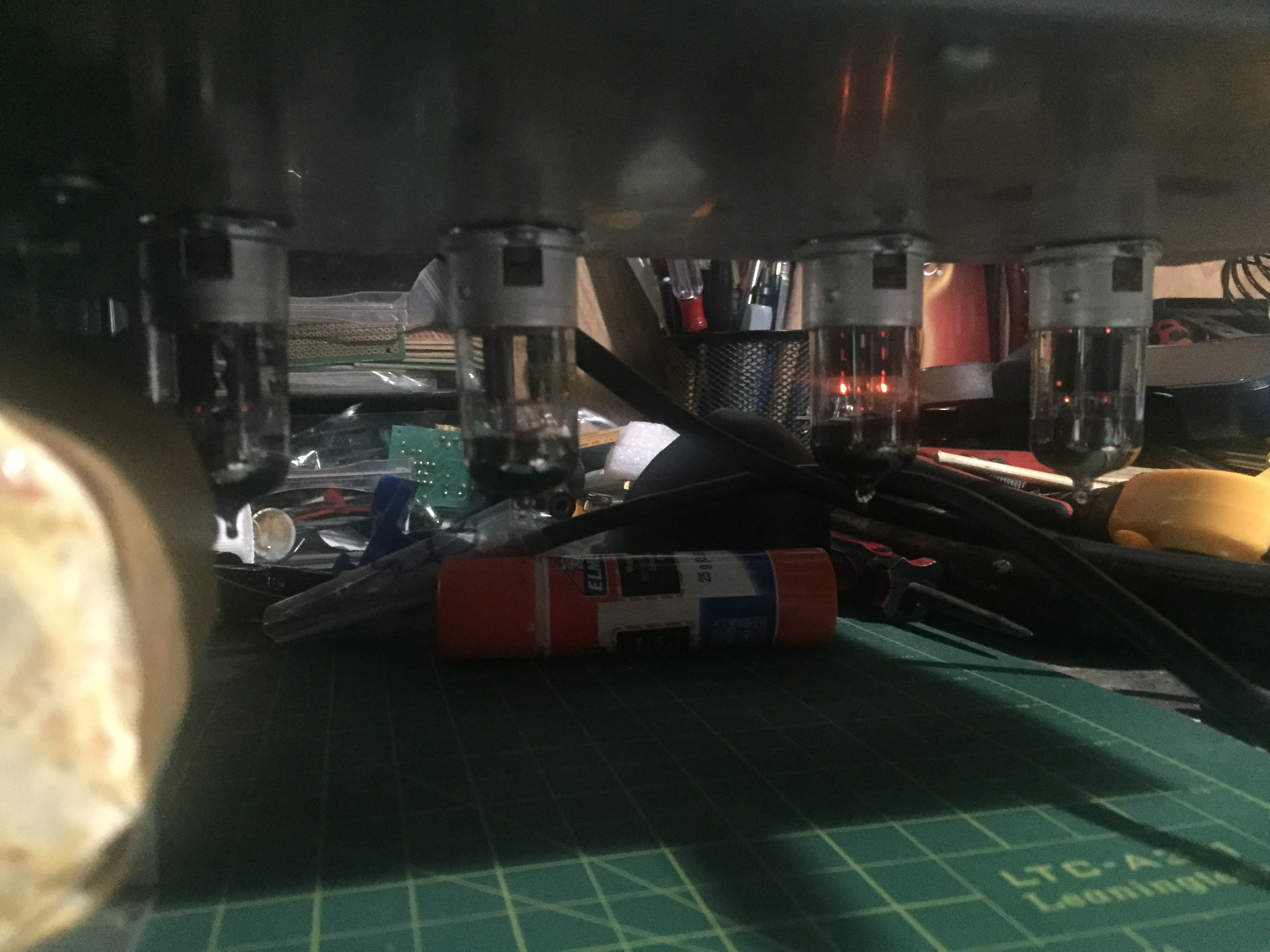

Hrm, replaced V2 and I got my volume back but V2 is glowing maybe a little too much? Here are V2 voltages after the tube swap,
Pin 1 - 186
Pin 2 - 0.007
Pin 3 - 1.3
Pin 4 --
Pin 5 --
Pin 6 - 112
Pin 7 - 0.008
Pin 8 - 1.6
Anything to be worried about with these readings, or the glow? V4 seems quite a bit off (by 70 VDC on Pin 6).

You might want to check the value of the 1K cathode resistor. 1.6V is quite high compared to the sheet.
Touch up the solder joints there. Rest looks OK.

Cathode resistors test fine. Preamp tubes are a mismatch of brands and ages now. Does it make any sense that the 12AT7 on V4 would go, I swapped that out for a 12AX7 and then V2 seemed to have gone, now I've swapped V2 for a 12AX7 and I've got volume back but I'm concerned I'm just going to burn through tubes. I'll give it a run through on the bench here at operating temp and see what happens.
