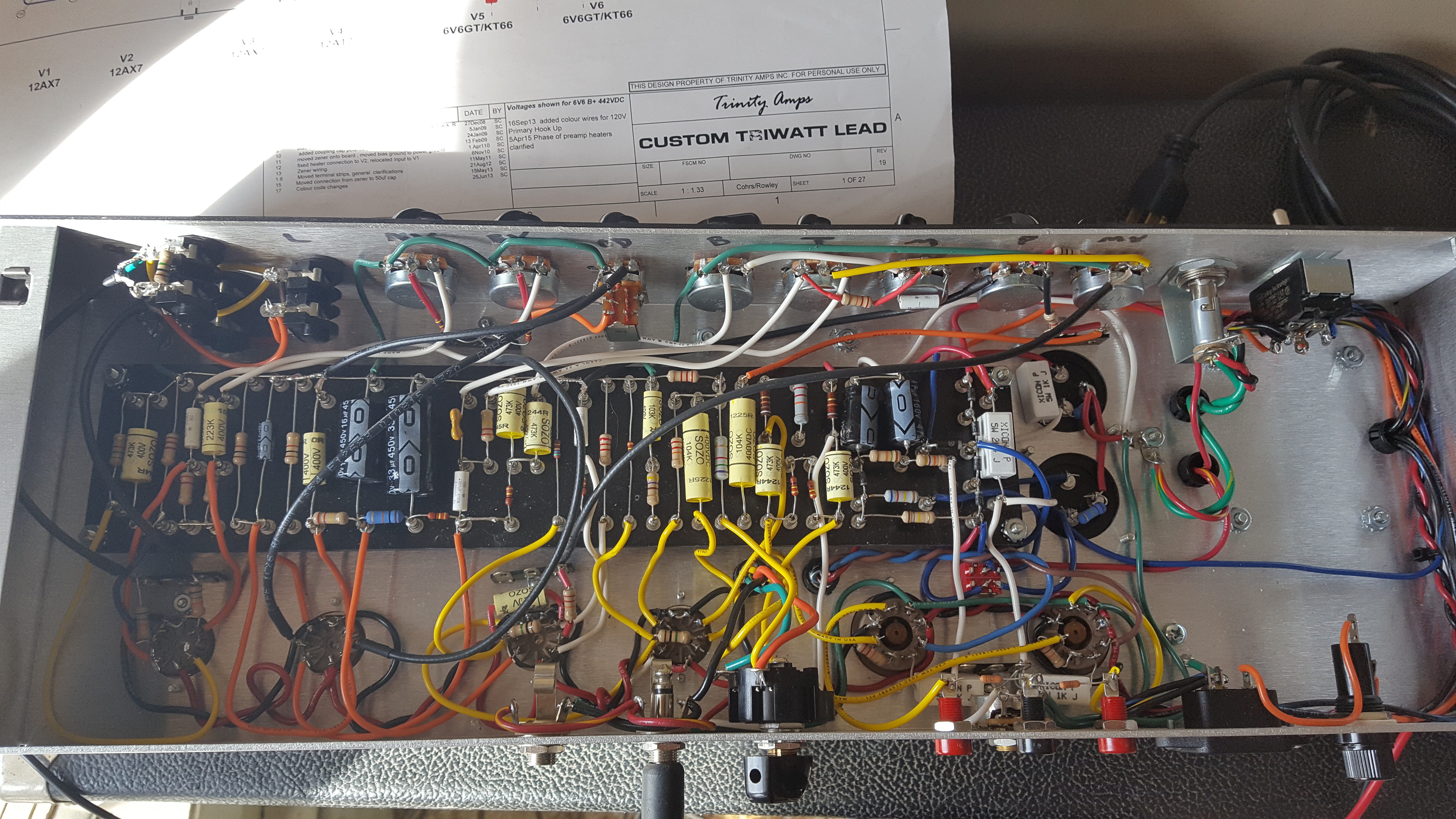

I know its hard to tell where the components are soldered on the tube sockets. I have checked all the connections over and over again. Everything is where it is supposed to be.

I disconnect the master volume from the v3 22k resistor on pin 7 and now it continues to hum all the time, so it seems the issue is before the master volume. I was thinking maybe it had something to do with shielded cable but no luck.
