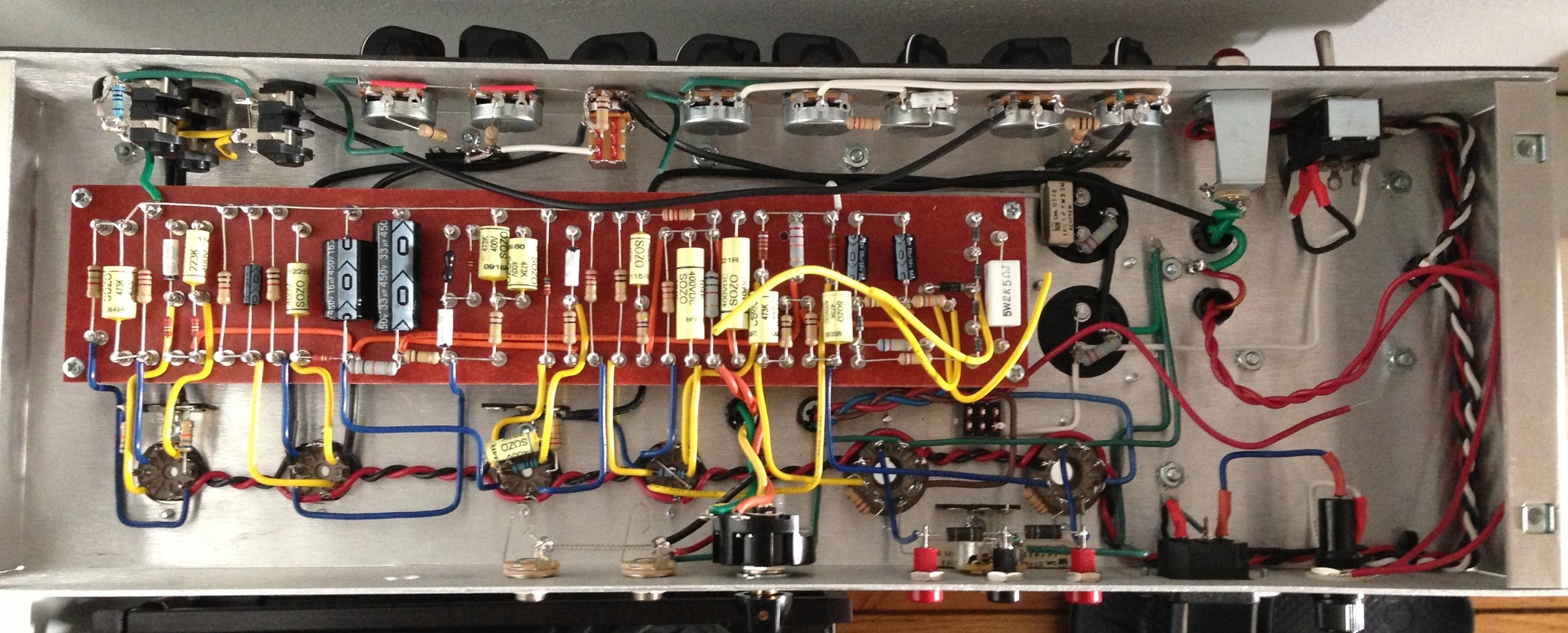

After unexpectedly moving I have finally found some time to start on the build. This is my first amp build so if you see anything goofy please let me know. I have built a couple pedals and am a profession luthier who has been looking to build an amp for the past 5 years. I'm pretty good with a soldiering iron and can get pretty anal on details.
Here is my current progress. I have all the tube sockets wired up and all the caps and resistors in. I'm pretty happy with how it's coming. Thanks a lot to zaphod for his build picks they have been very helpful.
I'll have some more time on Thursday to work on it. I can't wait.

I can't comment on how it goes together but I can say that is a very nice and professional looking build.
I'm about to embark on my 18 watt build and I sure hope it turns out as neat as yours is.
How many hours do you have in the build so far?

Thank you so much.
I probably have about 12-15 hours into it. I'm taking it nice and slow as it is my first I really want it to come out nice.
Good luck skip jack on you 18 watt. I was torn between one of those and the Triwatt. The Triwatt obviously won in the end. (Big Townshend and Gilmour fan) I still think I will do an 18 watt at some point.

Looks excellent. Keep it up and I'm sure you will have a winner there!

Work looks awesome. Love the crisp corners on the wires.

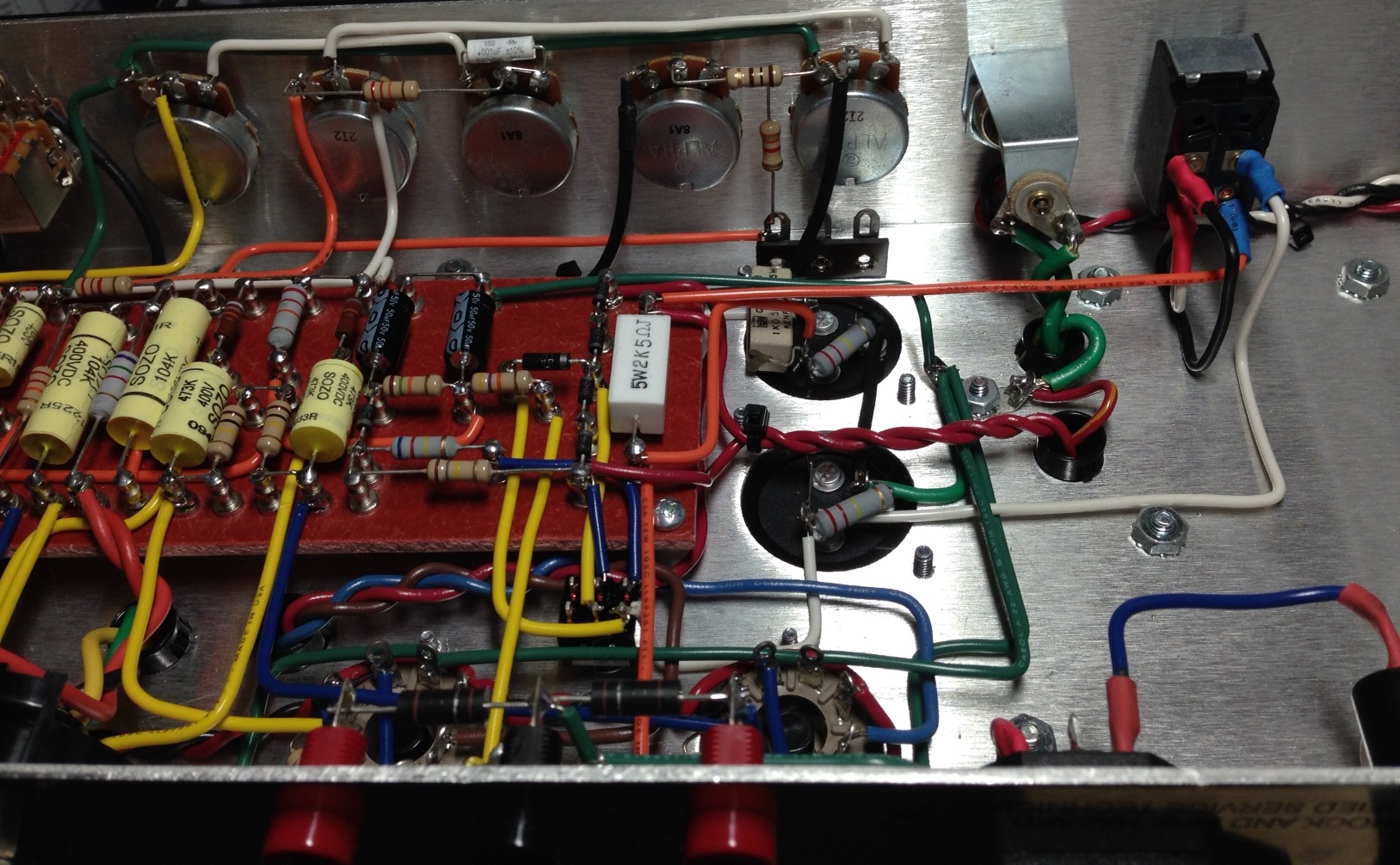

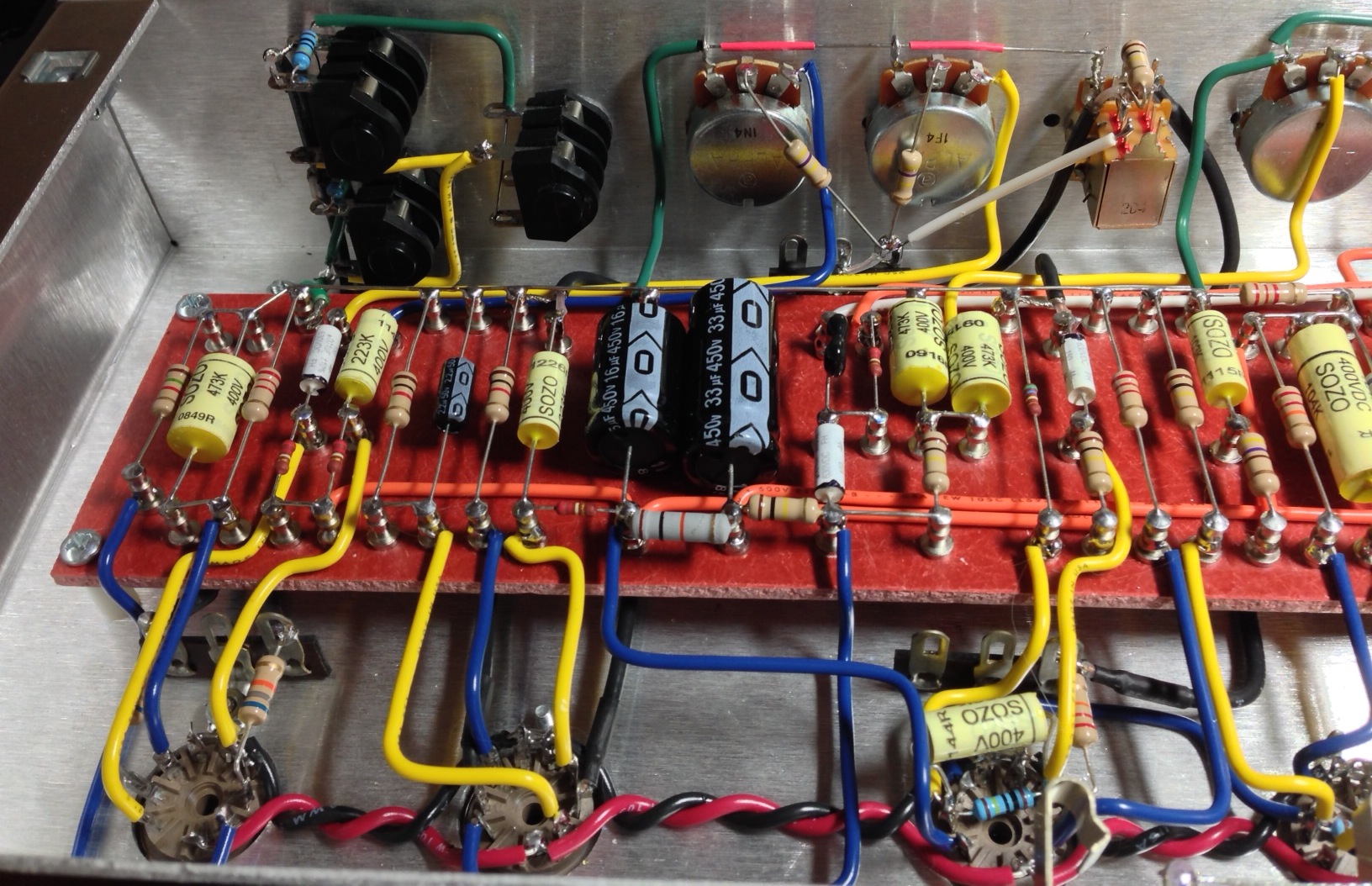

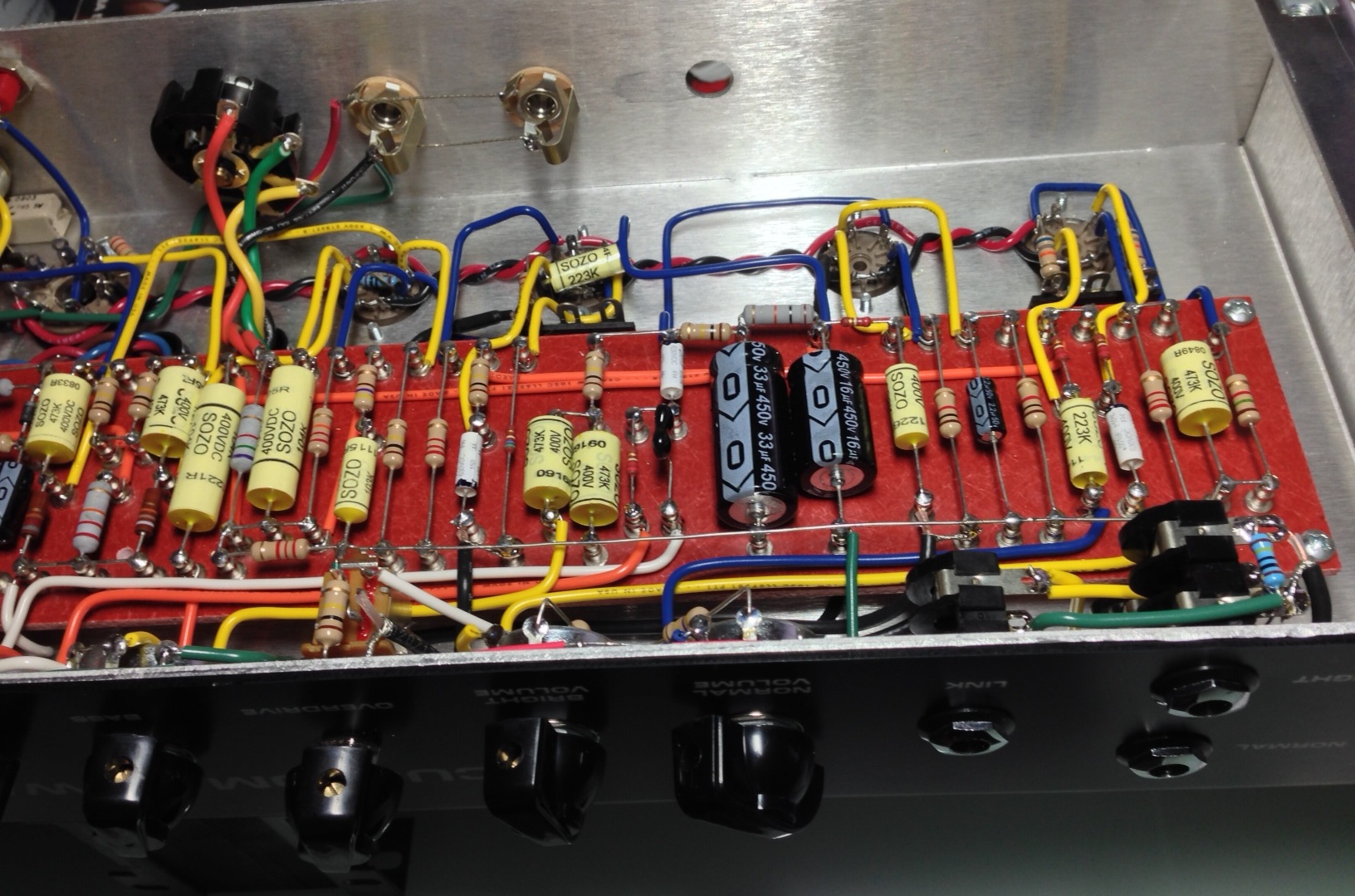

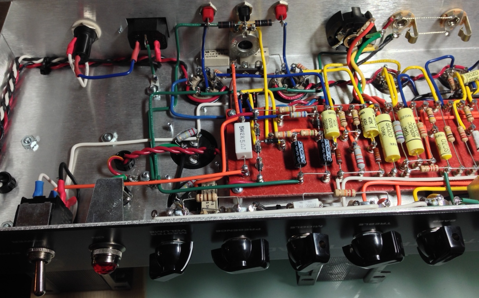

So I just finished the power up steps and it lives!!!! It sounds awesome. The cleans are so dynamic and rich. I love it!!! Only thing is the presence knob doesnt's seem to do any thing or maybe it's very subtle. I will get some pictures up soon. The other issue when you turn the Treble knob all the way up it cuts out. I figure it's just the pot is damaged or something.

Quick update:
For the bias switch I have it switched towards the Power trannys that is the right position for 6v6's?
No problems at all with the overdrive it sounds great!!!
I retouched the connections for the presence control and I think it's working it's just subtle.

Did some more poking around and answered my own question. My bias switch was set for kt66's. With it switched the other way the bias range is 13-27ma. The V2 pin2 is .5 but the pin7 is still -12.5. Every thing looks good and seems to check out ok. Also for V5 and V6 pin8 are still high at 23.3 and 19.9.

Pins two and seven in 12AX7s typically have no DC component excepting the phase inverter. In this case everything seems to be fine and normal in your Amp.
I don't really know why you're getting -12 V on pin seven that's pretty strange because of feeding from the positive plate voltage. Could just be the measurement.
The presence control is subtle but check if it is wired correctly.
