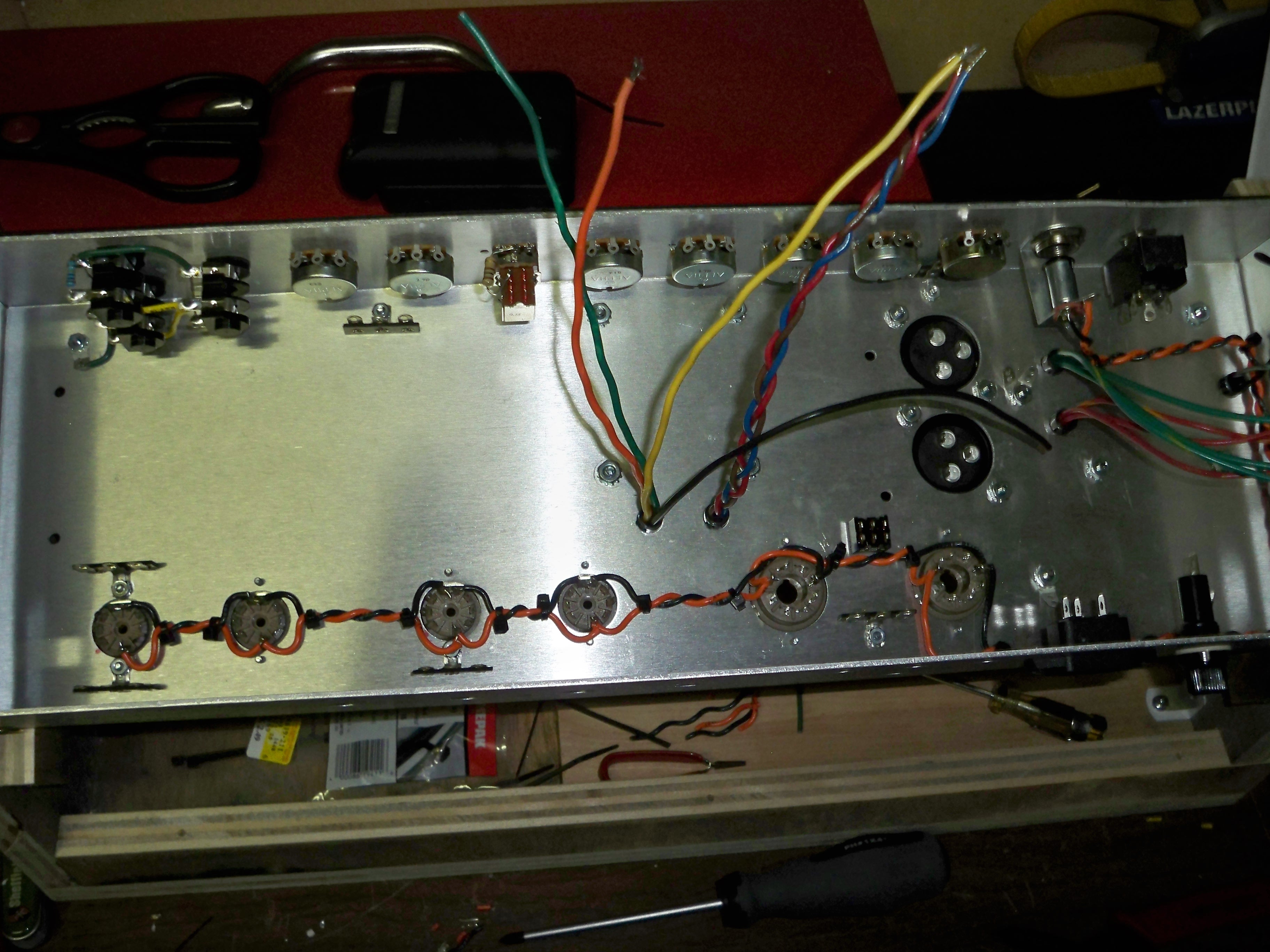

Thought I'd try to upload a photo of my work so far. I'm no computer genius so I'm not sure if this will work. If it doesn't maybe someone can tell me how to get a photo onto my post.
 Post subject: Re: Heater wiring
PostPosted: Thu Mar 15, 2012 3:16 pm
The pix and the wiring lokk fine to me :thumbsup:
PostPosted: Thu Mar 15, 2012 9:16 pm
Posts: 81
Looking good! Tying the twists is a nice touch. :thumbsup:
