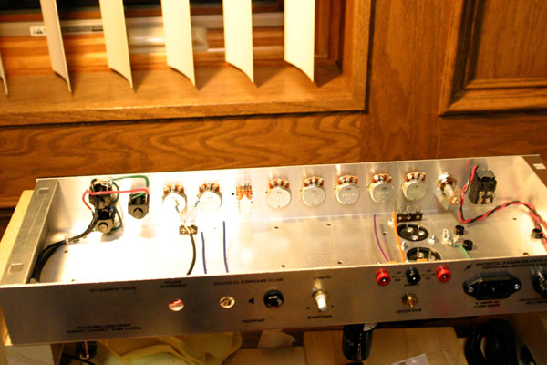

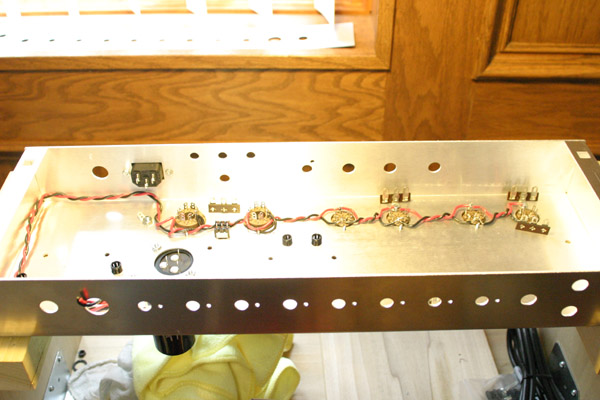

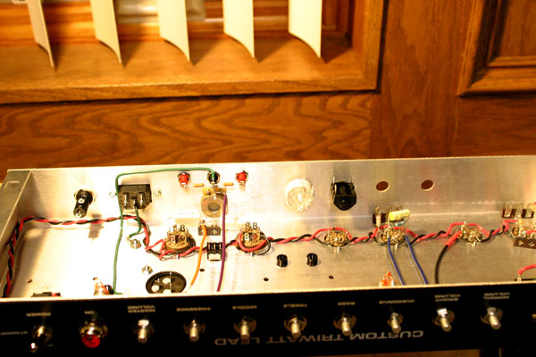

A few pics as I begin. Sorry for the poor lighting, I loaned my lights (AB400) out to a guy and need to get them back!

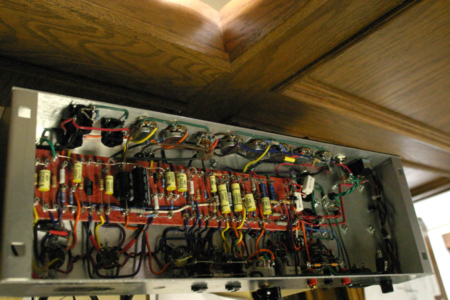

Posts: 81

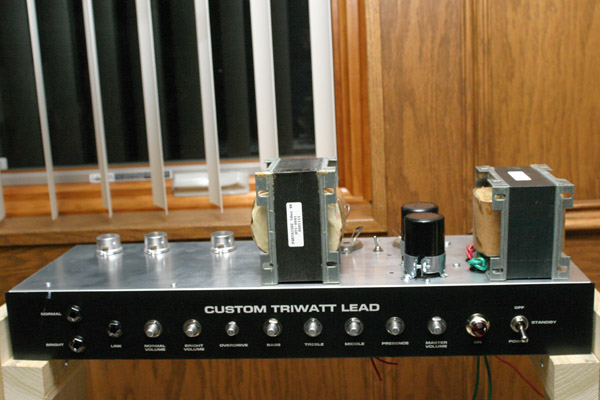

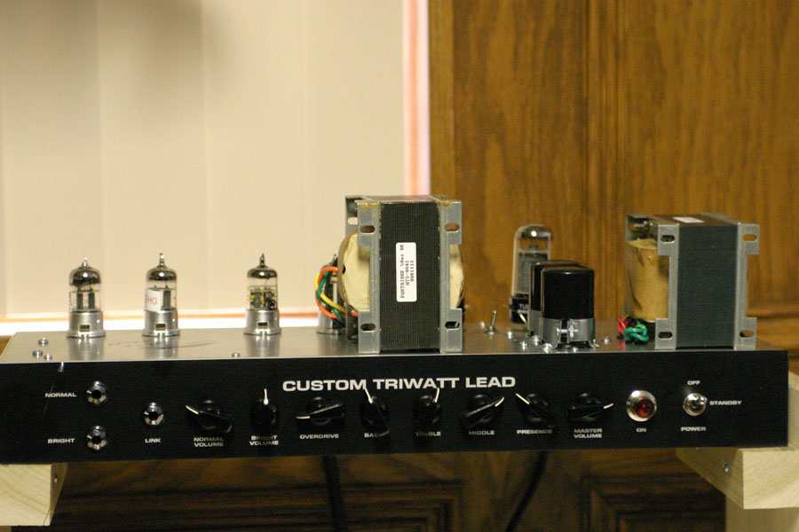

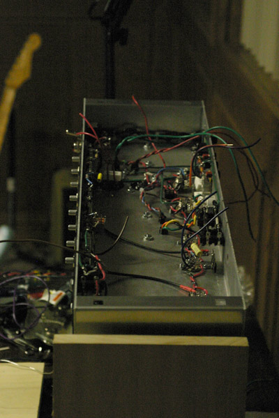

OK, a couple of pictures. I found my trusty Canon 500EX flash and managed a couple of shots before the batteries went TU. I'll get more batteries or even better, get my Alien Bees lights back. I know, the first shot (under exposed) looks like a spaghetti mess but it's OK, I know where I'm going (at least I think I do). This amp carries some serious iron!

Posts: 81

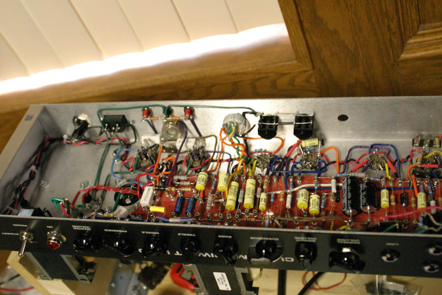

Success!!! I powered it up today. :thumbsup:
Had one mistake that was apparent when I checked voltages. Took me a while to track it down, I had the jumper lead from the 16uF positive end to the wrong turret - it was on the 1K resistor instead of the 220K. If I hadn't put the jumpers on top of the board it would've taken a bit longer to track down. Sometimes I get so engrossed in building I don't want to stop. In this case it means I didn't take photos along the way. Oh well, there's plenty of good looking build photos available.
Played a while tonight, it sounds great. Very little noise unless I have the boost up around 11 o'clock - it starts to hum a bit from there. I'll need some time to tweak settings before I decide if it dethrones the 18 Watt sIII as my number one.
 Post subject: Re: Build Begins
PostPosted: Sun Jan 22, 2012 12:07 pm
Posts: 81

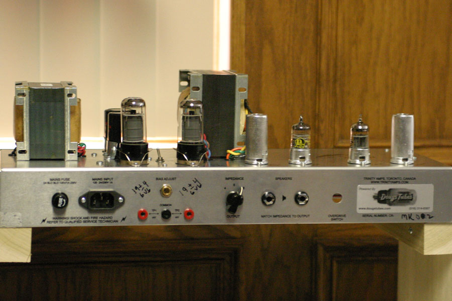

A few pictures:

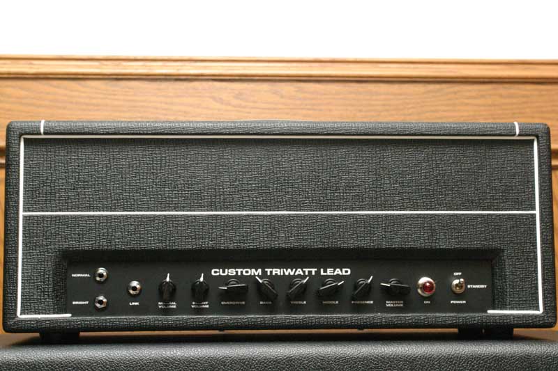

Another front shot.

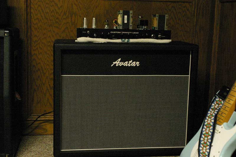

FedEx dropped off an Avatar G212 Vintage cabinet loaded with Hellatone 30 and 60 speakers today. The Triwatt through this cabinet is awesome. The efficiency of these speakers makes for a loud rig! The sound is sweet, I'm already thinking about building another for a friend that gigs four nights a week.
