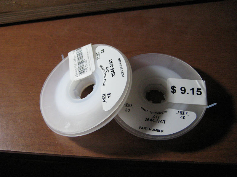

Look what else the man in the big brown truck of happiness left on my doorstep -
Teflon wire sheathing - both 18 and 20AWG
I'm still waiting for a few other parts to come in as well - I realized a few days ago that I have about half of the resistors in this kit in super cool 1% Dale metal film. So a quick Mouser purchase later and I've got the rest coming to match. Nothing wrong with what came with the kit, but I have a thing for those little brown guys. They manage to look retro and futuristic at the same time, plus they are the lowest noise resistors I've ever seen. I'm keeping the carbon comp in the last preamp stage for the extra "mojo" though.

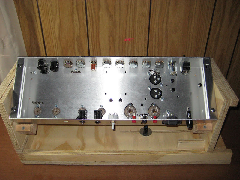

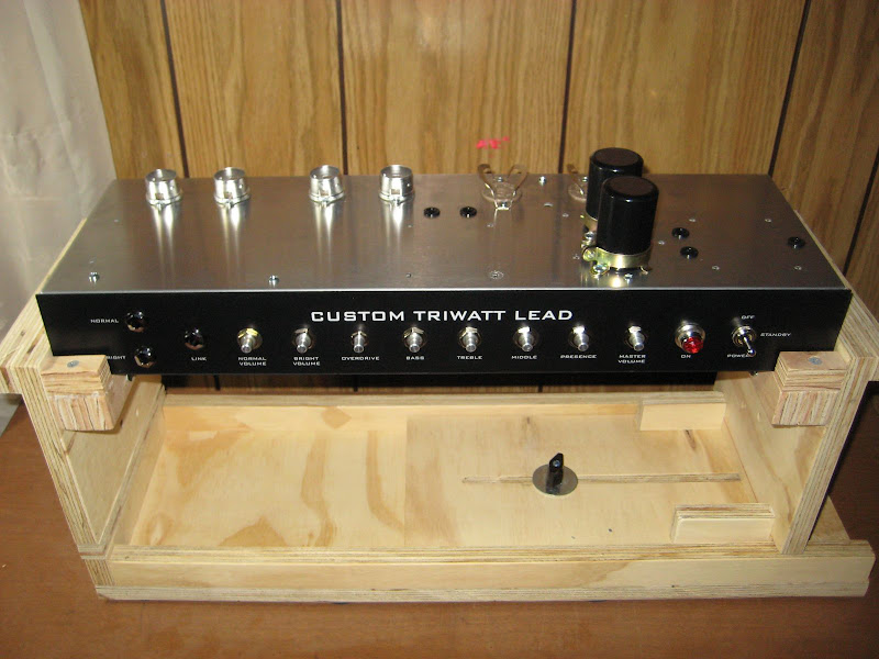

Got most of the hardware mounted - transformers tomorrow.
Gut shot with no guts
Yum. That's a purty face plate.

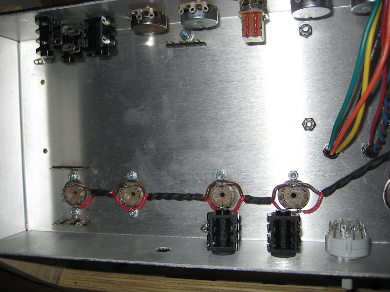

Any how, I've got the heaters wired
And the power input done
Yes, I have a serious fetish for shrink tubing :^) Once the lead dress is finalized I go back and tack the wires down with a dab of silicone as well. Woo hoo!
I might get a bit done tonight, but I really want to get the turret board in place first so I can visualize the rest of the wiring. Come on big brown truck!

Well most of us are :lol: Nice work ! Think I may have to get my self some irons and a chassis. Btv were did you get the Teflon wire sheathing from?
http://www.burningheart.com/_lib/util/s ... =2517&s=hi

malt wrote:
disconnector wrote:
Plus I'm a big fan of worthless overkill :twisted
The teflon sheathing came from Action-Electronics - great prices and very fast shipping http://www.action-electronics.com/ptfetube.htm?zoom_highlight=ptfe

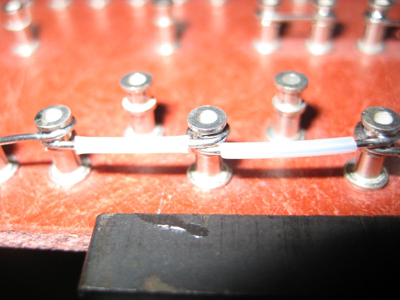

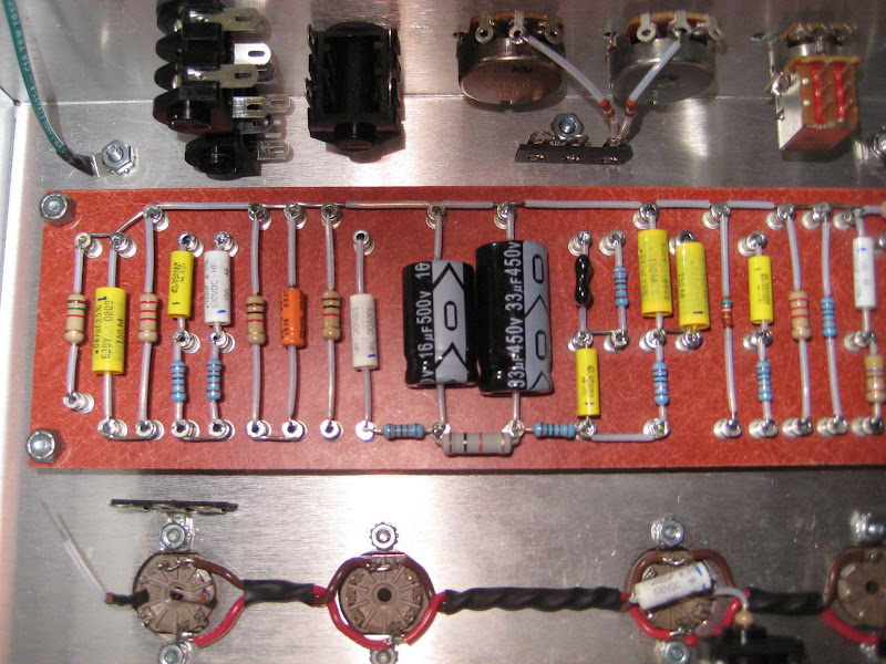

A bit more progress -
Bus bars with teflon sheathing

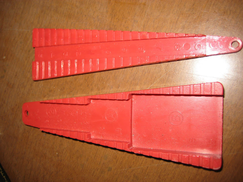

I love my lead forming pliers. They make great bends. I got them from Sears a long time ago.
These lead forming plates work great as well. Please don't ask where I got them - I have no idea and it's been many years.
Bias section is done - I'll fill the turrets once the off board leads are in place
Lot's more to do, but the beauty of a hobby is that I don't have to hurry :D

Disconnector, even though the Teflon doesn't (technically) burn at standard soldering temperatures, try to avoid bringing the sleeving into the solder joint. The target clearance should be approximately 1x lead diameter (including insulation) with 2x being the maximum.
The only other thing I would suggest is maybe a bit more solder on your turrets, otherwise looking pretty good. Heat shrink? Eeeekkk!!!!!
OOC, How are you planning on stripping the Teflon coated wire?
Joe G
Yeah, I'm not extremely happy with the sleeving so far. I've got to get back into the groove of this. I'm going to fix this with a razor knife tonight and move the teflon back a bit.
The turrets are just tacked right now. I'm going to get the offboard wiring done first and then fill up the turrets so no worries there. I want to be able to connect everything from the top.
I don't have any teflon wire - its just 18 and 20AWG PTFE sleeving. I've got a pair of teflon strippers though :wink:

You can get those lead forming plates from Hoffman Amplifiers. Seem like a useful tool. Do you use the tool for all leaded components?
(another BYOCer here, I'm ChrisM over there).
Cool on the BYOC connection. I LOVE their stuff - totally high quality at a reasonable price. It's why I'm loving Trinity as well :D I've got a Overdrive2 in the mail and a spot on the CC for a 5 knob compressor as well.
I use the lead forming plates quite a bit. I've got an old pair of polyamid calipers - quickly measure the distance between the turrets, find the equivalent spot on the lead forming plates, a quick bend and your done. As Joeyvelour noted, I'm not an expert on getting the teflon sleeving on yet, but I'm working on it.

Stanley Supply is a great tool source as well
http://www.stanleysupplyservices.com/
I use a ruler and a razor blade :lol: I do have to finish that V6 one of these days :roll:

Just for the sake of overkill.... Watts Tube Audio (aka Turretboards.com) has those lead benders too.

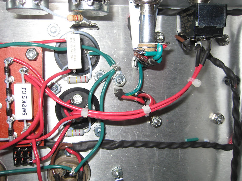

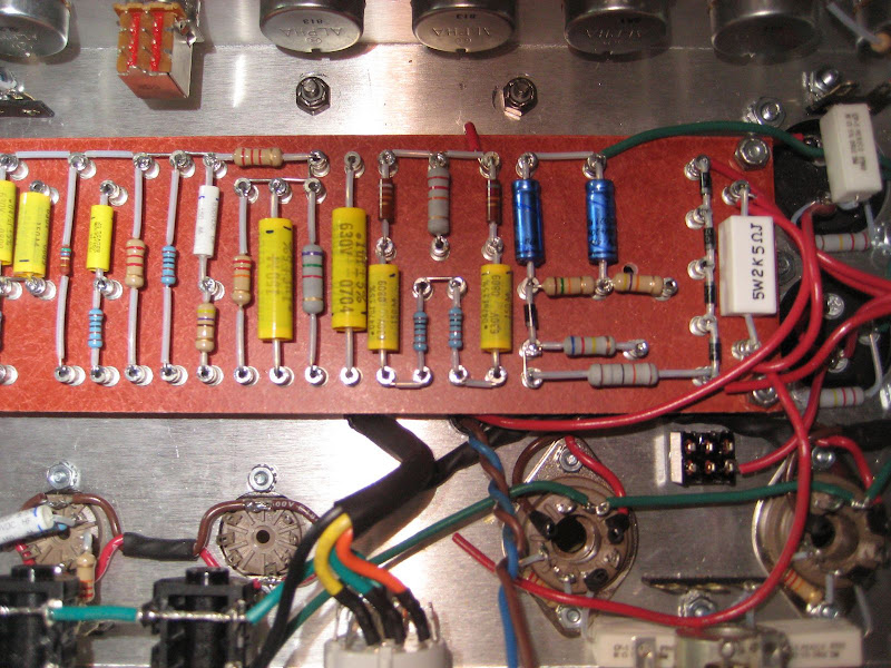

A bit more progress . . .
Most of the primary power wiring is done. Still a few connections to go.
Here's tonights project. I'm going to knock out the input and preamp wiring.

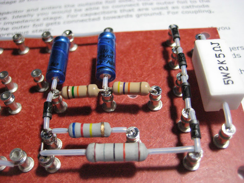

Also hoping to get the bias circuit wired tonight. It took me a little while to figure out how the 6V6/KT66 switch worked from the schematic - that's freaking ingenious!
Here'a a pic of incomplete bias section - hopefully it will get done tonight if the kids will leave me alone a bit (yeah, good luck)
I wish that I had more than an hour of consecutive time to work on this thing, but it will be done before 2011 rolls around. I hope.
