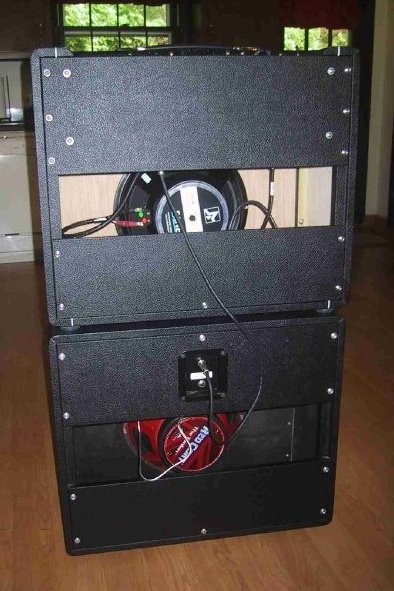

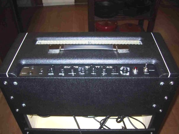

 Post subject: Links to Combo Pics
PostPosted: Tue Jan 26, 2010 8:20 am
Posts: 158
Location: CONNECTICUT
Currently the Fane AX12-150 is in the bottom cabinet, & a Weber_Axis Ceramic 12" is in the Triwatt's Cabinet.
ROB
PostPosted: Wed Jan 27, 2010 2:28 pm
Nice job. I'm sure it sounds as good as it looks too!
PostPosted: Wed Jan 27, 2010 9:21 pm
Sure looks nice!
Yes, by making the combo Bluesbreaker style, you do away with needing to mount the amp chassis upside down, like you would in a classic Hiwatt-style combo. Then you don't need the special upside down faceplate and rear panel either.

The Bluesbreaker style combo looks awesome (where did you get the cab btw?), but I'm not a big fan of horizontal burning tubes, especially forward facing and tucked underneath like that. Access to the tubes is difficult and it has to get toasty hot under there. I can also see some potential mechanical issues involved with transporting the combo right side up having the tubes cantilevered straight out like that. The pre's should be ok in the shields, but I wouldn't rely on spring retainers or bear claws to hold a tube in place when the sound man is driving the band truck :lol:
Maybe stick with transporting the amp on it's back in the trunk!

I got the Cabinet from Mather Cabinet. It's an 18 Watt Marshall Combo Cab with a few design mods. The speaker might sit a little lower and the dim's. are 24" W x 20" H x 10 1/2" D, with an 18" cutout for the control panel.
It stays pretty cool in there. A lot cooler than an Ampeg V4 I had in the 1980s. I have changed preamp tubes without much hassle. I do have to look at the pin orientation as you are pulling the tube out, before you install the next tube.
