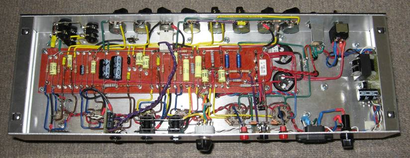

Input jacks installed and wired up. Board installed. Shielded wires to tube sockets will come later, after the other connections have been done.

Here the preamp/PI tubes have been wired.
Note: A couple or so resistor leads on the board got slightly bent while I was connecting the tube sockets, which I straightened after this picture was taken.
Next, to connect the front panel controls to the board and do all the shielded wire connections.
Speaker jacks are also in place now. There's a 100k resistor temporarily soldered directly onto V2 pin 2, which the shielded wire from the Overdrive control is connected to. This allows me to test the amp with the Overdrive engaged. This resistor will be removed when the relay board is installed, as there's a 100k resistor on the board itself. The twisted purple wire will also go to the relay board.

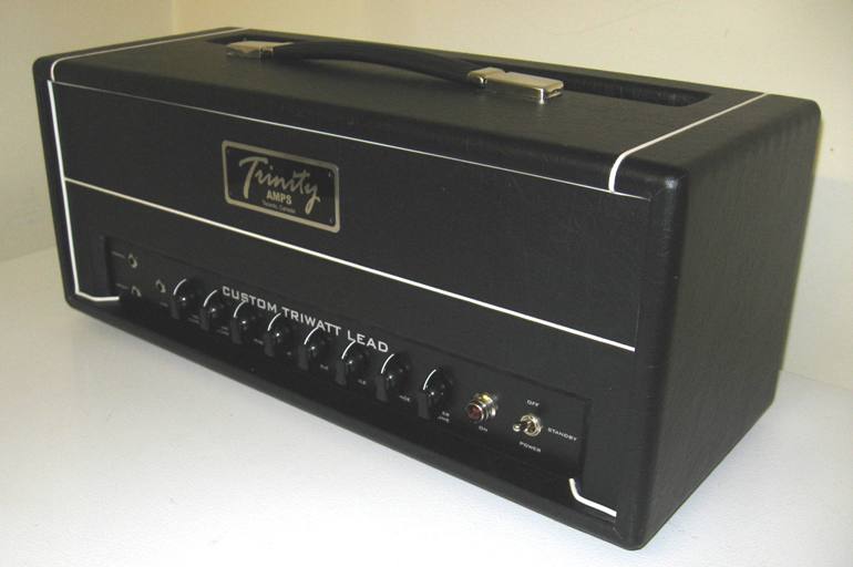

All set to go to Singapore with 5V regulated PSU for the footswitch and the relay board in place.
All sewn up. Not the traditional tolex, but pretty slick looking.

love your lead dress, i hope to make mine look as good as yours when i buy my kit.
How is it putting the shielded wire under the board, is their very much noise with them so close to other wires?

The amp is very quiet with the lead dress as is and with coax under the board. It seems to not be susceptible to extraneous noise whether above or below the board. In # 2 amp, some coax was above the board and it was quiet as well.

Just be real patient, and don't rush the job. My gut shots should help give you some guidelines to use as a basis for your own build, although I'm still perfecting the way I build these amps.
No, because they're shielded. The fact that they're laying close to the chassis is also a good thing for noise. In fact the non-shielded wires above the board were expected to be more of a challenge, but they seem to have turned out fine.
