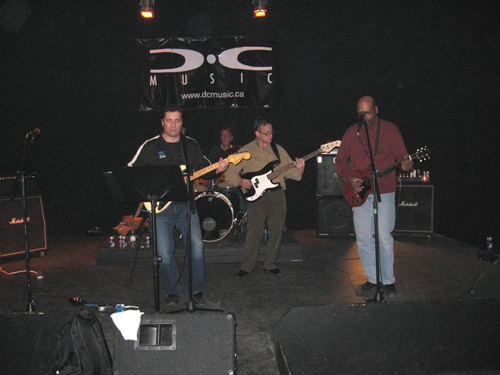

PostPosted: Fri Mar 13, 2009 12:14 pm
Stage Set-Up
Settings with 12AX7 PI & KT66

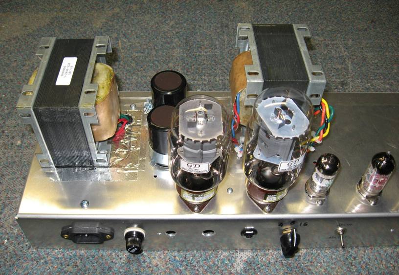

PostPosted: Fri Mar 13, 2009 1:30 pm
Boy - the KT's look absolutely HUGE!
PostPosted: Fri Mar 13, 2009 3:06 pm
Yeah, the band thought I should make a plexi glass case for it just to show them Bad Boys off!
PostPosted: Fri Mar 13, 2009 3:07 pm
Yeah, real big fat b*stards with a big fat tone. :D
KT66s with a 12AX7 PI and the MV turned all the way up. That's loud!!! :shock:
PostPosted: Fri Mar 13, 2009 4:13 pm
That was for the last song of the night. Some wailing Hendrix style playing! Most of the night it was about half plus way and it was all good!
