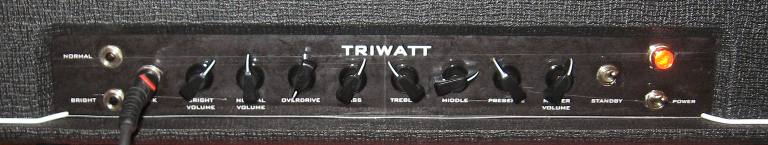

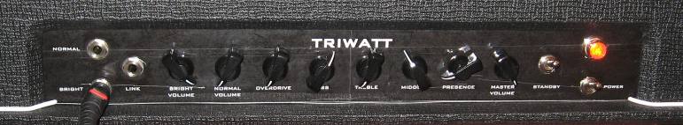

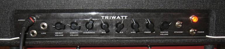

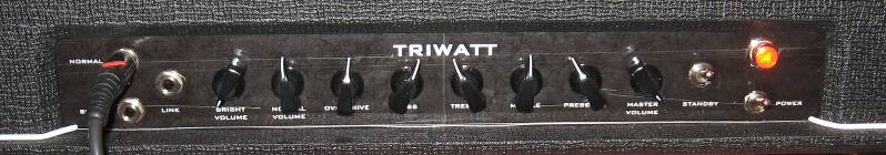

So, that's all I can think of for now. If you have questions, ask. I'm uploading the clips for Stephen tonight and he has the photos of the panel settings to go along with the clips. As you can see, pretty radically different settings yield widely usable tones on the Triwatt. More clips to come - I've got this thing for a week so I'm going to try to get some more players in here to give it a whirl. For the next round I'm thinking I'm going to concentrate on dark, moody tones... :)
From this round, I think all the tones are pretty cool, but my favourite recorded tones are in clips 01, 04, 05, 10, 12, 13, 15, 18 ( 2nd half Greenbacks), 19, and 21 might be my favourite of the day! :) And 22 the low MV one is right up there too!! 8)

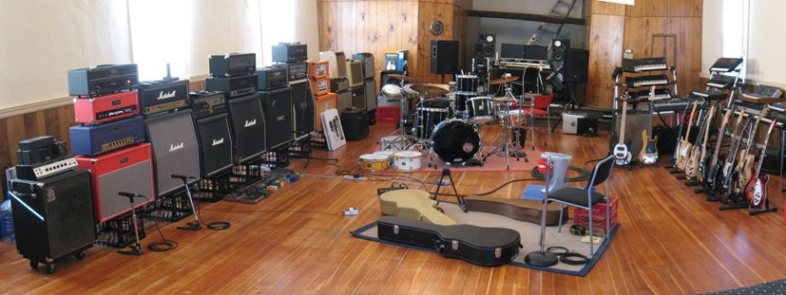

Thanks jcny!! :) It definitely can be a pretty ambient space, but it's certainly not out of control at all... It just sounds big in here. Drums are a thing of absolute beauty. :) And percussion!! The room sound on a tambourine track sounds crazy! Acoustic guitars are beautiful, and if you mic a clean spanky guitar tone from back a bit you can get a nice slap. On vocals, I need very little artificial reverb... 8)
