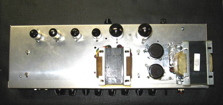

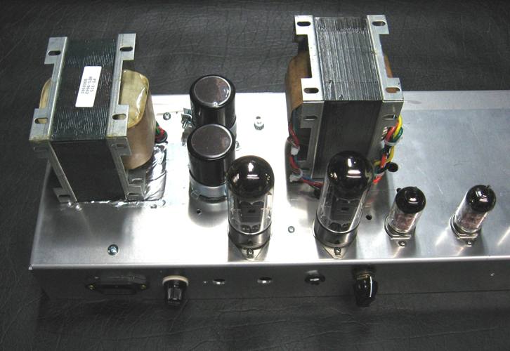

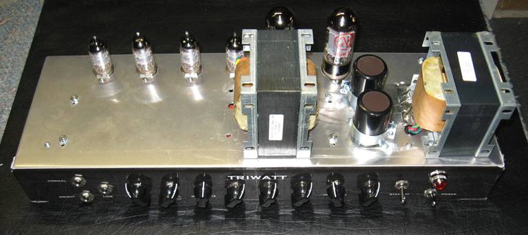

TRIWATT is up and working with new iron installed in the same locations for production versions. The 4 pre-amp tubes will be moved 2 more inches to the far end, for better pre/power amp separation.

PostPosted: Sun Jan 18, 2009 11:42 pm
Wow, those are some big chunks of iron :D
Careful moving the pre's too far into that corner, those of us with big paws and right handed have a problem working in that corner :P :P
Waiting for the test reports :D :D :D :D

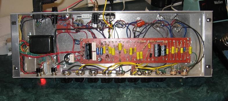

Looks great Stephen! How about a shot of the business section for us wiring guys :D

PostPosted: Mon Jan 19, 2009 12:48 pm
This is the first prototype amp, and the wiring below deck is therefore a little rough, especially after various mods, changes, tweaks, experiments with different grounds, transformers, etc. Stephen has also made some changes to the board, based on what we learned from this prototype. Components are now placed in a more Hiwatt-like rectilinear fashion, and we've optimized their placement for tidier wiring, minimal wire lengths, etc. We're also now using turrets instead of eyelets, there are now two cap cans, and we've altered the position of the power tubes to improve their spacing, relative to the transformers. So there is a gut shot earlier in this thread, but you'll need to bear in mind that the finished product will look somewhat different. :)
Edit: It looks like Stephen just re-posted that gut shot.

PostPosted: Mon Jan 19, 2009 12:50 pm

Inside View - Looks something like this old pic!
Not military style but considering it works, is a protoype, required some wiring changes etc. - not bad.
Neds an update pic with the new iron. We'll save that for #2 perhaps.
