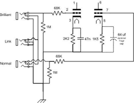

Just wondering about the linked inputs... I see the TRIWATT has a link for the Norm and Bright which is what is on the Gilmour signature Hiwatt.
On the old DR103's there were 4 inputs, of which I heard he jumpered.
Which ones did he jumper on the normal bright? and is this what the TRIWATT link has? I guess I'm asking cause Im sittin on the only peice of gear (Amp) I still have which is a 76 DR103 4 holer.

Wooah, you got the real deal!
In the TRIWATT, there are only Hi inputs so we have linked them.
PostPosted: Fri Jan 09, 2009 12:00 am
We have exactly followed Gilmour's input scheme. So you have a single Normal and a single Bright input - ie there are no Lo inputs. The 3rd jack, together with some clever internal switching, links those two inputs together when you plug into the Link input.

Somebody Asked. Here is the 3 input schematic:
