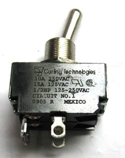

PostPosted: Sat Feb 14, 2009 12:09 pm
Progressive Switches are in!!
Carling quality, lots of current capacity too.

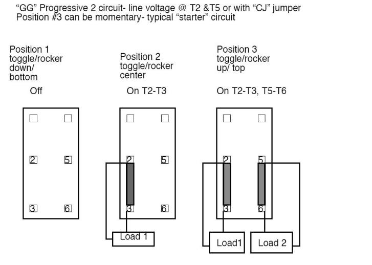

PostPosted: Mon Feb 16, 2009 10:52 am
Is it just a DPST (on-off-none)?
Two poles to make or break the mains. Two poles to make or break B+ and then the off position where both connections are open.
PostPosted: Mon Feb 16, 2009 12:56 pm
This is definitely not your common, everyday, 2 pole switch. This circuit is OFF-ON-ON
PostPosted: Mon Feb 16, 2009 1:28 pm
Posts: 432
Location: Massachusetts
So...
Position 1: both circuits open
Position 2: circuit 1 on (AC to amp), circuit 2 still open (B+)
Position 3: both circuits on
⫽ Yes
⫽ No
So B+ caps will be left charged and disconnected from the circuit upon shut off, no power chord to discharge the power supply caps?
This is sort of what I was asking above.

PostPosted: Mon Feb 16, 2009 3:11 pm
So is it two SPST switches with no common lug to either SPST?
PostPosted: Mon Feb 16, 2009 6:57 pm
X Yes
It does mean you cant turn the power off & drain with the Standby On so adding bleeder resistors is a reasonable thing to do. We used 220K 2W in the TRIWATT to do this from the supply caps.
