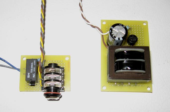

Just finished the first compact PSU for the relay. Very cute!!
PCB transformer, Bridge rectifier, 9V supply with 1000 uf filtering.
If it's noisy, I have a plan for regulation that will fit on the board but I did a test external supply without regulation and it was fine so ...

So are you going with a regulated power supply in the chassis? I am thinking that it would be the easiest and noise free way to do it. Too bad the use of the rectified heater supply is too noisy. That seemed an elegant and convenient way to get the power for the relay.....

Relay Board -------------------------------------------- PSU Board
Size of the PSU board is about 2" X 3" ; Relay board half that.

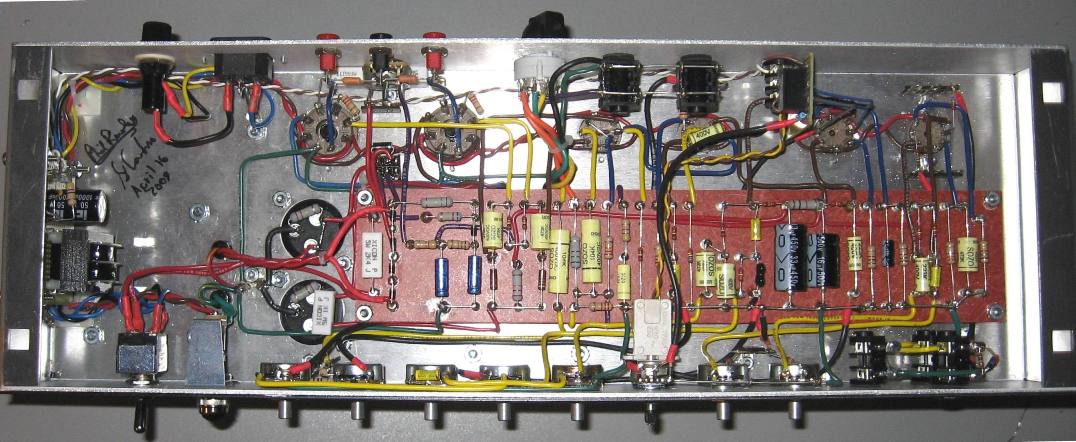

Installed & Working.
Zaphod came over and we wrapped up #2 up today. Made a small housekeeping mod to the PSU to hopefully make it less susceptible to flourescent lights!
I's working - footswitch and all. :D
Might try a regulated PSU simply as an experiment on #3.
PostPosted: Sat May 23, 2009 4:08 pm
The new switch circuit worked better than all my expectations. It's real quiet, without hum or buzz. It switches both from the front panel or the footswitch, without pops and clicks. And with the boost engaged, at least with this amp, the amp's already very low background noise level actually decreased! This was something really unexpected, and I wish I could pretend it was deliberately designed in. :) All I can guess is that some kind of a phase cancellation effect is happening here, which is reducing the noise level.
