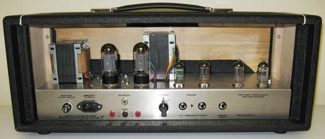

keto - might have been easier as well for the screws/wire to get through if you stand up the OT on one of the ends like below. I think the mounting holes are spaced for this orientation:
looks like this fellow didn't care for tube shields either!
PostPosted: Mon Dec 10, 2012 12:25 pm
Joined: Tue Nov 27, 2012 9:11 pm
Posts: 43
Yessir, I did that last night - but not for the reason you give. I was told to do so to get the windings to not be parallel on each transformer, for potentially less noise. I have a pic, but the OT is rotated 180 wrong in the pic - wrong colour wires thru the wrong holes, a problem I had previously fixed. I fixed it but was too pissed to take a pic - must have had the transformers off 5 times yesterday lol.
