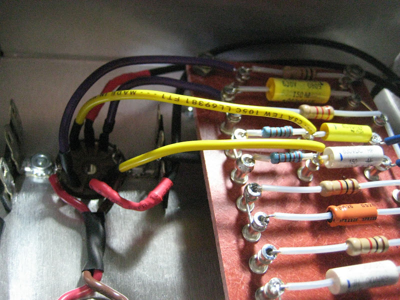

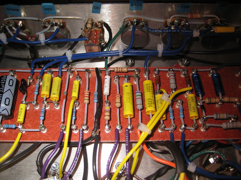

As far as the build goes- I've completely rewired the power and bias section from the previous pictures. It's much neater now.
I have to clean up a few solder joints and the power and bias is pretty much done.

A few updates . . .

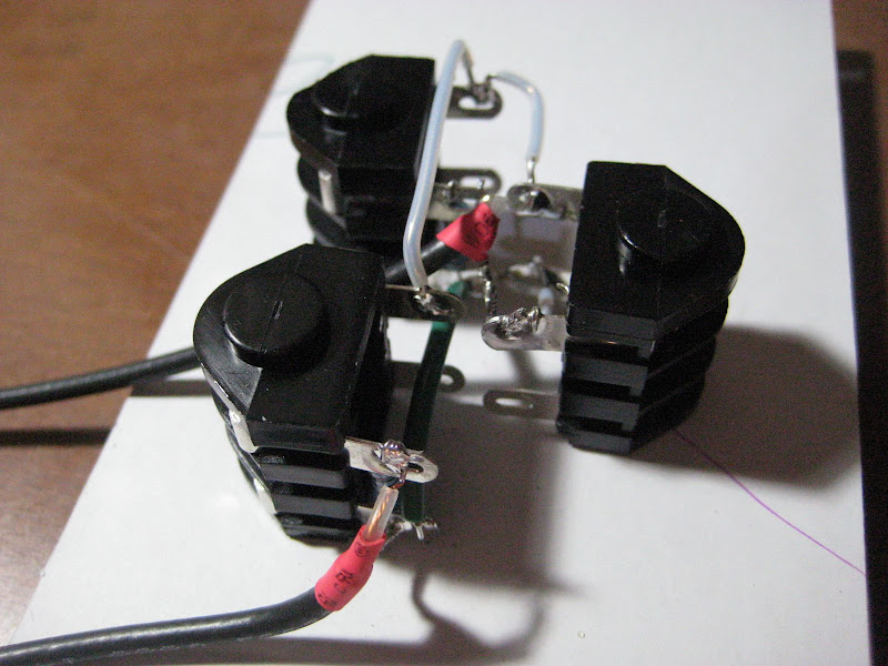

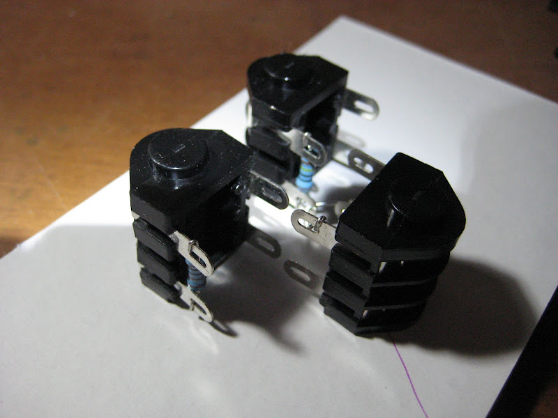

I build a cardboard template to hold the input jacks for soldering. Waaaayyy easier that wiring in place.
All done . . .

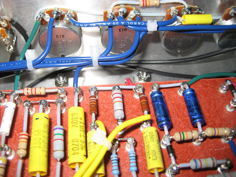

Volume controls and overdrive wired up. I label everything from the back to keep from screwing up (and more than usual)
Preamp progress. The shielded cable from Stephen is great!

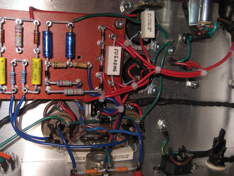

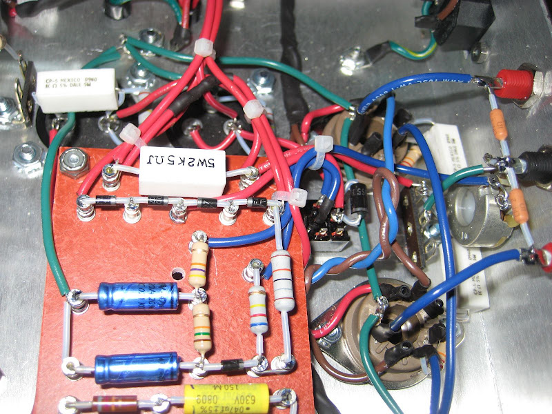

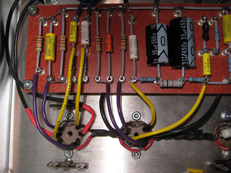

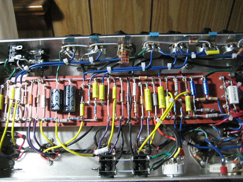

Finally done!
I had to get a bit more wire from Stephen due to a couple of rewires that I did. Plus my job has been maniacal lately. Anyway - she is done and pumping out pure tone!
Here are a few pics -
She fired up on the first try and didn't even need lead dress. No oscillations, squeals, or hum at all. I mean ZERO noise other than typical self noise from the tubes if the overdrive is cranked and the master is wide open.
