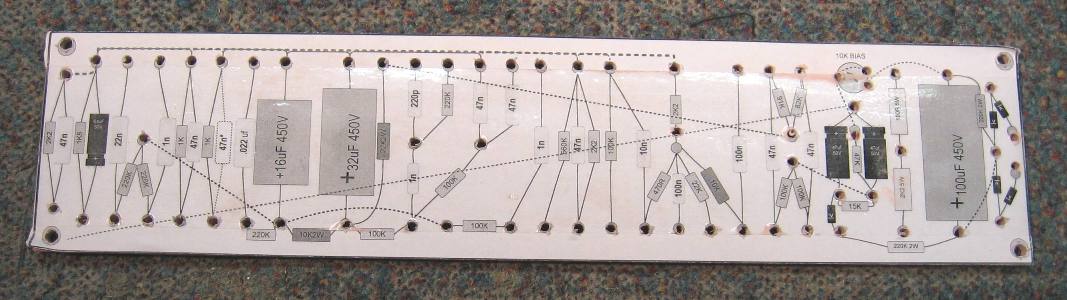

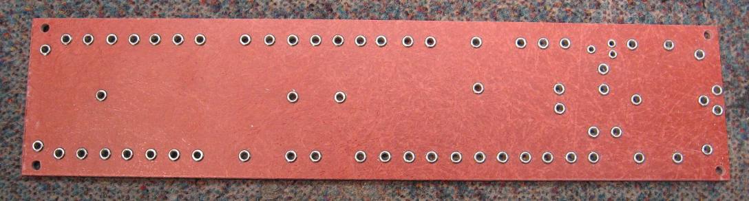

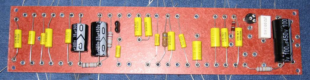

Mask For Triwatt Prototype Eyelet Board
Triwatt Prototype Eyelet Board Progress - not soldered

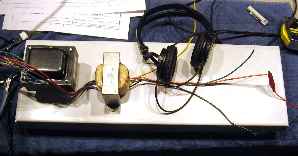

Working on the chassis iron layout with the headphones.
Turns out both transformers , on-axis 4" separation or greater is quietest. If I moved the PT off axis, I got hum in the headphones.
Good thing the OT is 6" away in the prototype layout. Time to punch up the chassis.

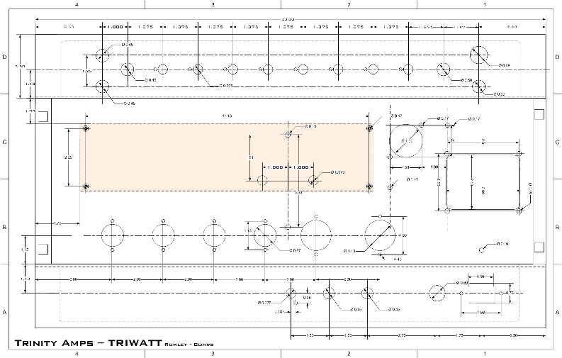

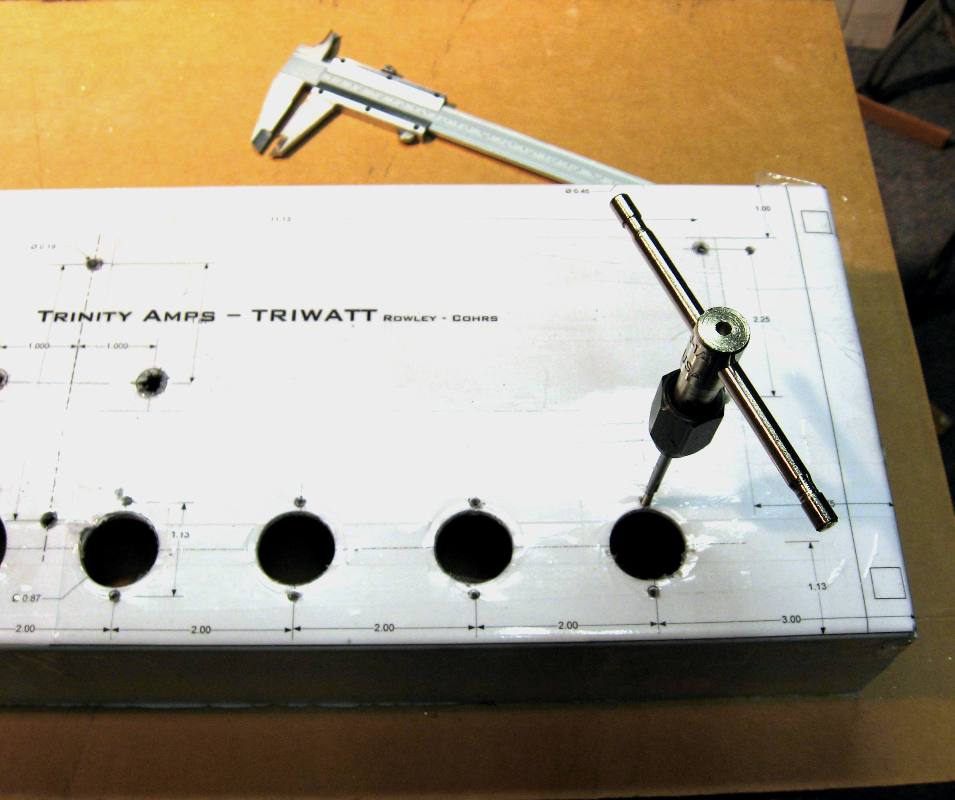

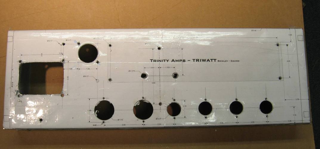

PostPosted: Sun Nov 09, 2008 7:29 pm

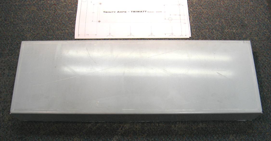

Bare chassis
Template taped onto chassis. Ready to go.
Chassis Punched. Tapping Socket Mounting Holes
Top of chassis completed.

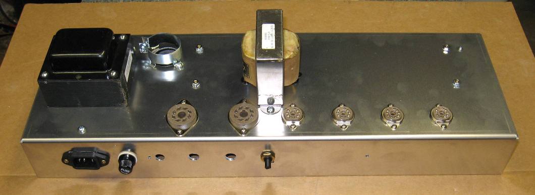

PostPosted: Mon Nov 10, 2008 8:18 am
Chassis Front
Chassis Rear

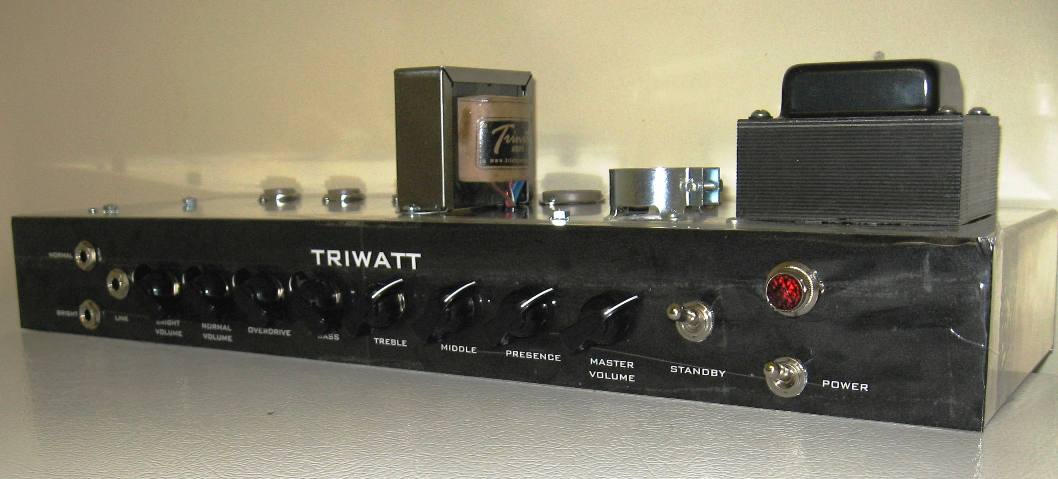

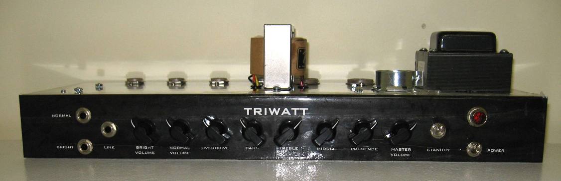

TRIWATT Prototype Front

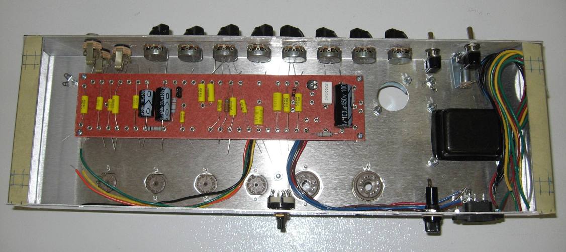

TRIWATT Prototype Inside View
PostPosted: Mon Nov 10, 2008 10:37 pm
DAANNGG!!! that looks GOOD! :shock:
Waiting for a report on how it sounds :D :D
From the looks, should be sometime soon :P :P

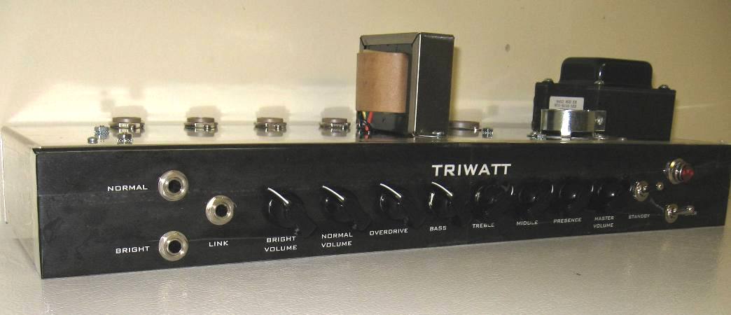

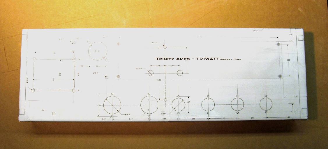

We still need some parts but getting closer. Mocked up the panel to see what that would look like. What do you think of the panel design?
PostPosted: Tue Nov 11, 2008 12:54 am
Fack that looks awesome! I want one!!!
Love the front panel.
How do you decide where the x-formers go with headphones btw?
PostPosted: Tue Nov 11, 2008 6:59 am
I like the front panel :P
First thing that struck me was the layout of the three inputs on one end and the power, standby and light on the other really reinforces the Triwatt name / theme (if that makes any sense to anybody :roll: )
How are the bright vol, normal vol, overdrive and master vol interactive?
PostPosted: Tue Nov 11, 2008 8:04 am
From AX84 FAQ
What is the headphone trick?
This is the best way to find the quietest place to put a reverb, output, driver, or any other signal transformer to get the least hum. CAUTION: THIS INVOLVES WORKING ON THE AMP WITH WALL VOLTAGE PRESENT. WALL VOLTAGE CAN BE FATAL.
First set up the power transformer. If it's not installed yet, all the better, but if it is, this will still help. If the PT is not installed, wire up the primaries to a power cord, but do not wire up any secondaries-- tape the ends of the secondaries. If the PT is installed, fine, just make sure there is no circuit on any of the secondary leads (pull all tubes, and disconnect leads and tape them as necessary).
Now set up the signal transformer (output, reverb, whatever). Hook one set of OT secondaries (your choice, but I usually go from ground to the highest impedance tap, don't worry about impedance matching here!) to a set of headphones. Tape the primary leads.
Put the headphones on, plug in the power cord, and start moving the signal transformer around. Try it all over the chassis, and also rotate it. While you might expect the least hum with the transformers as far from each other as possible and at right angles (and that may be the case for you), it might come at an odd angle and/or position. Sometimes the least hum occurs when the transformers are side by side. When you find the quietest spot, use a permanent marker to mark where the mounting holes should be.
If you have more than one signal transformer, repeat this for each one. When you're finished, unplug the PT. That's it!
