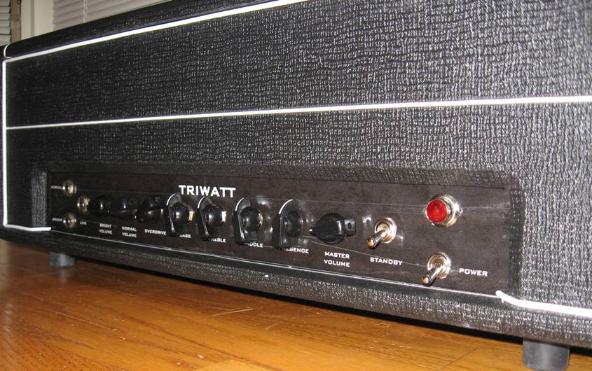

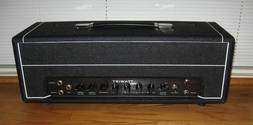

Today Phil & I worked on the TRIWATT again. It was a day for last minute changes and tweaks before the trip to bgroup studio. This was actually the first time I had a chance to hear the TRIWATT so Phil plugged it into an original Greenback 112 and off we went.
First off - this amp is loud. For a 20 watt amp and a 112, very loud. A more effiecient speaker boggles the mind. I was quite surprised at how loud it was and it was hanging together so well. Started of with a nice acoustic like Pink Floyd and then some hard chords where you could clearly hear the strings.
Second - This amp has crystal cleans. Even at loud, overdriven levels, the cleans manage to come through. Quite amazing. Unlike any amp I've had the opportunity to hear. Very nice. Phil commented that it could almost be used as an acoustic amp.
Third - The Overdrive control kicks some major butt. Marshallesque at times but different. Phil thought it could give a Marshall a run for it's money. The OD adds it's own flavour too. Some fullness of it's own and interestingly, even driven hard, that clean chime came throgh.
Fourth - The controls are all effective in their own right and sat mid-position which is a good thing as that provides lots of options. The presence was very subtle but effective as well. No complaints in this department.
The link channel seemed to be a favourite of the day. Possibly because we could dial in various levels of Brilliant and Normal channel and get exactly what we wanted. A useful and unique option. The Brilliant channel is - Brilliant - which I love. That will cut through the mix on stage like a knife through butter. Clean and crisp. Think David Gilmour.
We made all these observations using the Trinity Amps RS Clone 18 watt transformer, which had a nice balanced sound - top to bottom - honestly. But we had a 36 watt OT on hand and just had to try it out. We jury rigged it in and went through similar tests again with it hanging in the breeze!!
The massive OT [for a small amp] added noticable bottom end and seemed to smooth or mellow the sound. Not that the 18 watt OT was bad, but we both liked it a bit more so we made it a permanent fixture. It cleared the inside of the cabinet by 1/2" thank goodness!
So now the TRIWATT is in it's home ready for the trip to the studio and for the ears of the expert. I'm sure he will have much more to say than I.
Home Sweet Home
