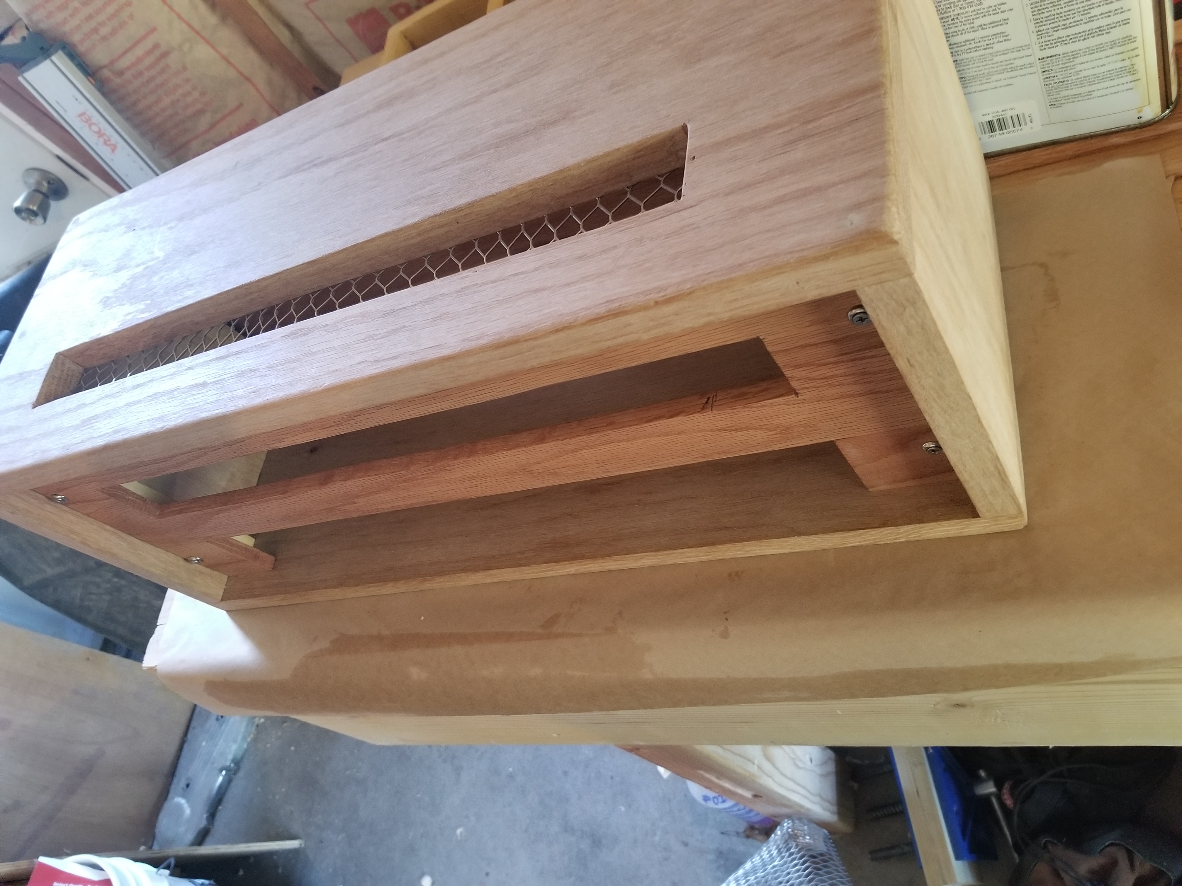

Good afternoon! I'm on a business trip right now and don't have the amp in front of me. I'm building a head cabinet and was wondering if y'all screw the chassis in to head cabinets. If so does anyone know the measurements to drill the holes? I was going to sketch it out in my down time to drill next week. Can't wait to give this beast a proper home!
PostPosted: Tue Aug 11, 2020 4:55 pm
AFIK, there's (4) #10 cage nuts on the bottom of the chassis at either end. Sorry, don't know the measurements, but I'd take the measurements from the bottom of the chassis and use washers and # 10 (probably 1"length) screws in slotted recesses on cabinet bottom, so you can adjust the position of the amp in the cabinet. Just my 2 cents. :bugeye:
