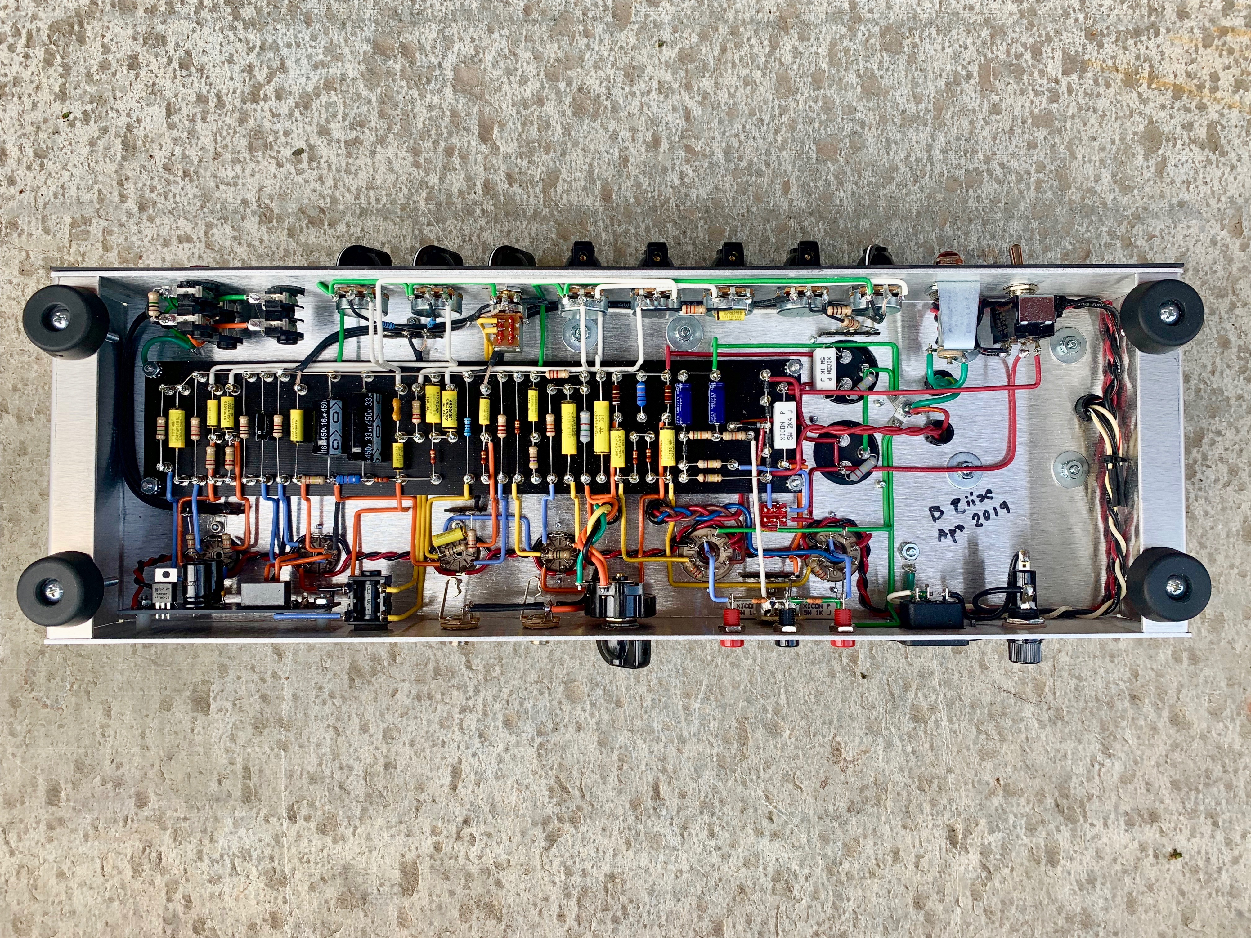

I have now finished my Triwatt build and it sounds fantastic!
But I have problems with hum/buzz from V2 induced by the OD relay board.
Apart from this the amp is very quiet and the noise floor very low but the hum is louder than I think it have to be.
I have performed the following tests:
1. disconnected the 6.3 V AC heater cables from the OD PCB and powered the OD board from a 9V battery. Result same hum level as when powered from the heater supply.
2. When battery powered grounded the OD board. All hum disappears! A very low hum can be heard on full volume, same as with no OD board installed.
Conclusion:
The OD board needs some form of ground reference. But how to do this when it is powered from the heater supply?
When the OD board is not grounded the whole board acts as an antenna for hum and the cables to the front panel OD-switch are very sensitive. Whit the card grounded this is not a problem and you can touche all cables without inducing hum.
Any tips what to do? Is it verified that the new OD-board works without inducing hum?
/Bjorn

bbrodie, The hum appears when you turn up the master volume, regardless if the footswitch is connected or not. The hum is proportional to the volume setting and doubles when the overdrive gain stage is engaged and the overdrive volume is set to full.
The pull switch works when the footswitch is disconnected. There is no difference in hum level with or without the footswitch connected.
I've had no time to investigate this further. My plan is to exchange the voltage regulator and the relay for 3V versions and supply the card from only one side of the filament winding and the center tapp (grounded). I will order the components tomorrow and return with the result when tested.
I suggest that you wait for Stephens answer. I'm convinced that he will come up with a much more elegant solution.
Bjorn

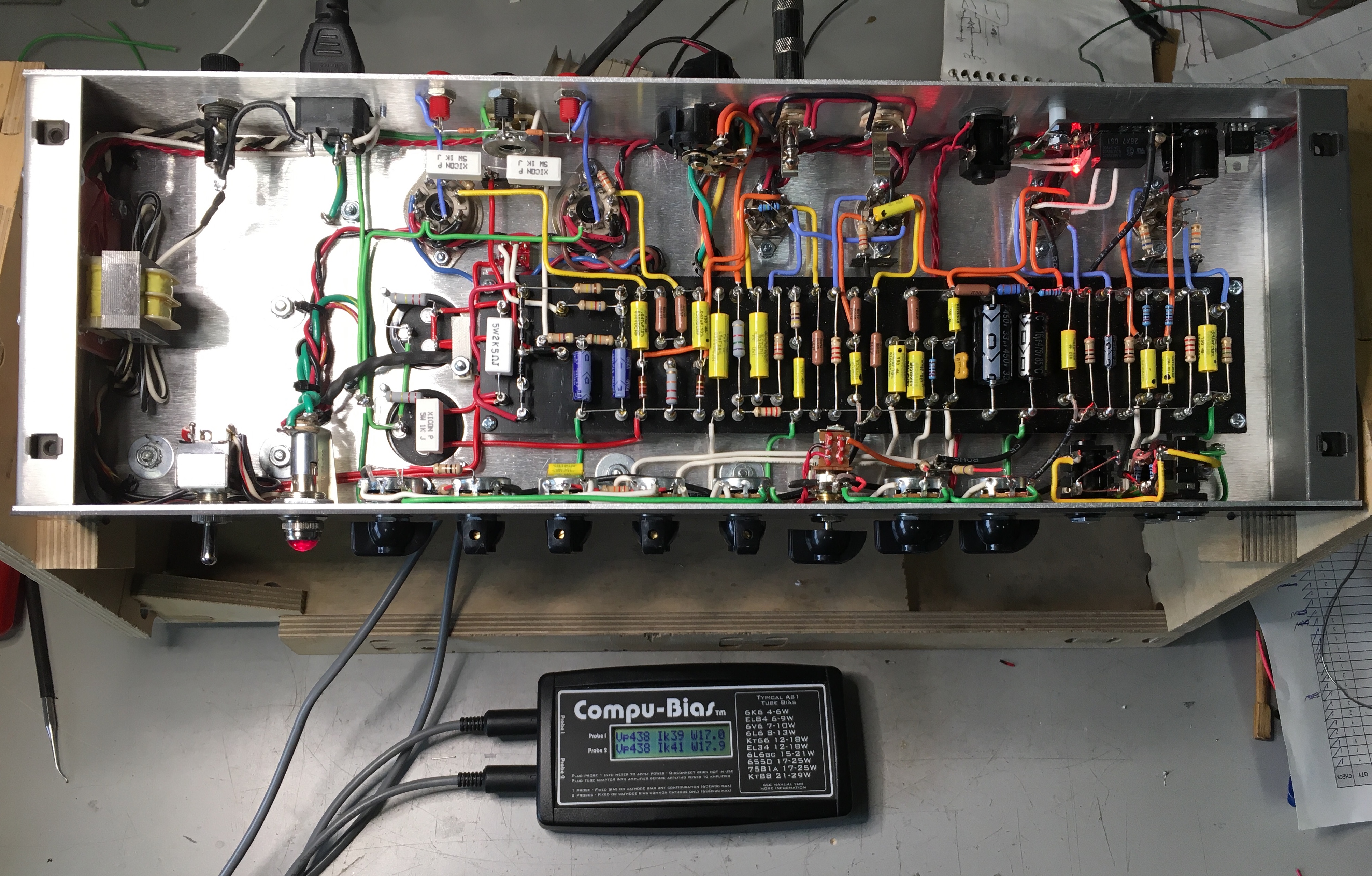

Below is a picture of a current build with the new mini transformer installed at the powe end of the amp.
Riise also developed a working solution we will try when we can get the parts in.

PostPosted: Fri Jan 10, 2020 3:46 pm
Posts: 19
Riise/Bjorn, I just wanted to say thanks for the great internals pic--I found it very useful in my just-completed Triwatt build. Your wiring is absurdly neat, and although I'm really not capable of that level of control, your pic did elevate my game when it came to keeping things clean and orderly! One thing I have to ask that puzzled me from your pic--the 2 red wires coming off the right side of the progressive power switch appear to have their downstream connections reversed compared with the layout diagram--is that something related to the OD footswitch, or was it done with some other intention, or does it just not matter which is which?
