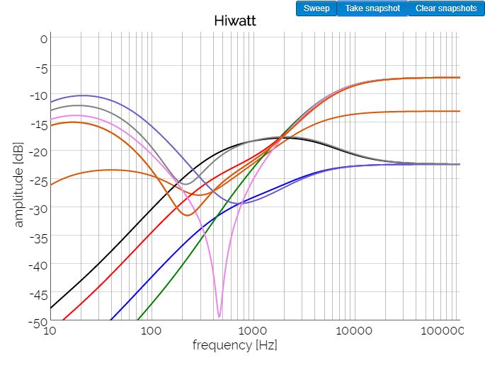

PostPosted: Thu Feb 06, 2020 11:52 am
Two response graphs for you to peruse!
STANDARD TRIWATT TONE STACK C6 at 1n
TRIWATT TONE STACK WITH C6 at 47n
