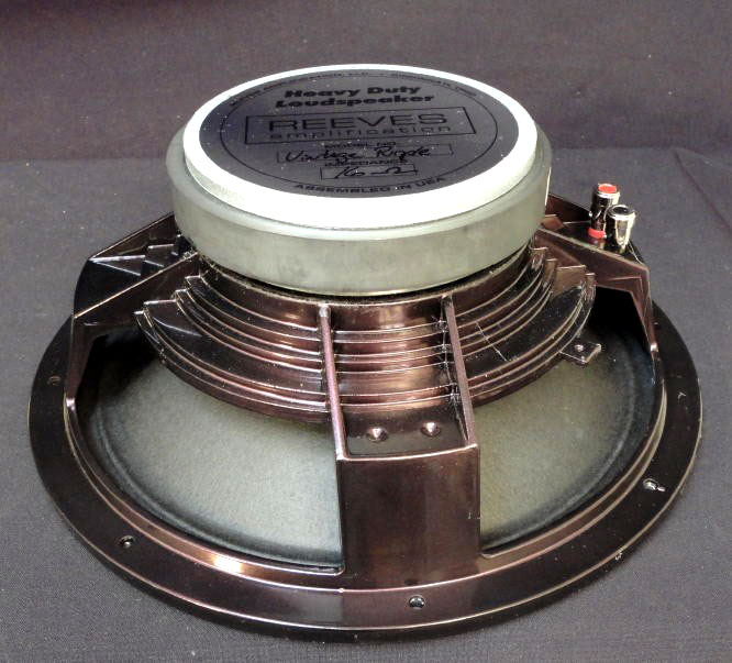

The Reeves Vintage Purple speakers were developed to fill a void in the market place when the Fane speakers that were originally loaded into Hiwatt cabinets in the '70s went out of production.
The Vintage Purple 12" speaker is built on a Cast Aluminum frame with a 56-oz. magnet and a 2" voice coil. We took an original Fane speaker from a vintage Hiwatt cabinet, refined several prototypes until we replicated that magical tone.
$129 speaker.
I emailed them to see if they are sold seperately.
PostPosted: Mon Jan 11, 2016 11:12 am
I checked with Reeves and the Reeves Purple clones are available at $129 ea.
Note: 16 OHM SPEAKERS ONLY
One persons comments:
"...my vintage purples are broken in.... they took forever to get there. They completely nail that vintage Fane tone and these speakers have been a surprise on the way they opened up after some time was put in on them. The funny thing is, I think people give up on these because they are not easy to break in, but once they do, they're keepers!!! I can get that Live at Leeds tone with these loaded in a Reeves SE style cab and using a DR103 and P90 SG!"
http://www.reevesamps.com/cabinets/guitar-cabinets/
