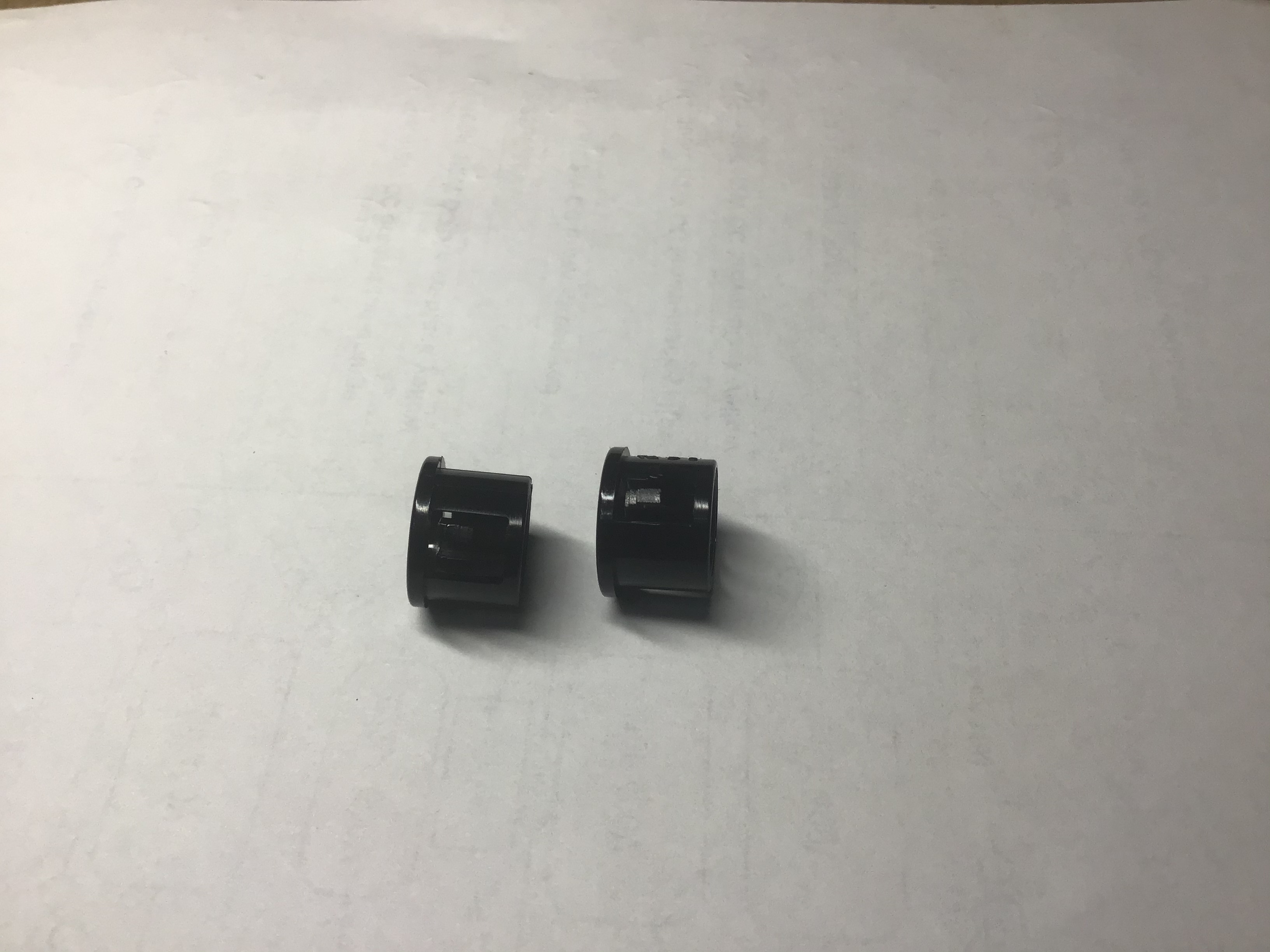

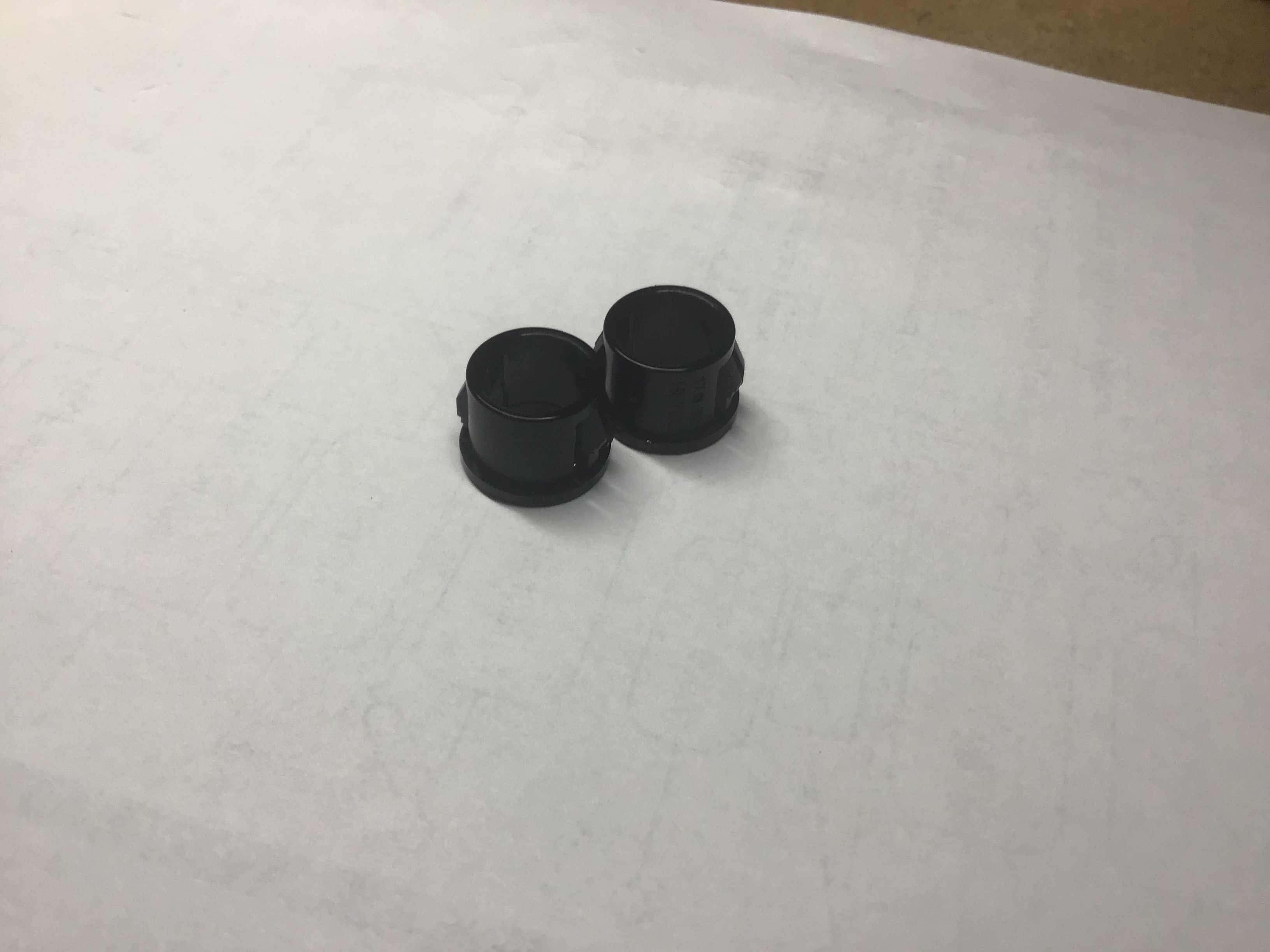

 Post subject: Parts question.
PostPosted: Mon Mar 22, 2021 10:00 am
Posts: 22
There are 2 small black plastic grommets that I cannot find a use for in the instructions.
What are they used for? I don’t want to go any further until I know.
PostPosted: Mon Mar 22, 2021 11:05 am
For output transformer lead protection through 1/2” dia holes on top of chassis
