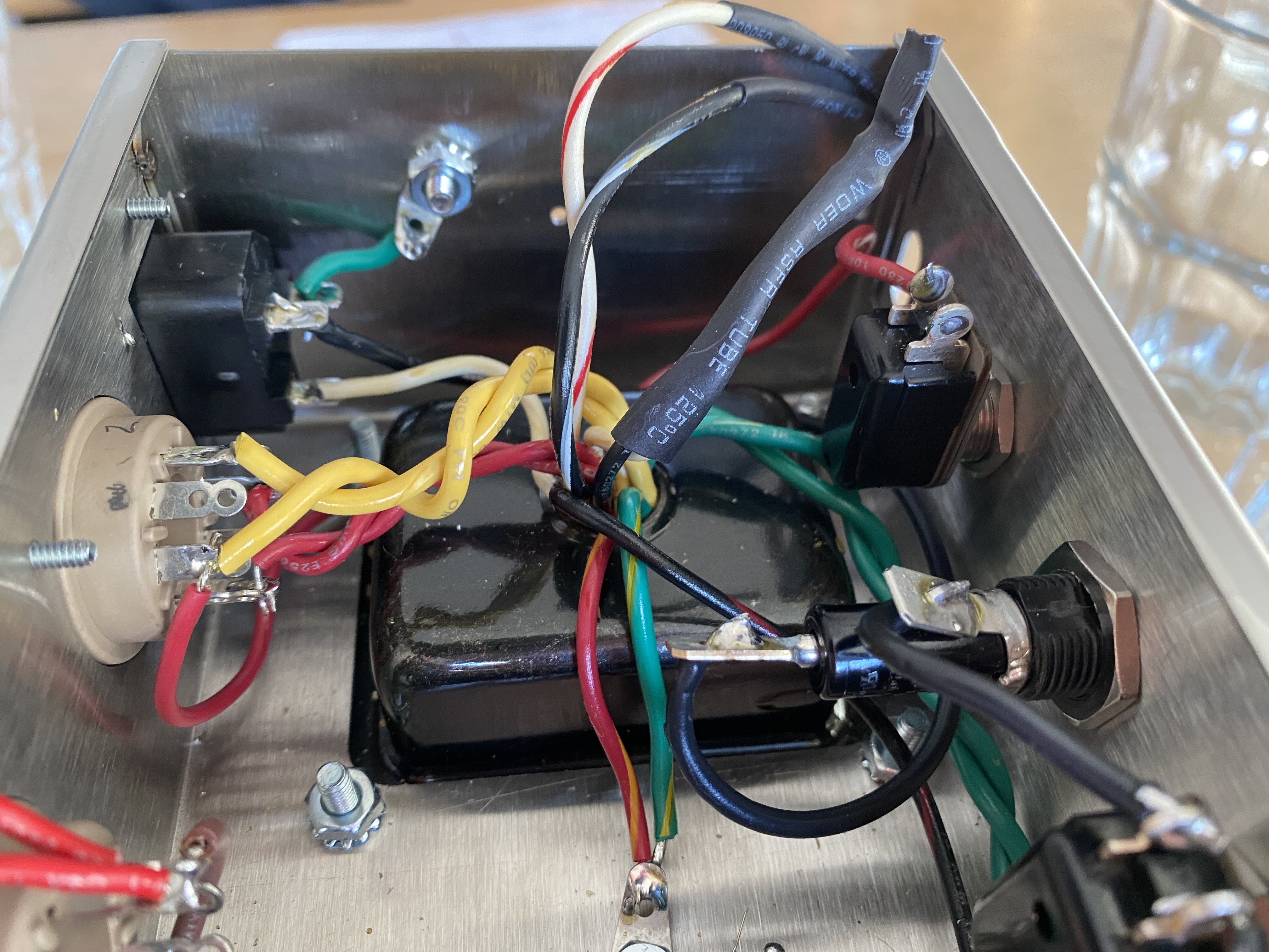

Can anybody help me with me with my 230V Power transformer hook-up (page 75 in the builders guide), I'm getting really low voltage when measuring the pins on my rectifier socket.
- I connected the black cable with the white/black cable and put heat shrink on it
- I put heat shrink on the white/red cable
- I put heat shrink on the black/white cable
IEC socket: Line goes to fuse thereafter to on/off switch and black/red back cable to the transformer. It's also grounded, and I connected the Neutral 0V to to the transformer via white cable.
Yellow and red cables goes to the rectifier pins.
Green/yellow and red/yellow goes to ground.
Two green goes to the light and I got light when I'm turning the amp on.
I haven't connected standby to the eyelet board yet, is that my problem?

Ok I found out that it was just me that needed to learn how to operate a multimeter. If somebody else needs to Hook up for 230V, hopefully they can use my post in the future. The amp is working except only problem is that I have no sound through the normal channels... ... back to work :-)
