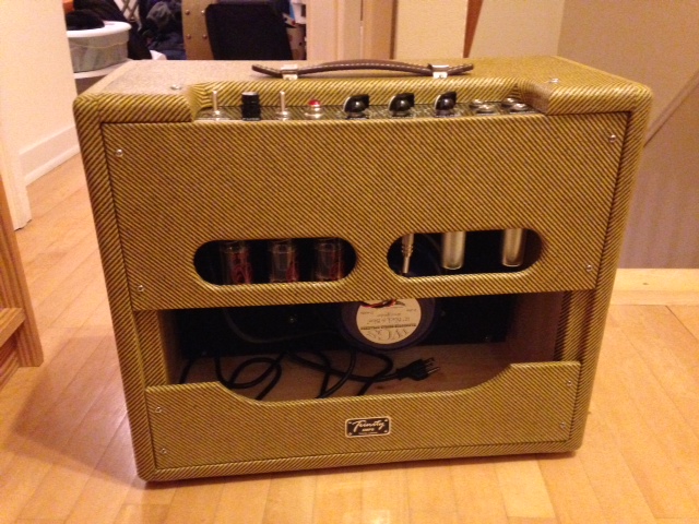

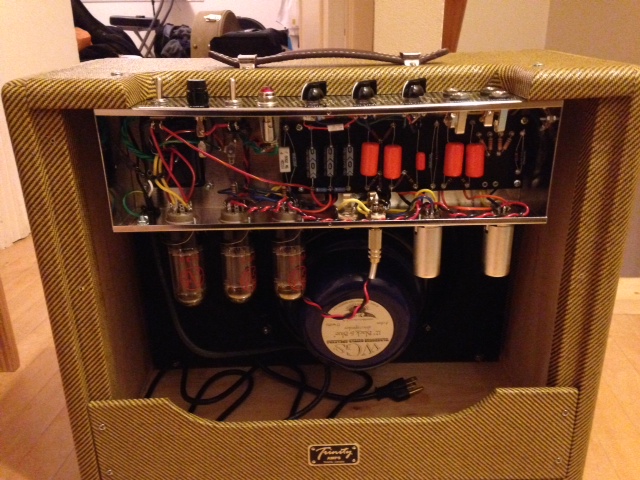

The cabinet (trinity) arrived last week. The speaker hasn't arrived yet so a friend lent me one so I could get the amp up and running. Here are some pictures:
The cabinet is beautiful and the amp sounds great! I can't wait until the speaker arrives. I'm going to play it stock for a while before doing any mods.
