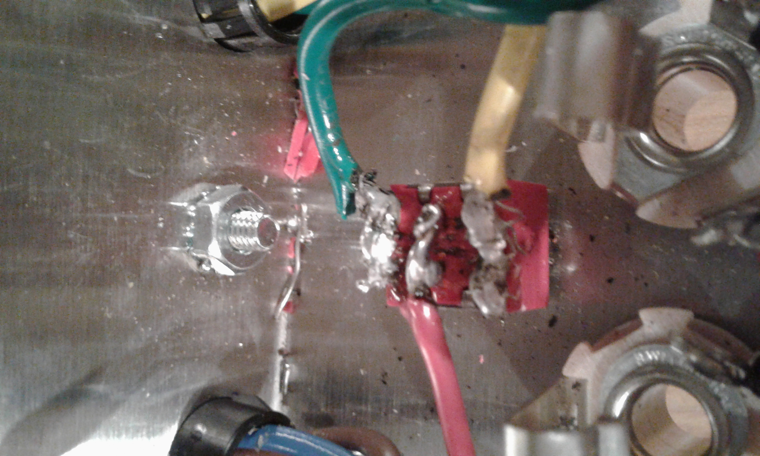

Does the wiring to the impedance switch get soldered across the two terminals of the piles? As per picture?
I am new to the build game and I find the instructions assume a lot of knowledge.

Yes, you got it right. Looks fine in the picture.
