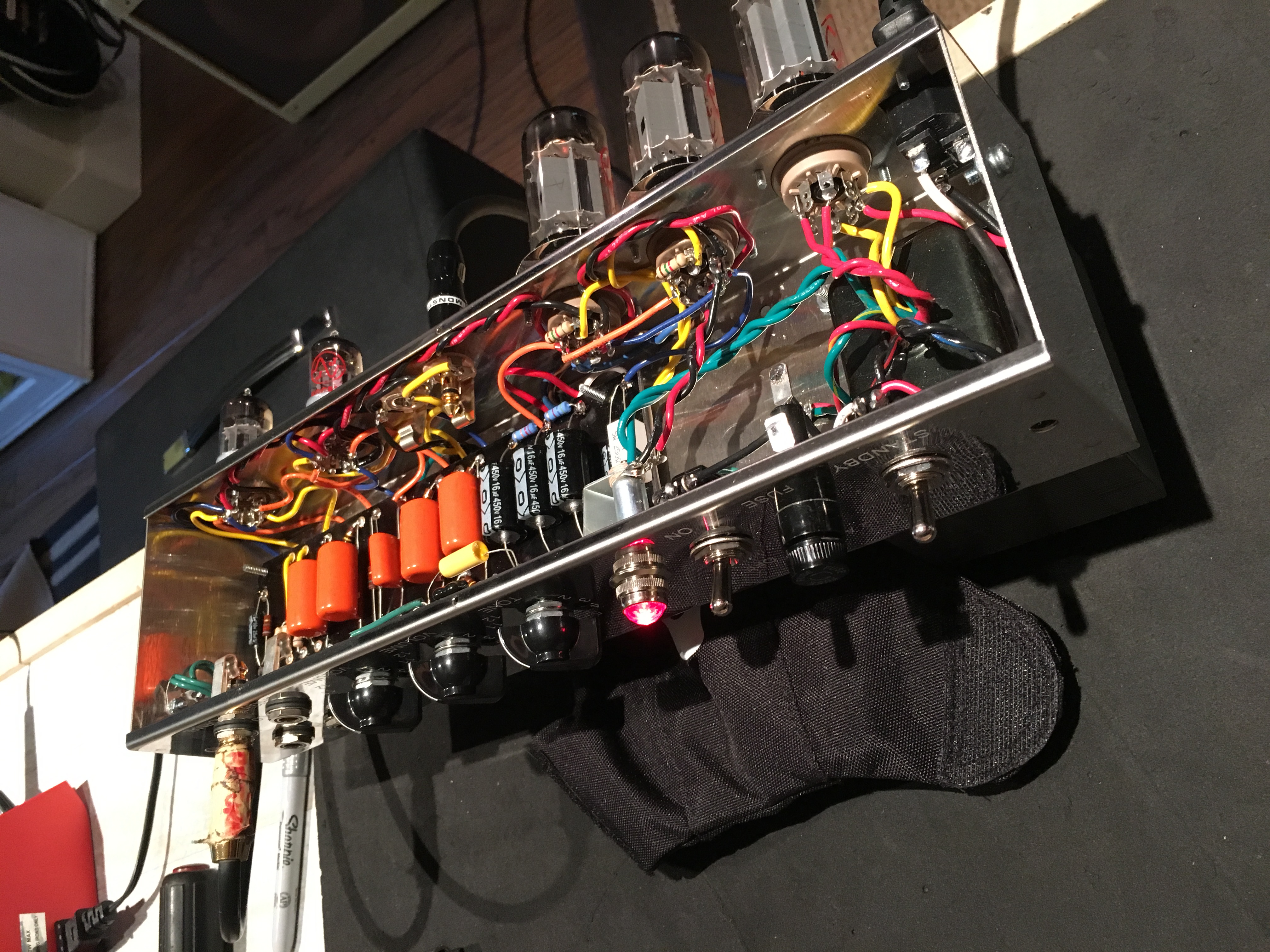

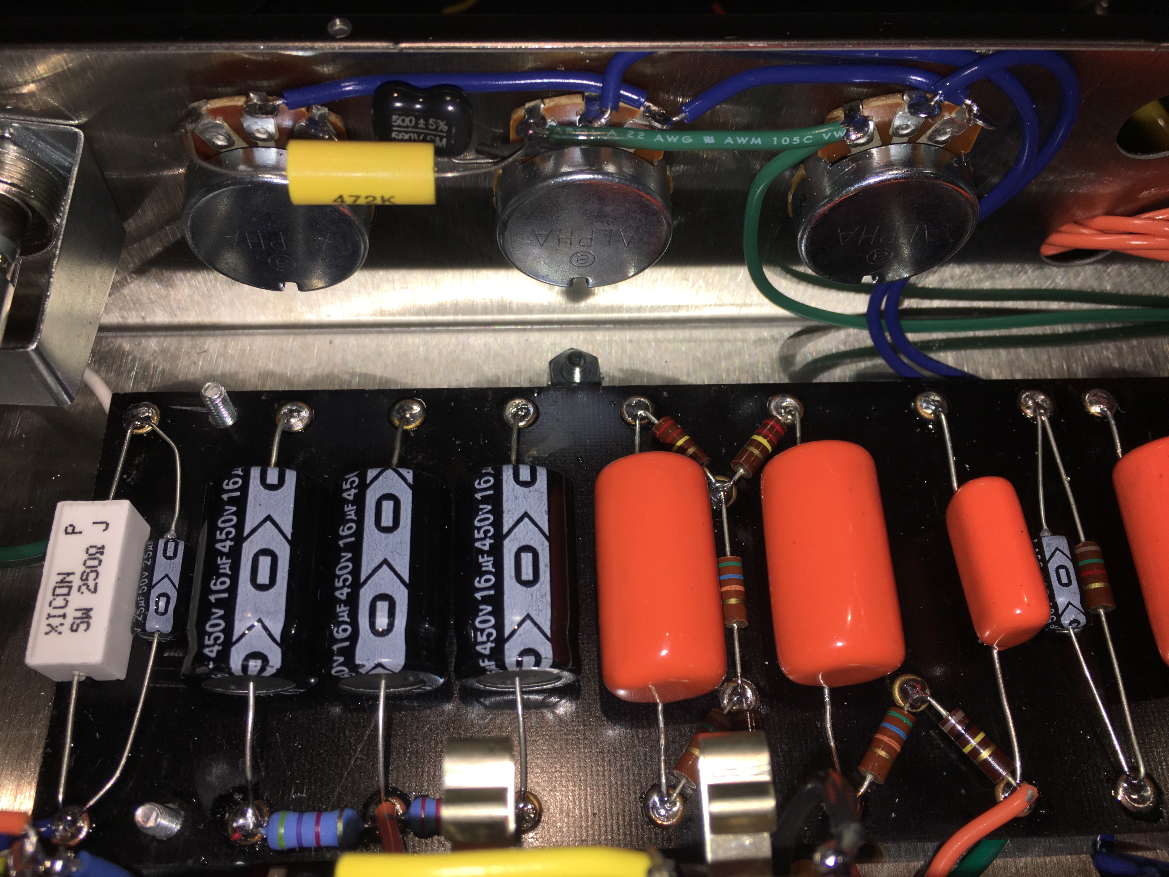

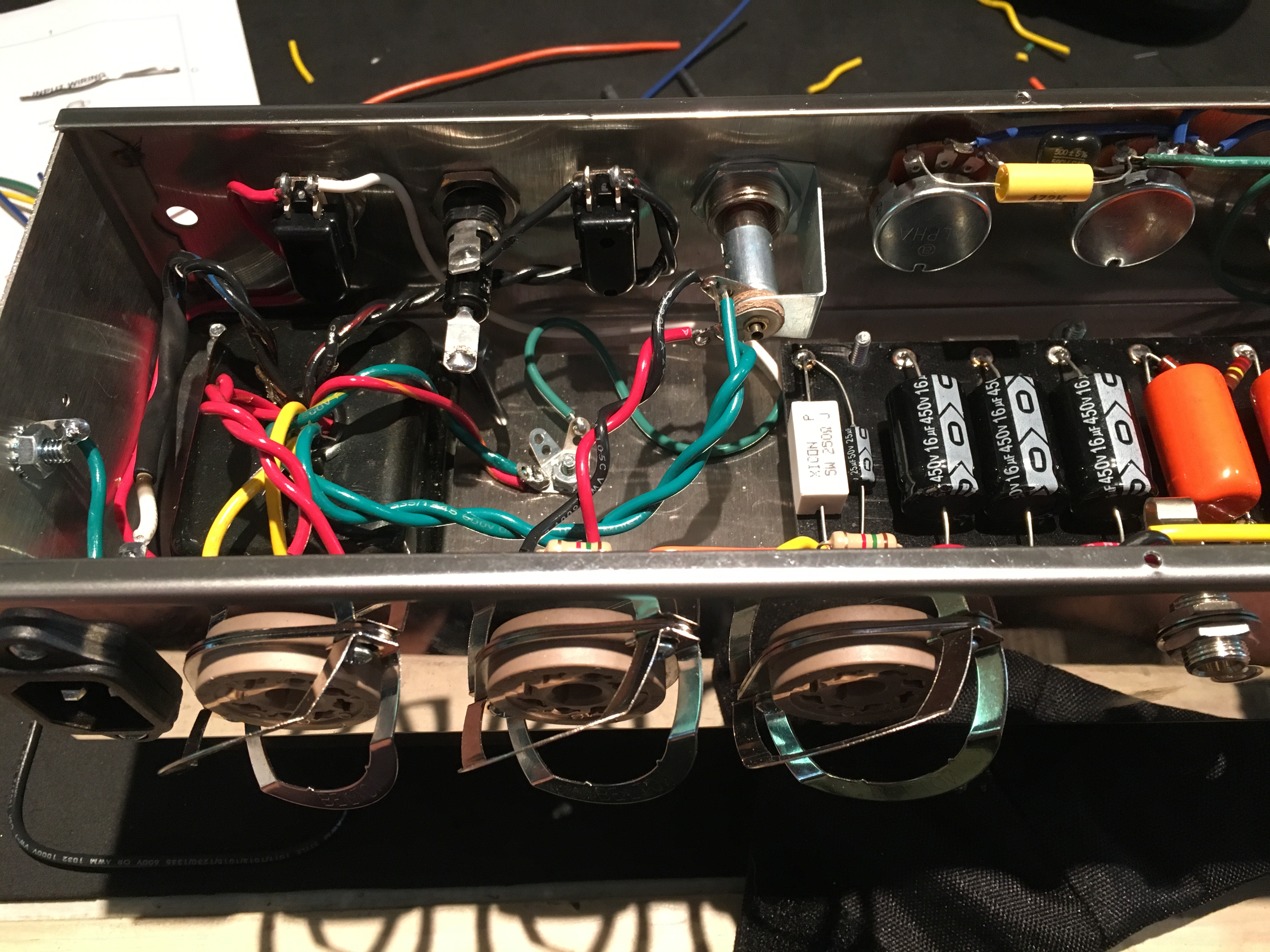

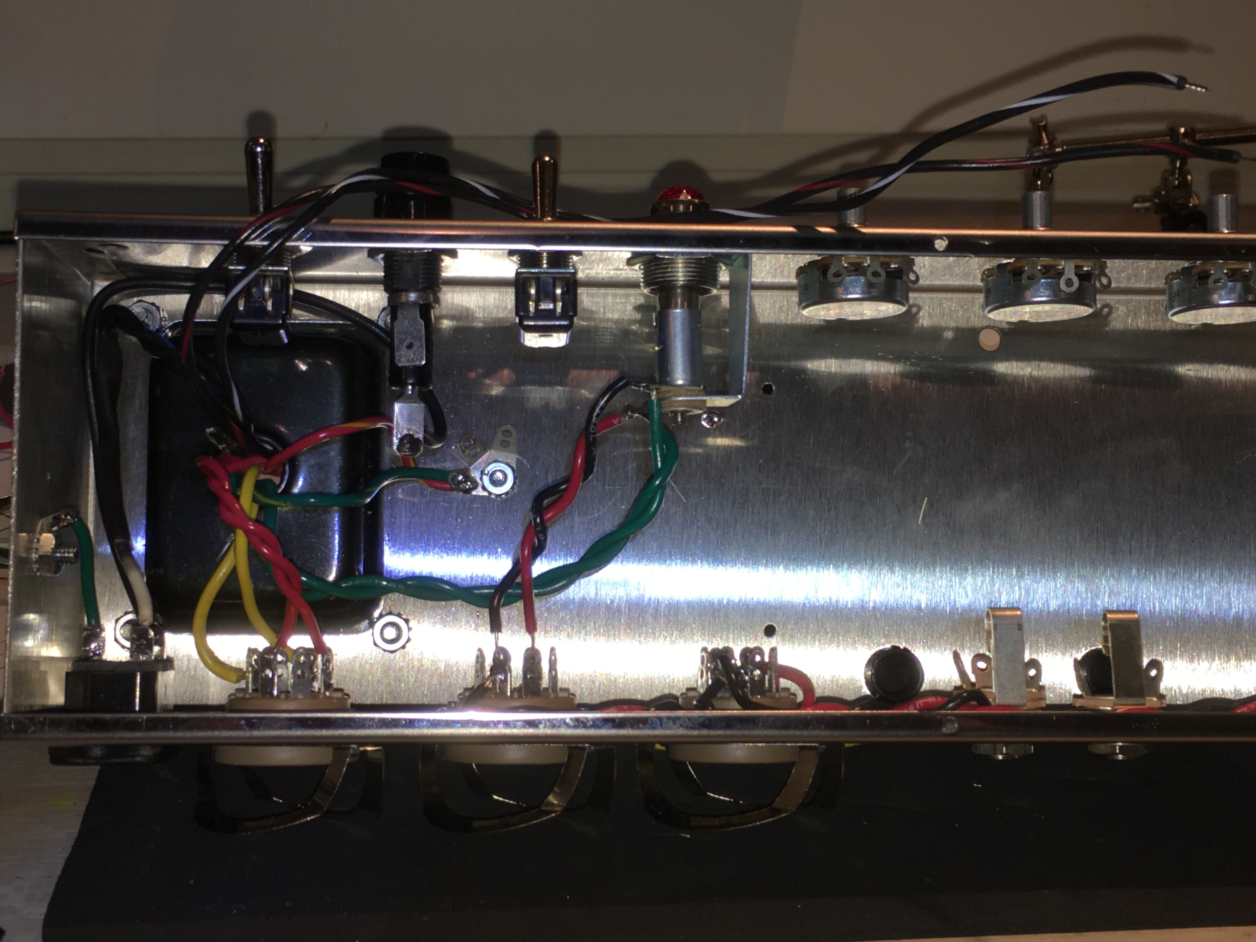

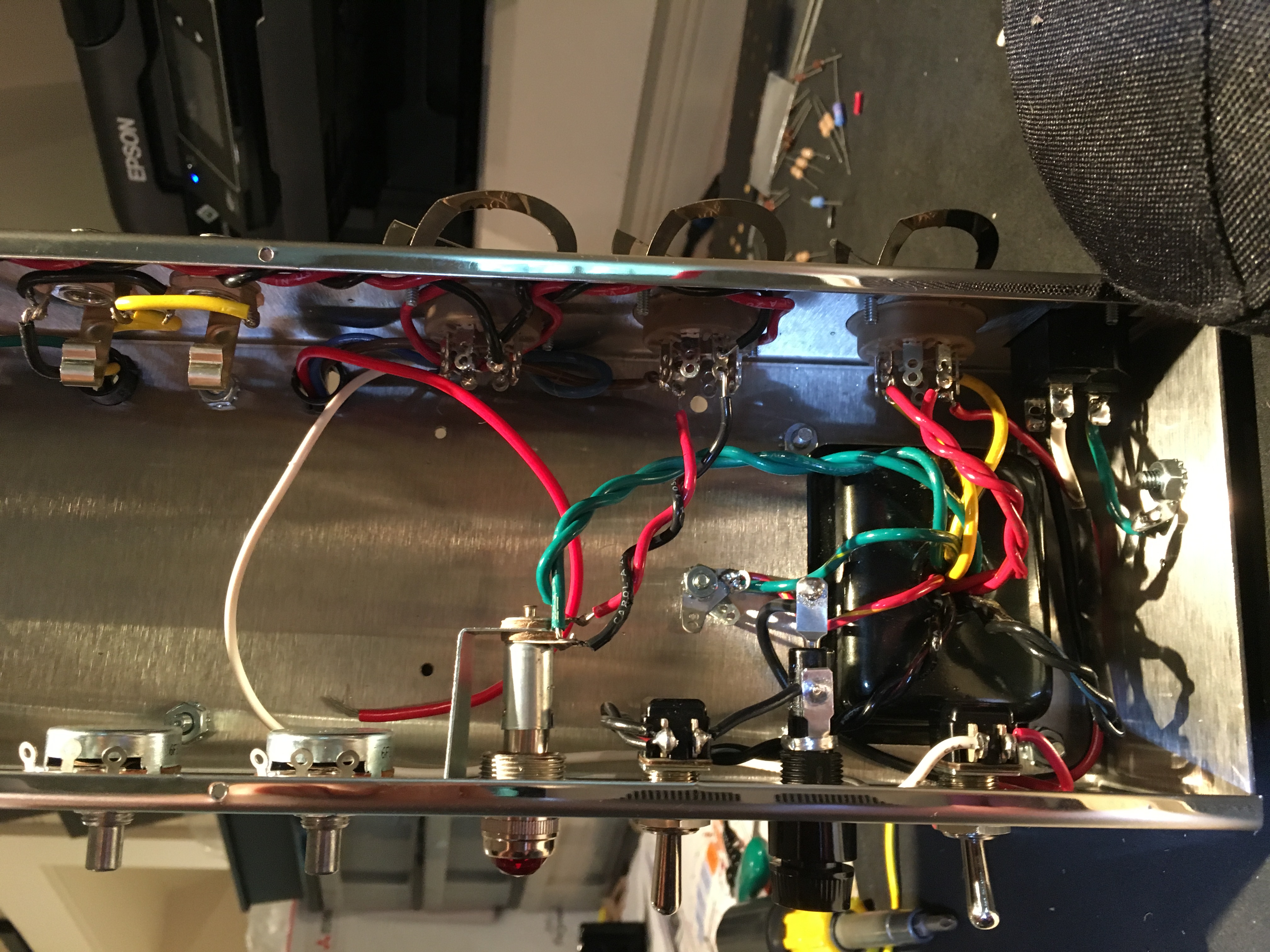

Well, so far so good, I think...
If you see any glaring errors, please let me know!

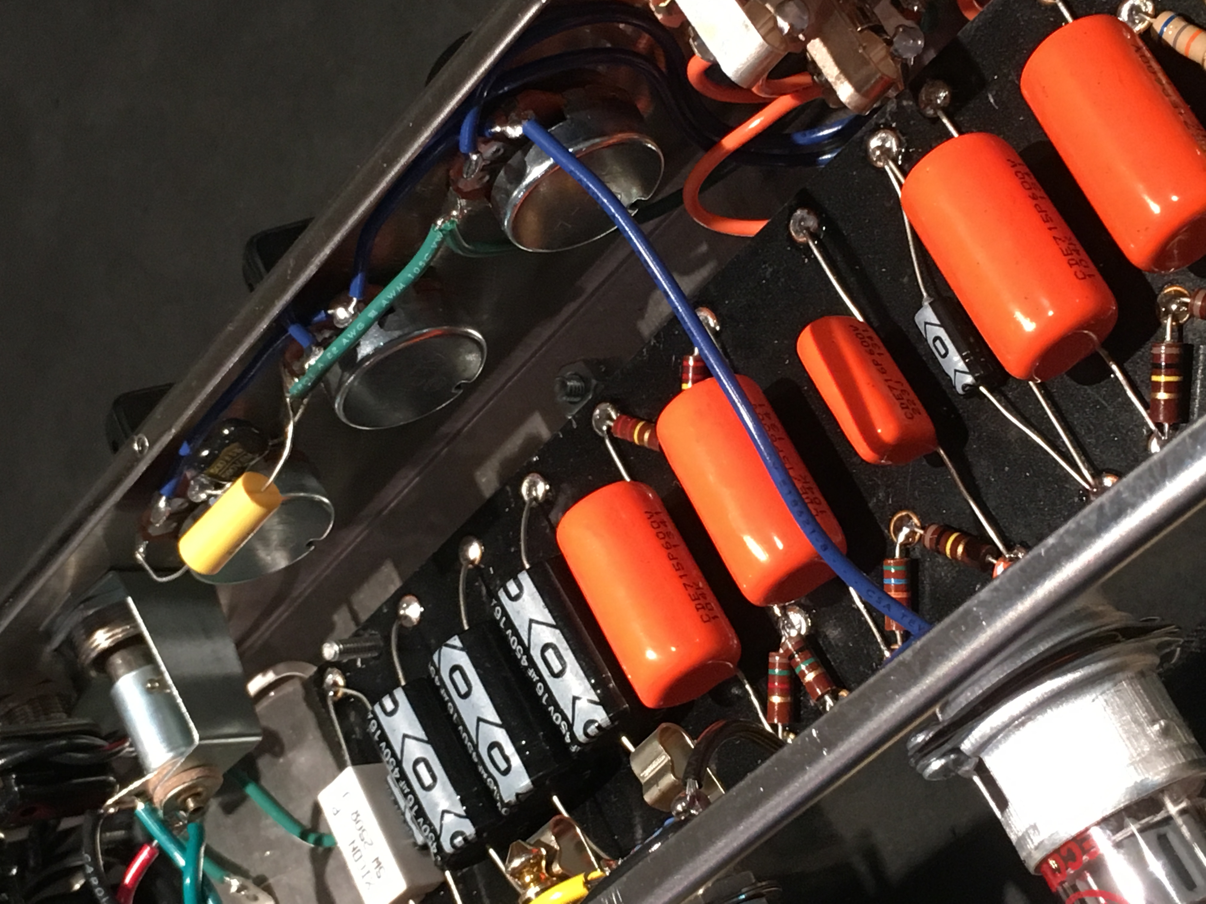

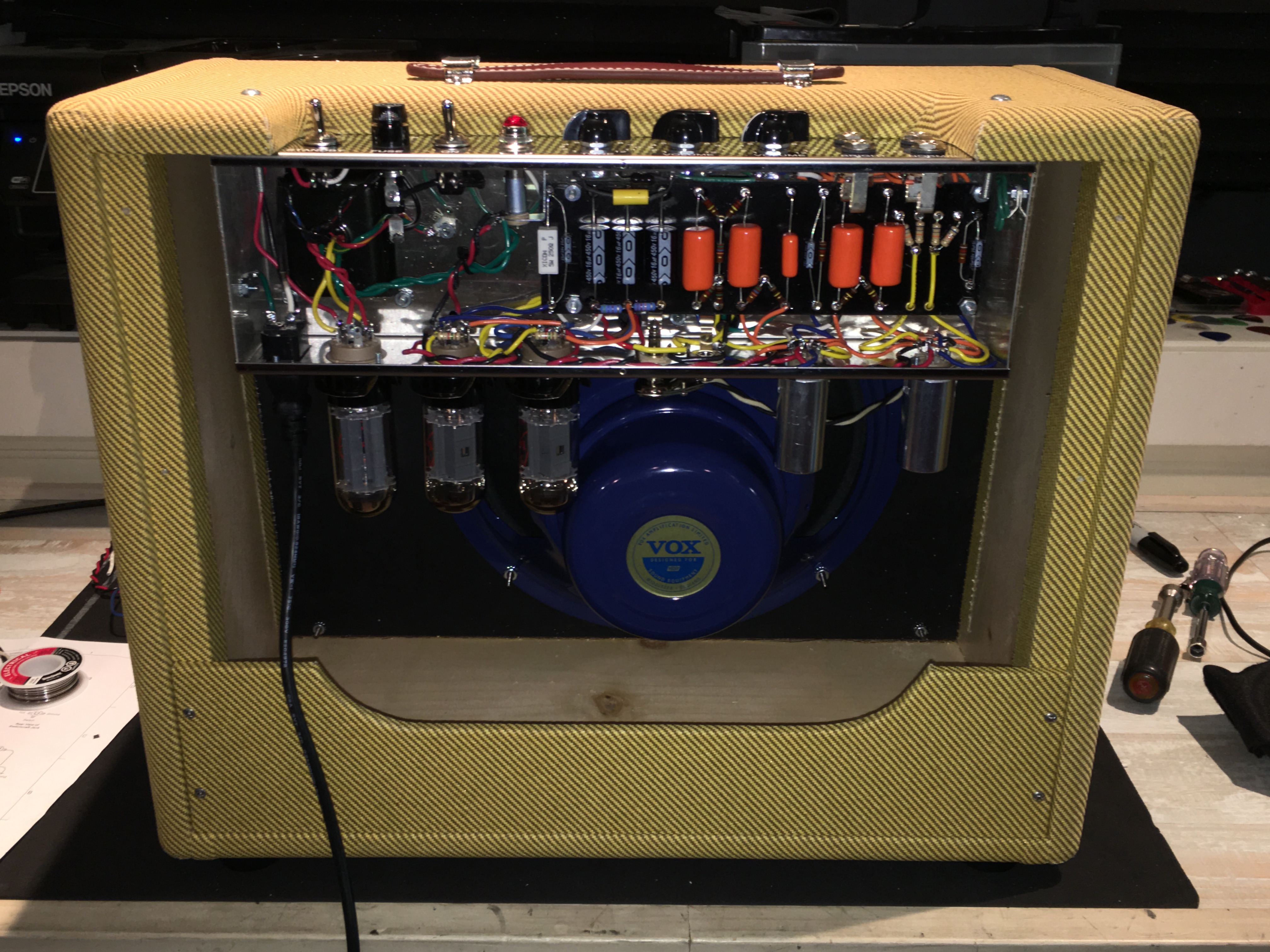

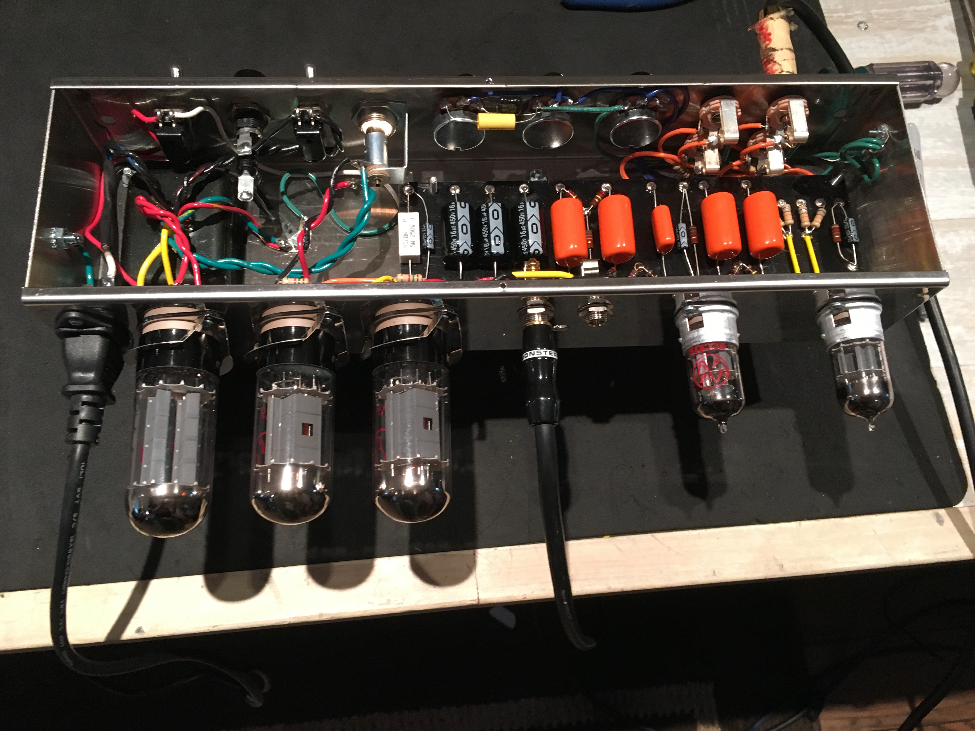

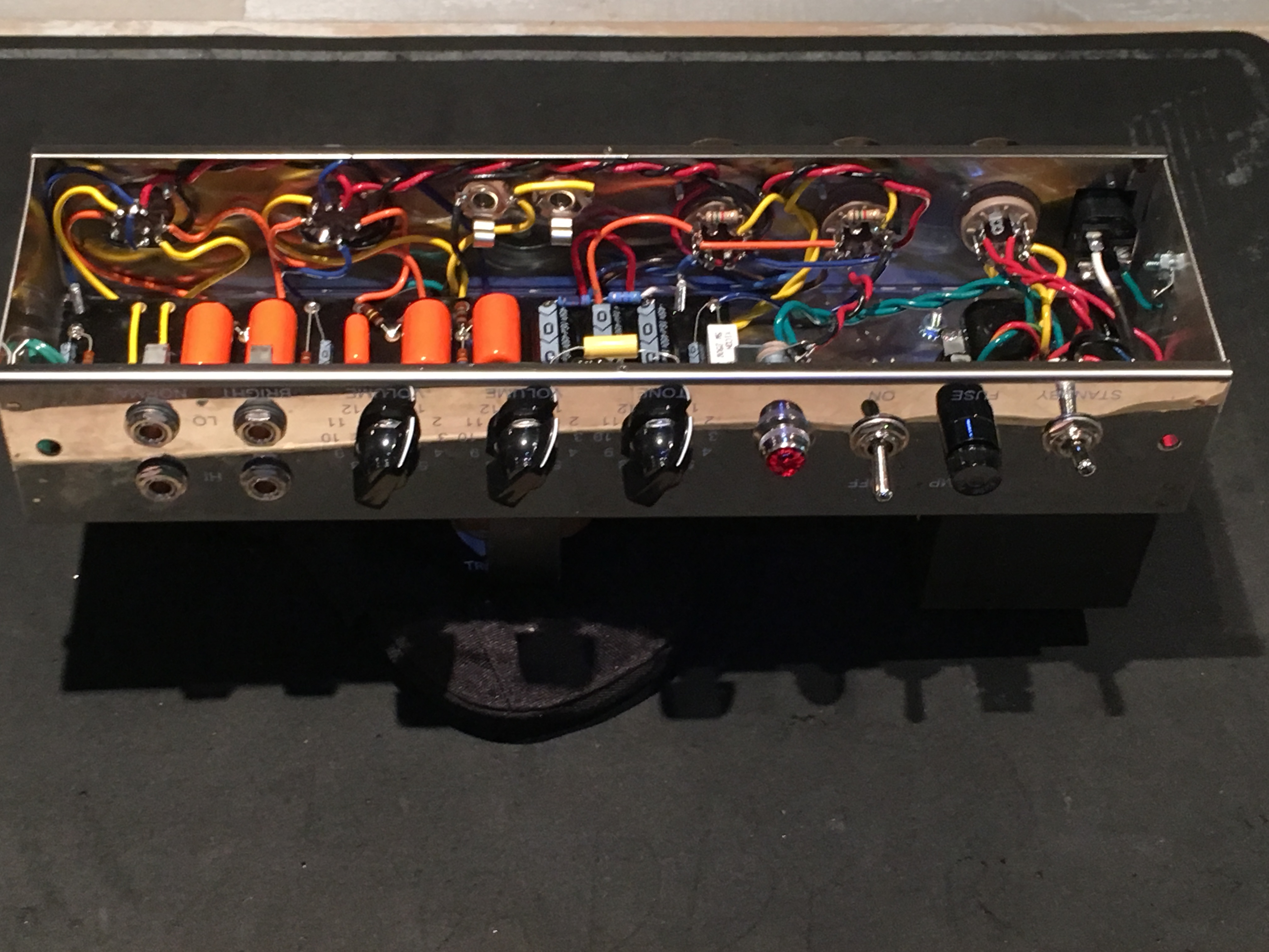

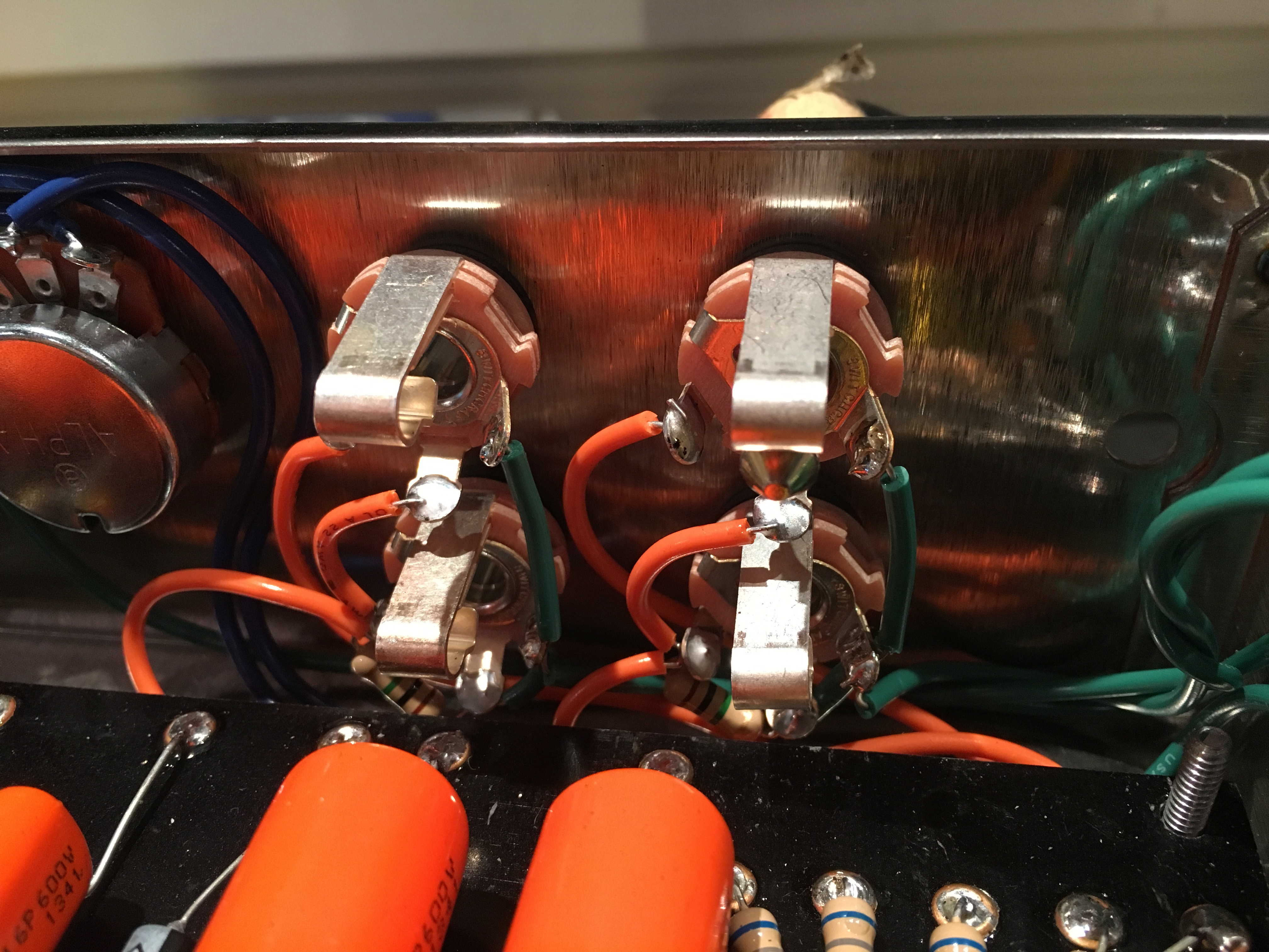

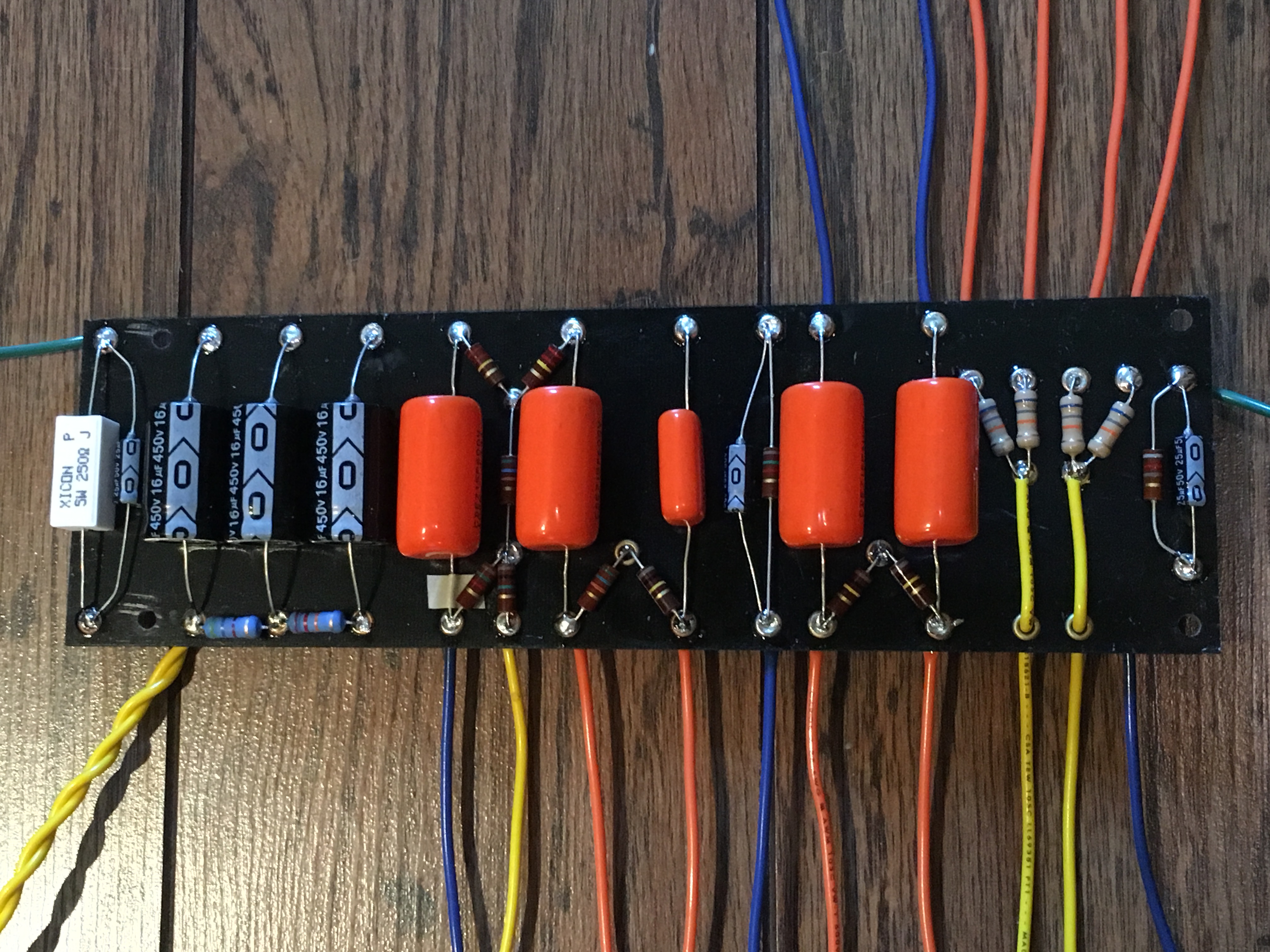

Here are some pics, for reference.

PostPosted: Mon Jun 26, 2017 1:42 am
The build looks good!
But yes, there is supposed to be a shielded cable running from the top of the Normal volume control to pin 2 of V2. If that's missing, no wonder you don't have sound. The fact that you hear a bit of hum is a good sign that most of the amp is working, though.
You could temporarily use a piece of regular wire for the connection just to test the amp. You might get more hum with regular wire, but the amp should work. The shield on the shielded cable only connects to ground at the volume control end, so it's not necessary to pass the signal. It's just there to shield the inner conductor that runs from the pot to the tube.
If a piece of shielded cable didn't come with the kit, Stephen will send you some. But you could also cut up a regular stereo patch cord to get a piece.
