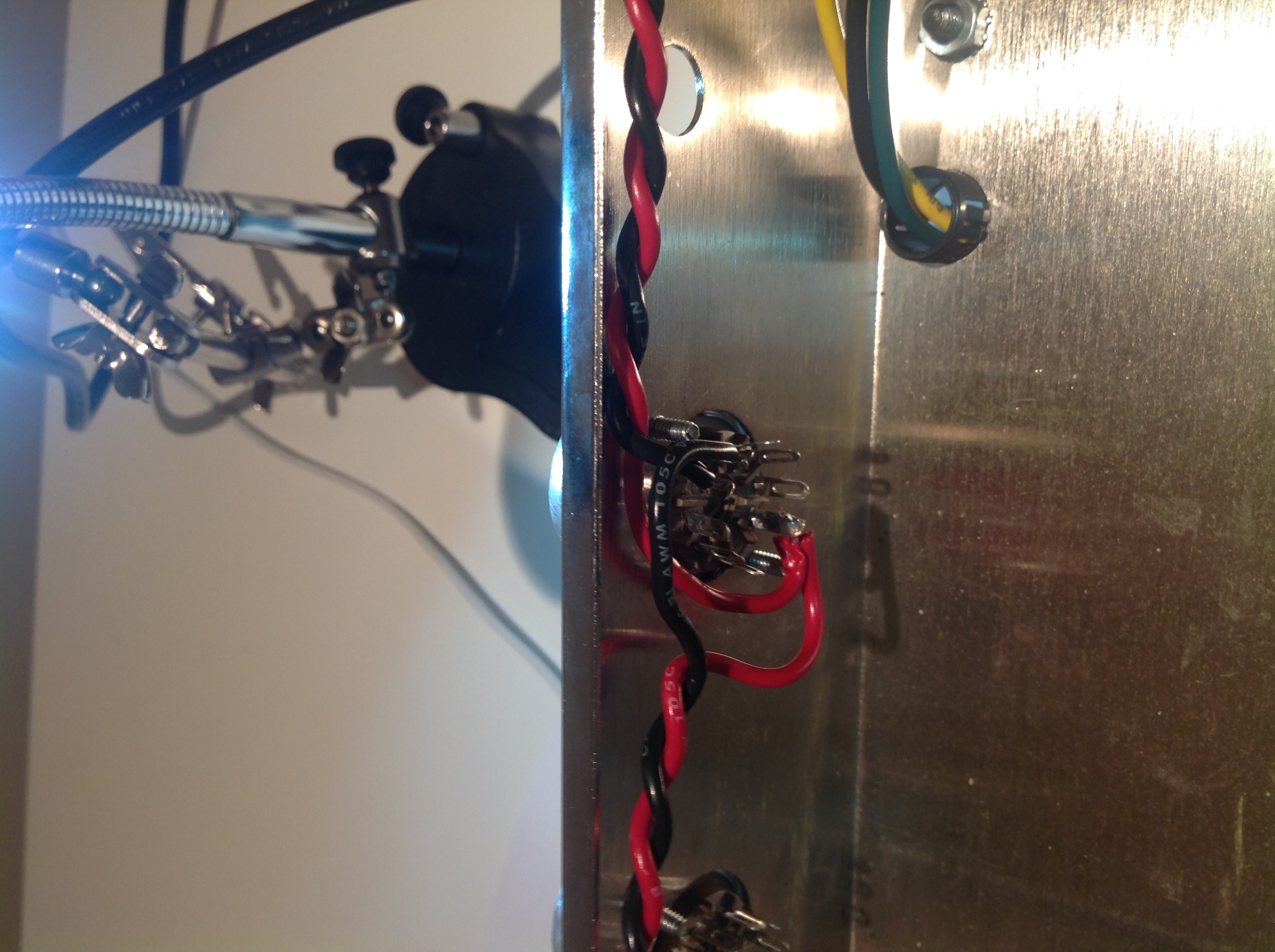

Just installing heater wire to pre amp tubes. I can't tell if the black ground is supposed to it together across pin 4 and 5 or not for wiring coming from output tube

Hi Chris, yes, on both the preamp tubes pins 4 and 5 are wired together/connected as part of the Heater wiring.

Is a small piece of heater wire used as a jumper the way it's done - this is how I have wired it

Yep, that's fine. :thumbsup:

Or you can just strip off a bit more insulation and run the same wire through pins 4 and 5 of the 12AX7.
