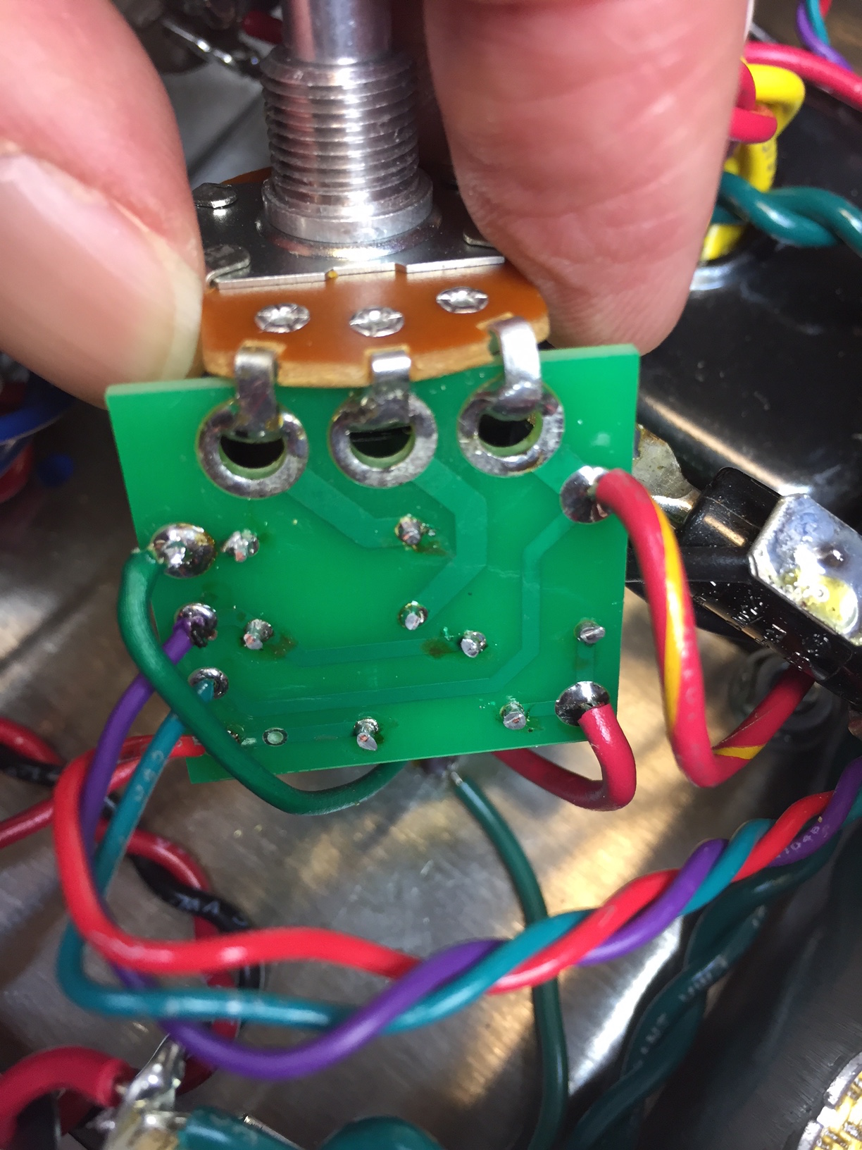

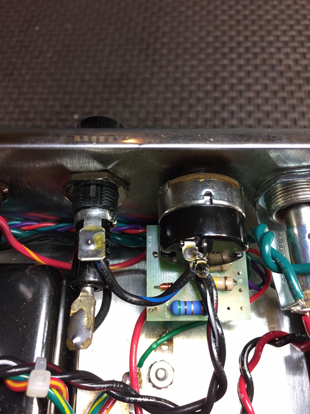

Thanks for the pictures. Very helpful. I just finished the install of the VRM. The amp works and sounds good. There is a more linear control on the volume controls...the amp used to hit "loud" by the time it was on 2. Both channels work and High and Low functions seem intact. I modified the inputs with the blocking capacitors and moved the 1M resistors directly to the tube grid. The VRM, however, doesn't seem to do anything. It turns the amp on, then there is no difference in volume or sound throughout the range of the adjustment. I have done what I can to check my connections but can't find where I've gone wrong. I'll attach a few pictures in case there's something visibly and obvious that I've messed up. Thanks for any help you can provide.

PostPosted: Sat Jan 07, 2017 11:09 pm
Does the voltage change when you turn the VRM?
Check the connections to the little PCB.

Thanks for the ideas. The pot seems to be working fine. It reads 1000k and gives variable resistance as wiper is rotated. Continuity from pot lugs to pcb is good. For the MOSFET, there are no shorts. In following the video, I'm unable to get any continuity among any of the prongs. My meter has a diode test function but I have to switch it into resistance mode to get continuity. None of the testing sequences result in any closed circuit. I'm not positive I'm doing this correctly though. I've attached a pic of the pcb back.
