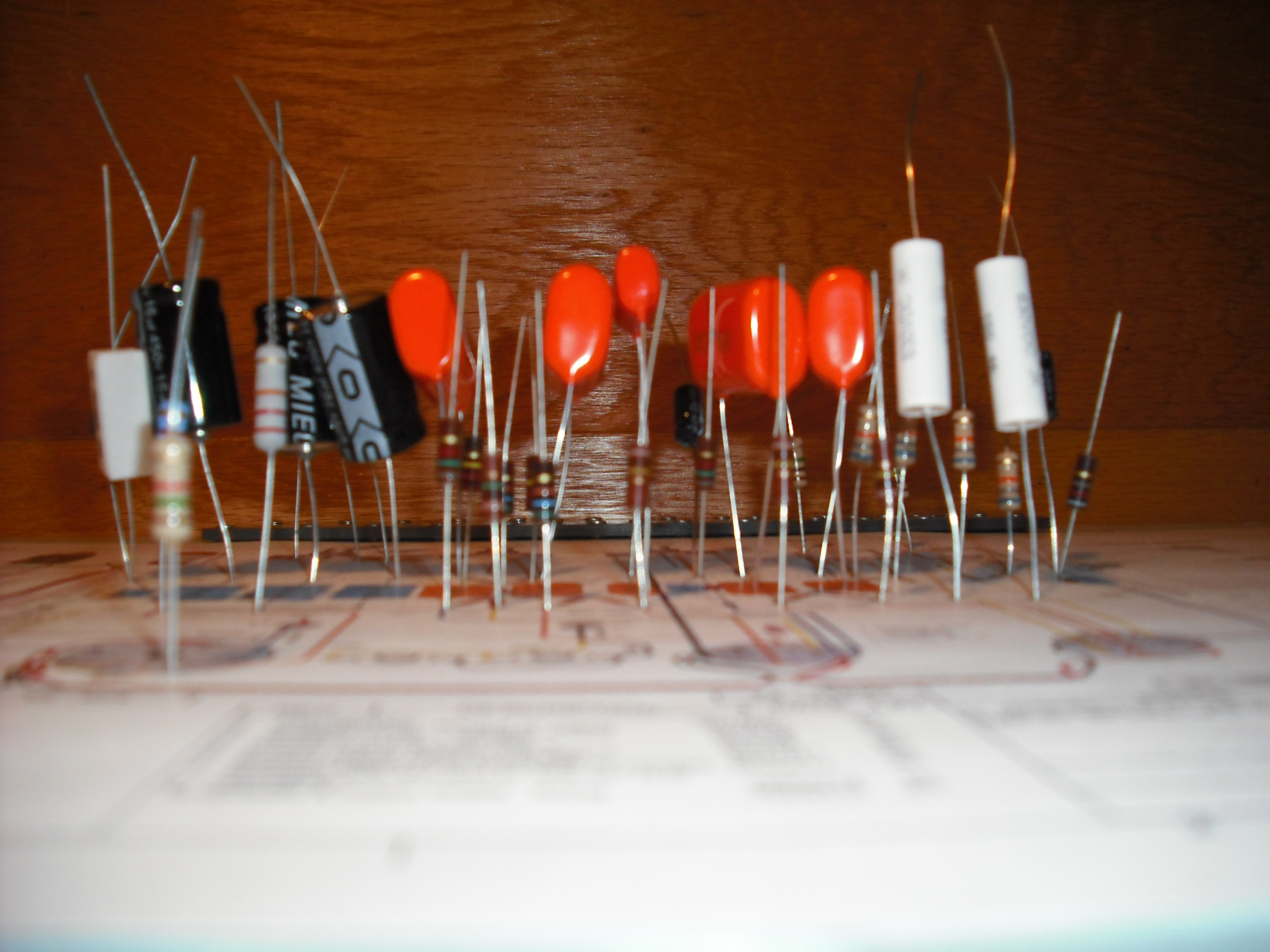

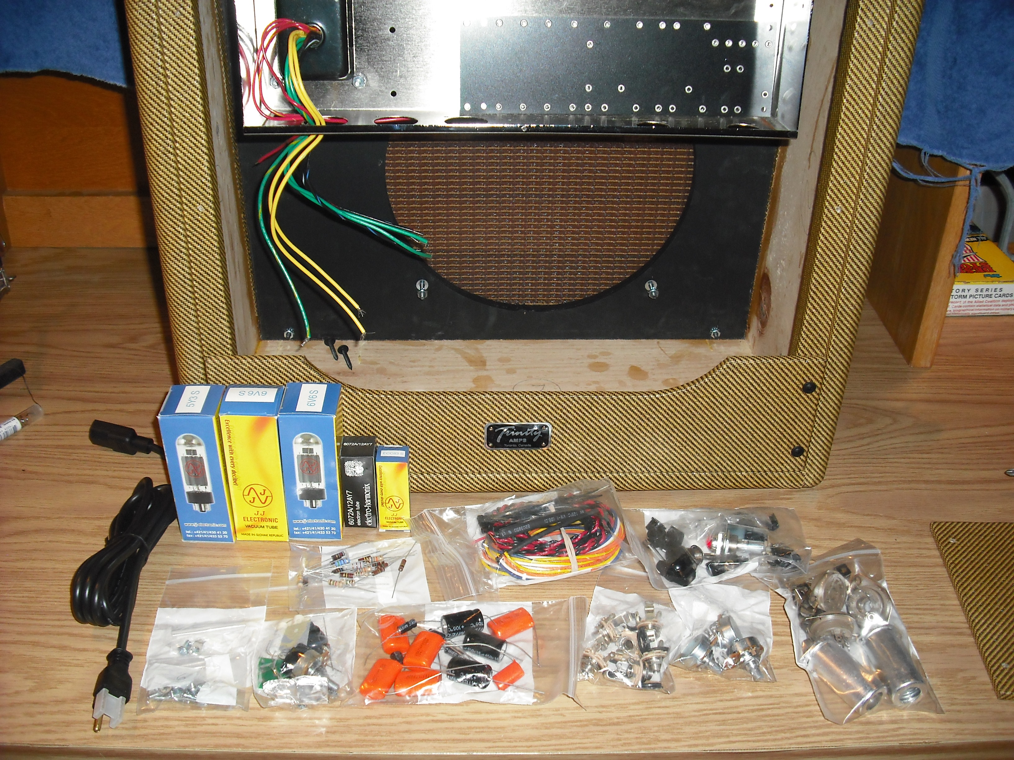

Original Parts :

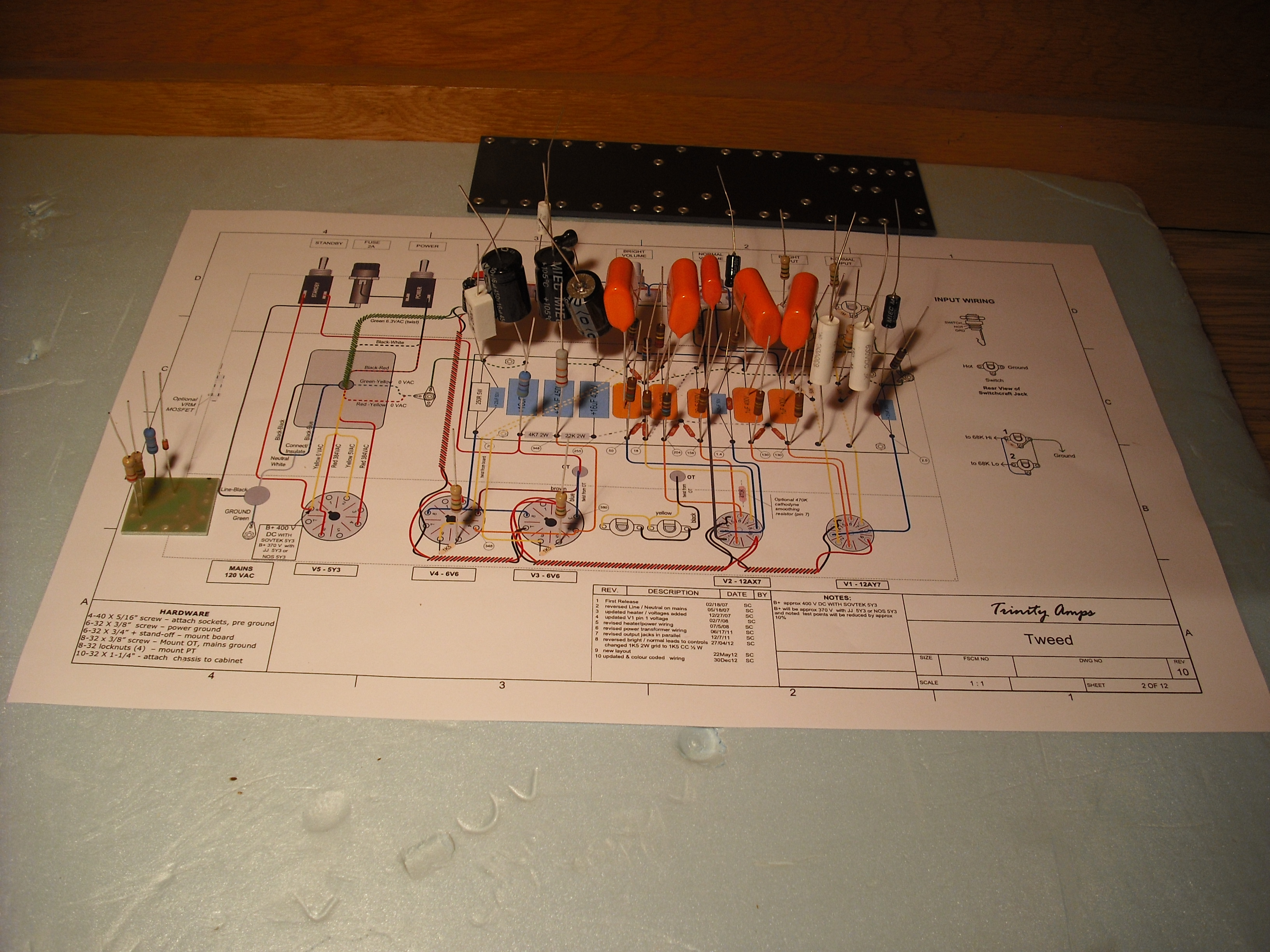

Layout parts on drawing to verify inventory.

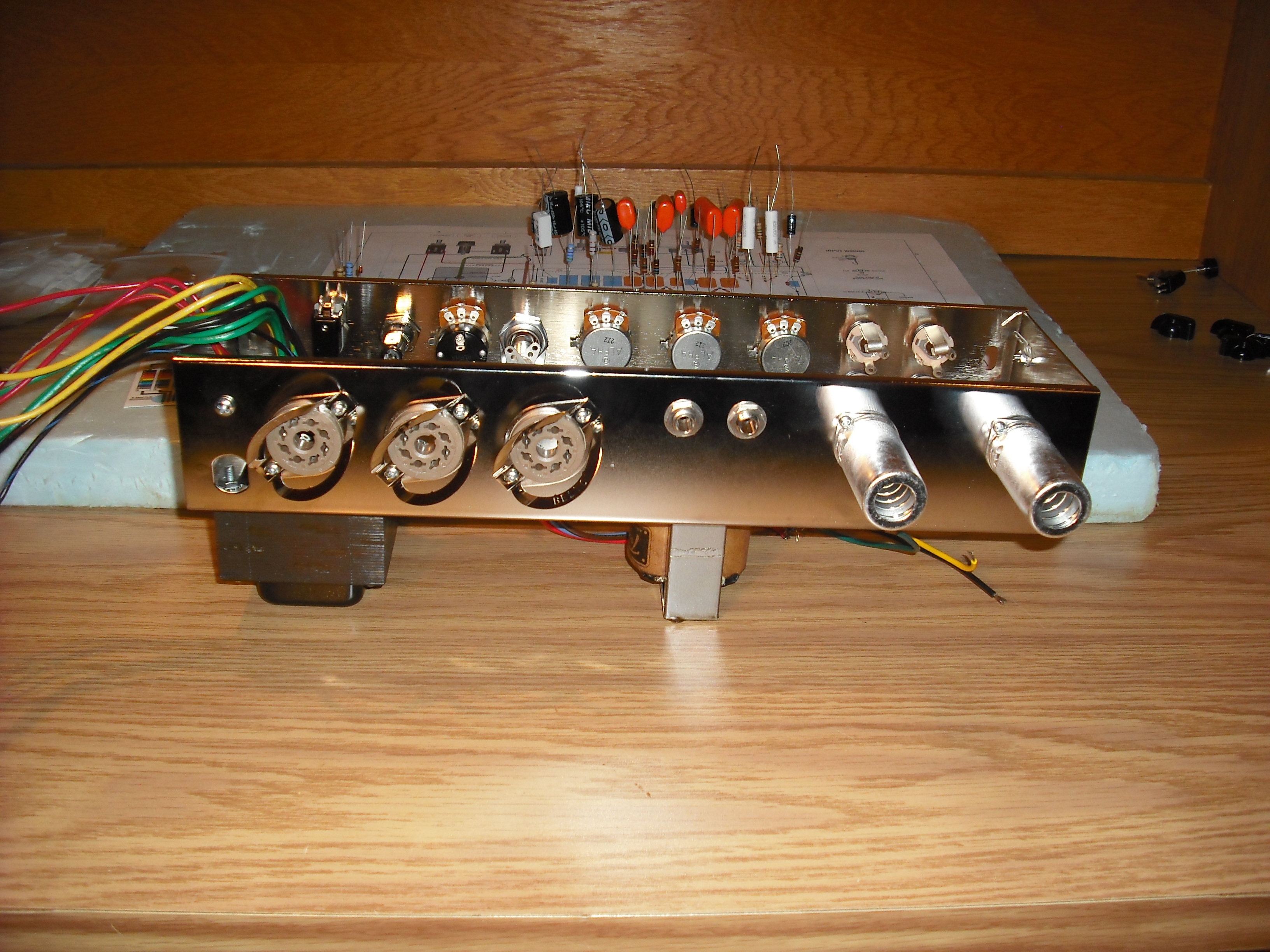

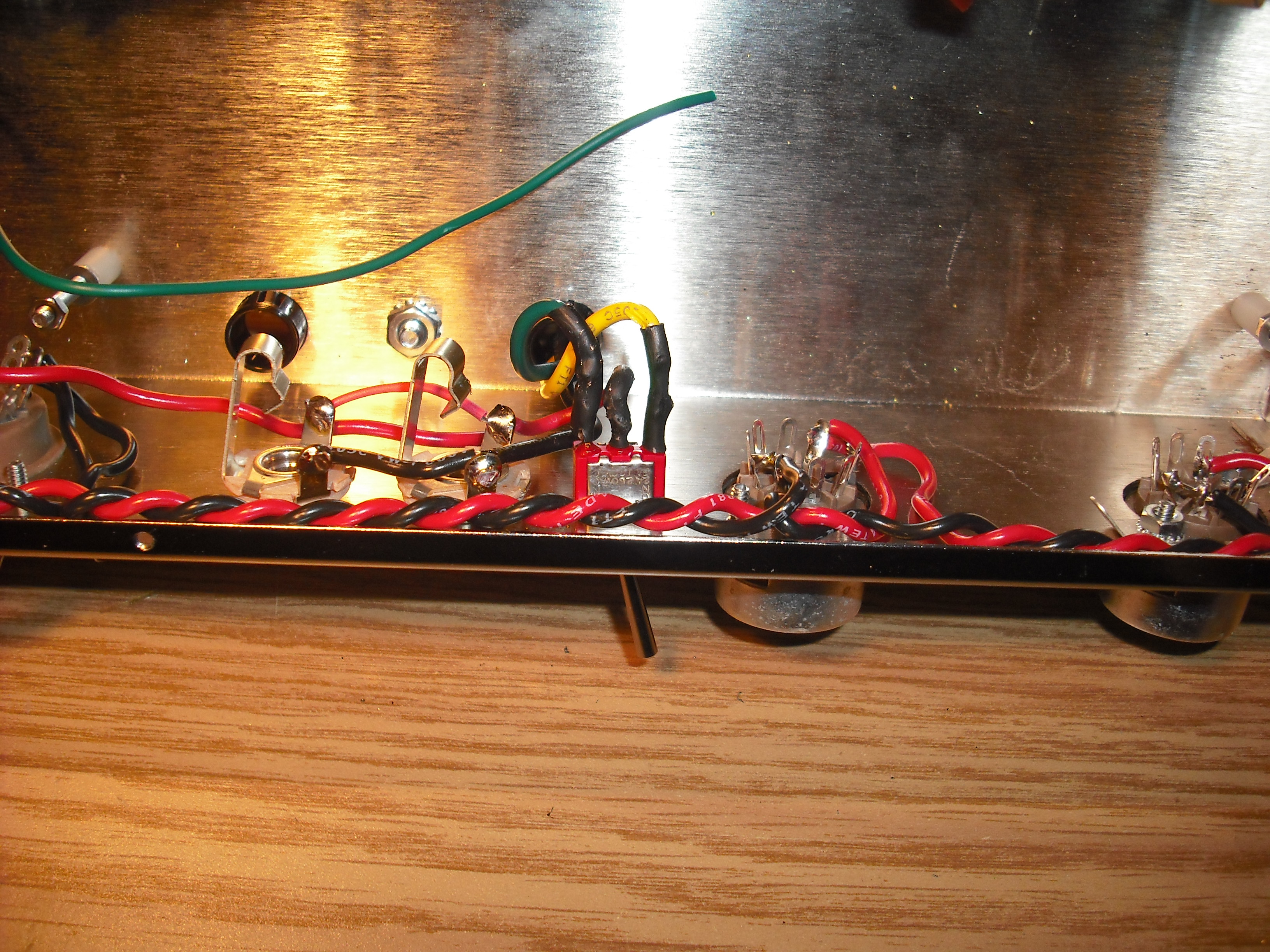

Install the hardware :

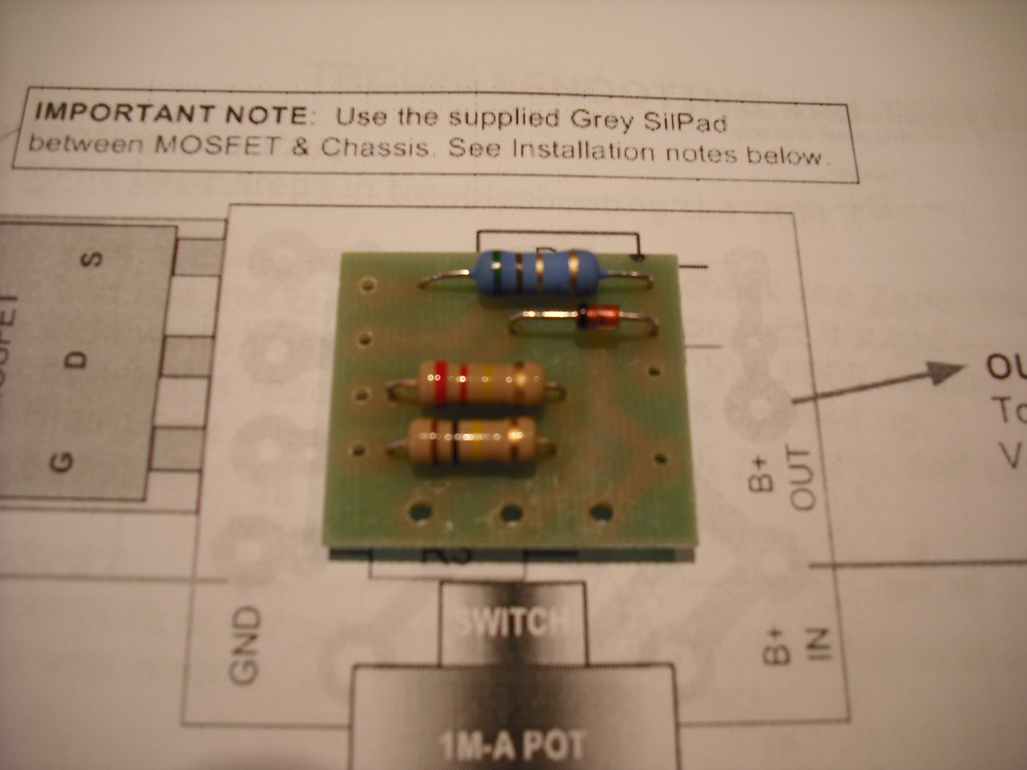

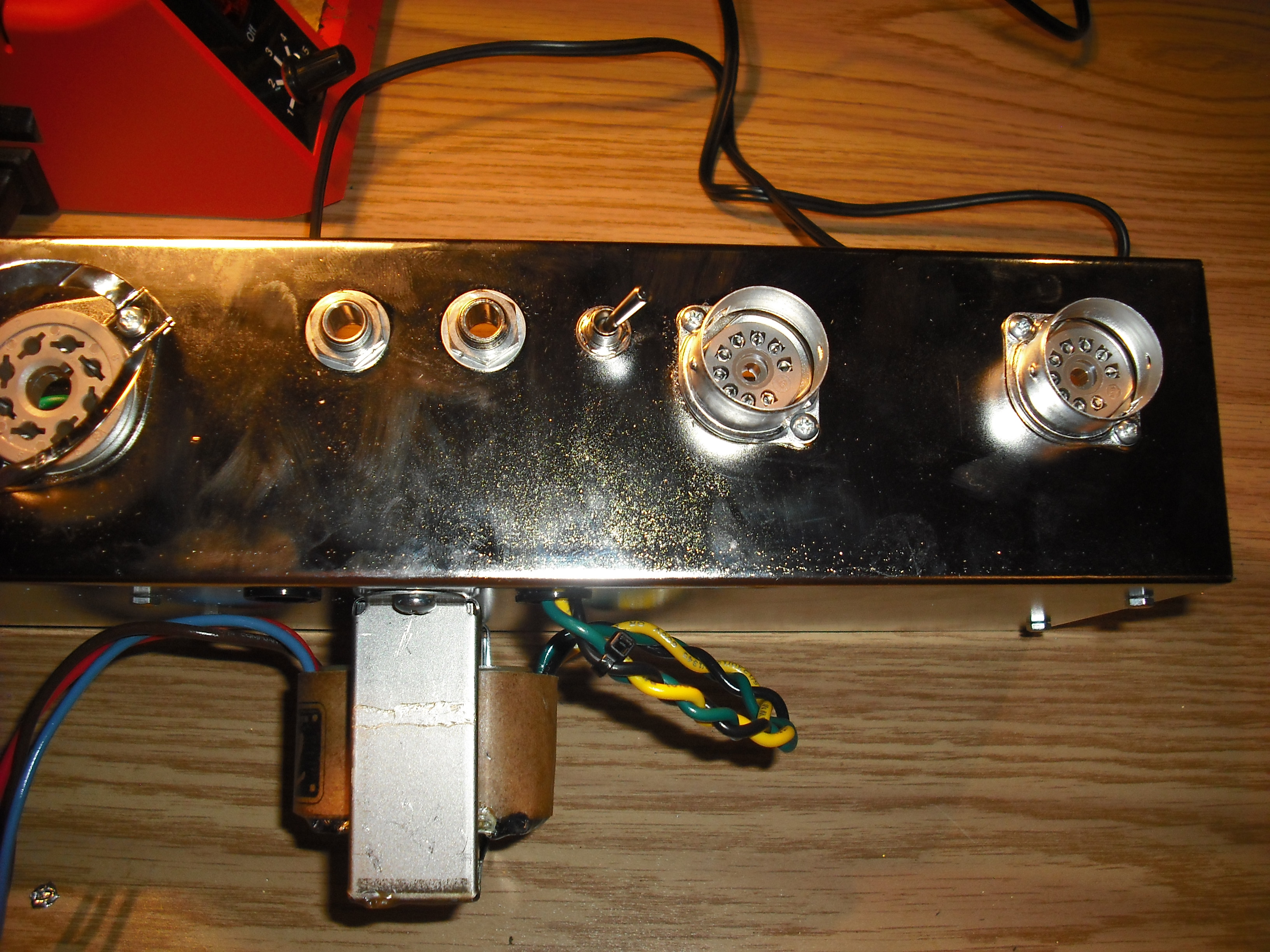

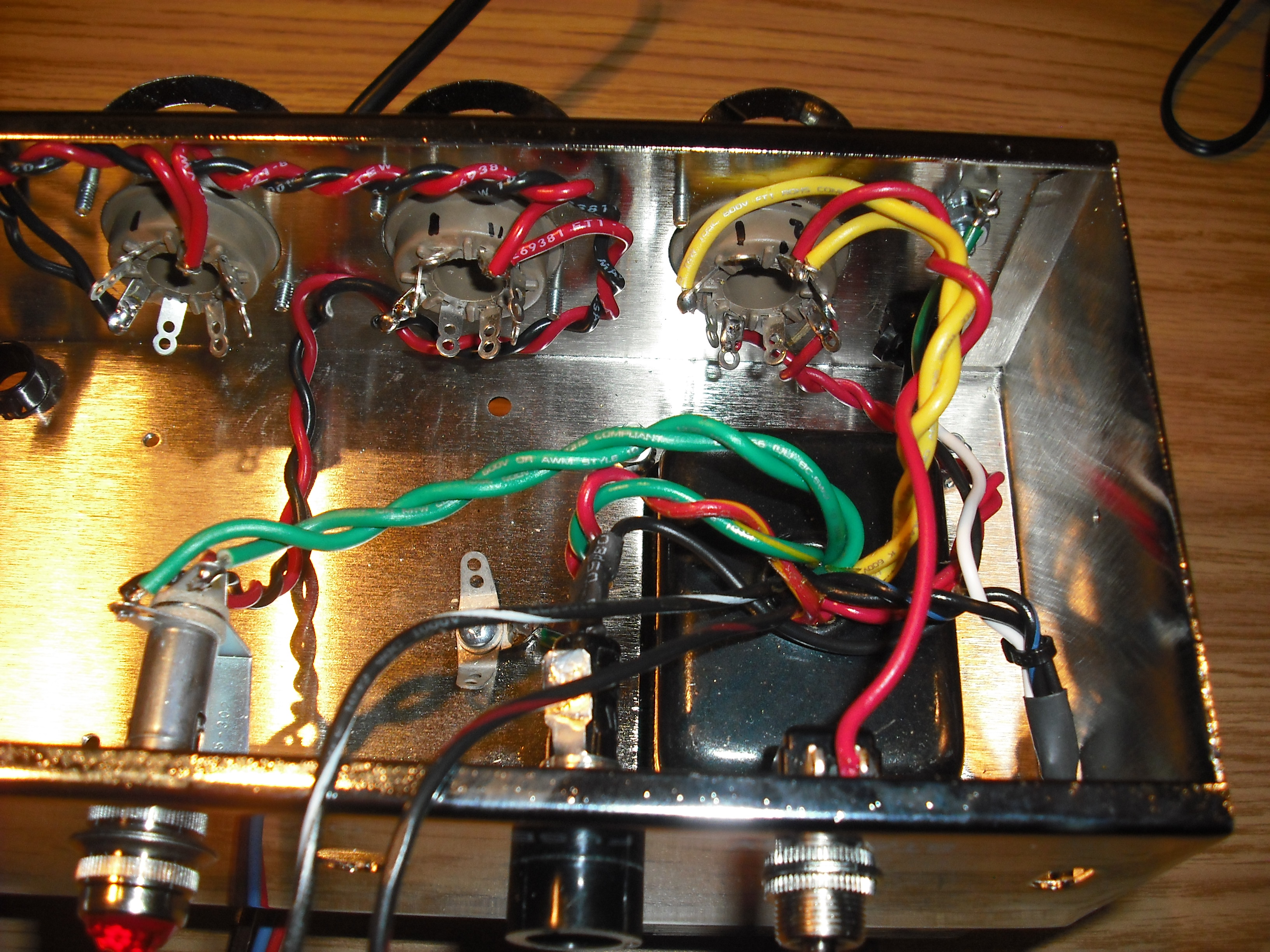

Solder up the VRM :

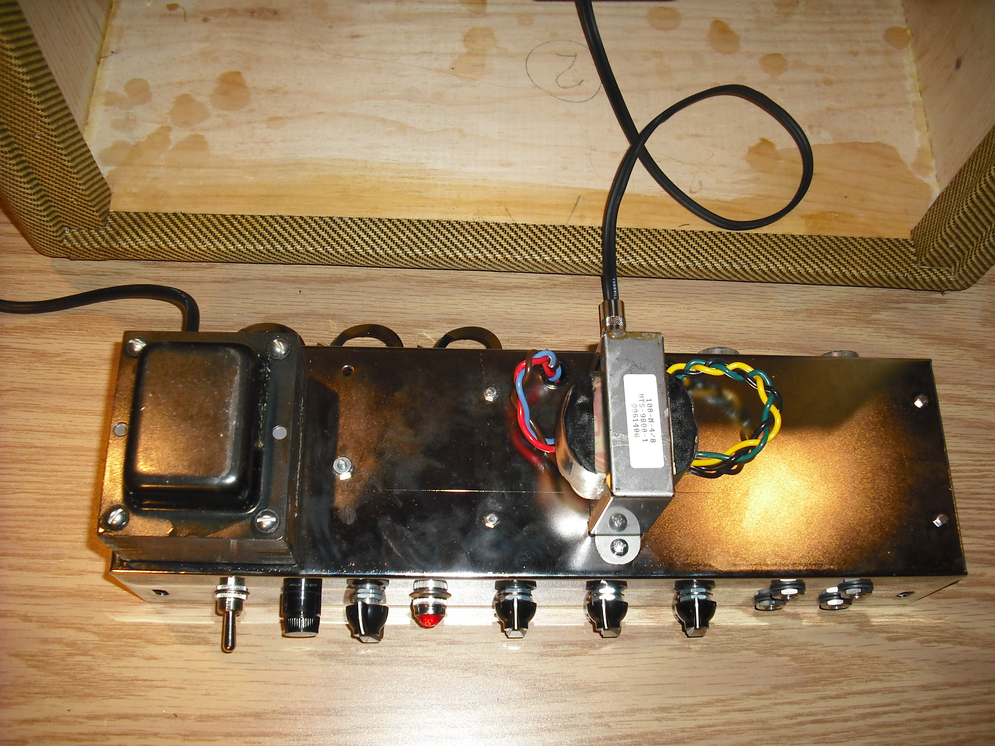

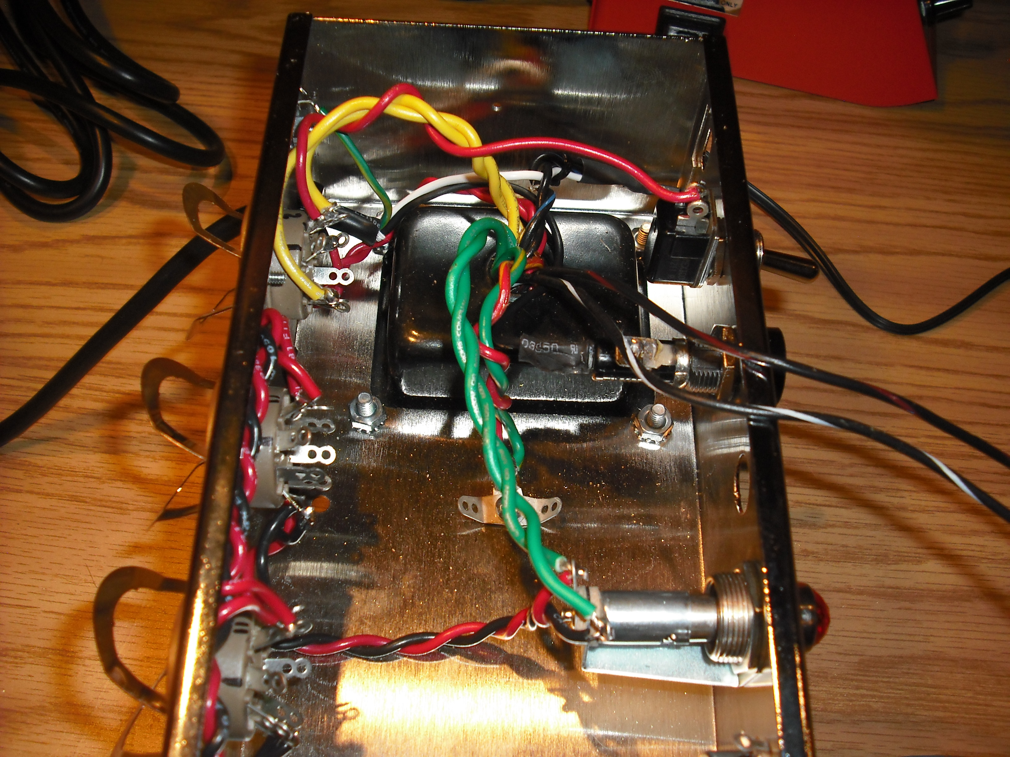

Wire up the PT and the Tube Heaters :

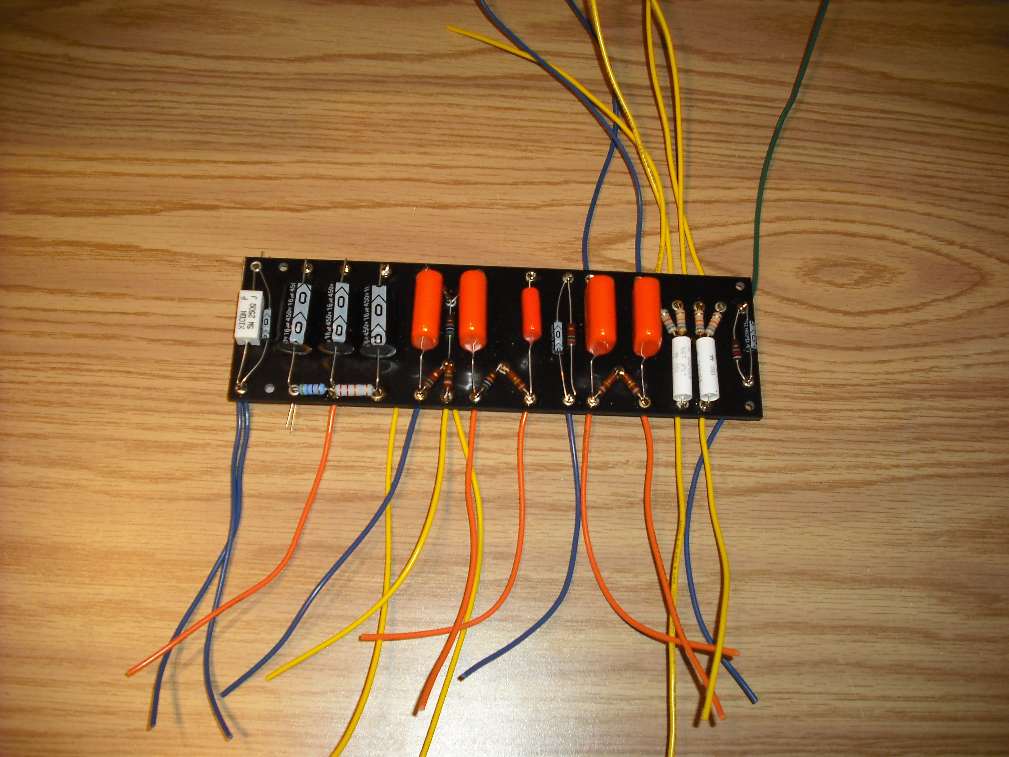

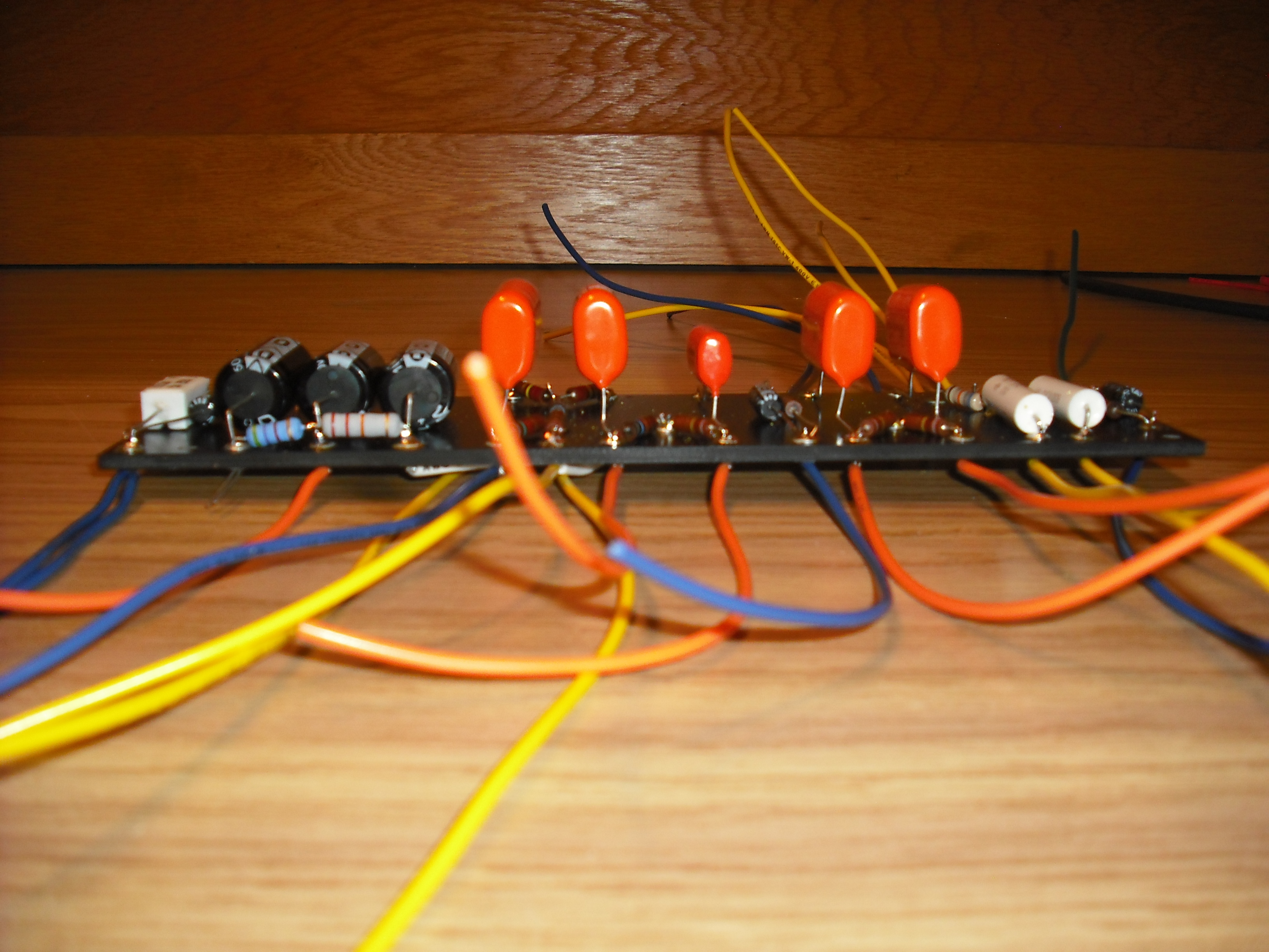

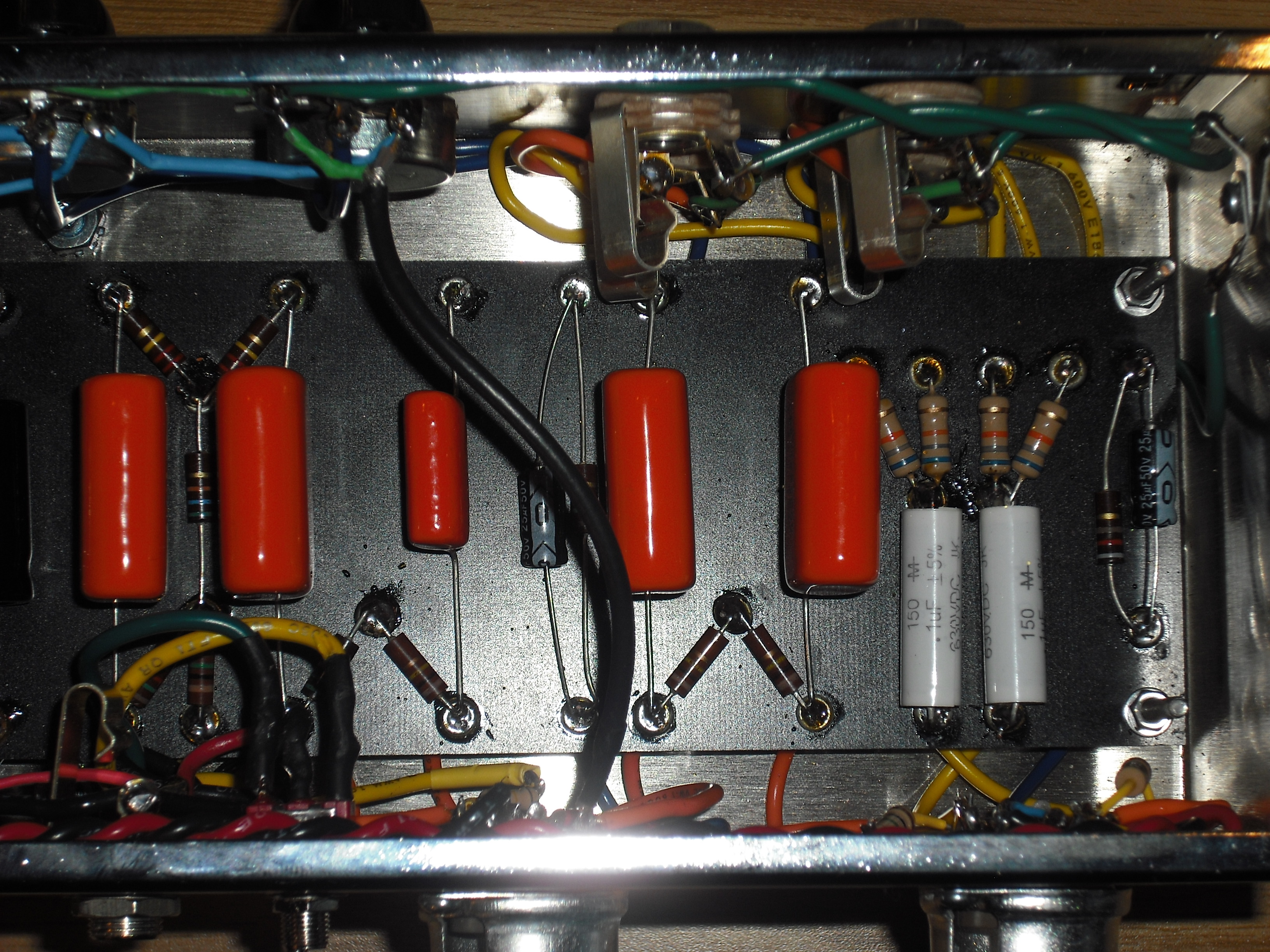

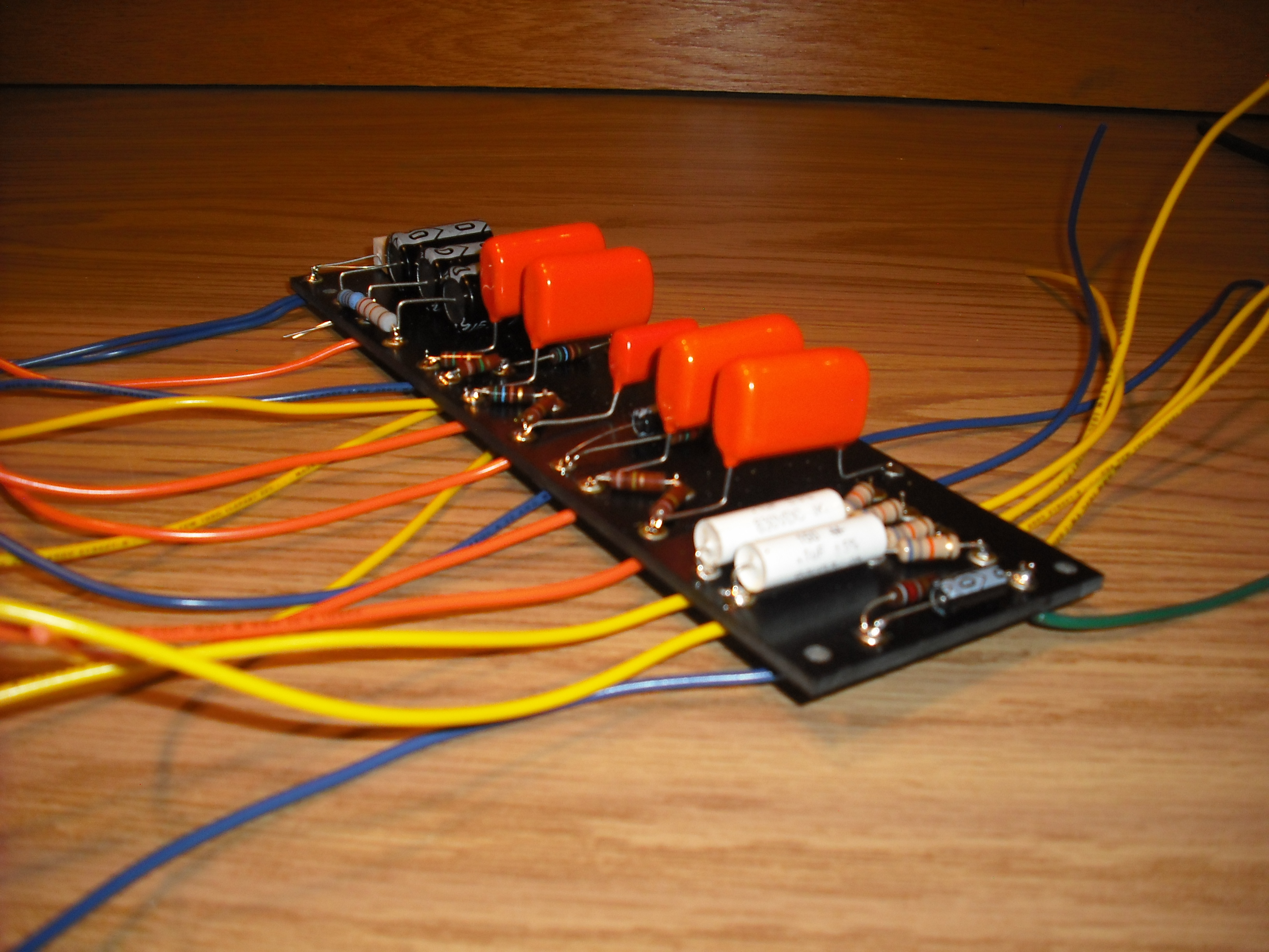

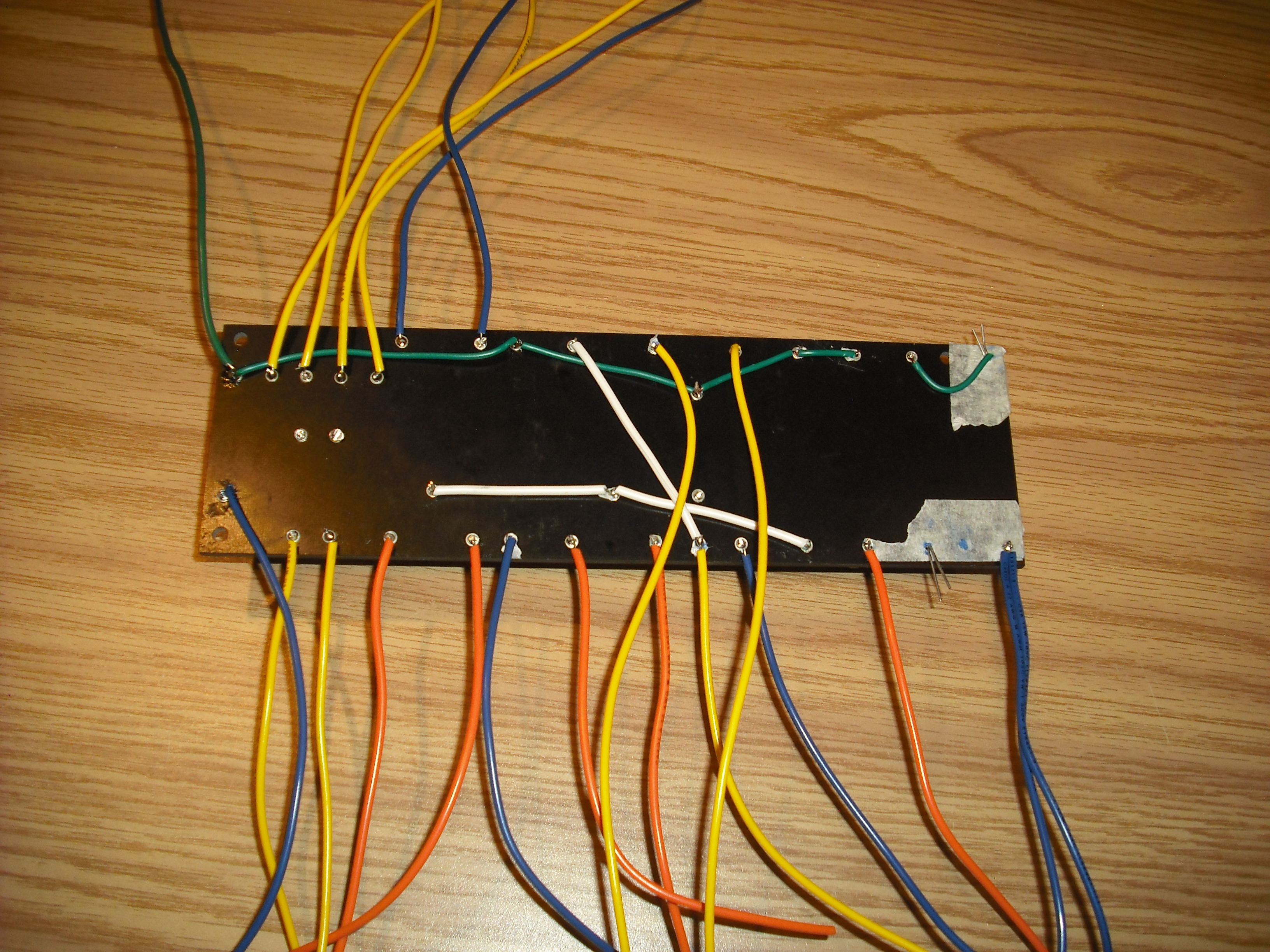

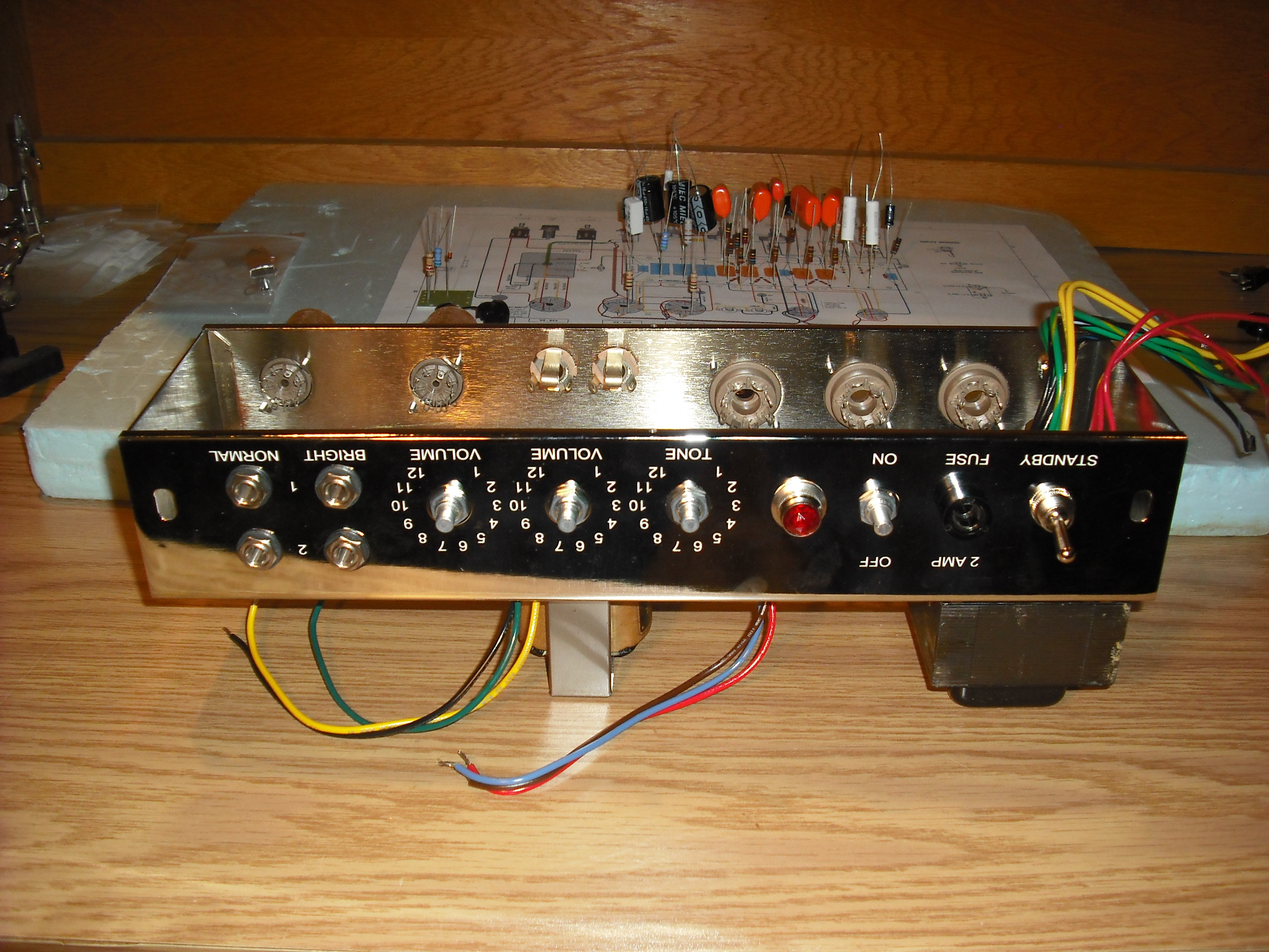

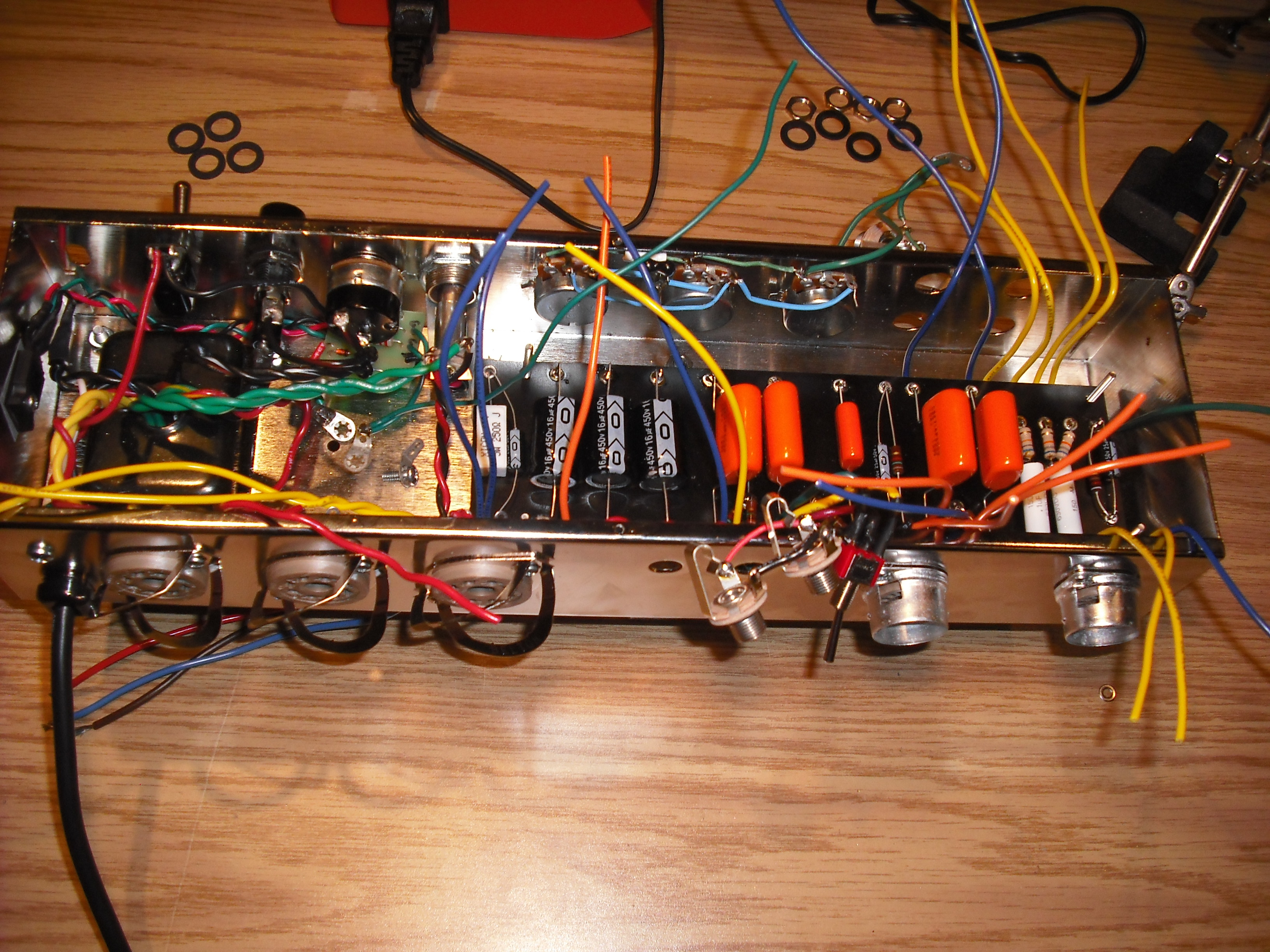

Build up the Board and Fly Wires :

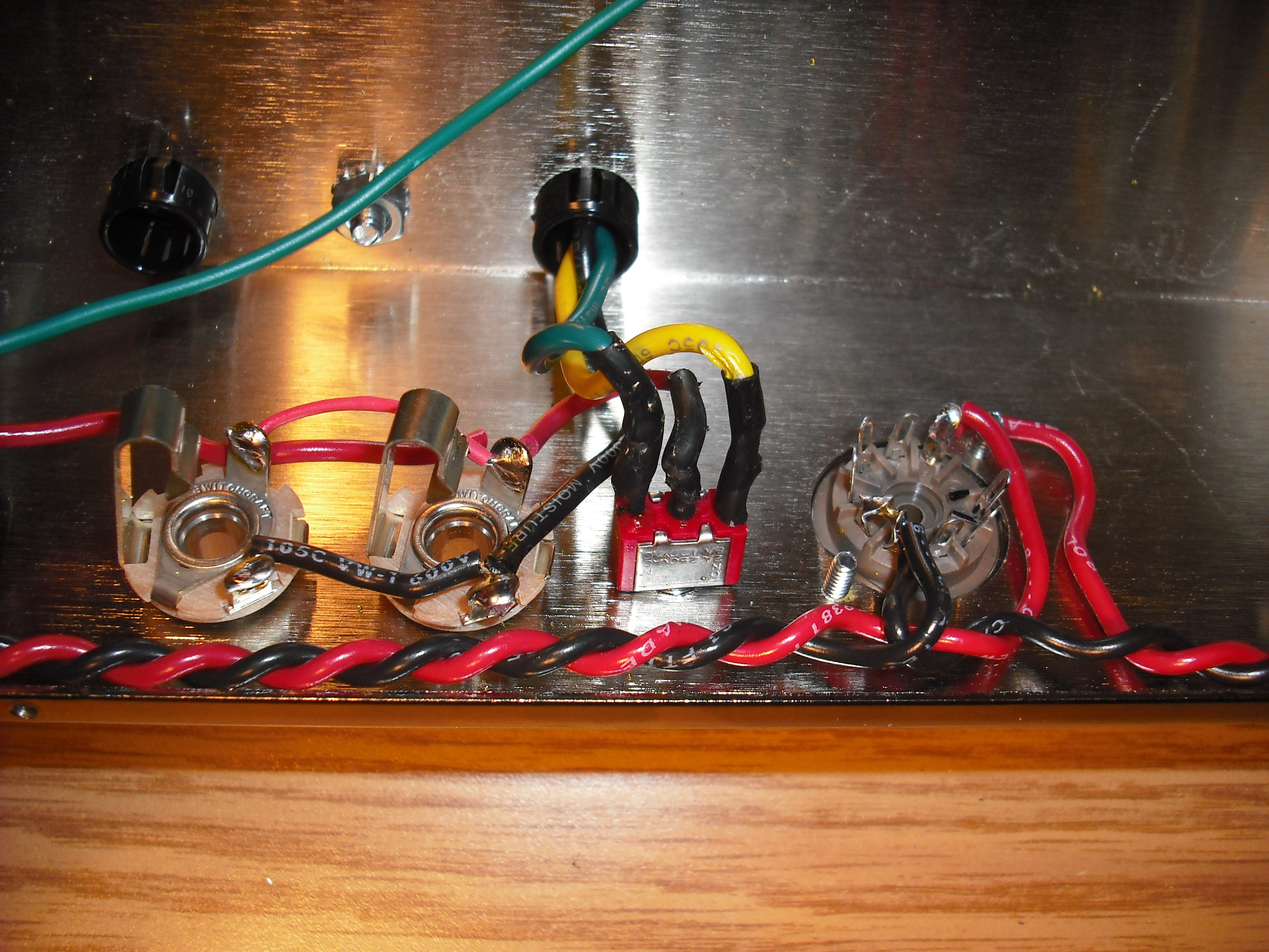

Wire Up OT 4/8 SPDT Switch :

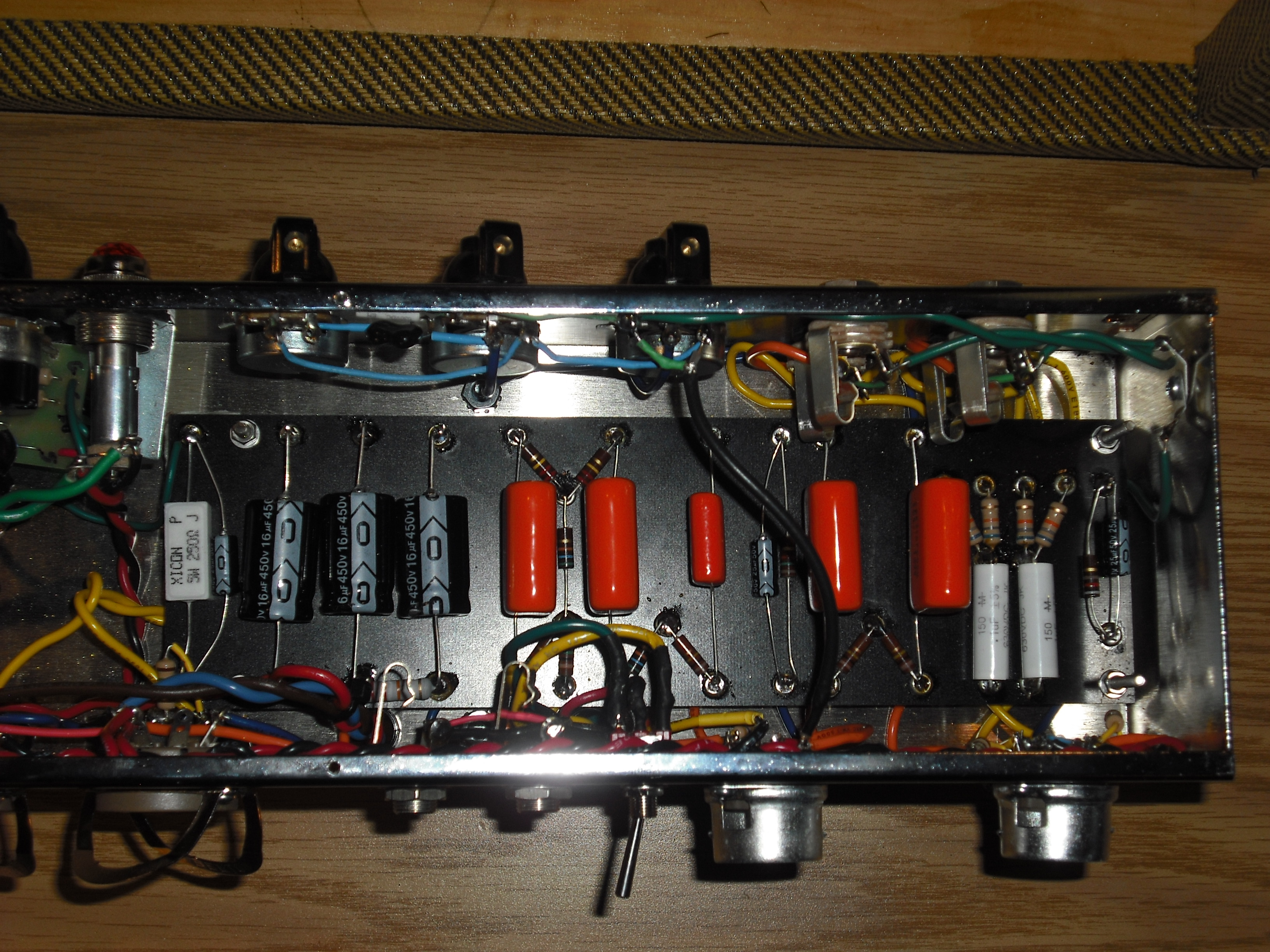

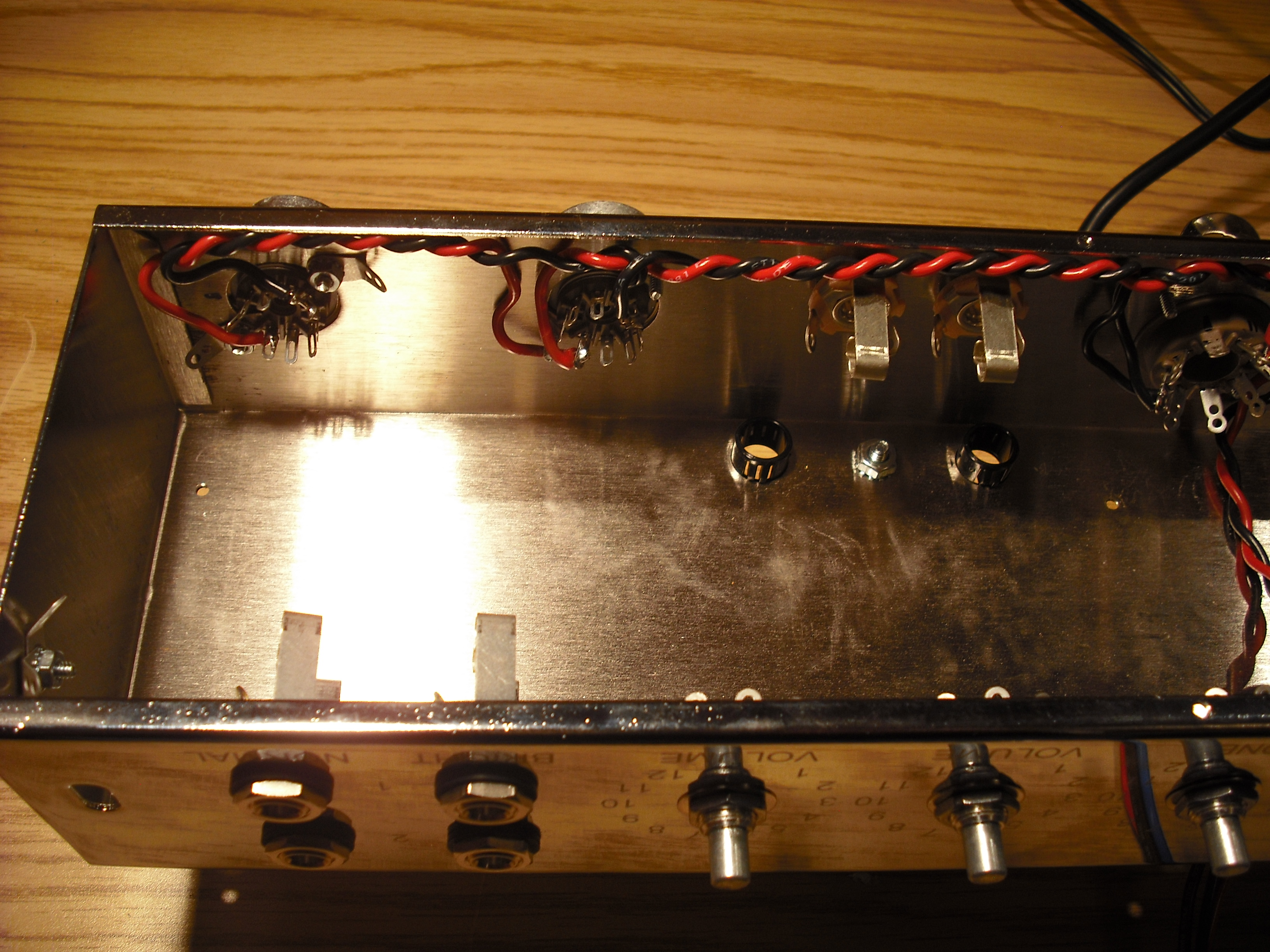

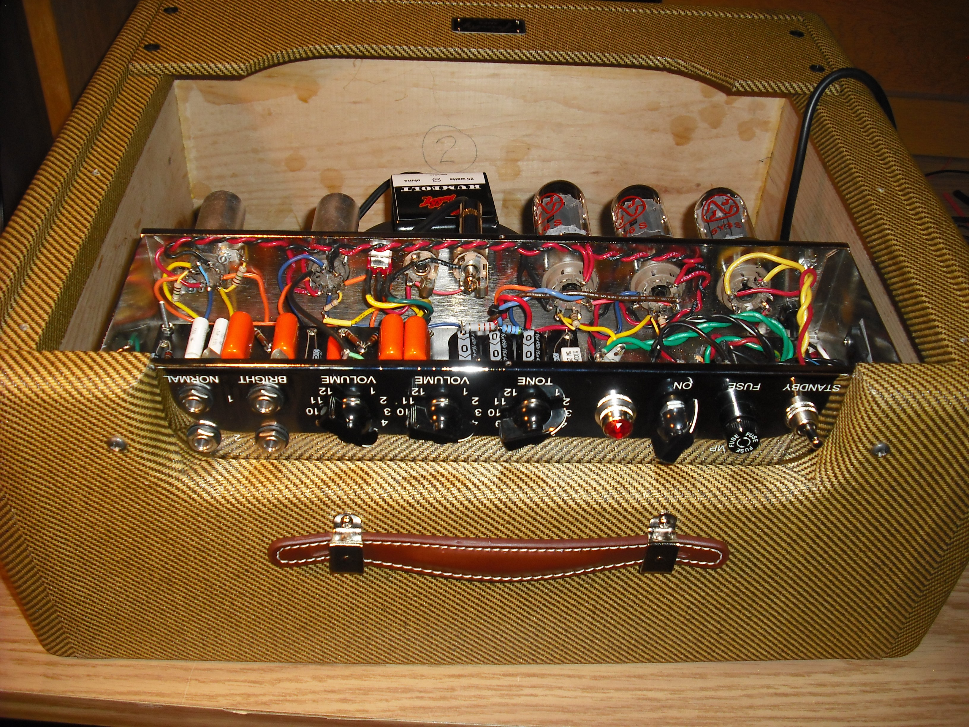

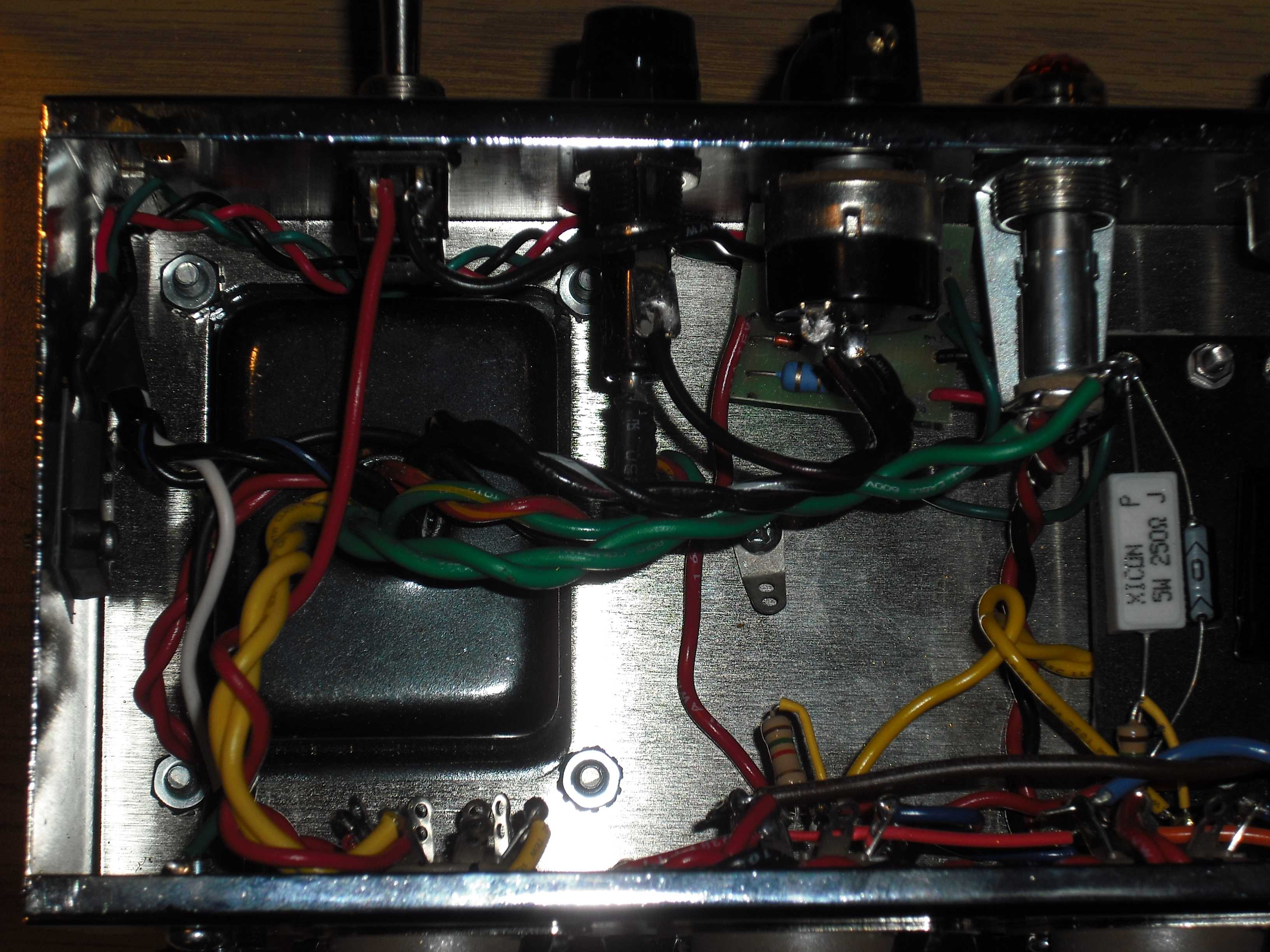

Fit Board into Case and wire up pots :
Install controls and braid OT wires :
Attach the Fly Wires :

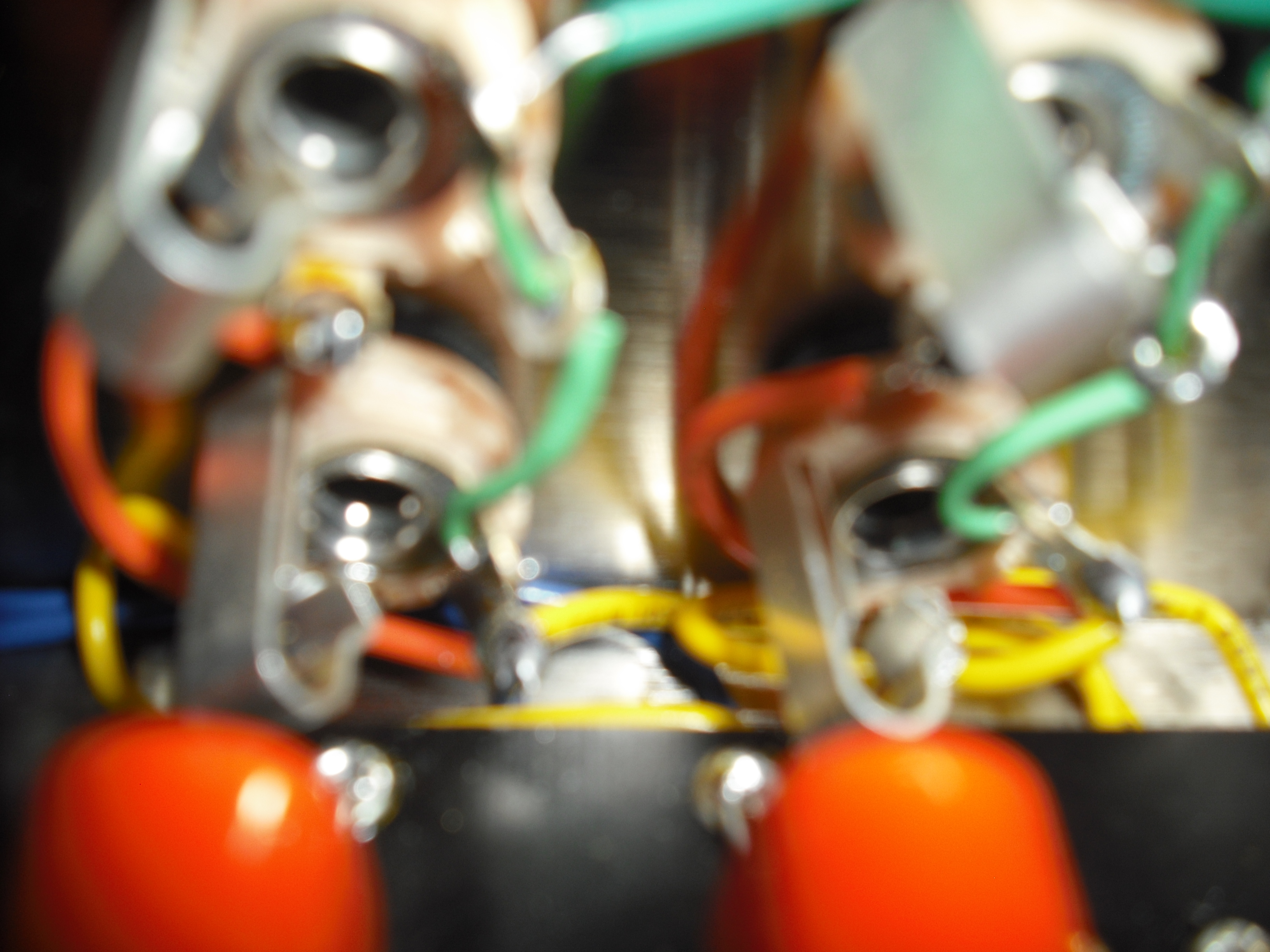

Input Jacks :

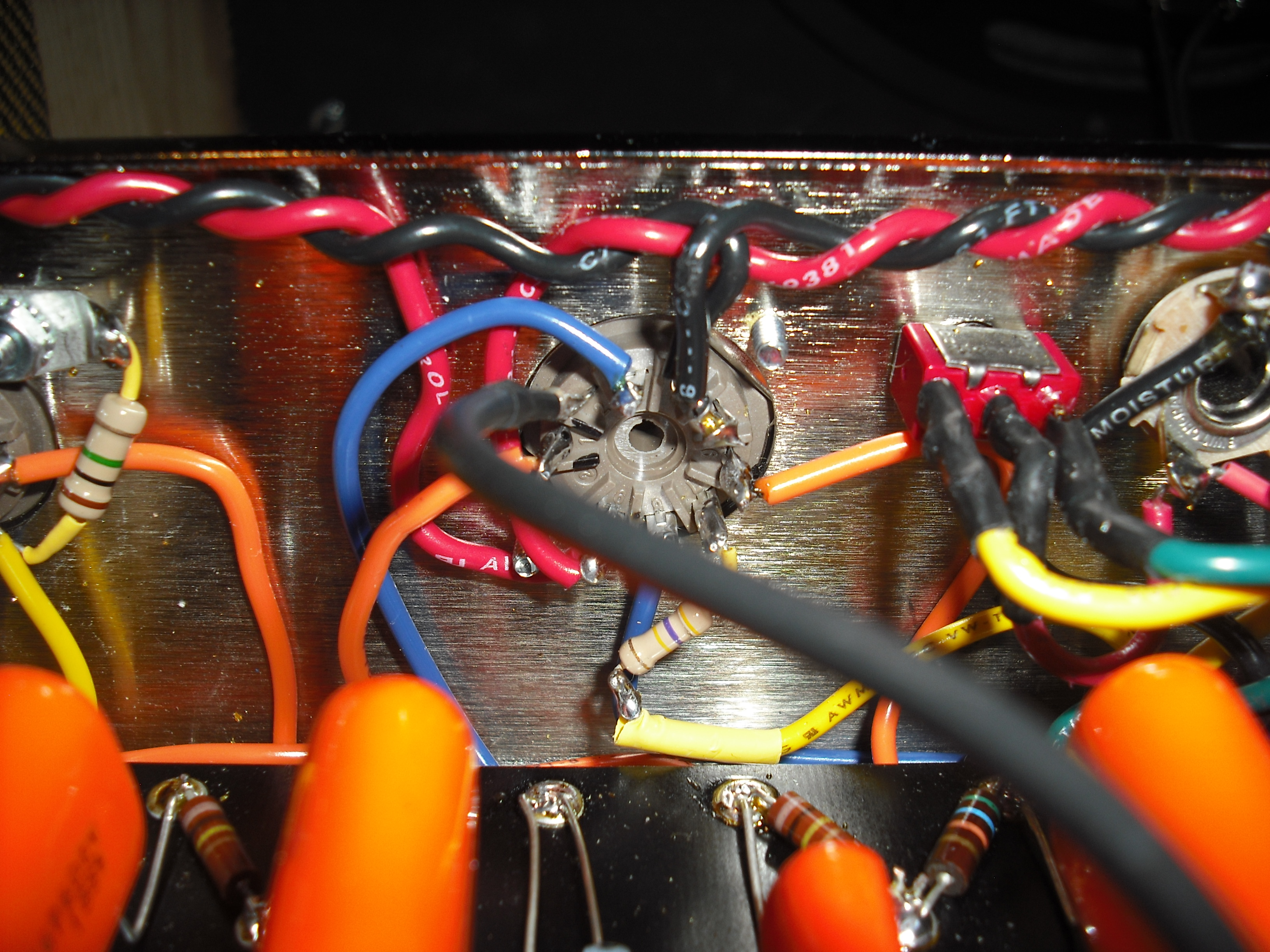

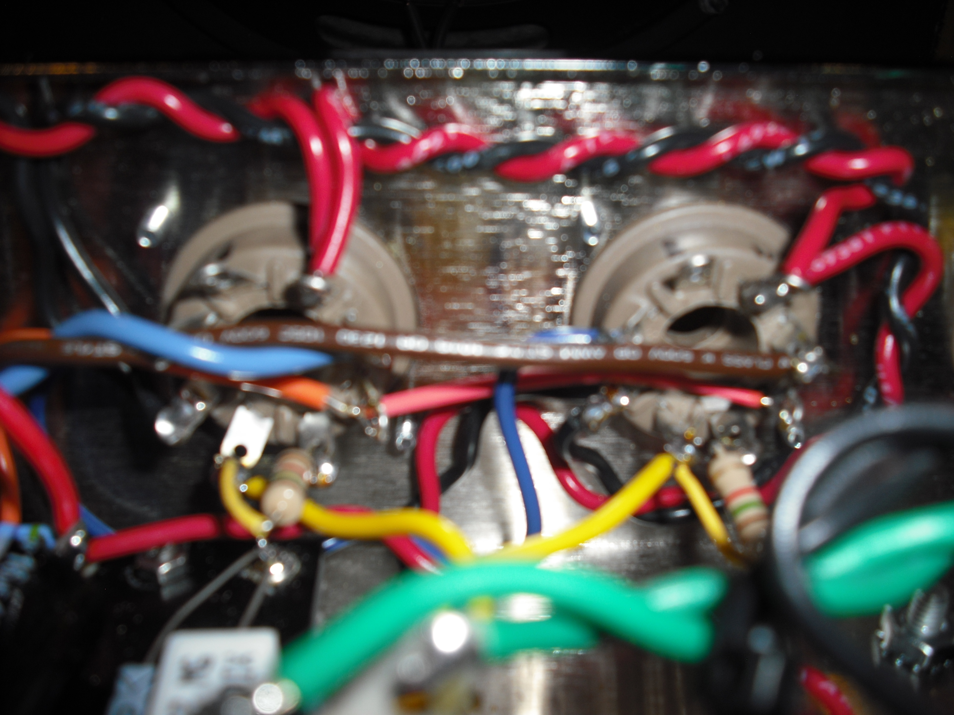

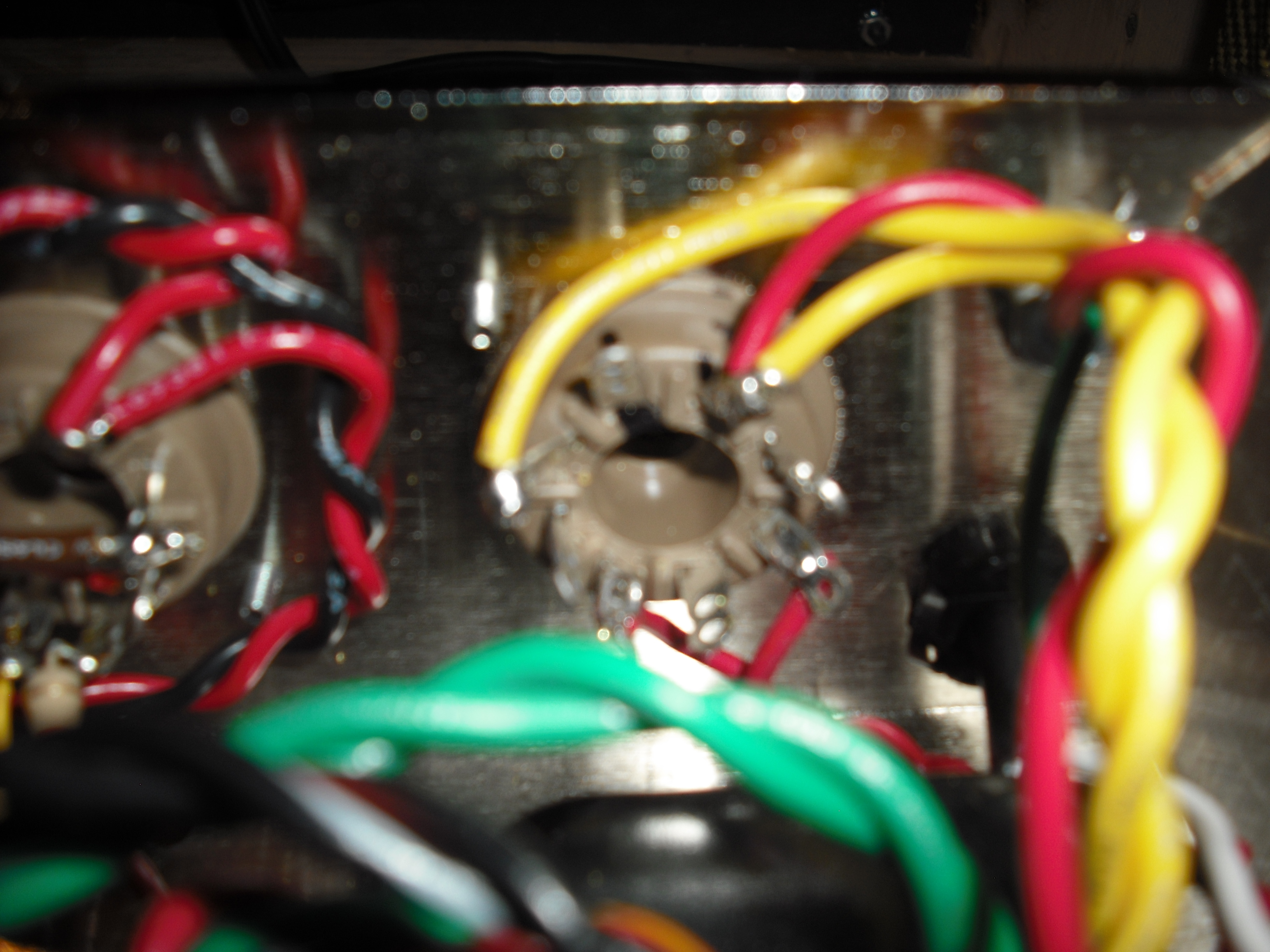

V1 :
V2 :
V3 & V4 :

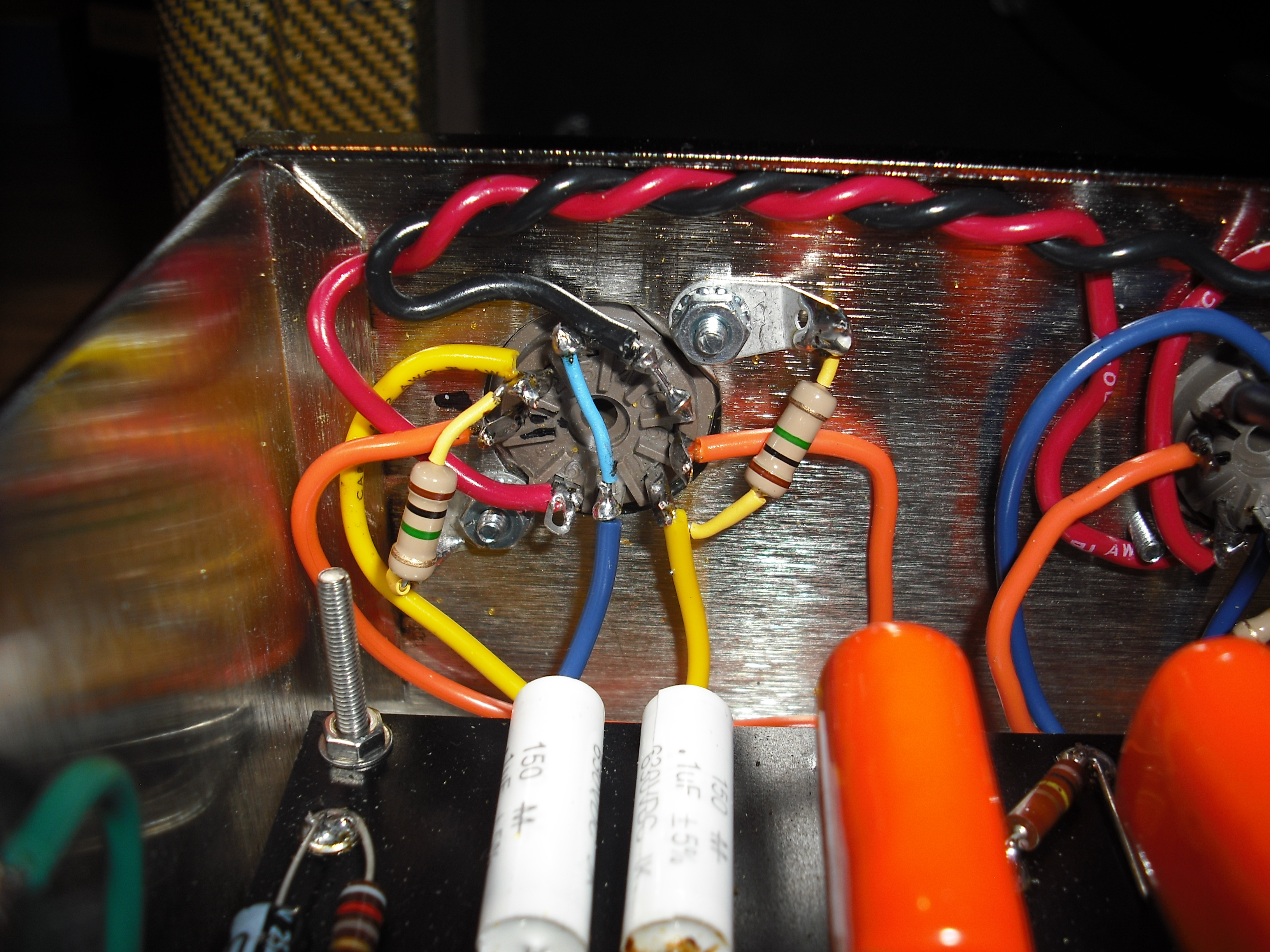

V5 : (NOTE - i and the red wire on the wrong pin and found out during my final inspection before power up - i am not sure if this would have caused any issues or not...

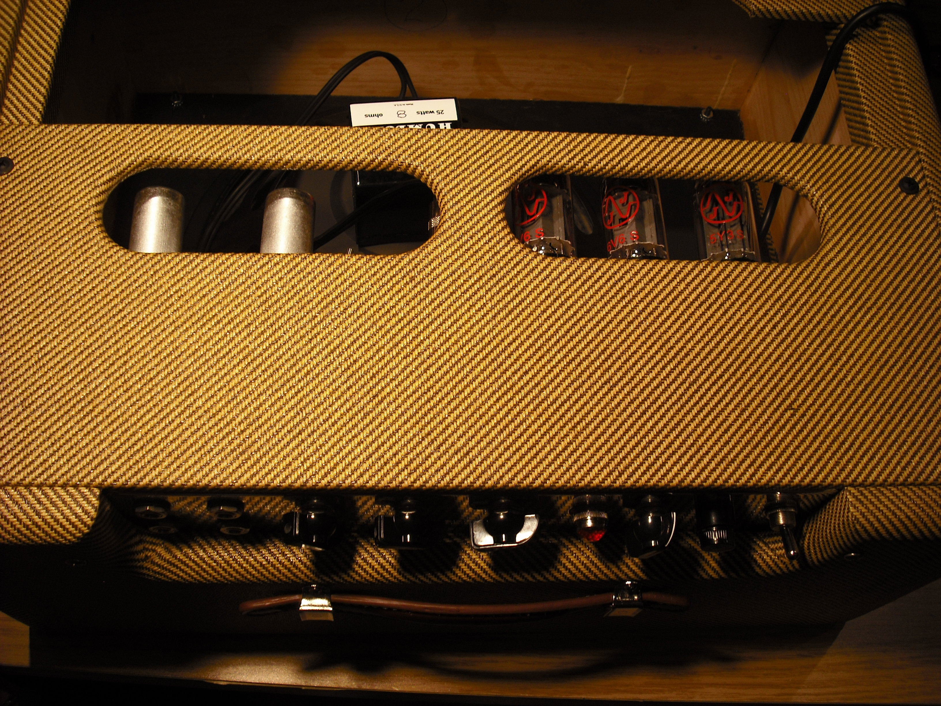

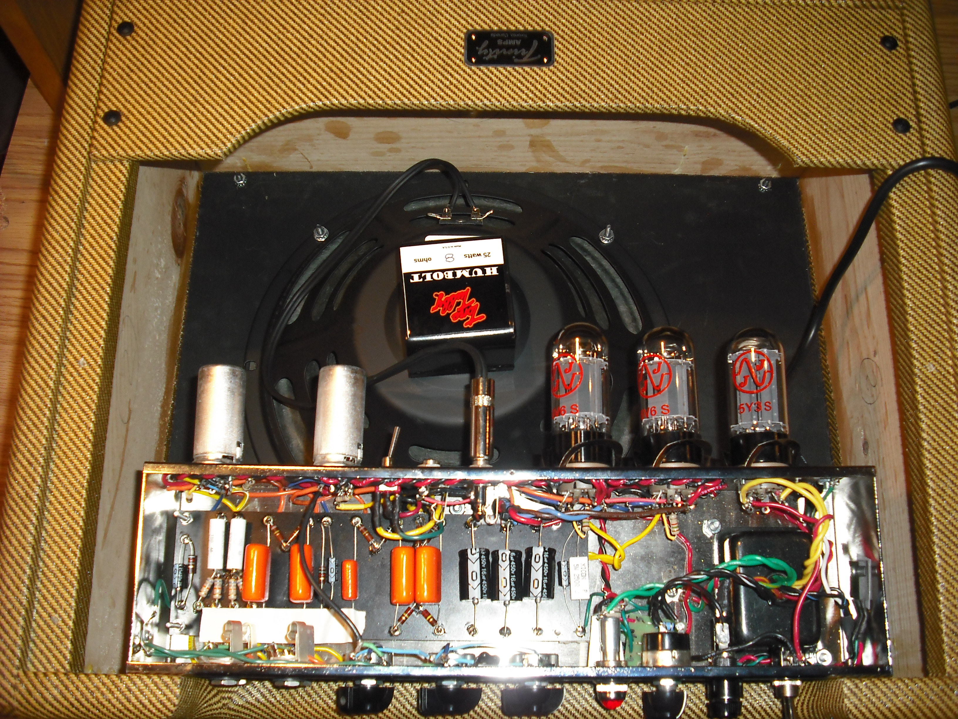

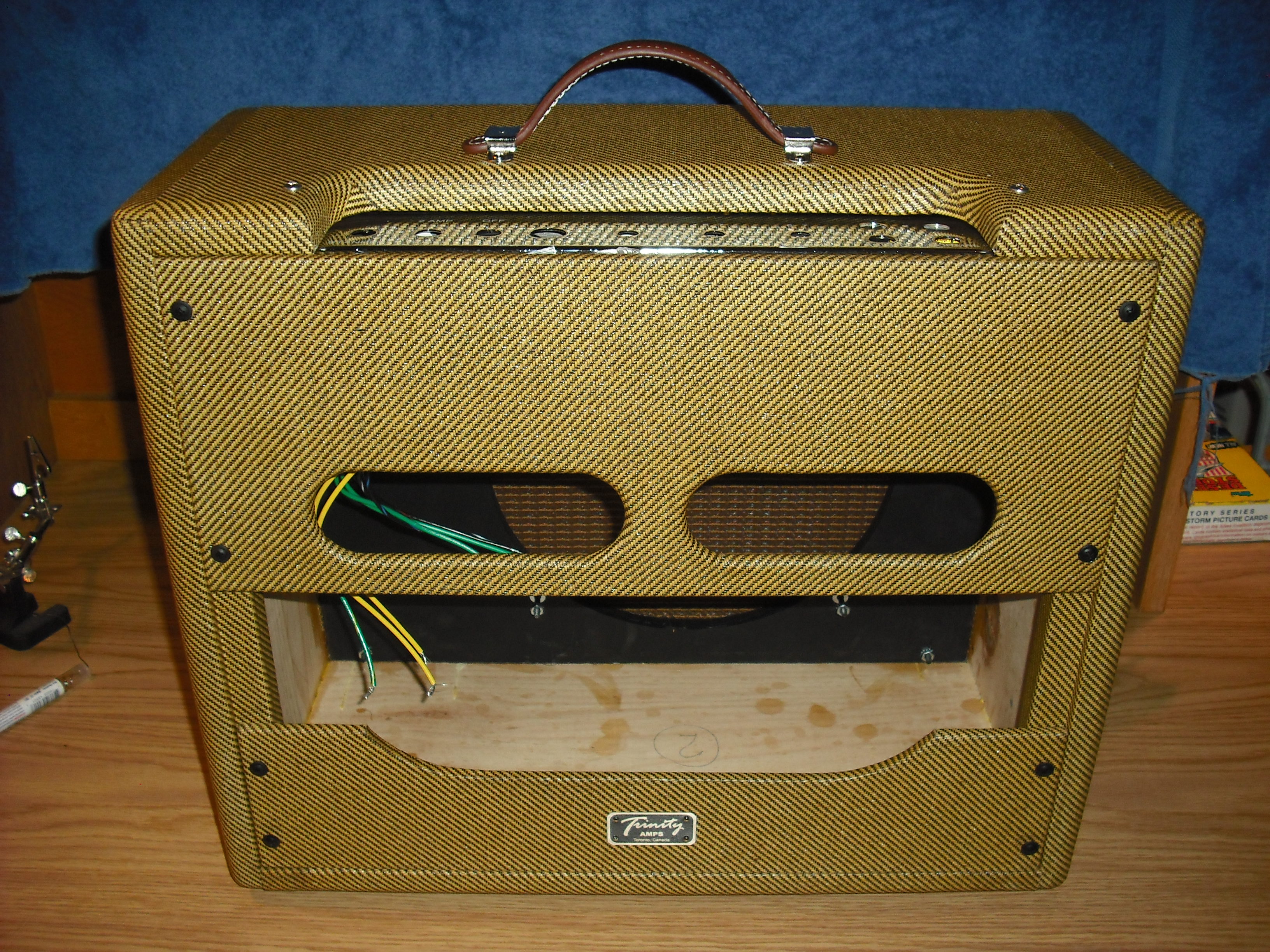

Install in cabinet :

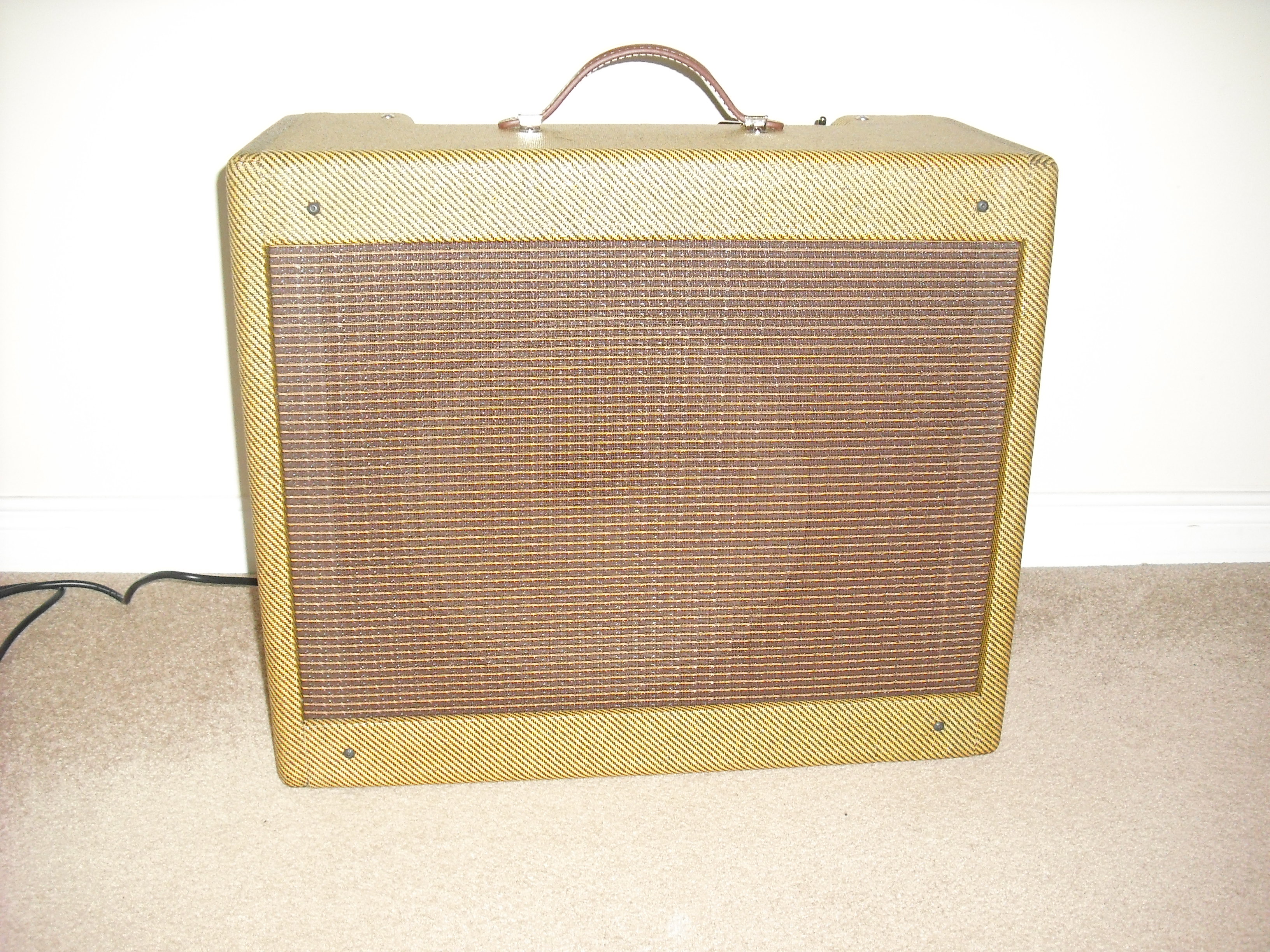

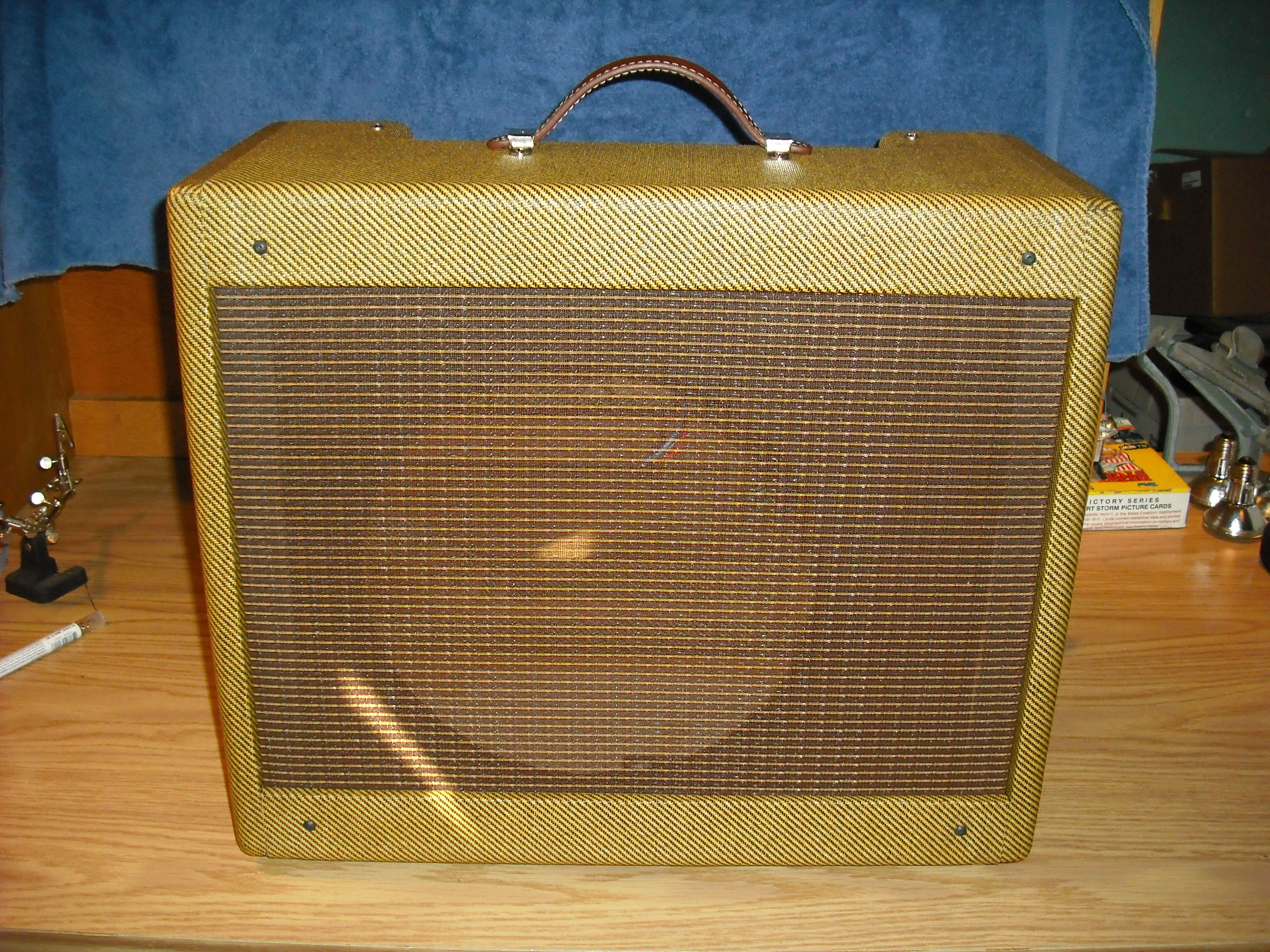

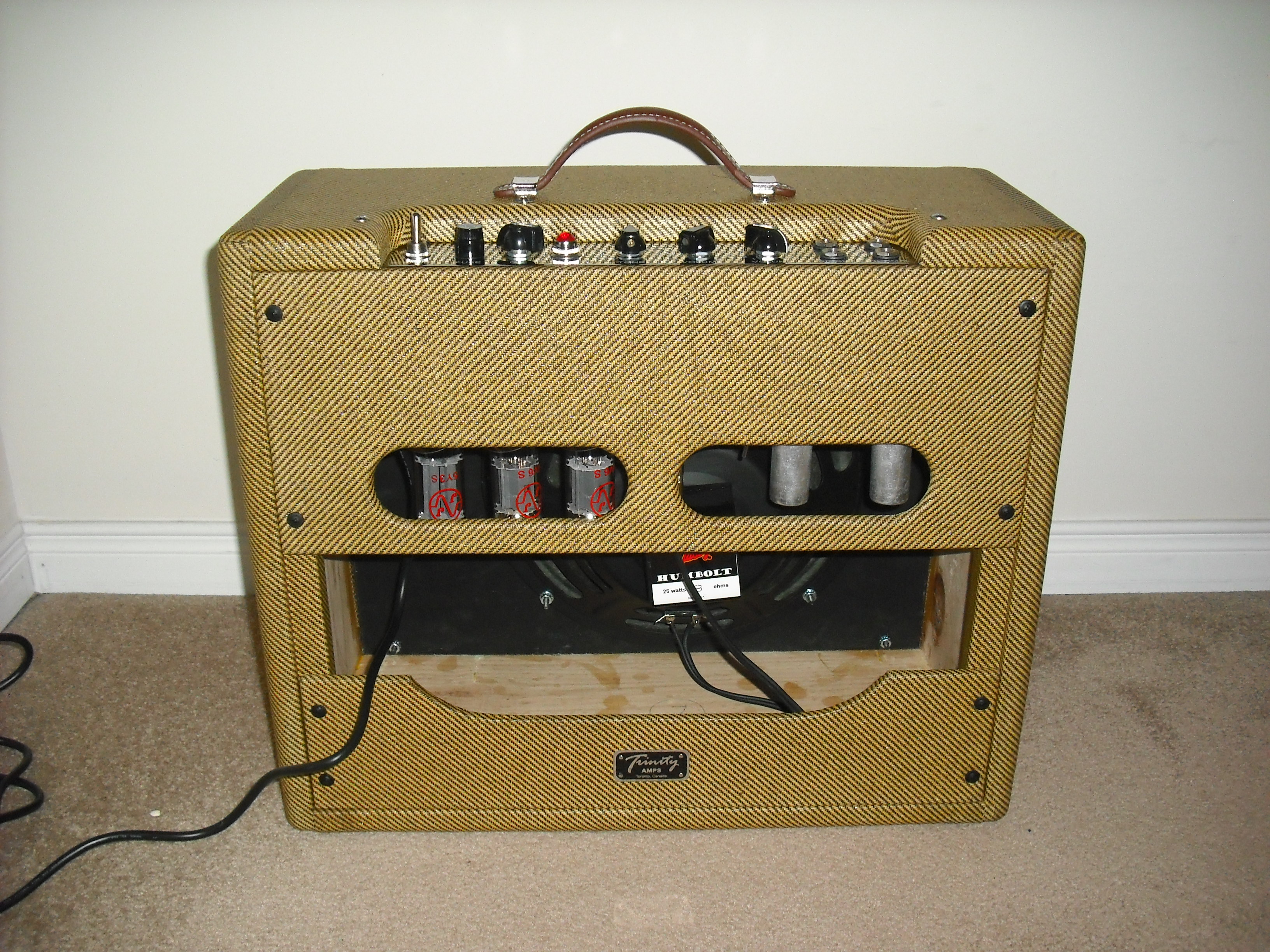

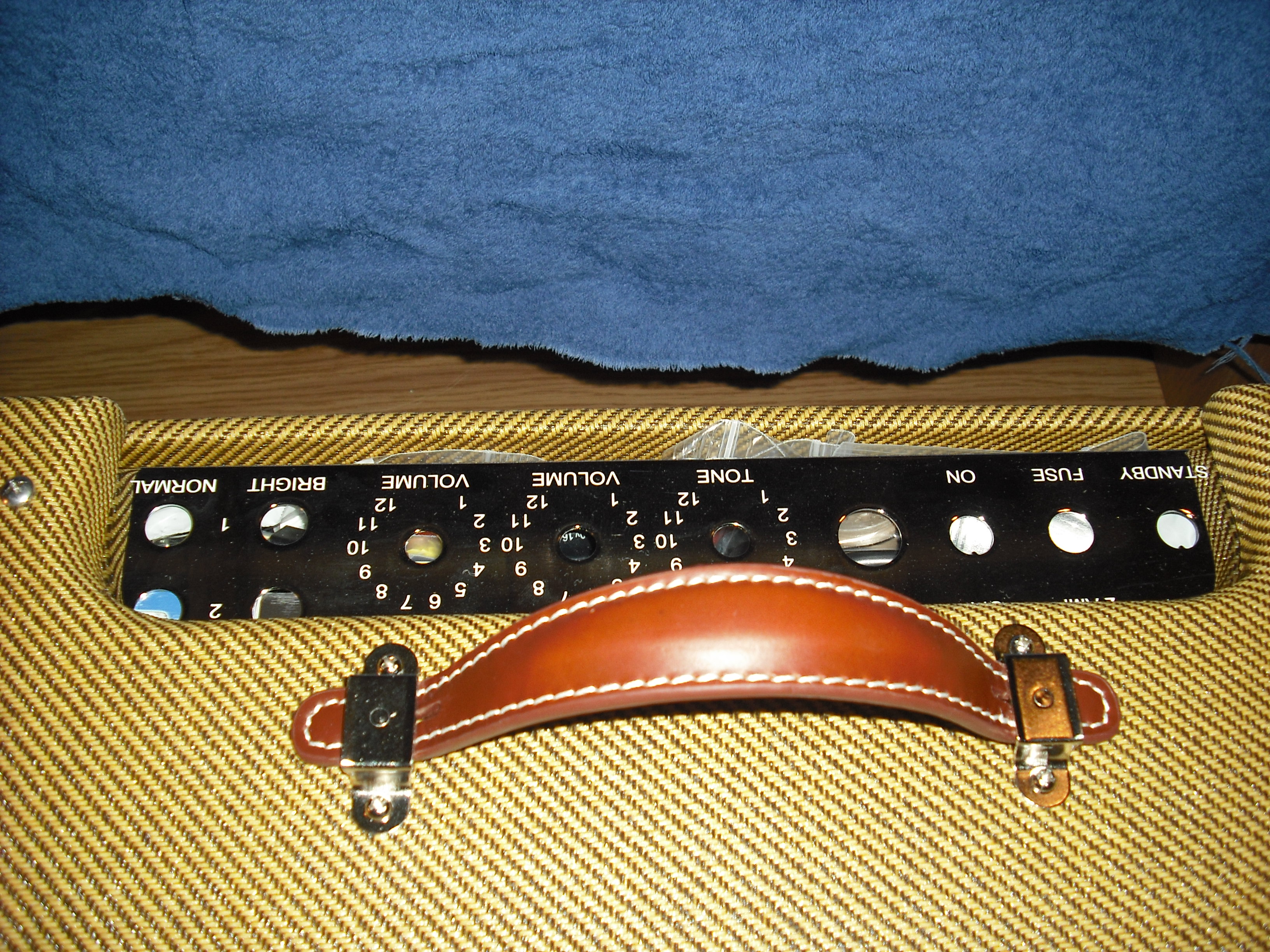

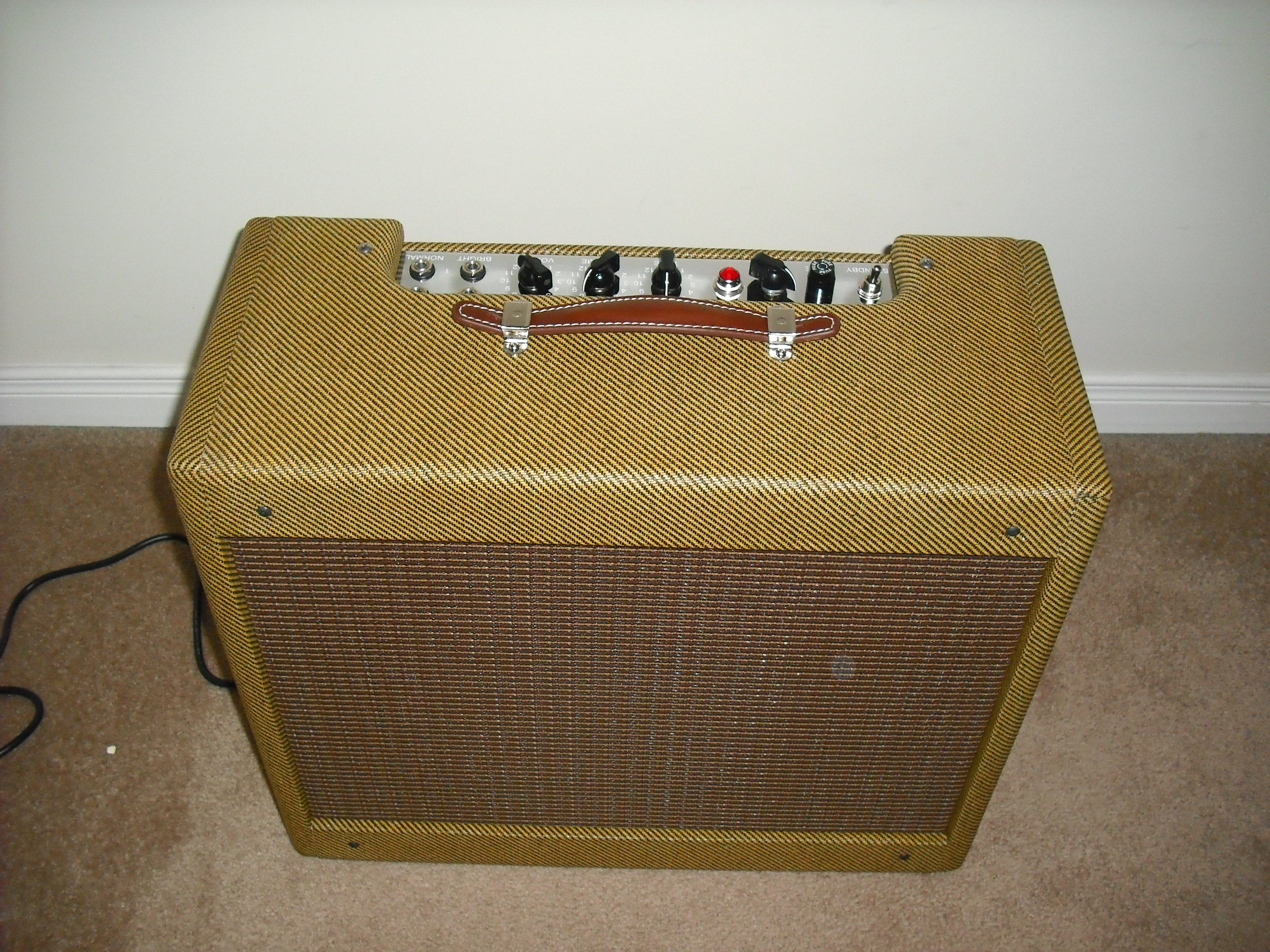

Final Pictures :

Nicely built. Looks great . How about that Tone Tubby Low Watt speaker, impressions?
 Post subject: Re: Tweed With VRM
PostPosted: Thu May 15, 2014 10:44 pm
Posts: 49
I am very impressed with the speaker and Connie is really happy with the VRM...
