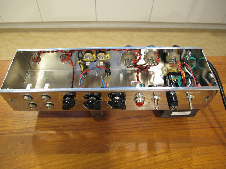

I'm surprised you don't have enough heater wire. Stephen usually provides more than enough wire with the kits. Check your heater runs and make sure they aren't too long.
You could use the PT wire if you have enough left over. The key thing is to twist it together tightly. Stranded wire like the PT uses won't twist together as well as solid core does. I would use some of the solid core wire instead if you only need a few inches. Check your lengths to make sure you have enough to go from the board to the tube sockets and controls, then see how much you have leftover.
Even though heaters only use 6.3 volts, for safety all wire in the amp should have insulation that's good to the highest voltage in the amp. You could use 22 gauge wire for the heaters. I do that with my scratch built amps. It has more than enough current carrying capacity. 18 gauge is too thick and hard to work with.
Good luck with your build!

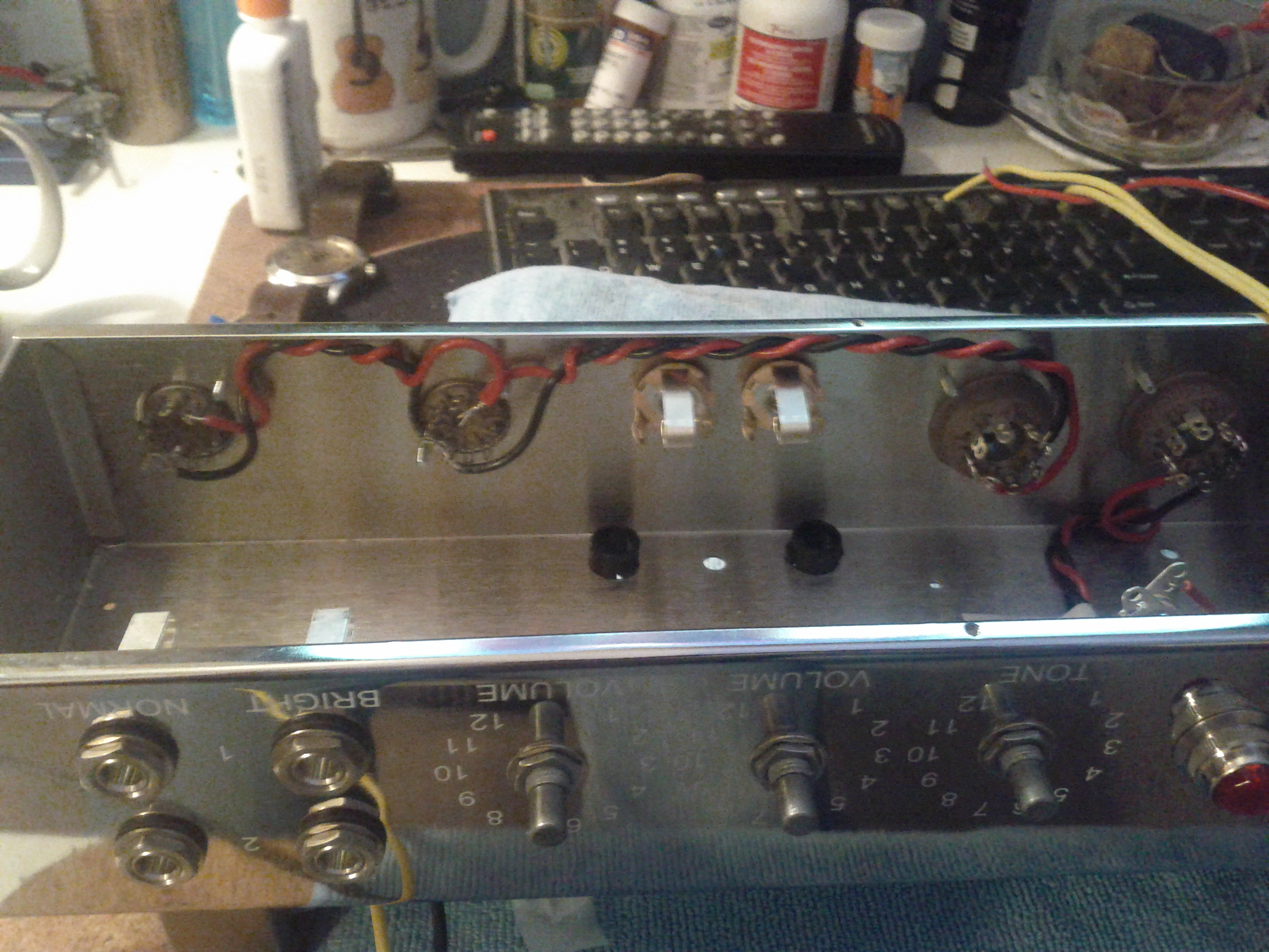

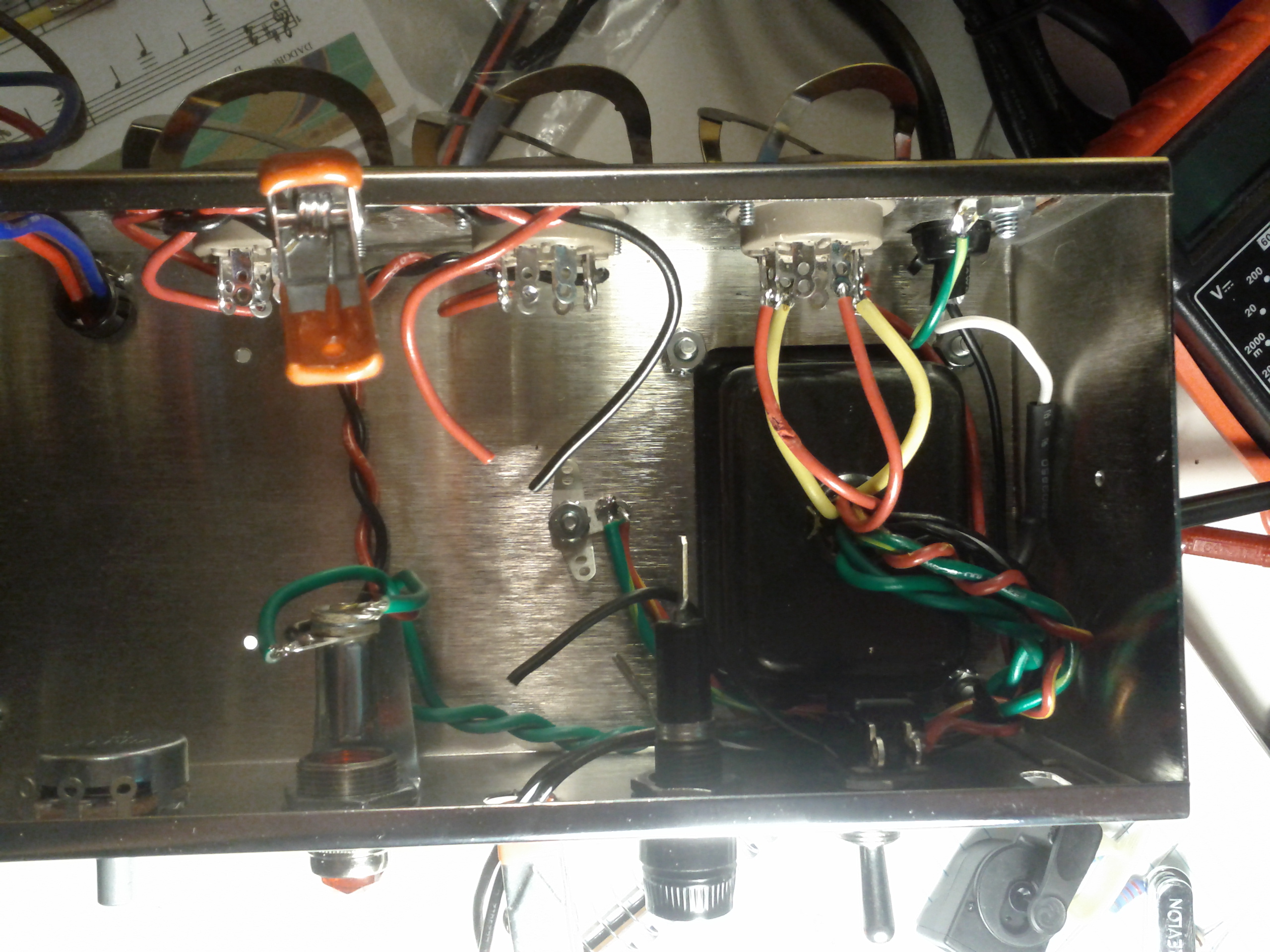

No, user error while cutting the wire. If its ok to use the left over wire from the PT, I'll finish it that way. I've attached a few pics of where I am curently at. just finished wiring up the PT
 Post subject: Re: Tweed - First Build
PostPosted: Sat Oct 12, 2013 8:51 pm
Looks good. Too bad about running short of the black and orange wire for the heaters.

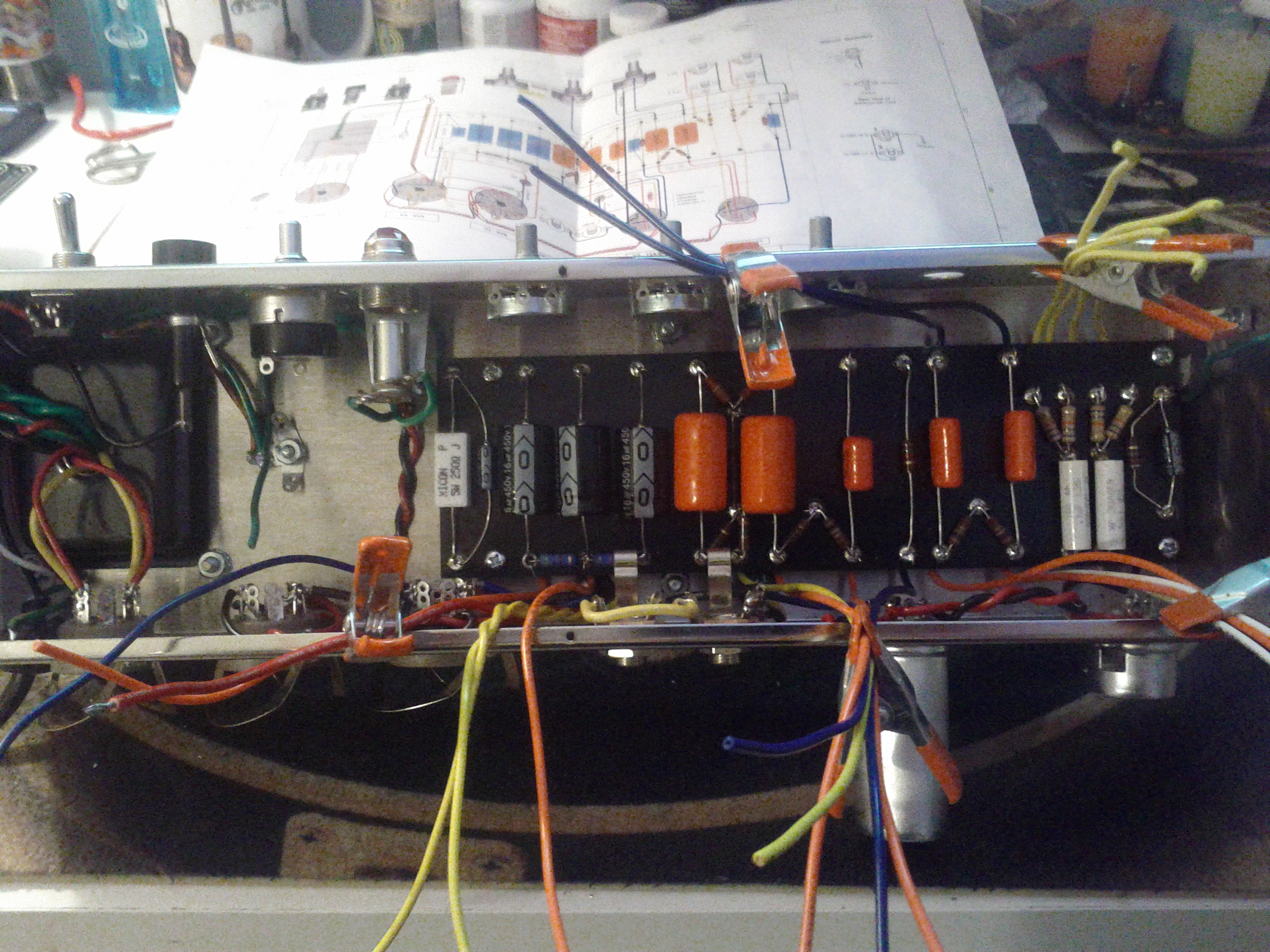

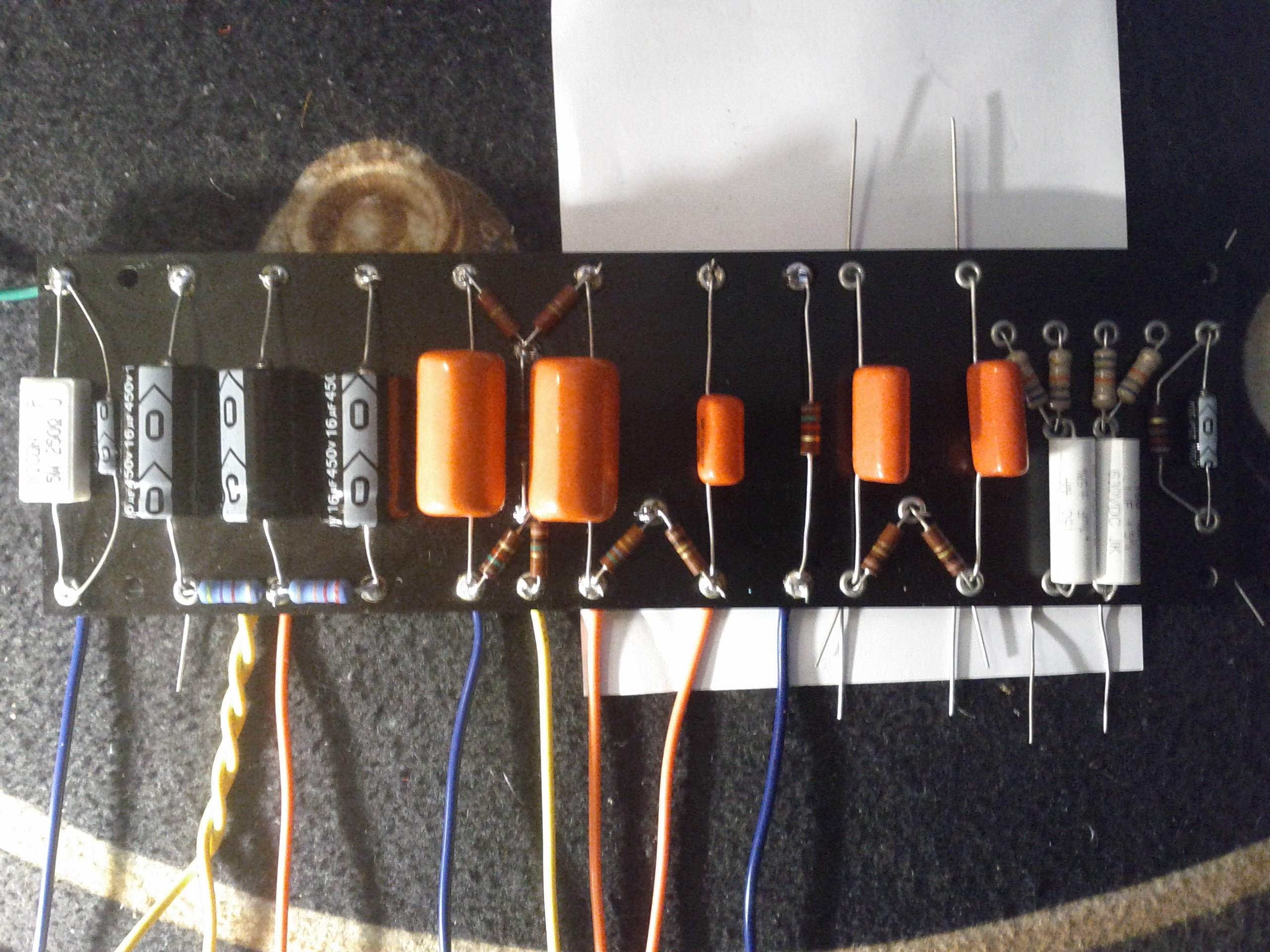

Moving along on the build. I finished wiring up the OT and PT. and am finishing up the board. I've included a picture below.
I have a quick question about VRM install. I want to ensure there is no polarity on the DC blocking caps before I solder into place.
Also, want to confirm that I am moving the 1m jack resisters to the tube grid on pin 2 & 7.
I am also doing the vol/tone mod which is evident by the .022 caps and the absense of C7.
PostPosted: Wed Oct 16, 2013 10:04 pm
Looks good
Yes, 1M grid leak right on the tube socket.

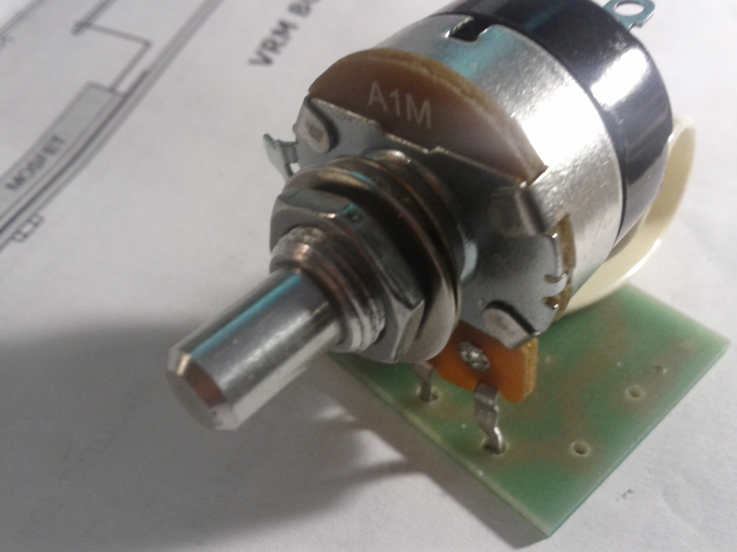

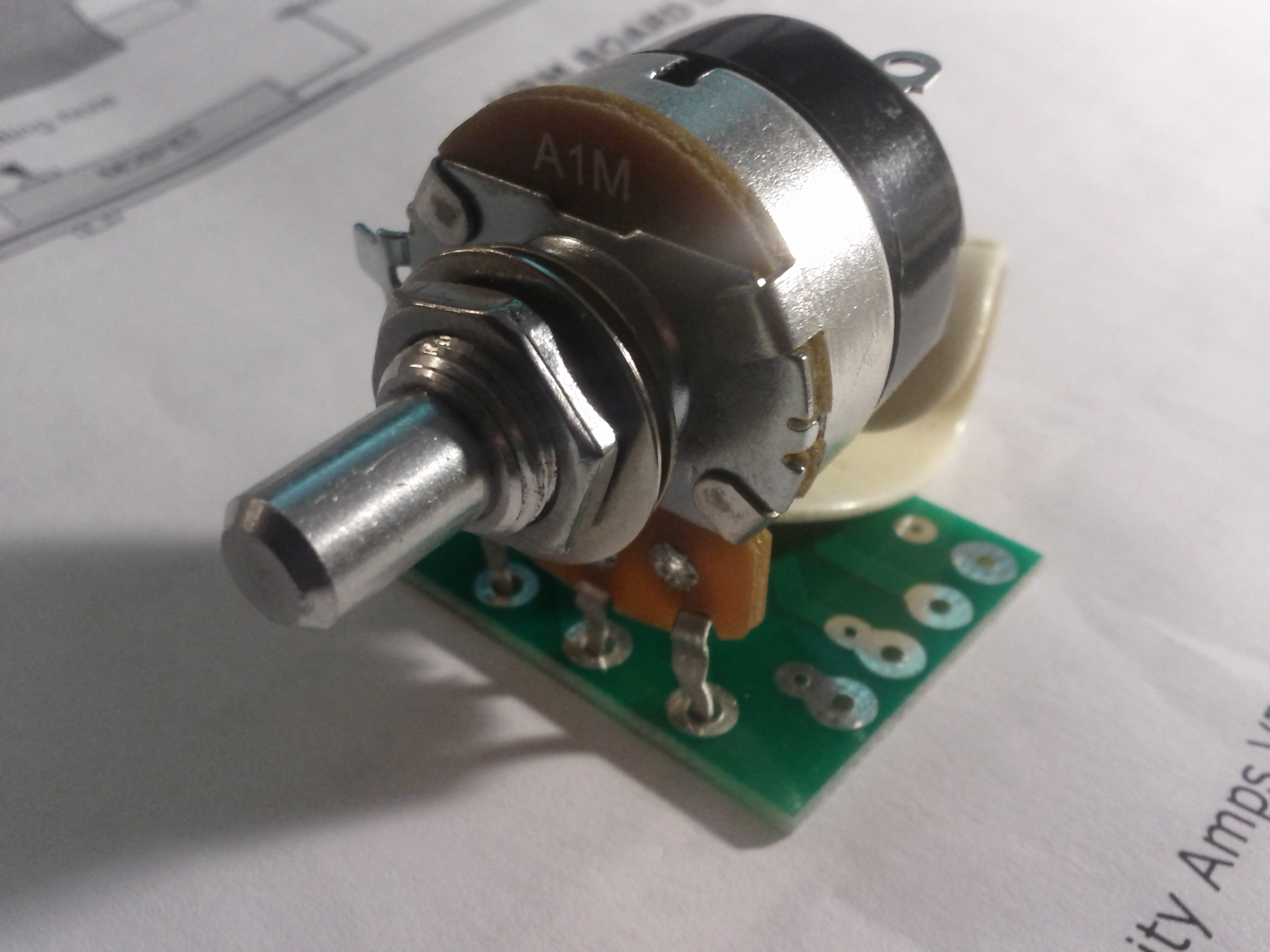

I am a little confused putting the pot onto the PCB for the VRM. Which of the two attached pics is correct?
I also got the circuit board finished and installed into the chassis.
Thanks for any assistance.
File comment: shiny side of PCB
File comment: unfinished side of PCB
File comment: Board installed in Chassis
PostPosted: Sat Oct 19, 2013 12:28 am
Unfinished side up, as in the second picture.

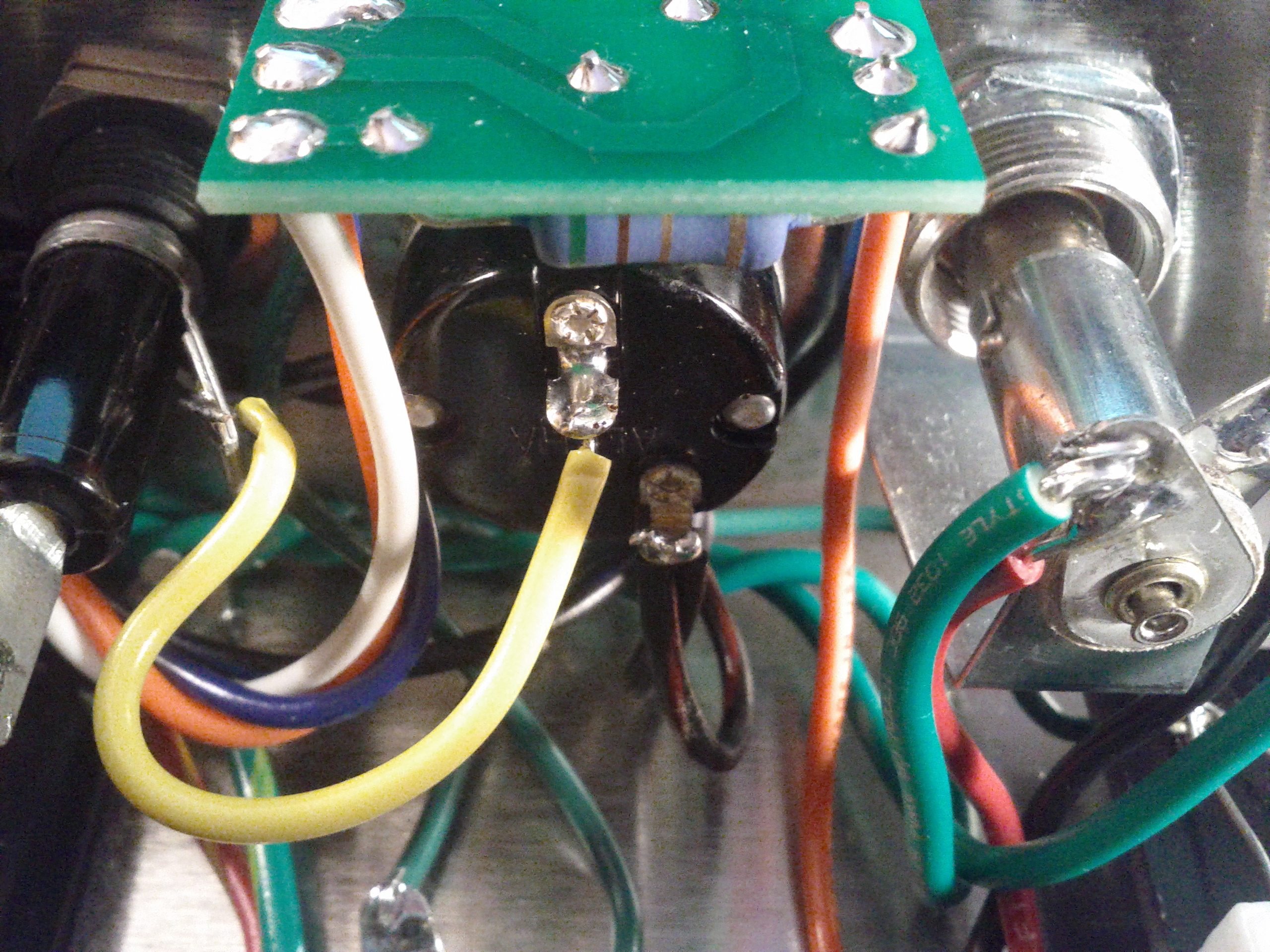

I have another question. I have just finished installing the VRM. I wired up the Pot but I'm not sure if I have the wires correct on the back.
The yellow wire is going to the fuse. Do I have this right or should I switch positions with the black/red and black/white on the bottom of the pot.
rob
PostPosted: Wed Oct 23, 2013 8:24 am
It doesn't matter. It's a switch and it has no polarity. What you have done will work.
