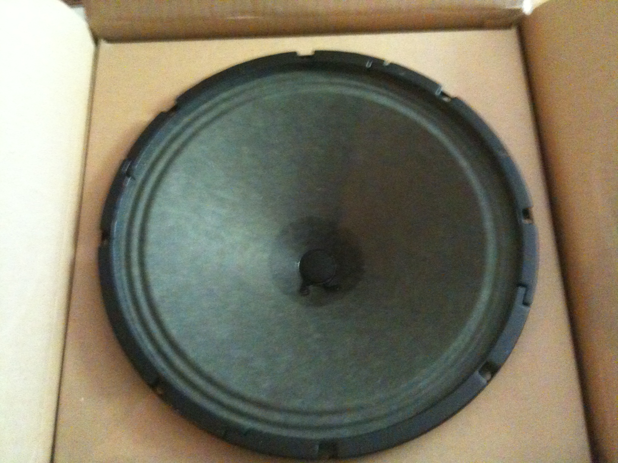

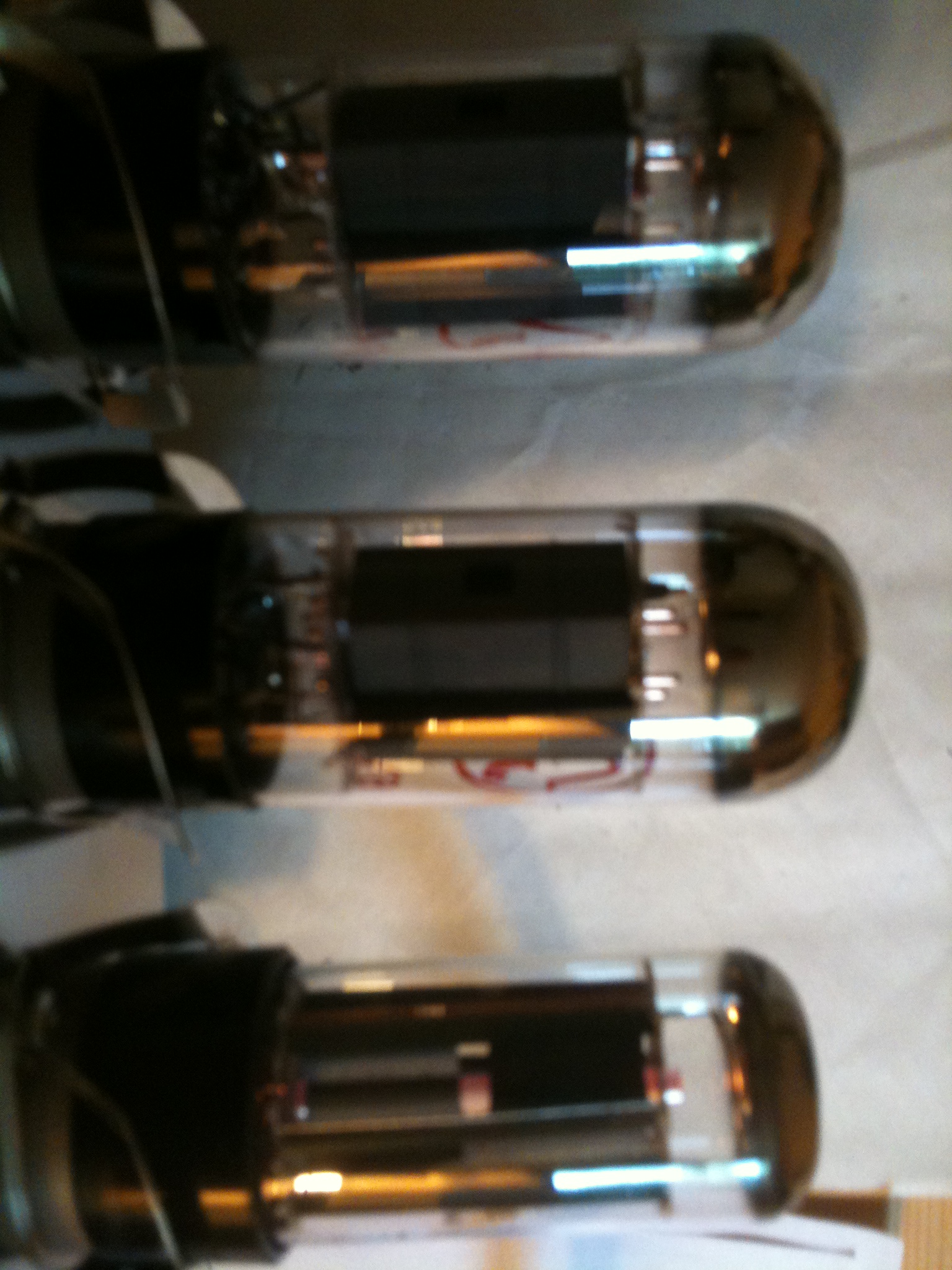

My kit arrived in early May (beautifully packed and shipped very quickly out here to Vancouver). I ordered the kit, a ToneTubby low watt, and a VRM kit (which arrived about a week or so afterwards). Many thanks to Stephen for his quick responses to e-mails and expedient shipping.

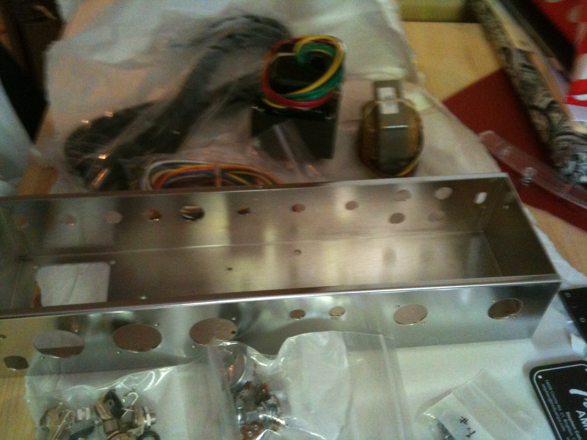

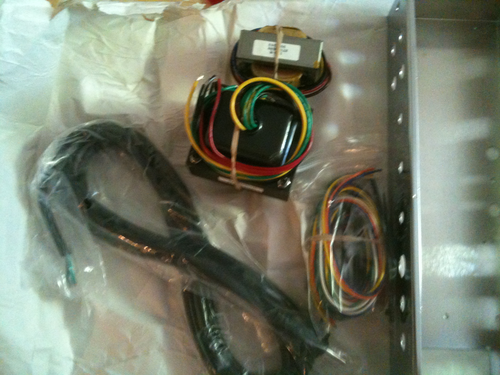

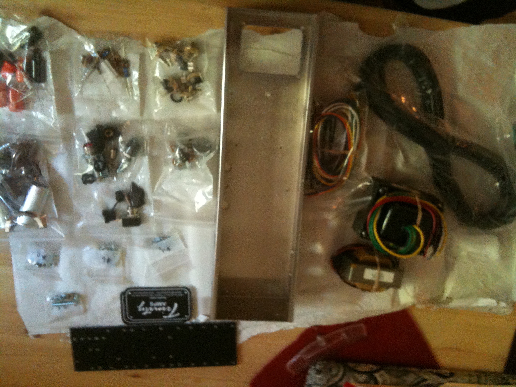

Given that I had been holding off on buying a kit for so many years, the anticipation of ripping open that box took me back to childhood Christmas mornings and made me forget that I'm a grown-ass man!
Well I was definitely not disappointed. Everything in the kit was tidily laid out, packaged, and labelled. I pulled out the bits and pieces and took a look at the chassis - stunning.
The chrome on that chassis looks so perfect that it quite literally takes your breath away.
Everything was right where it should be and after a minor mix up on the manual (I got a Tramp hardcopy instead of the 5e3 - which Stephen quickly resolved), I was good to go.

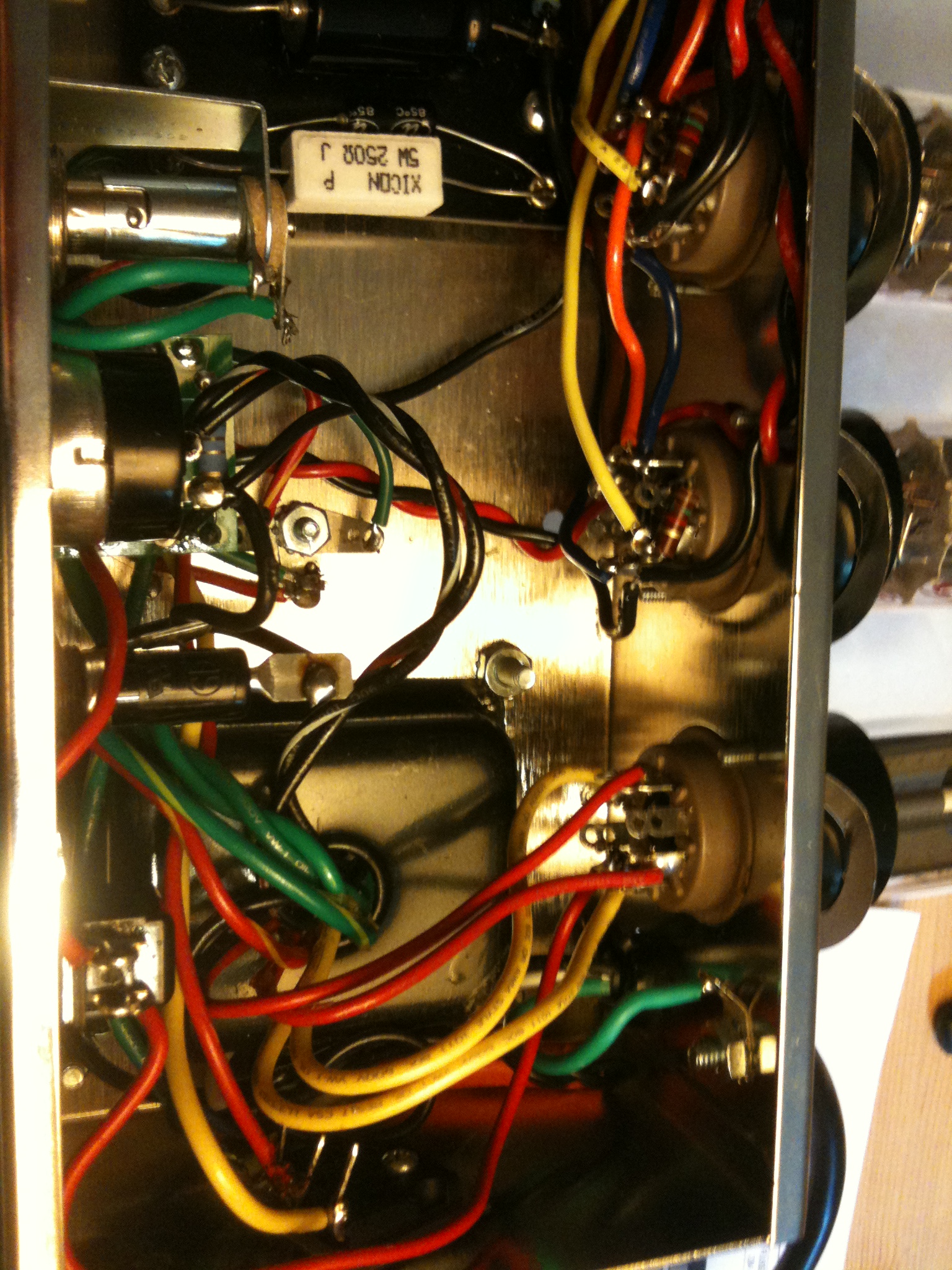

Well I worked through the manual and before I knew it I had everything in place.
I struggled a little with the VRM kit at first as I found the instructions and schematic confusing, but the Resources section of the forum was really helpful along with some of the excellent high res pictures in the Tweed forum section.

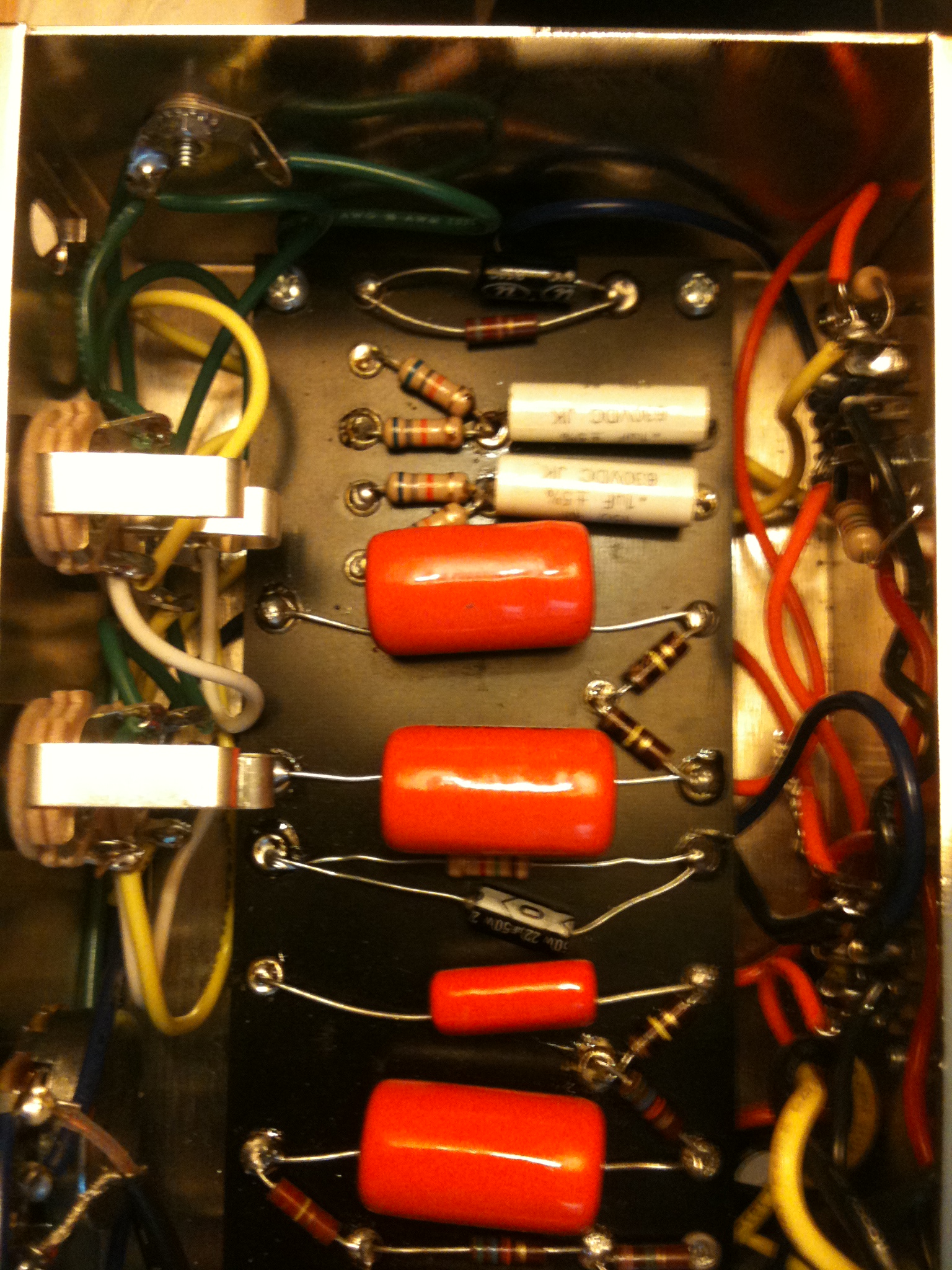

Aside from the VRM installation, I did have some trouble with the tricky solder joints on the tube sockets, particularly as they started to get a little crowded near the end. A couple wires got rather toasty in the process, but nothing structural merely cosmetic, and mostly minor. Mashing (ok fine, gently coaxing) the board into place was also a rather unpleasant process but if you follow the sequence in the manual and hook up all the flying leads as suggested it makes life a lot easier.
Overall the build really didn’t take me that long, but I stretched it out over a few days. I found that having a full uninterrupted day on a weekend to work on the amp was by far the most effective use of time, because it enabled me to read up on what I needed to do, do it, then read up on the next part and so on. Evenings were less productive for me because I found I spent most of my time reading and not enough time soldering! Really I think that somebody with even limited soldering experience, like myself, could easily put the kit together over an uninterrupted weekend, which is a testament to the elegant design of this circuit as well as the excellent manual from Trinity.

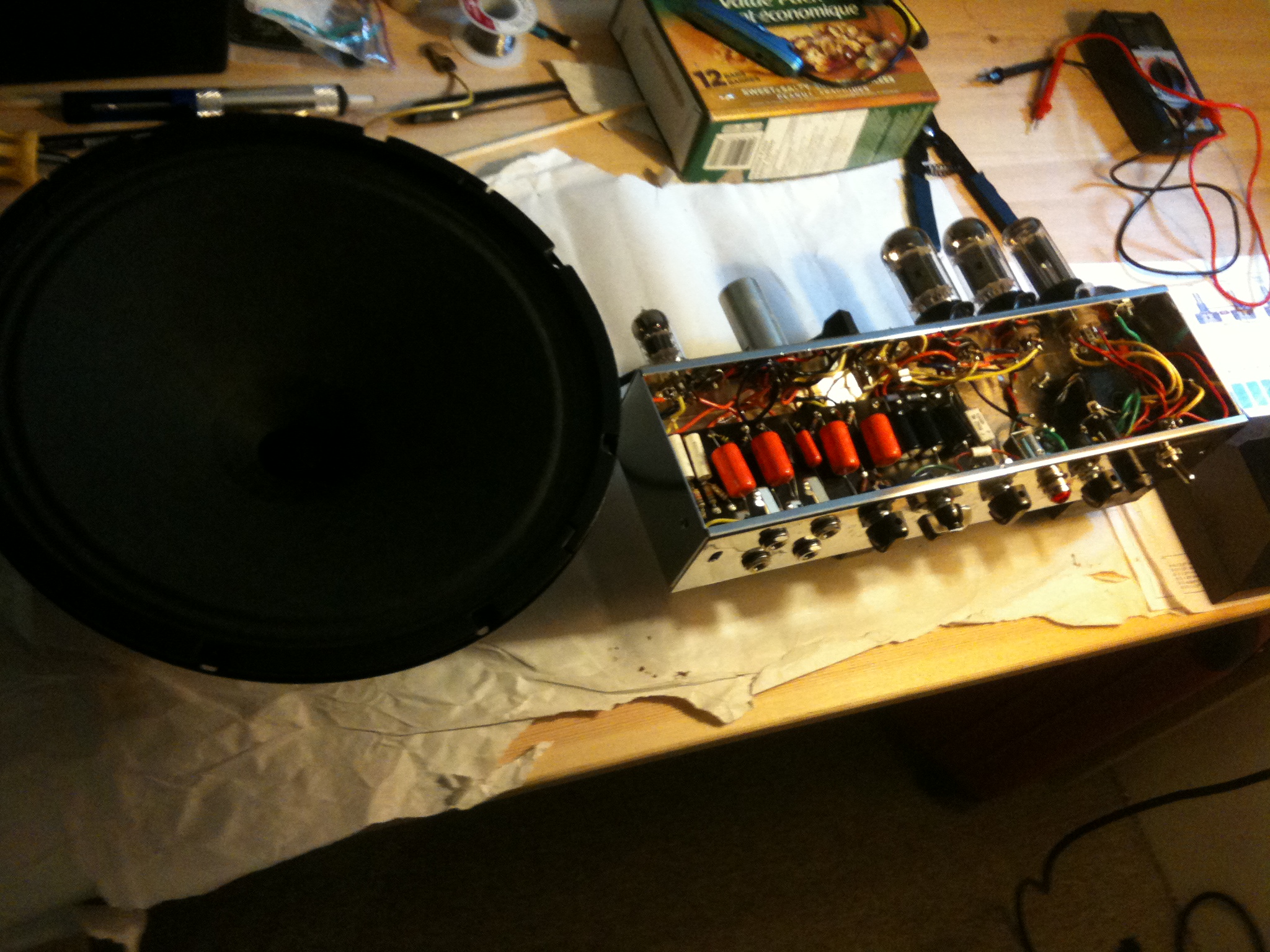

I’m one of those people who checks things rather obsessively, so I was continually double/triple-checking everything as I went along. When it came to the final check, I found that everything was in order and ready to rock.

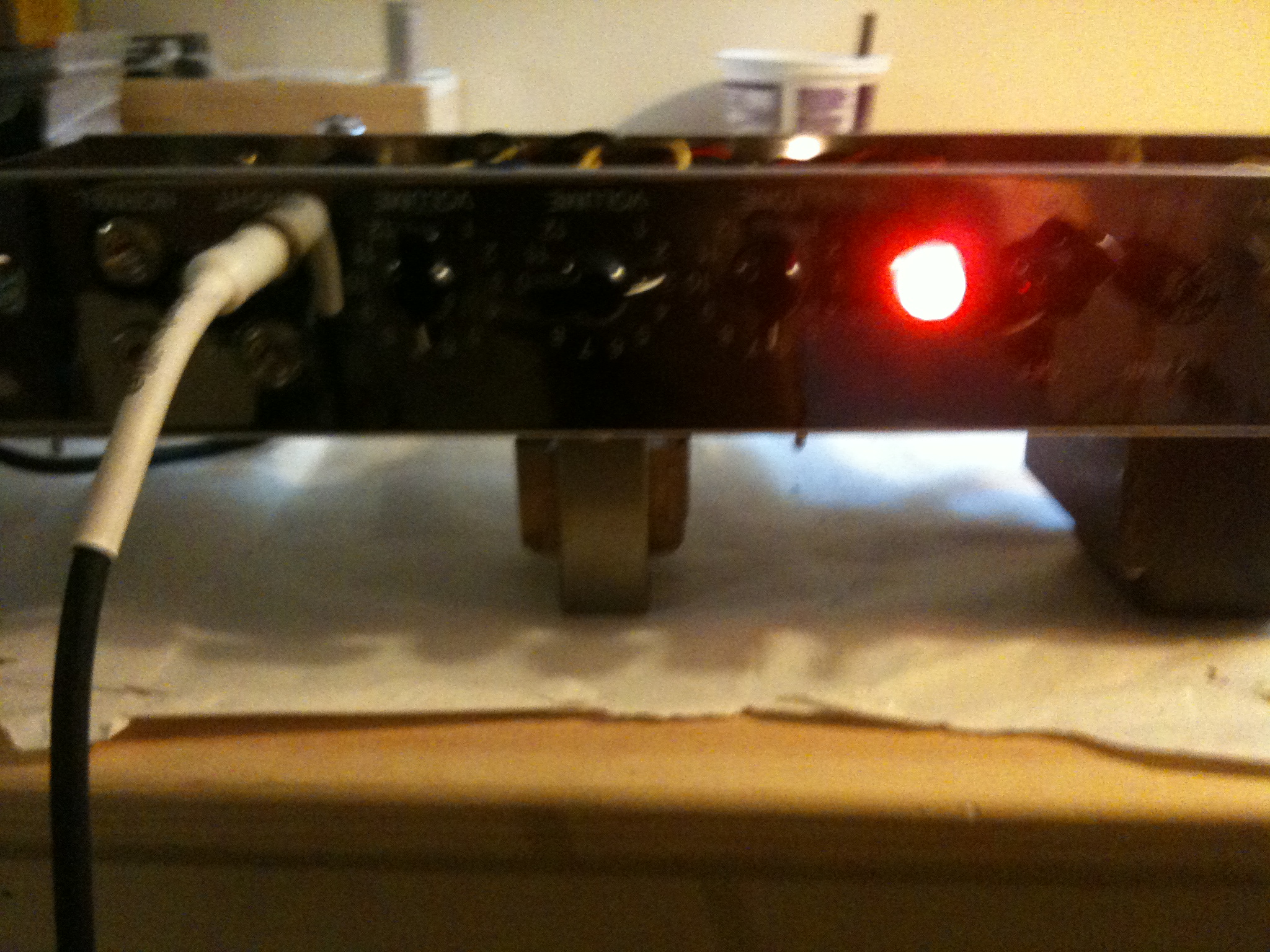

With some trepidation, I plugged it in without tubes and the voltages checked out just fine. I shut’er down, added the rectifier, fired’er back up, and nothing exploded. Finally I put in all the tubes and the speaker and flicked that switch. The moment I had been waiting for all along had finally come to fruition. I gave it a few seconds and saw those tubes give off that beautiful, heavenly glow. Hell. Yes. The warmth of those tubes warmed this ol’ cold heart of mine, let me tell ya.
Carefully I upped the volume ever so slightly and plugged in a guitar cord. With my heart in my throat, I put my hand over the end of the cord expecting, hoping, desperate to hear that heavenly hum. What did I hear? NOTHING! NOT A SOUND!! Oh god, my heart sank. What have I done? STEPHEN WHY HAVE YOU FORSAKEN ME? Then I took a look at my speaker. I realized that I had put both the positive and negative leads on the same terminal. I’m an idiot. I just built an amp from scratch but screwed up the simplest part? That’s embarrassing. What is this, amateur hour? Anyway, it gave me some hope that everything was still ok. So I shut’er down, put the leads on the correct terminals, and fired her back. What do I hear? Not much really, this amp is really frickin quiet (in terms of hum that is, it’s loud as hell in terms of volume!) But it was clear that this thing was working like a charm.
I was so excited I could have puked. I grab my guitar, plug it in…. E minor chord…. BLISS!!!!!! Man this thing is just something else. So, much to the chagrin of my upstairs neighbours, I put the amp through its paces… well as much as I was able to at 11pm (basically volume of 1 and the VRM at minimum). But it was clear that this thing was just working fantastically. It even sounds great at that low of a volume.

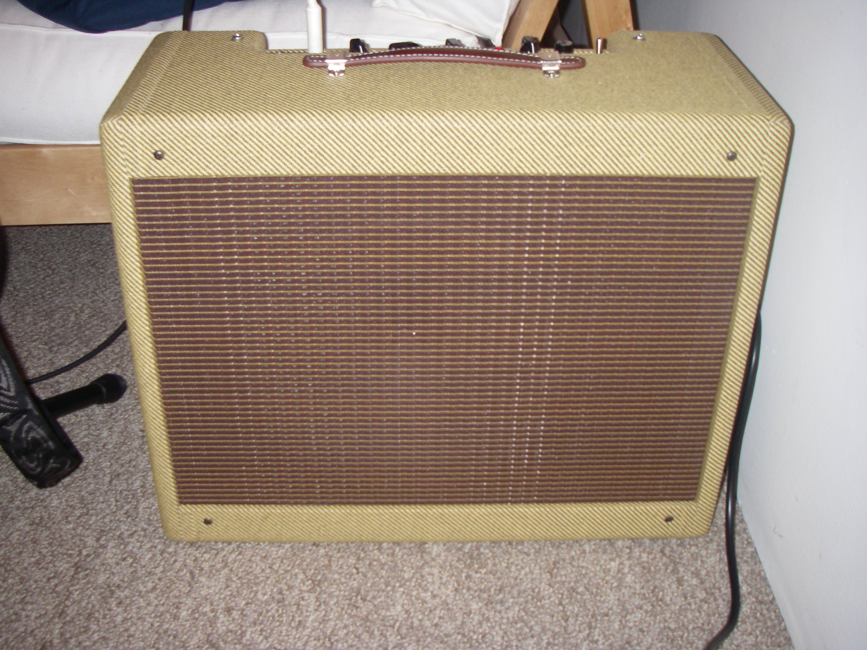

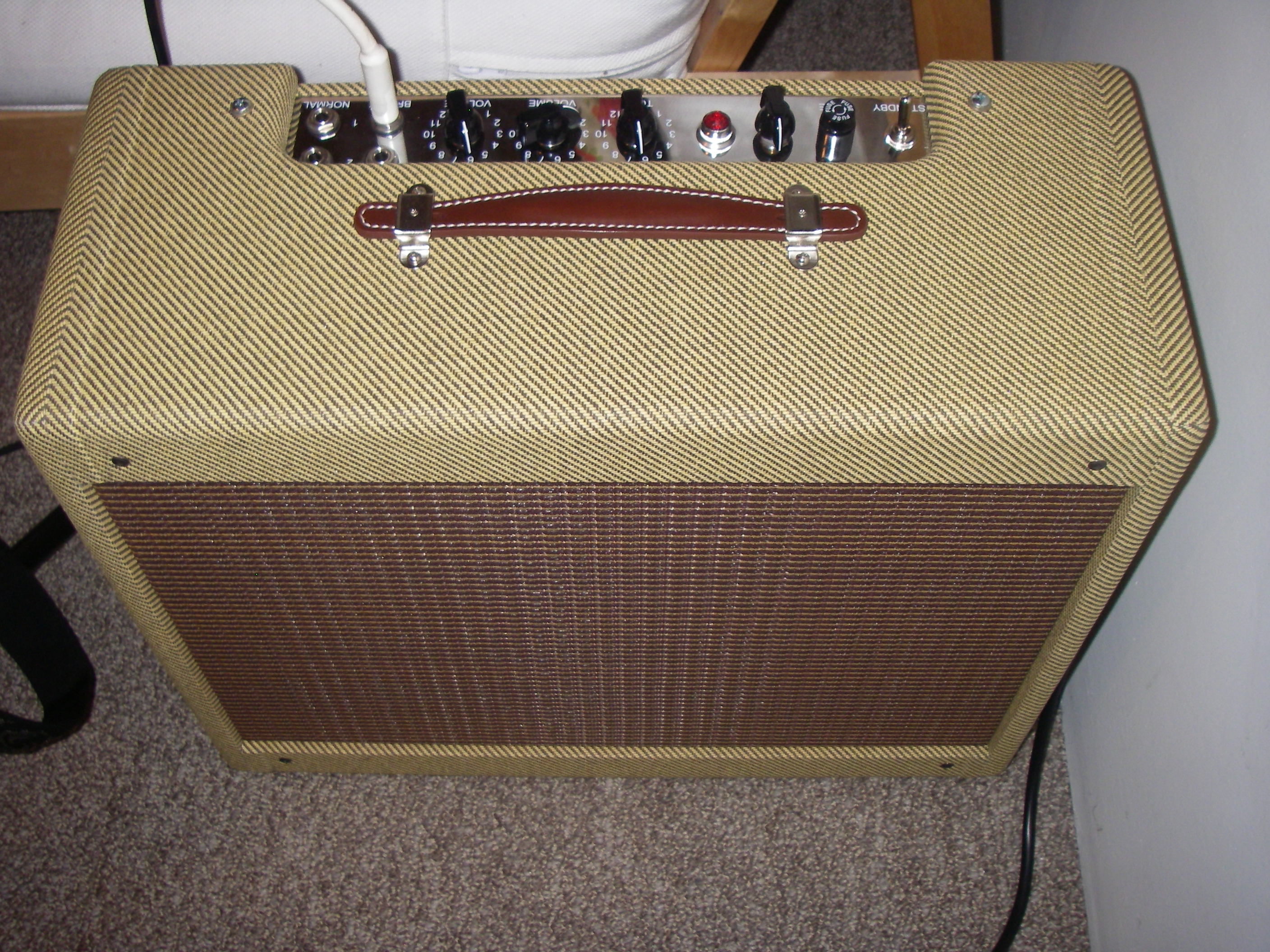

Just a quick update to show off the new cab and bring some closure to the build thread (for those of you waiting on pins and needles)!
I ended up buying the cab through a company in the U.S. I am really pleased with the quality, look, and most importantly, the great tonal properties of the cab.
The chassis and TT speaker fit just perfectly.
While I wanted to build the cab myself, I'm glad I wussed out and bought one because I know I would have made a mess of the tweed. That said, I predict another amp kit in my future...
