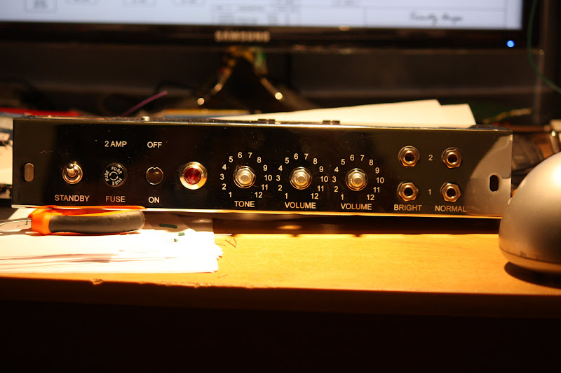

Just arrived home in Cape Town (South Africa) with my new Tweed kit in my luggage. I'm very excited to start building the amp, it will be my first F-style amp too ;-)
Here it is:
I'm also going to build a cabinet for the Tweed, it will be the first woodwork I do since school (about 15 years ago) so that will likely be trickier. I decided to make my Tweed not a tweed covered amp but to cover it with red tolex and tan + black grill cloth, but I'll use the standard Tweed cabinet design and just substitute the covering material. I've ordered the tweed kit with the VRM module which scales the whole amp I believe. I'm hoping that that will give decent tone to fairly low volumes. The PA/PI scaling on my 18 watt is great in that regard.

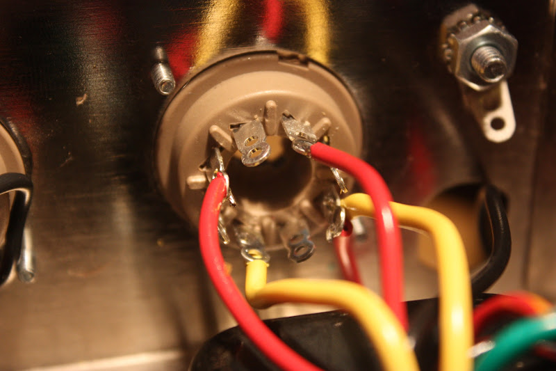

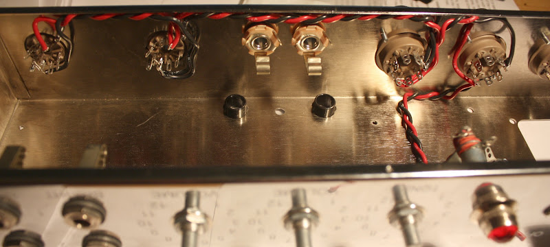

More pics!
Heaters, before I soldered them.
The VVR board now attached to the On/Off Switch / VVR pot
Power Transformer mostly wired, must still install the Mains power to complete this section of the amp.
Rectifier
