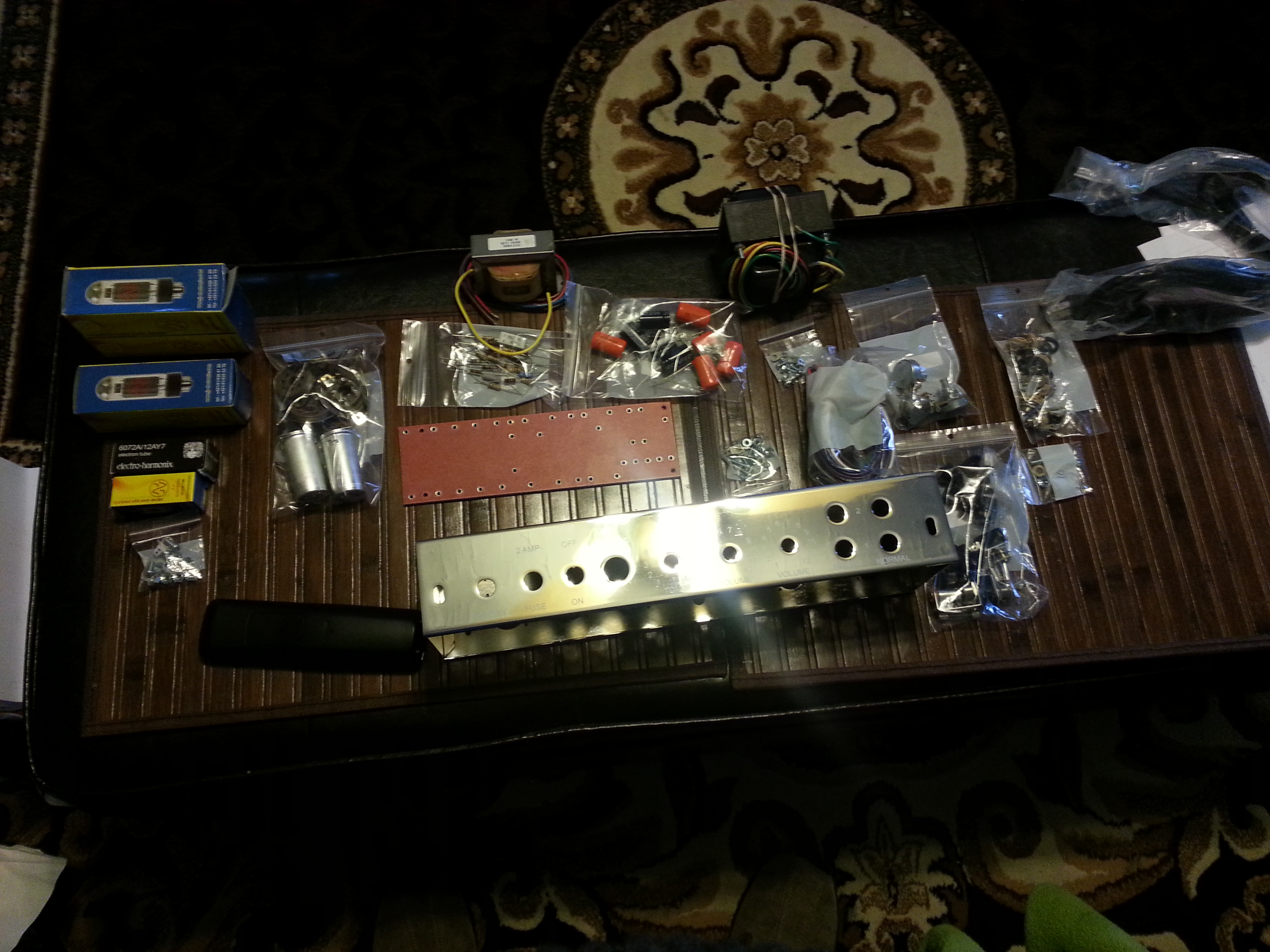

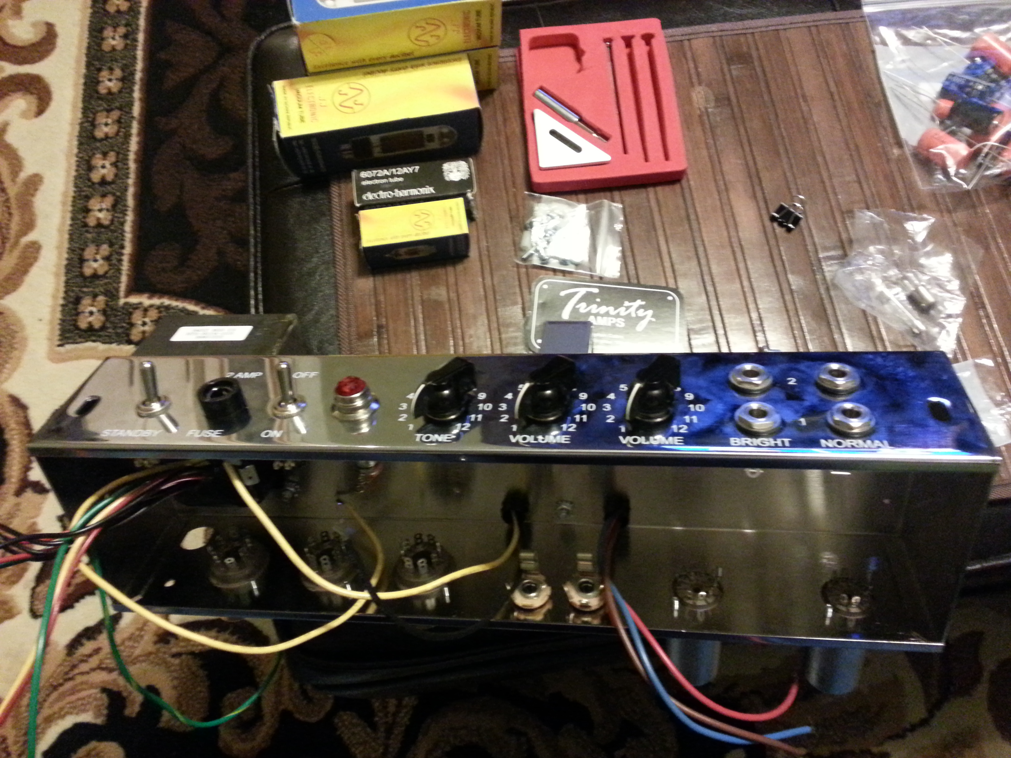

5E3 TRINITY TWEED AMP BUILD (oct/22/12)

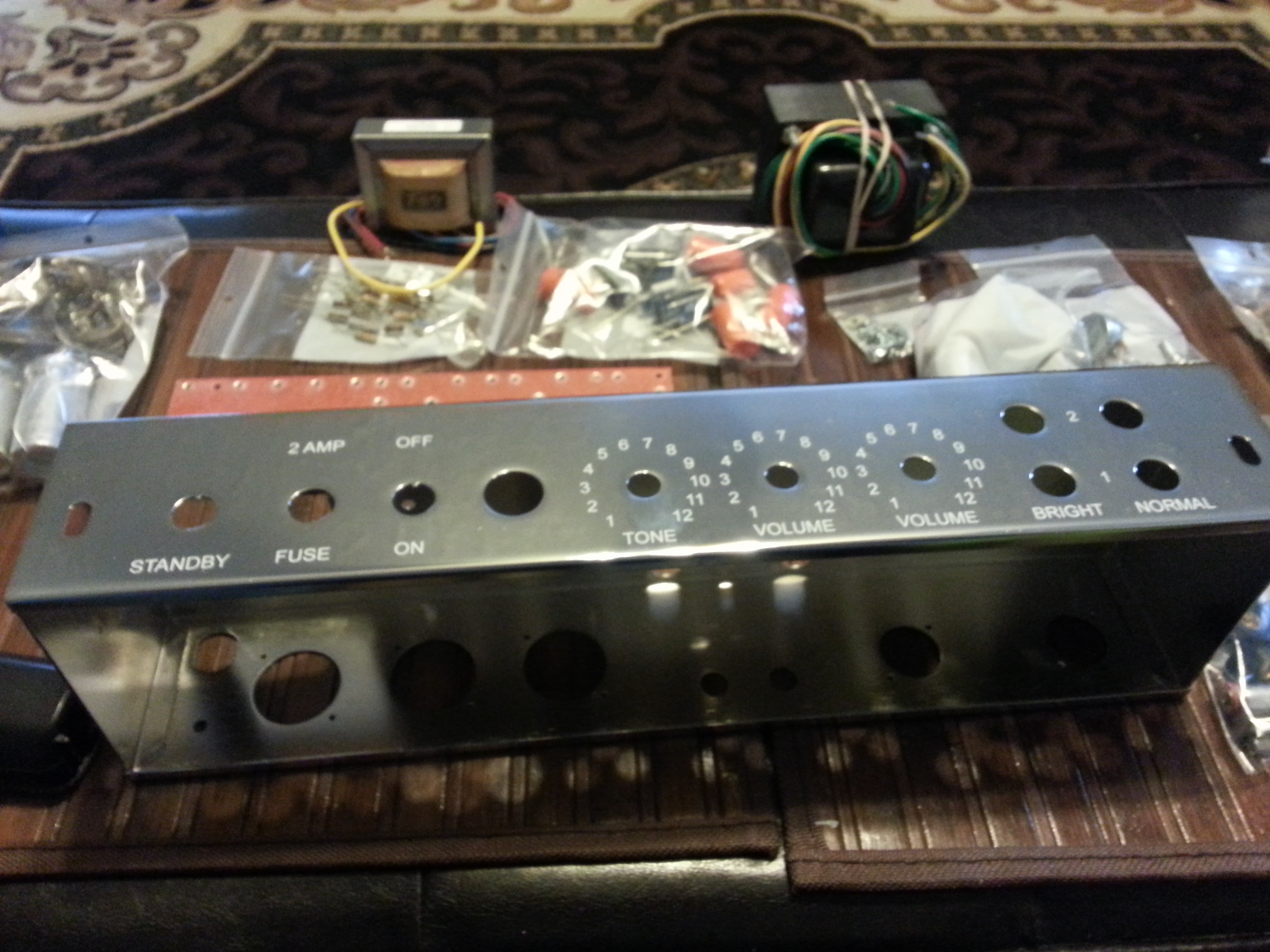

amp came to day checked all the parts
looks like every thing is here...read all night.

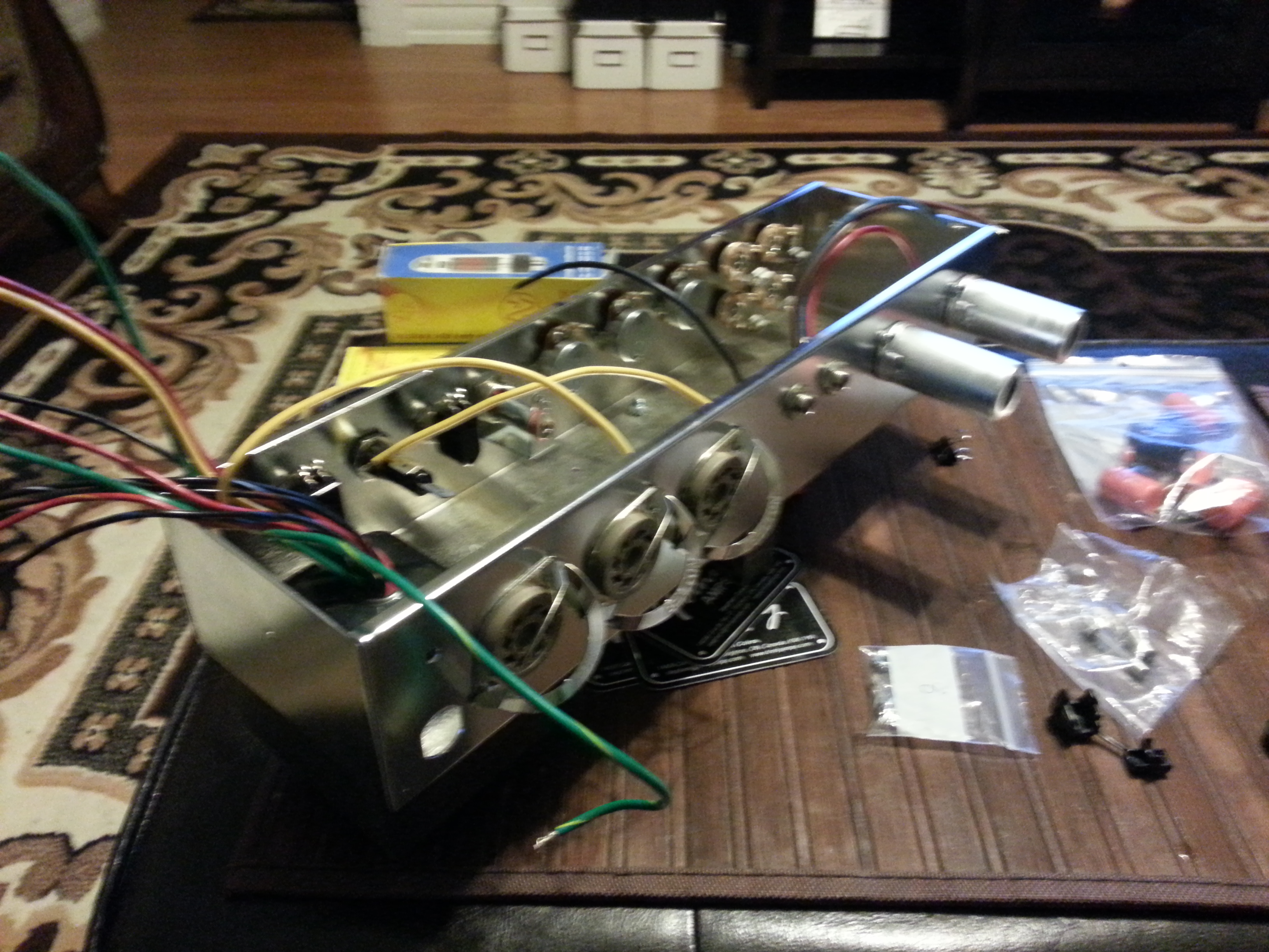

read most of last night , started putting her together today.
one step at a time .

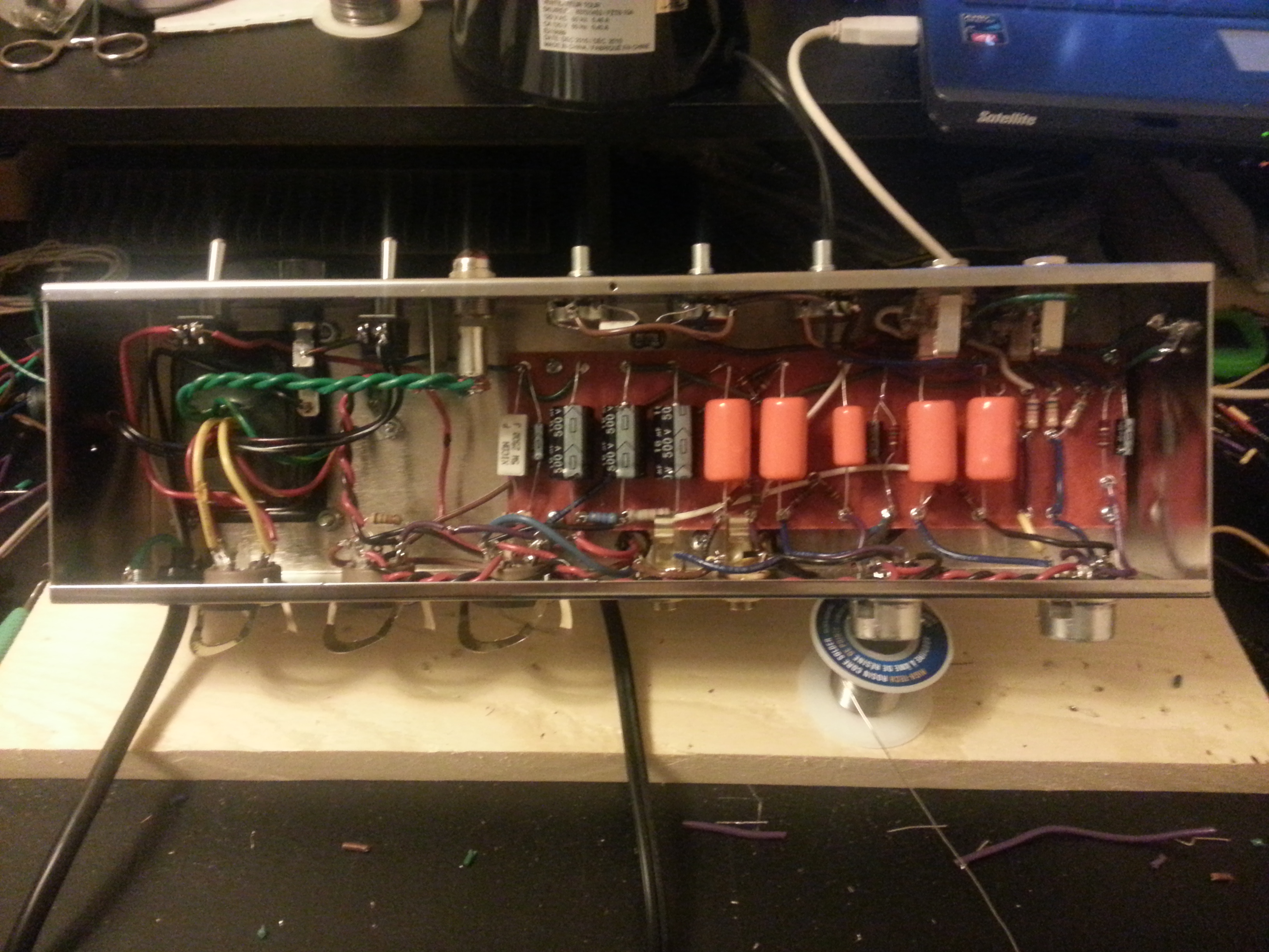

Finely got it rite :shock: I hope ;; it looks good

Greetings from a first time Tramp builder (built about a year ago, the amp is running fine).
Nice going.
Please keep posting.
I'll be following your thread because your pictures and explanations are great and I'm interested in eventually building a 5e3.
PostPosted: Wed Oct 24, 2012 3:31 pm
One of your filter caps is backwards!
PostPosted: Thu Oct 25, 2012 12:13 pm
Posts: 204
Location: Vancouver BC
Actually,there are 3 backwards,the small 25uf on the far left and the 3rd 16uf and the middle 25 uf, if I'm not mistaken.

thanks guys i have it now caps flow north south do the resisters have a inline flow
PostPosted: Sat Oct 27, 2012 9:49 am
Posts: 141
Your resistors are not polarity sensitive.
PostPosted: Sat Oct 27, 2012 12:03 pm
Caps look good now. The rest are'nt polarized. Practive your soldering and get a good hot, shiny solder joint. Very important. 25W iron, .032" flux core solder.

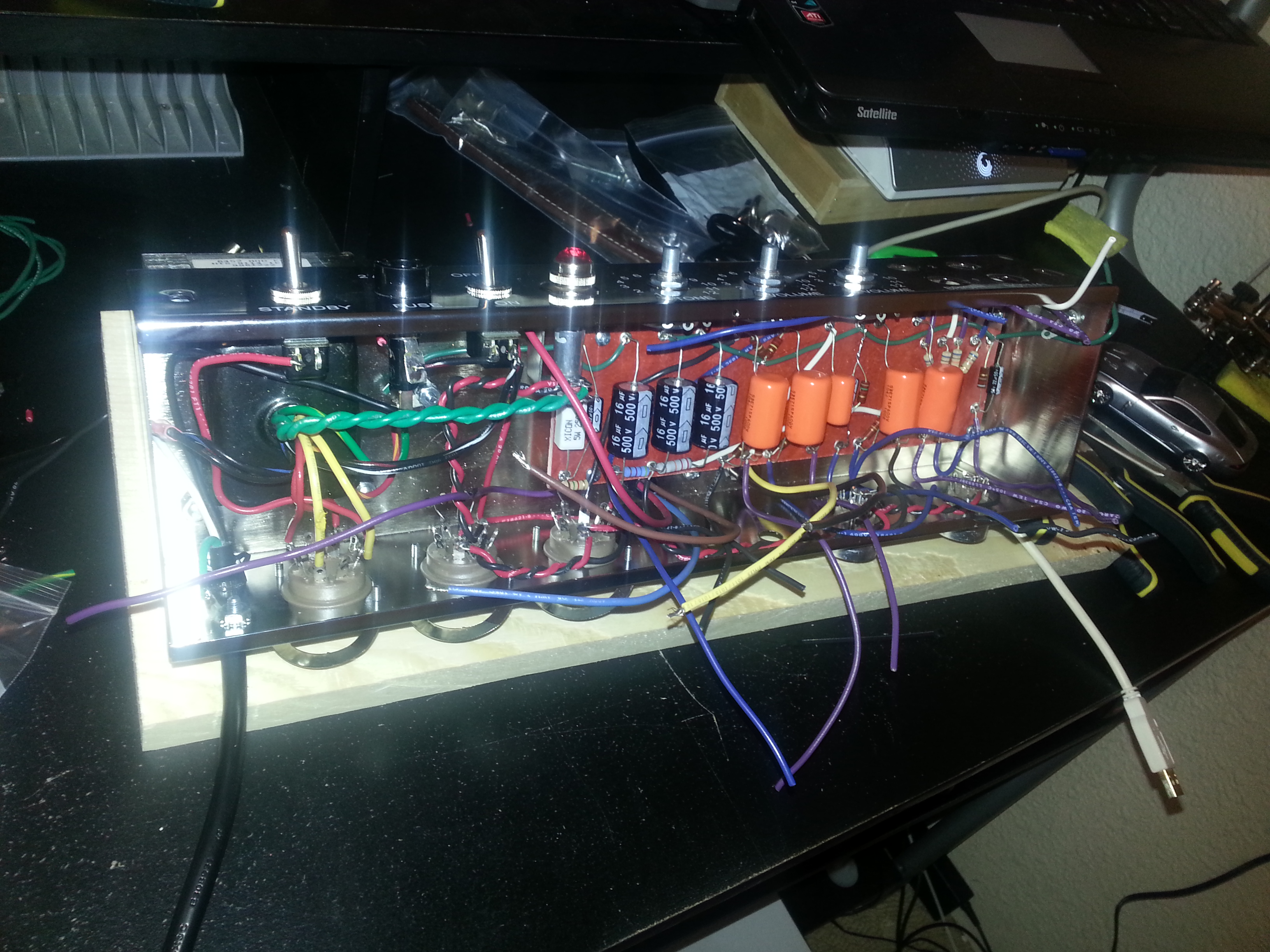

heres where im at today picked up my tools yesterday 15 hr of work and !!!
PostPosted: Tue Oct 30, 2012 7:41 pm
Looks good. And a healthy snack to boot!!
Keep it neat and it will be fine! Short wires!

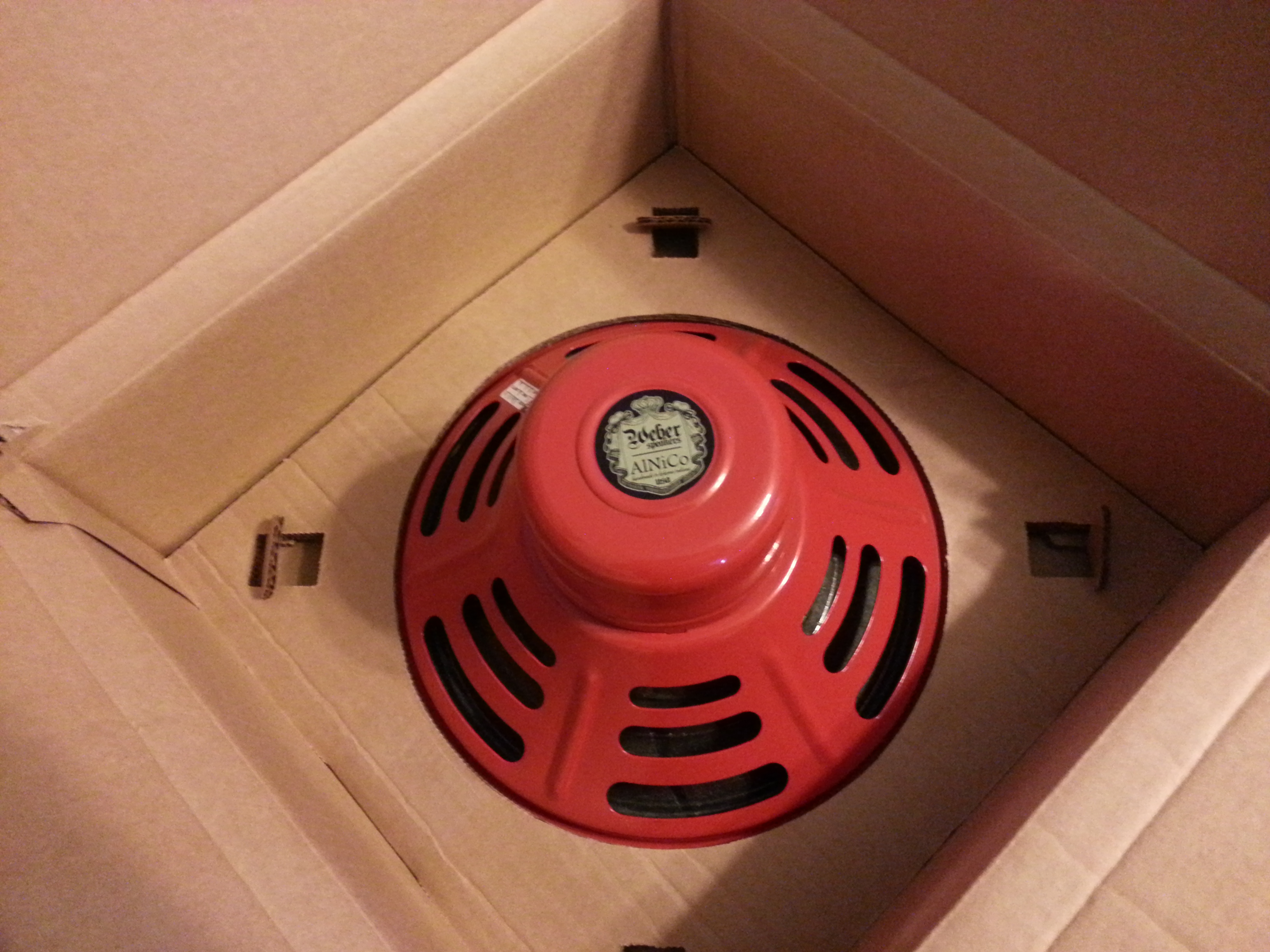

well the speaker UPSed in today. Holy cow its beautiful its a 12A125.A alnico ,, WOW !!!!
i have to finish the cab, have all the hardware ,tweed ,and grill cloth ,,,

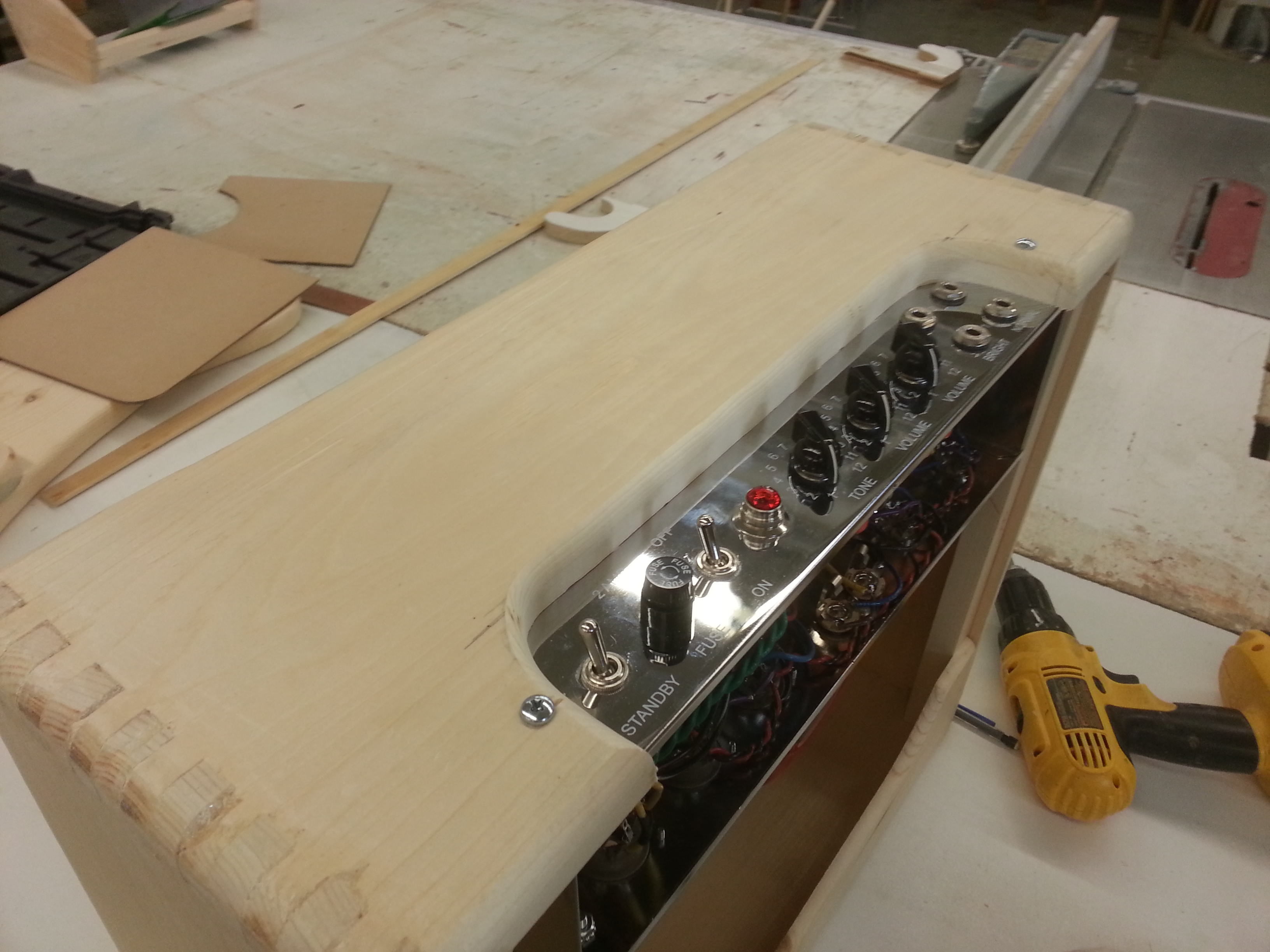

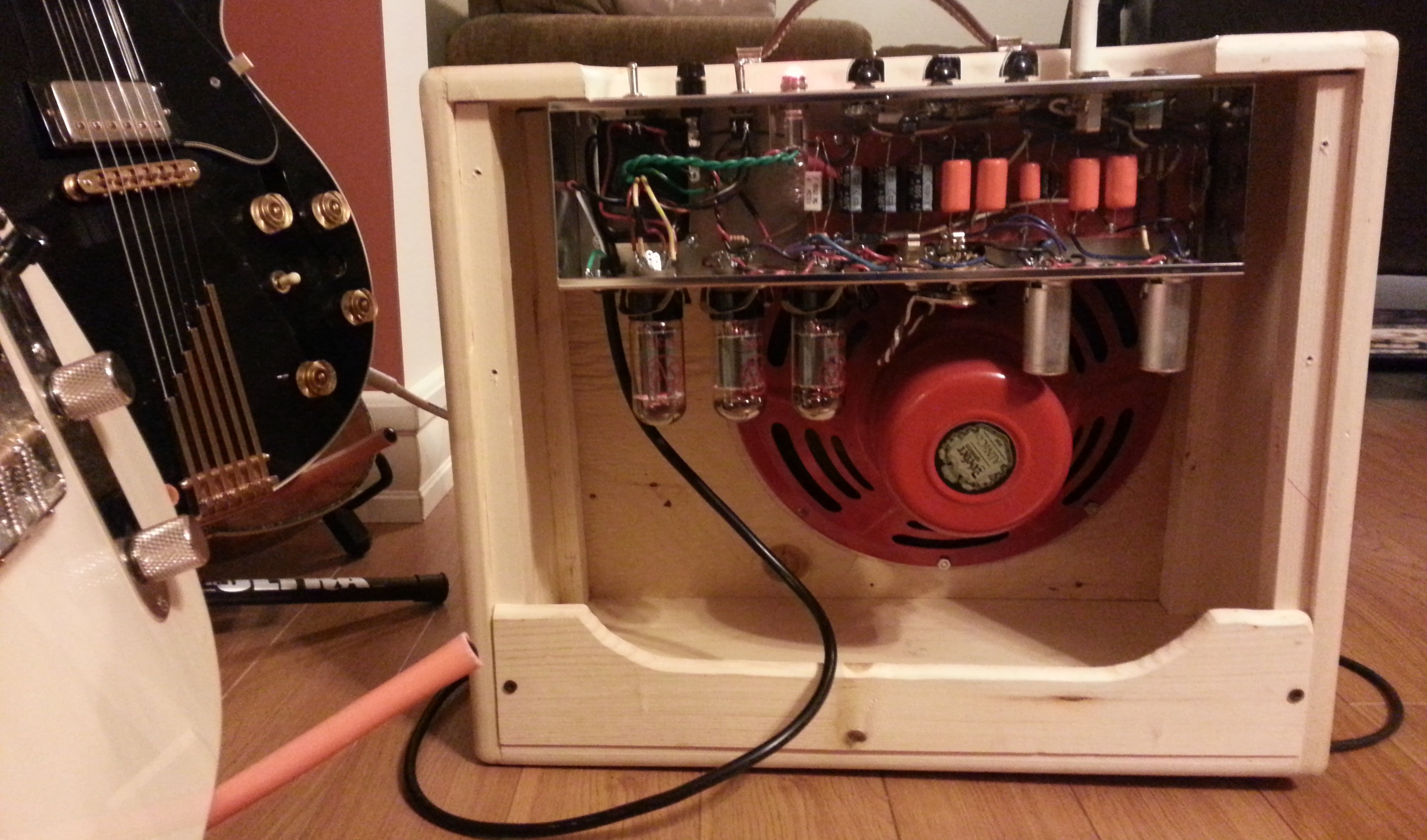

ive been away but have made some progress
PostPosted: Fri Dec 14, 2012 1:15 am
Joined: Thu Aug 23, 2012 12:20 pm
Posts: 12

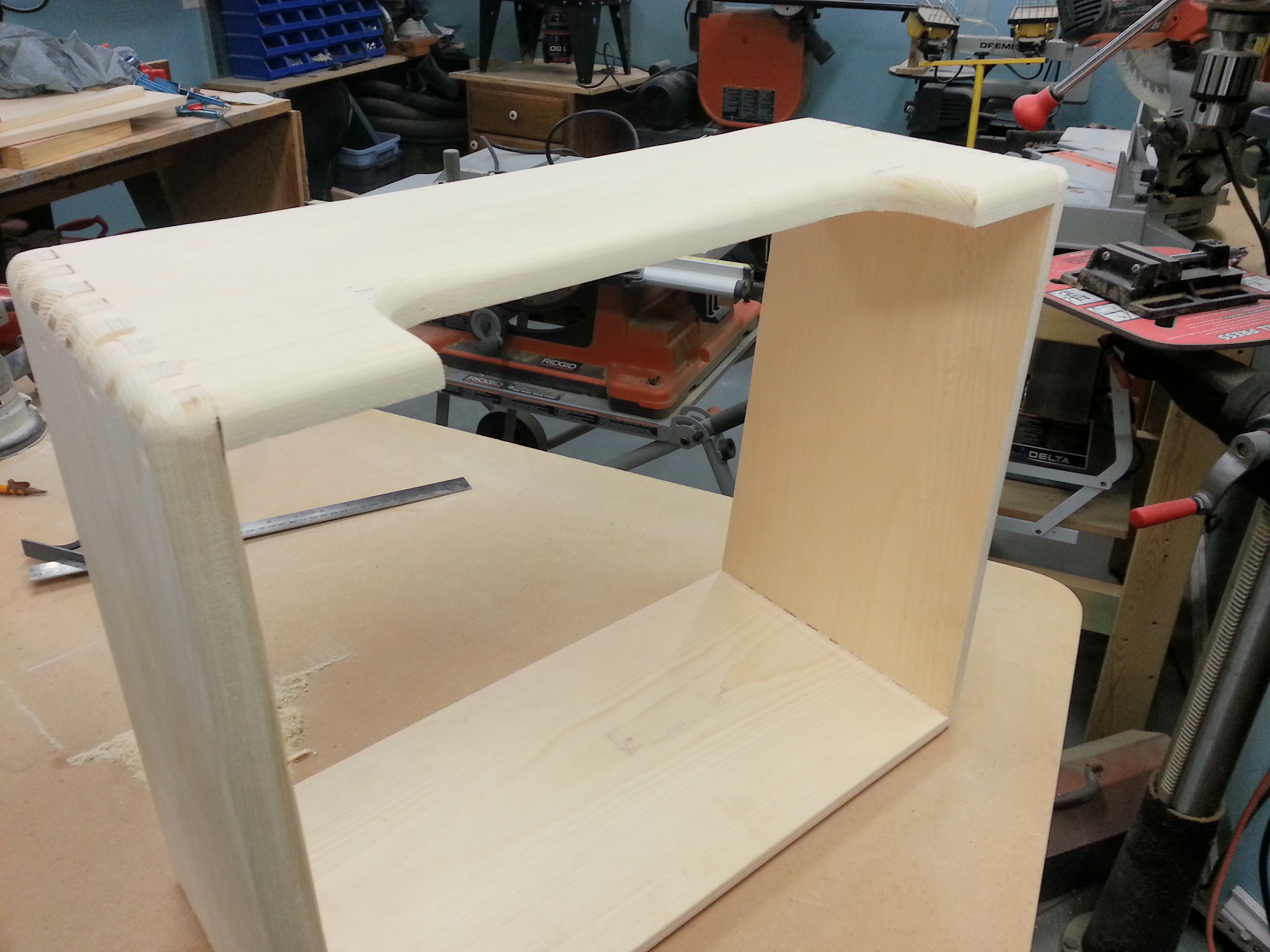

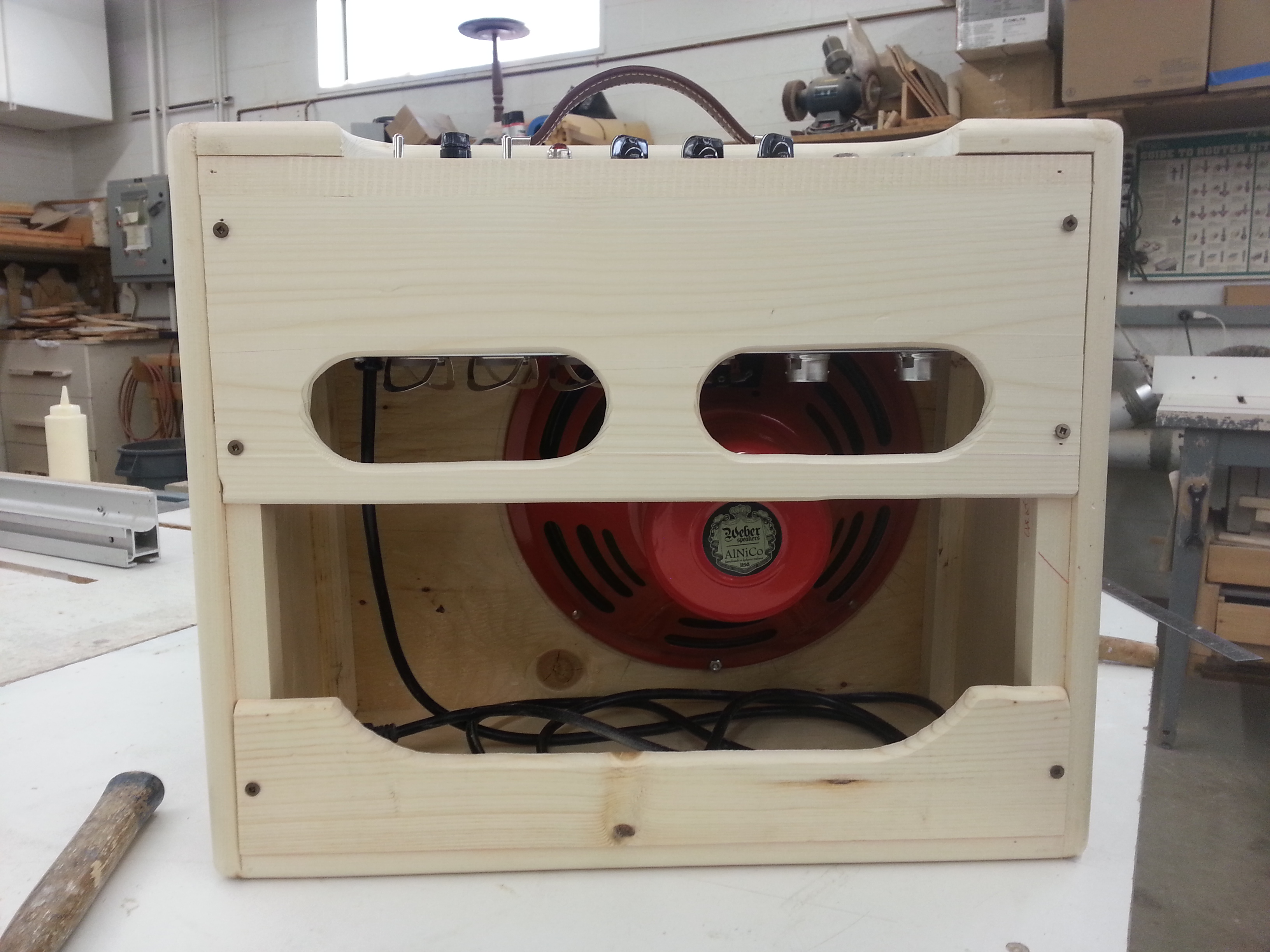

Some more pics I am going to make another cab made lots of mistakes its just time and 20 bucks for a pine board .. dose not look bad in pics but it is bad !!
File comment: ts alive !!!!!!!!!!and dose not have a loud harsh hummm !! its has a great chime to it, just a hint of bravado and great volume driven overdrive vhen you dig in

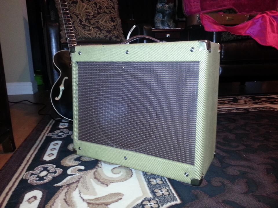

PostPosted: Wed Jan 30, 2013 2:18 am
Posts: 12

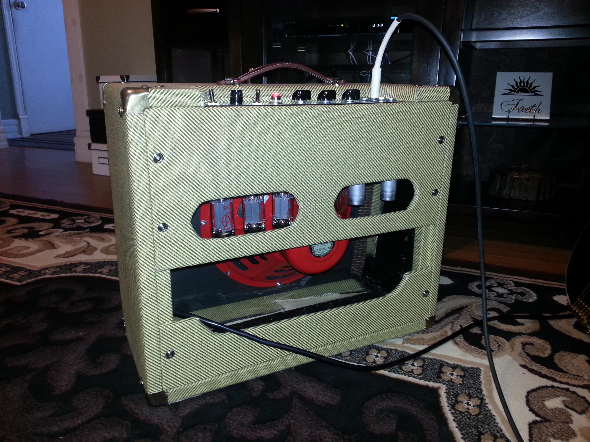

i got the tweed done to day .. i will never build my own cabinet again .. next time i will buy one !!!
the good thing is that it looks more like a 50 year old closet find..witch is kinda cool

Posts: 40
That looks pretty good! Well done! My cab should be done this week too, then I can take my tweed for walkies :D
PostPosted: Wed Jan 30, 2013 2:29 pm
Tweeding takes about twice as long to do as Tolex. And people wonder why it should cost more!
