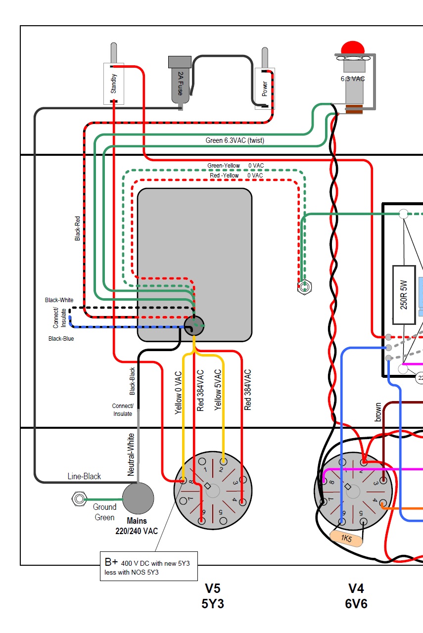

Hi guys
I'm trying to differentiate the wiring differences for the PT between 120v and 240v.
Is there a wiring layout anywhere for the 240v wiring?
Cheers
Brad

Hope this helps. It's based on the manual schematic but more pictorial.
Tweed 240V PSU hook-Up

This is bit late to this thread but may add value for later reference.
Once wired as per Stephen's posted layout for 240V you would also normally drop the fuse rating to a 1A Slo Blow.
Snowy
Snowy
True & we try to rember providing same for 240V customers - sometimes it is overlooked with pre-packaged kits. :oops:
