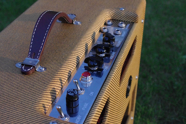

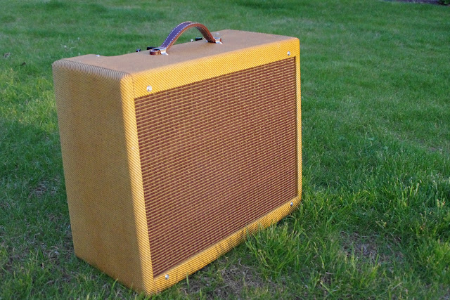

Well I'm 99% done. Still want to chase a pesky little buzzing problem. Will get at it again soon. My tweed cabinet arrived today. It looks brand new, I cannot find a mark on it. I found a deal on the net from a private seller. $125 shipped from Philly to NW Washington. Heck of a find. I mounted the chassis and an original 1964 Jensen C12N in there that I took out of my 64 Bandmaster cab to store. It sounds very darn good. The volume is so touchy from 0 to about 2.5, then at 2.6 it explodes into full-on, rip your face off tube distortion. From 2.5 to 12 the amp does not seem to get any louder just dirtier. I can see this is not really a "keep your family happy at home" amp. It rips, but man, it's loud. The C12N is a ceramic speaker. I plan to order a BBQ 12125-A, alnico soon and put the old C12N away again.
The buzzing is not completely gone yet. It's great when I plug my guitar into either of the bright channels. If there is no guitar plugged in, or I plug into the normal channel it's there. I'll get it sorted out soon enough. Right now, I am having too much fun playing it. I highly recommend the Trinity Deluxe kit. It has good quality components and good instructions for beginners. was my first ever amp build and I am very happy with how it turned out. - Keith

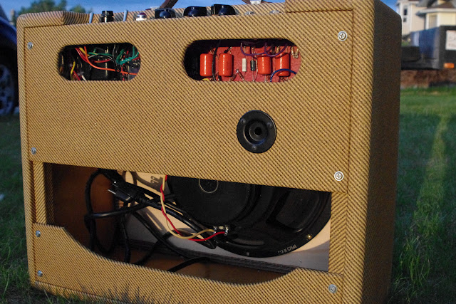

VERY nice indeed! You might wanna rotate that upper-rear panel 180 degrees, though. The oblong openings typically line up with the tubes for cooling. Kinda cool being able to peek at the circuitry, though.

The two volume controls are so interactive it's pretty cool. I already swapped the rear panel around as I installed it in
a hurry and over looked it.
